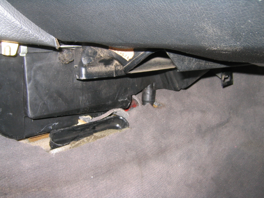

Accelerator bottom section off floor as well as stop peg...
