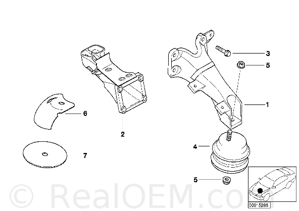

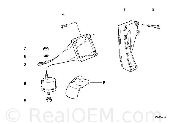

BM WORLD 1294 Report post Posted September 20, 2007 some thing like this . bmw parts list not these ones that you have . Visit My Website Quote Share this post Link to post Share on other sites
