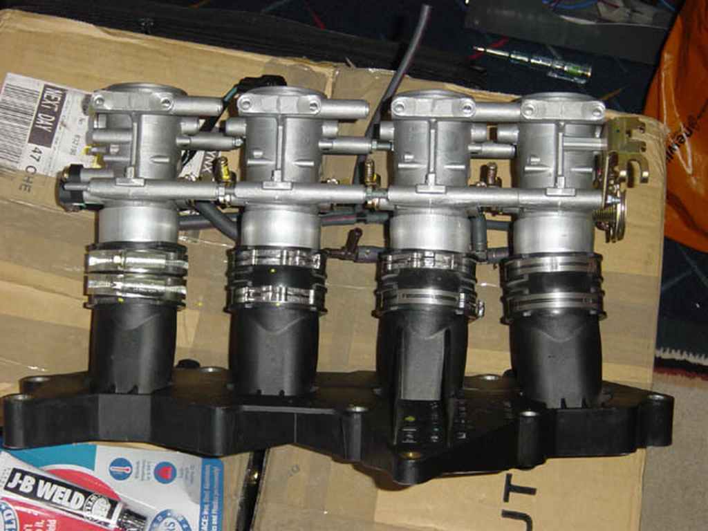

Justlikemusic 0 Report post Posted February 14, 2008 http://www.clockwisemotion.co.uk/images/ho...ttle-bodies.jpg Another thing with customer throttle body install with megasquirt is the custom injector rail you can use, basic lack of intake manifold so you are just getting max rpm power, and larger injectors from any car you wish custom fitted into it. http://www.mez.co.uk/dcam/DSC00232.jpg This is making me lose sleep. Quote Share this post Link to post Share on other sites
