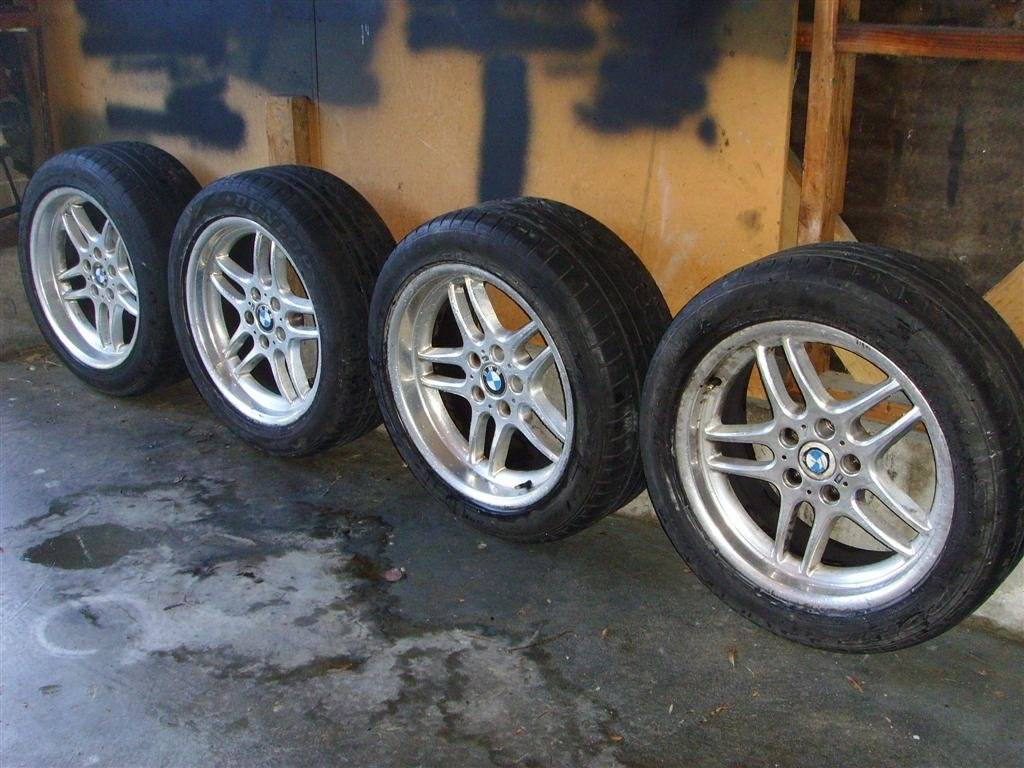

I seek advice on tyre sizes for fitting on my 18" staggered 8 and 9" M-Pars (pictured below)
Currently I run 18x8.5" on 235/40/18 and 18x9.5" on 265/35/18, obviously on an E34 with a bit of drop and some negative camber in the rear.

Id say 'as you are' mate. 235/40 and 265/35 is the correct size for 8's and 9's.
I have seen people with 245 on the front (255 even) and either 255 or 275's on the rear, but what you have now is what I would do.

Nice wheels there! Now if I could find a set of those for my E34 (or even a set of throwing stars...!)...
