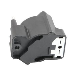

E30-323ti 66 Report post Posted January 17, 2017 5 hours ago, Kepes said: Didn't know the new ones had 8 ign and inj drives. Was referring to the blue G4+. Obviously I have a lot more research to do. You say wasted spark 2coils x 3channels. Wasted spark is something I am looking to do in the future, do you mean 3 coils x 3 channels? Would like the extra aux outputs to give me some room to add things in the future. I think this G4 Storm is a goer. Depends on the type of coils, but think you've got the jist. If they are individual (say like a M50 or a *JZ or RB*) you will have 2 coils on each channel, of which you use 3 to run wasted spark. If you get some twin output coils, '90s 6cyl fords/holdens have these as do the mitsi 4G63's (Evo/VR-4) & toyota 4A-GZE's, like the below, you only need 3 of them. Being dumb coils, you will also need a 3chl ignitor. Once you've done all that it's almost cheaper buying 6 smart coils, which could still run in wasted spark configuration on an older G4/G4+ storm or new Atom. Quote Share this post Link to post Share on other sites
