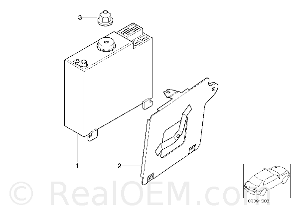

jochen 4 Report post Posted December 13, 2009 hi can advise bmw part number to look for please Use the following (Item 1 in pic below): BMW Business RDS (single tuner radio module) http://www.realoem.com/bmw/showparts.do?mo...hg=65&fg=05 or BMW Professional RDS (dual-tuner radio module) http://www.realoem.com/bmw/showparts.do?mo...hg=65&fg=05 When comparing the two, note that the Professional RDS is the BEST of the two. Note the manufacture dates: Do not get a radio more than 1 yr older than your car, otherwise you run into firmware version issues. Especially early E38 radios (prior to say Sept 1995) cannot control the E39 CD changer Do not get a radio built newer than 08-2001, because new gen radios from 09-2001 have different connectors and require a different wiring loom adapter and different antenna amplifiers If you have the Jap nav, then the Business RDS radio is plug and play compatible with the Jap nav. The Professional RDS radio won't display text properly with some older versions of the Jap nav The compatibility issue with Jap nav disappears if you remove the Jap nav and fit the Euro nav Here they are on ebay.de: http://shop.ebay.de/?_from=R40&_trksid...-All-Categories NOTE carefully the difference between old gen (round pin connector, prior to 09-2001) and new gen (flat pin connector, from 09-2001) The date is written on the label eg KW 39/96 means Kalendar Week 39 from 1996 The one here would work, and costs 80 Euros (about 160 NZD) + postage (surface mail, 6wk delivery, is only 13 EUR) http://cgi.ebay.de/BMW-E39-E38-Radio-Modul...1#ht_2180wt_939 Quote Share this post Link to post Share on other sites
