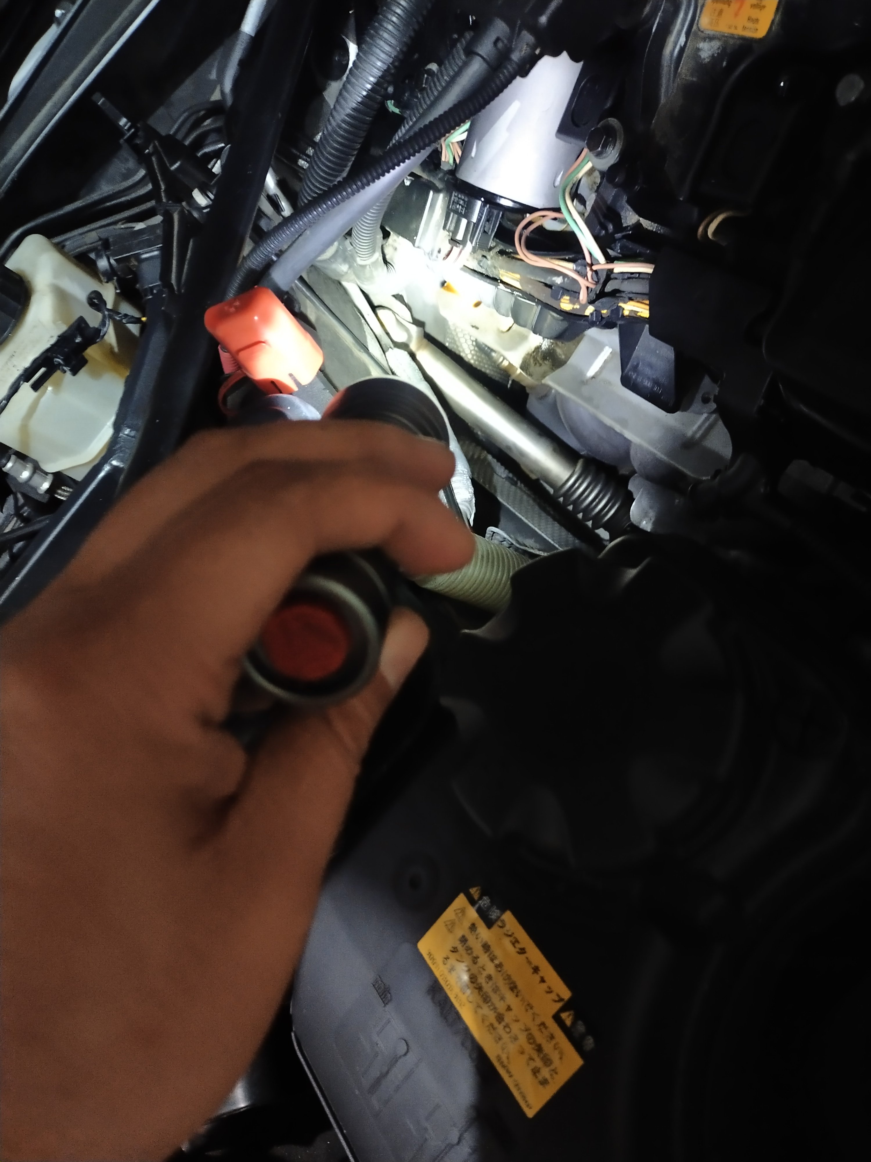

Toksis 3 Report post Posted July 6 Ok i replaced VCG and spark plug pipe on my cylinder 4 of my n46 e90. Torque to 10nm. However it still leak. Any advice on how to fix this? Quote Share this post Link to post Share on other sites
Vass 1073 Report post Posted July 6 The plastic valve cover itself could be cracked, seems to be quite a common occurrence. Worth checking it over thoroughly every time it's off, cracks can be hard to spot being black plastic and caked in gunk. 1 Quote Share this post Link to post Share on other sites
Toksis 3 Report post Posted July 6 is there a way to fix it if it is cracked? The spark plug pipe too is leaking little oil. Even I replaced the spark plug pipe in cylinder 4. I thought maybe tighten it more than 10nm? Quote Share this post Link to post Share on other sites
Vass 1073 Report post Posted July 6 I wouldn't tighten it more than that, those threads are really easy to strip out. Wouldn't mess around repairing the valve cover either, just straight replace. Should be cheap enough from Pick-A-Part or similar. 1 Quote Share this post Link to post Share on other sites
