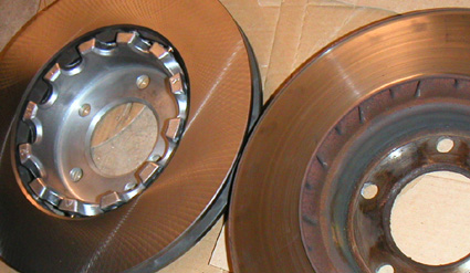

E30-323ti 66 Report post Posted September 24, 2006 Anyone know much about e36 M3 brakes? I have been told that the my rotors will need replacing soon. Should I stick with OEM rotors or are Brembo a better option? Cheers for your advice. OE rotors are good (it is a M3 afterall), esp. if you have the floating rotors. The OE ones are soft though, they wear out quickly with harsh pads (thus the big mess on your wheels). The Brembo's are good quality, not floating like the Euro M3 ones, and would prolly last a bit longer. If it were Bremebo Vs Conventional OE rotors, I'd weigh it up on price, add the floating rotors I'd go with them if the cost wasn't horrendous and if you plan to use it on the track a bit. Quote Share this post Link to post Share on other sites
m_reaney 0 Report post Posted September 24, 2006 OE rotors are good (it is a M3 afterall), esp. if you have the floating rotors. The OE ones are soft though, they wear out quickly with harsh pads (thus the big mess on your wheels). The Brembo's are good quality, not floating like the Euro M3 ones, and would prolly last a bit longer. If it were Bremebo Vs Conventional OE rotors, I'd weigh it up on price, add the floating rotors I'd go with them if the cost wasn't horrendous and if you plan to use it on the track a bit. Floating rotors? Please explain. Quote Share this post Link to post Share on other sites
E30-323ti 66 Report post Posted September 24, 2006 (edited) Floating rotors? Please explain. Floating rotors were OE on the Euro M3's (I presume the NZ ones were?). They have a alloy centre and the cast iron rotor is mounted on pins to the alloy centre. Floating Vs Conventional: As opposed to the more conventional all iron rotor. Edited September 24, 2006 by E30-323ti Quote Share this post Link to post Share on other sites

kerrynzl 3 Report post Posted September 25, 2006 Floating rotors? Please explain. Floating Rotors are fixed for rotational torque,but float laterally between the pads [brake clamping loads usually centralize them] the advantage of floating Rotors or Calipers is the elimination of Pad Knock-off caused by loads under heavy cornering [eg hub flex or bearing float] If you're ever experienced Pad Knock-Off you'll know what I mean[The Pedal goes to the floor, taking up the clearances] Quote Share this post Link to post Share on other sites
