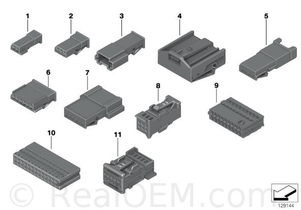

jochen 4 Report post Posted March 29, 2009 (edited) I know this post is gettin on, but i couldnt help notice a reference to "cable connections to Archos" in one of the diagrams, i have an Archos Av500 and if there is some way i could connect it to my e39 tv that would be awesome! Does anyone know anything about this? Yes, you can easily connect an Archos AV500, or any other device with AV-Out. Just connect the AV-Out of the AV500 to the AV-In on the BMW TV tuner. Your E39 won't have the AV inputs wired, so you'll have to fit the AV input wiring to the E39. The E39 AV-IN is mono, so just connect Left and Right audio together. Here's the pinout of the TV tuner: AV-IN is white connector, pins 4,5,6,& 15 Use an RCA cable, run it to whereever you want in the car, eg: glovebox. That's what I did. I had the RCA connectors (female) in the cavity where the fusebox is, then I just plugged in any RCA cable I wanted - in my case I used an iPod Video. Note also the presense of a Reverse Camera input - that's a cool feature to add :-) To get the pins for the TV tuner connector, use these ones: BUSHING CONTACT 61130005197 You can get the pins from BMW See also the parts list on RealOEM, the video module connector is item number 9: Edited March 29, 2009 by jochen Quote Share this post Link to post Share on other sites
