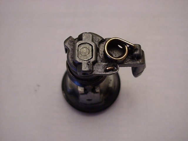

We got it to a stage where we had it locking but it wouldn't unlock from the drivers door, so we pulled it all out, reseated the spring and put it back together. Then the spring popped out, and now we can't even get it to lock.

Found an image on the net.
This is how we've been setting the locking spring, but we can't figure why it keeps popping out.
(reverse for the right hand side, but you get the idea)

This might be a bit late but heres a couple of photos of mine.
Key verticle
Key horizontal
It kinda turns inside inside out. Hard to describe.

I think that picture you put up is either upside down or a passenger door. Probably a yank drivers door?!?
