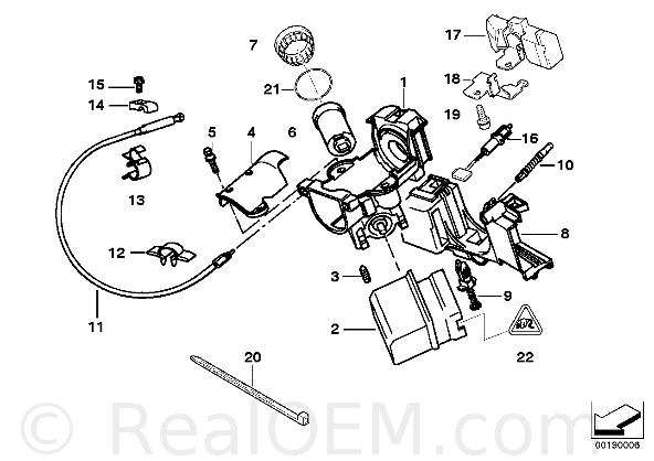

jochen 4 Report post Posted December 5, 2009 What sort of coin am I looking at, and would I need a new key or some sort of re=programming? Replace item #2: Part number and USD price here: http://www.realoem.com/bmw/showparts.do?mo...hg=32&fg=30 Plug and play, no new key or reprogramming required. Quote Share this post Link to post Share on other sites

camera doctor 25 Report post Posted December 29, 2009 Switch obtained from Brent, fitted today, so far so good. Did think that the T30 bolts holding the black plastic cage around the switch was a bit of German Overkill! Quote Share this post Link to post Share on other sites
