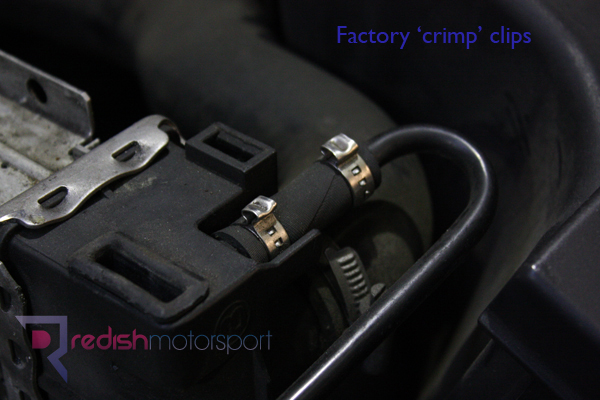

handgrenade 189 Report post Posted July 27, 2014 (edited) courtesy of some entertaining bimmersport members hazing the bmw newbie .. PS. world famous in NZPC. (thanks anthony) pps: no idea whats going on with my face in the pic. shocking. Edited July 27, 2014 by handgrenade Quote Share this post Link to post Share on other sites
