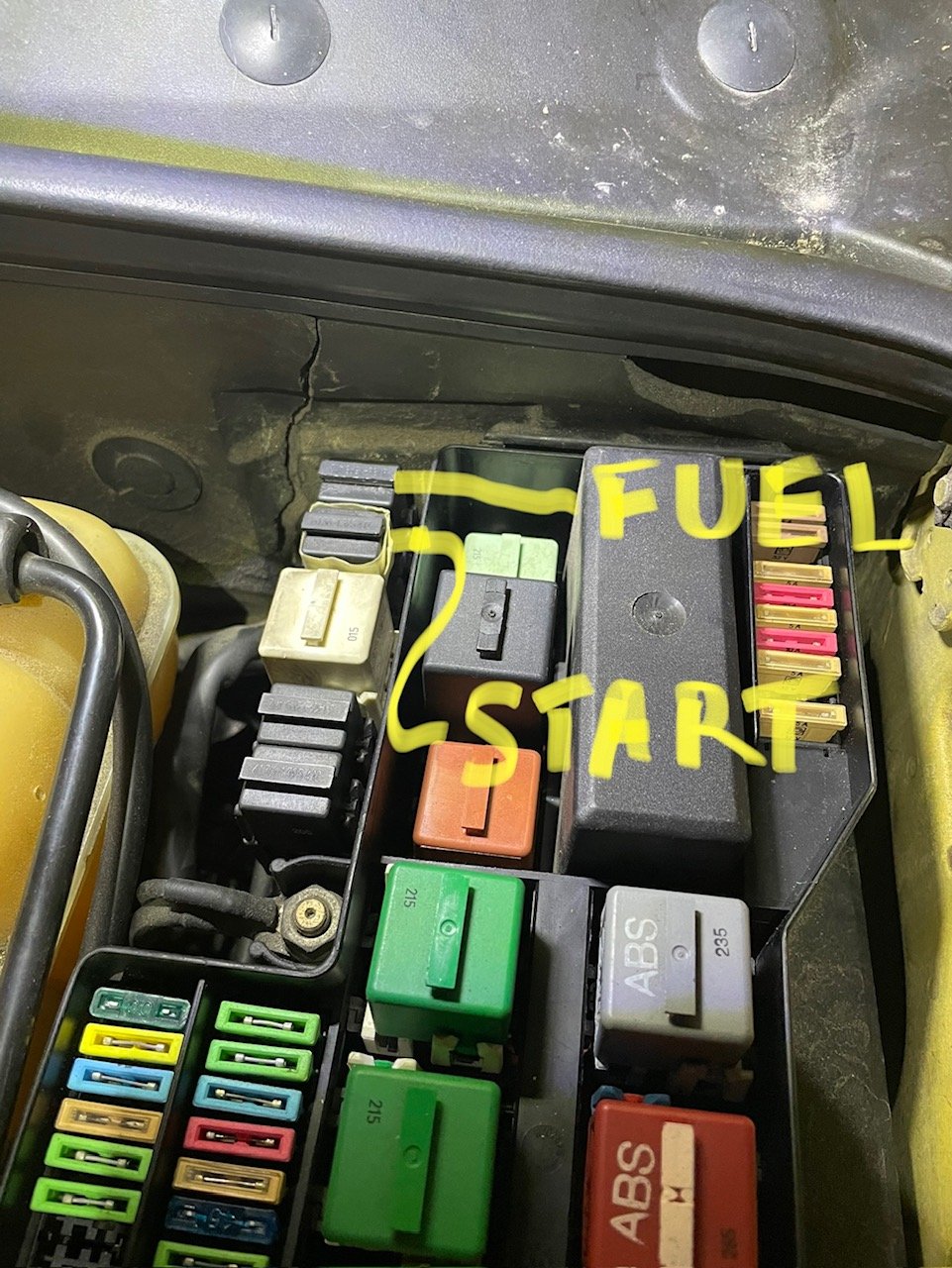

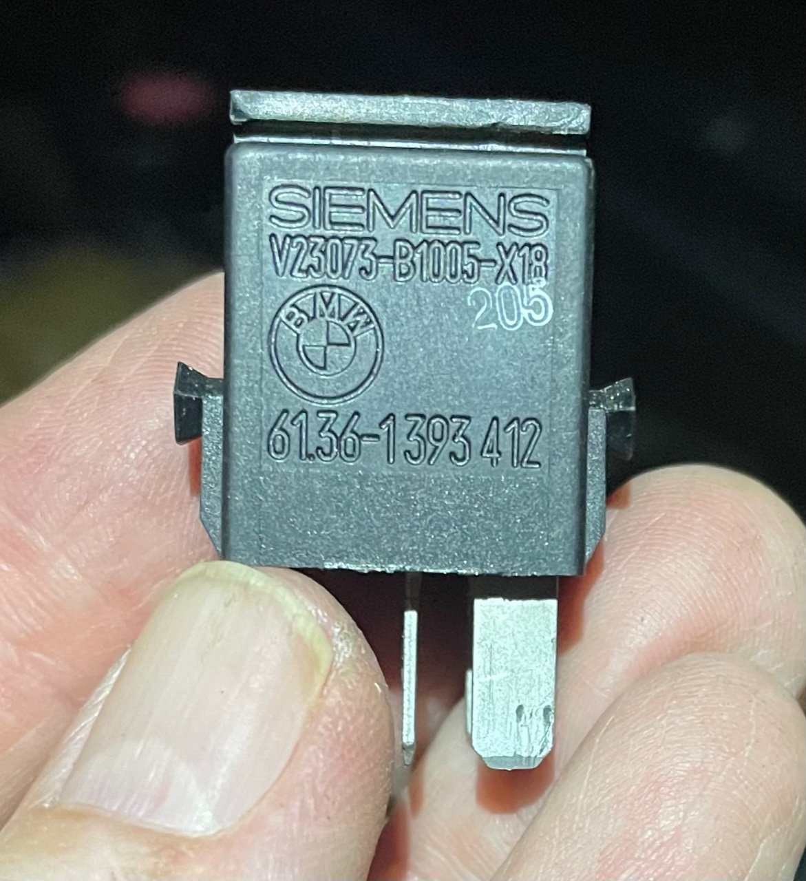

topnotchrally 171 Report post Posted April 27 (edited) Thanks Eagle for the tip. I found the immobilizer, it was fine 😞 The problem was the ‘start detection relay’. A small relay in the fuse box. The documentation is a bid sketchy. There are actually 2 relays, one for the fuel pump and one for the starter, the documentation only shows one relay. I figured out which was which with a volt meter and I put the fuel pump one in place of the starter one. The starter then worked but wouldn’t start... no fuel. I took the relay out of the my 523i ‘rear window’ (thanks REALOEM for the location help), put it in for the fuel pump and wa-la, starts and runs. 🙂 Something to get on my next run to Pick-a-part. Edited April 27 by topnotchrally 5 Quote Share this post Link to post Share on other sites
