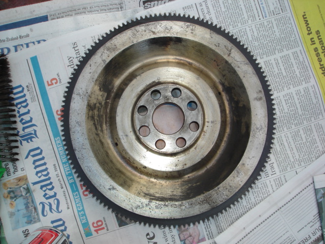

Guest Ari Gold Report post Posted April 6, 2009 I just traded my stock m20 flywheel to a guy at that works at the BMW dealer here with a track car, Said he can't use a lightened flywheel so offered me his lightened one for my stock one. Took it home and put it on the scales, reads a mere 4KG. I'm kind of scared to use it? M20 fly's aren't forged or a billet, I'd be careful. Just found a couple of before and after pics of mine: went from 19.6lbs to 13.5lbs Before: After: Pretty clear where the meat has been taken out. No drama after 5K kms or so. All the M20 8lb or so flywheels I've seen are alloy: http://www.kormanfastbmw.com/e30drive.htm http://store.nexternal.com/shared/StoreFro...reland&All= Quote Share this post Link to post Share on other sites
westy 614 Report post Posted April 6, 2009 (edited) Snap. Side Edited April 6, 2009 by westy Quote Share this post Link to post Share on other sites
