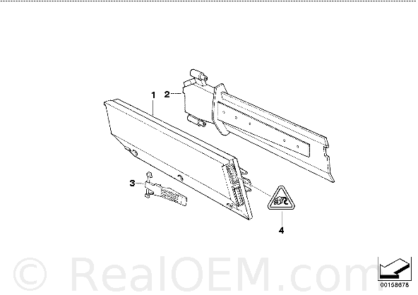

Mike.Gayner 0 Report post Posted May 6, 2009 Yesterday I was using the heater in my car as usual, and when I pulled into the driveway I switched it off, but it didn't switch off. What appears to be happening is that the fan stays on but all the vents close, so the air is forced through a small gap in the windscreen vent, creating quite a loud, high pitched (almost whistling) noise. Otherwise the heater/AC is working fien - the fan and temperature variables are working in good order. Is this is known issue? Anyone know a simple fix? Thanks. Attached is a picture of the same heater that's in my car. Quote Share this post Link to post Share on other sites

Guest Simon* Report post Posted May 6, 2009 This is using my serial number Mike but it is the same vintage E34 Part 2 in this diagram Quote Share this post Link to post Share on other sites
Mike.Gayner 0 Report post Posted May 6, 2009 Is that price correct? $517.82 Quote Share this post Link to post Share on other sites
Guest Simon* Report post Posted May 6, 2009 I didn't pay that much! That's Euros too - pretty scary Try the parts people, Euro-Italian, BM Warehouse, etc and Ray (HellBM) and Brent above too Quote Share this post Link to post Share on other sites
