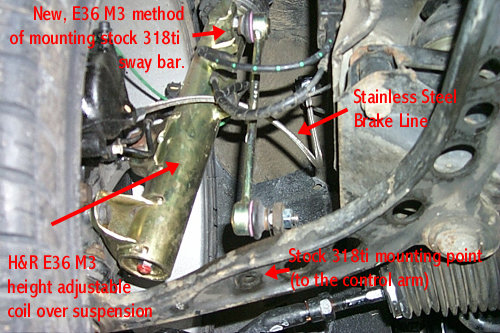

tibbs.james 1 Report post Posted May 14, 2010 bit of a hijack I know but can somebody provide a decent photo of the strut Mount Swaybar setup ? Quote Share this post Link to post Share on other sites
thorburn 123 Report post Posted May 14, 2010 (edited) http://www.uucmotorwerks.com/html_project/...g/sway_bar2.jpg Is there any clearance issues if using an e36ti sway bar (25mm one) on a 6 cylinder? does anyone use adjustable endlinks for adjusting the preload on the bar? Edited May 14, 2010 by bbs Quote Share this post Link to post Share on other sites
