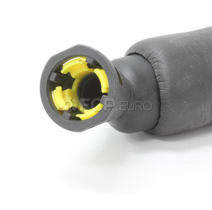

325_driver 422 Report post Posted July 28, 2019 (edited) I think the crank return CCV is on. Worst case if it's not on properly oil leakage down there? There's no vaccum down there aye? Edited July 28, 2019 by 325_driver Quote Share this post Link to post Share on other sites
B.M.W Ltd 951 Report post Posted July 28, 2019 The crank return hose must be fitted correctly. For the system to work properly ALL components need to be fitted correctly. Quote Share this post Link to post Share on other sites
Jacko 2399 Report post Posted July 28, 2019 36 minutes ago, 325_driver said: I think the crank return CCV is on. Worst case if it's not on properly oil leakage down there? There's no vaccum down there aye? You mean the difficult one at the sump? It'll make a snap when its on correctly, and it wont pull off without releasing the tabs. Quote Share this post Link to post Share on other sites
