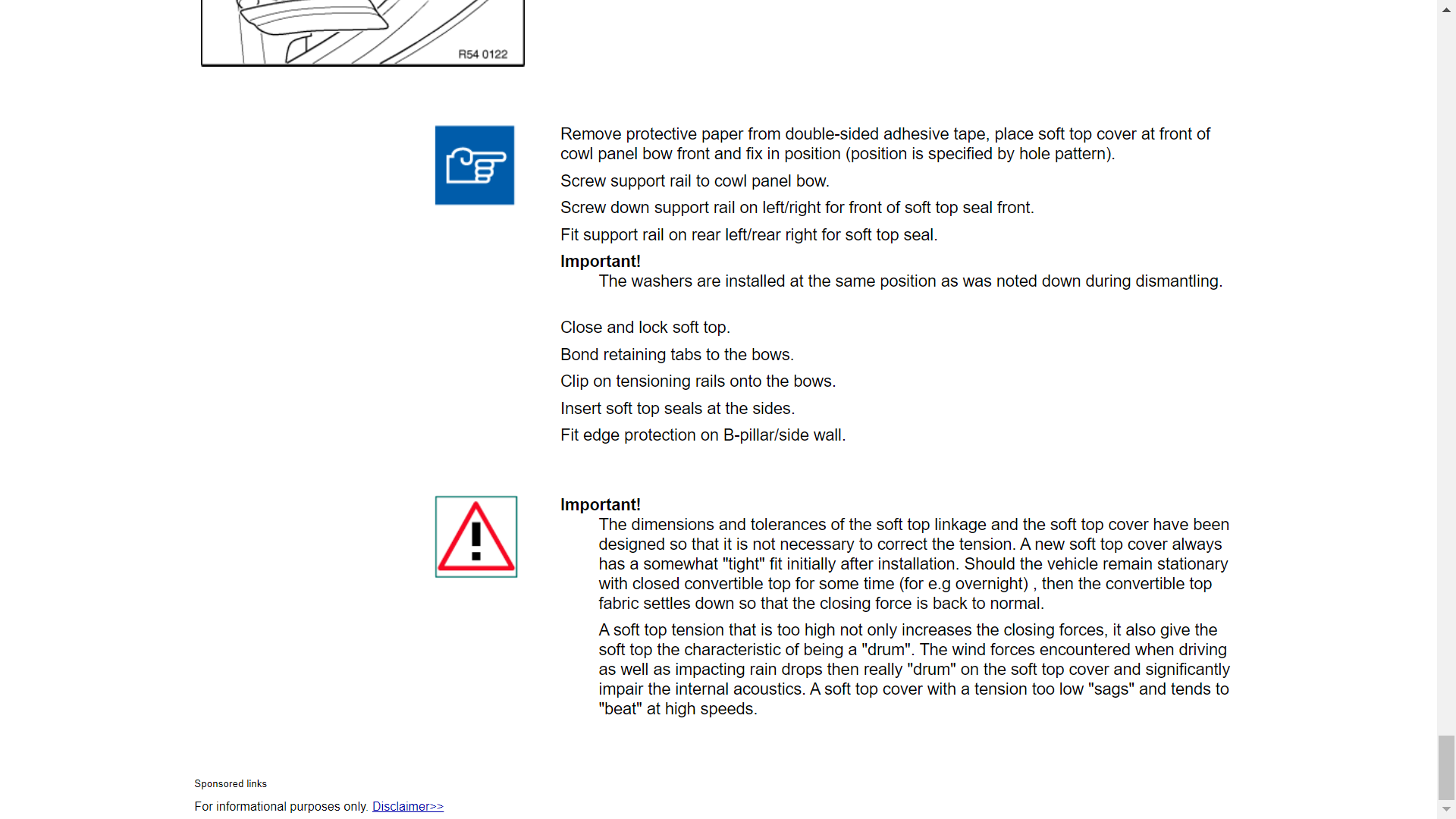

M3AN 4199 Report post Posted December 2, 2020 This isn't going to be helpful but... You live in Queenstown, it's summer, you have views like that. Forget the top! Park it up inside during winter. 😉 This might be more helpful... BMW's instructions... increment the file name from 01 up to 15 First: https://www.davesanthology.com/public/images/automotive/random_pics/Z3_Soft_Top/01.png Last: https://www.davesanthology.com/public/images/automotive/random_pics/Z3_Soft_Top/15.png Of course any BMW main dealer will also be able to do it for you but I'm not sure if there's one in Queenstown or the cost. Quote Share this post Link to post Share on other sites
joeyguse 0 Report post Posted December 2, 2020 36 minutes ago, M3AN said: This isn't going to be helpful but... You live in Queenstown, it's summer, you have views like that. Forget the top! Park it up inside during winter. 😉 This might be more helpful... BMW's instructions... increment the file name from 01 up to 15 First: https://www.davesanthology.com/public/images/automotive/random_pics/Z3_Soft_Top/01.png Last: https://www.davesanthology.com/public/images/automotive/random_pics/Z3_Soft_Top/15.png Of course any BMW main dealer will also be able to do it for you but I'm not sure if there's one in Queenstown or the cost. Thanks for that. And yes, I'm currently following your advice and enjoying the summer! Thanks for the pics. That's helpful. Dunedin might be a possibility. Quote Share this post Link to post Share on other sites
