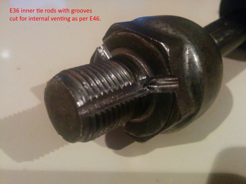

jom 98 Report post Posted April 17, 2023 My 328i Coupe has just failed a WoF for "worn tie rod" on the right hand side. It isn't worn, but the rack teeth are worn around the straight ahead position. I have tried to source a good E36 rack, but there don't seem to be any guaranteed ones available. so - E46 racks are more plentiful, but then I need to machine grooves in the inner E36 tie rod for pressure equalisation between the rack boots. Lots of info on the web about doing it ("took it to my local machine shop") but I can't find the details of what to do anywhere. I can cut the slots on my own mill if I could only find a diagram. Can anyone help? Quote Share this post Link to post Share on other sites

M3AN 4195 Report post Posted April 18, 2023 Here's what you need to do if you keep your e36 inners: You can alternatively use e46 inners that already have the vents, you lose some lock doing this because they're slightly longer (although some manufacturers, I can't recall which, have them the same length). The amount of lock you lose is negligible. On the other had, the work above cost me like $20 which was less than I'd pay for e46 inners. 1 Quote Share this post Link to post Share on other sites
jom 98 Report post Posted April 18, 2023 9 minutes ago, M3AN said: Here's what you need to do if you keep your e36 inners: You can alternatively use e46 inners that already have the vents, you lose some lock doing this because they're slightly longer (although some manufacturers, I can't recall which, have them the same length). The amount of lock you lose is negligible. On the other had, the work above cost me like $20 which was less than I'd pay for e46 inners. Brilliant, thanks Dave. To the point and pictures too! I already have one rack inner, so I'll buy another one and machine the grooves. Now where was that 2mm ball nose cutter...? Quote Share this post Link to post Share on other sites
