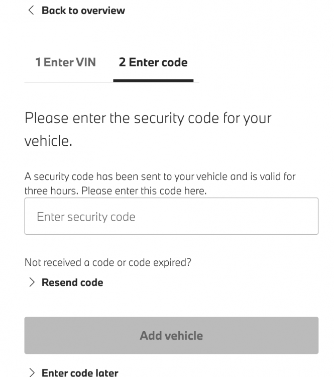

MoBMW530e 0 Report post Posted May 13 (edited) Hi, i'm in Ireland and my car is a 2017 bmw 530e i have been trying to add it to mybmw app for over a year and couldn't, when i add the vin in the app it says a code will be sent to the car but since the sim doesn't work in Ireland i never get the message but i came by this post which says it works, what am i missing, any help would be appreciated ? update: tried a Japanese address for my profile but i get asked for code when i try to add my car Edited May 13 by MoBMW530e Quote Share this post Link to post Share on other sites
Caityf 0 Report post Posted May 22 On 5/13/2025 at 9:04 PM, MoBMW530e said: Hi, i'm in Ireland and my car is a 2017 bmw 530e i have been trying to add it to mybmw app for over a year and couldn't, when i add the vin in the app it says a code will be sent to the car but since the sim doesn't work in Ireland i never get the message but i came by this post which says it works, what am i missing, any help would be appreciated ? update: tried a Japanese address for my profile but i get asked for code when i try to add my car I’m in Ireland and just bought a Japanese import. Had to change the country on the app in order to register on the my BMW app. I had to enter this code also. You have to go into connected drive on your panel in the car. Select menu, connected drive, messages and you should have a message there with your code on it. Hope this helps :) Quote Share this post Link to post Share on other sites
