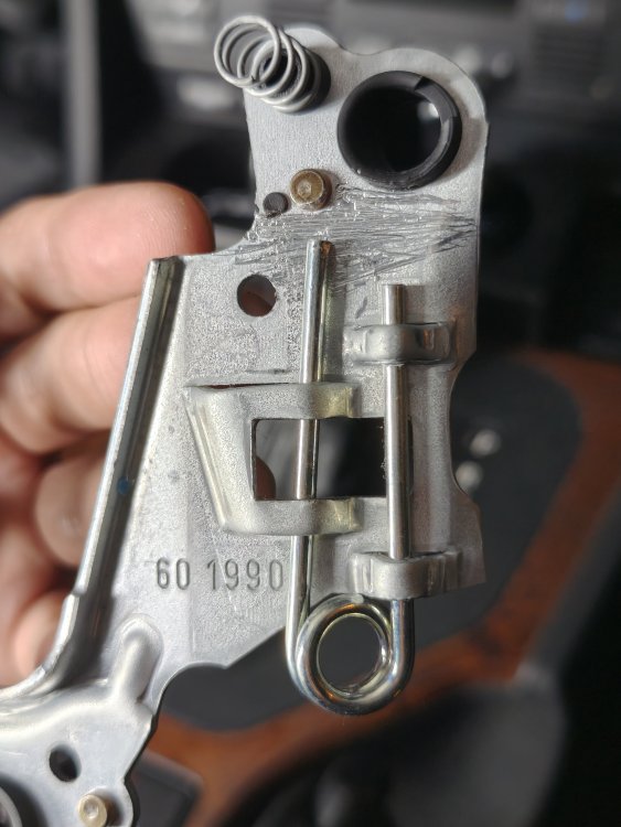

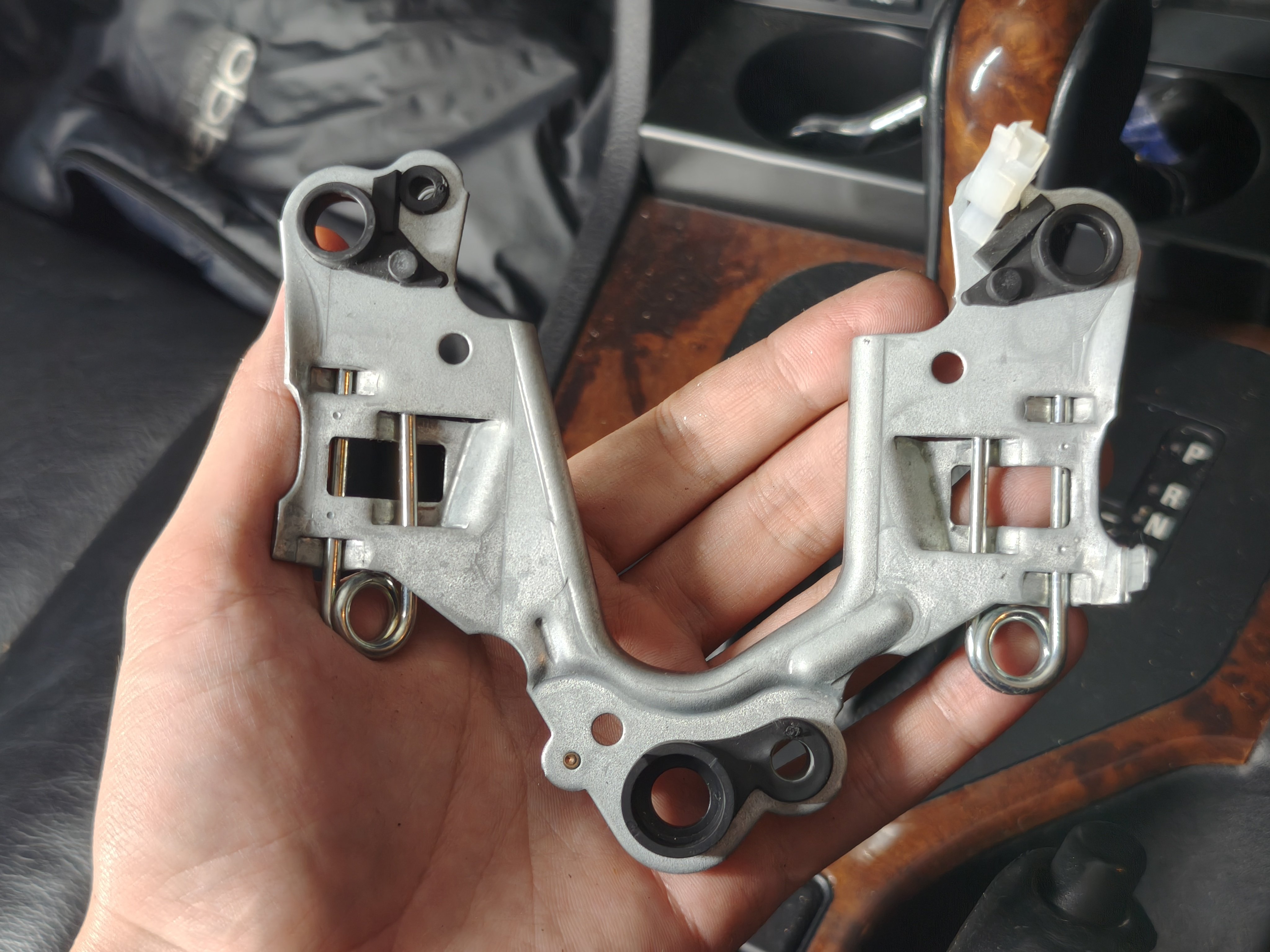

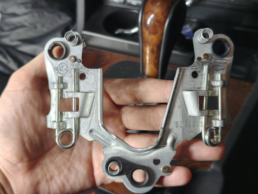

Noamit 4 Report post Posted February 12 My E39 530i won't stop honking. From the moment I turn the key, which is as soon as it can, the car will honk continuously. It initially started as intermittent honking. Once it starts, it wouldn't stop until I press the honk. I took off the airbag to see if I can see anything strange underneath, but my untrained eyes didn't catch anything. Once I put it back, the issue got worse and now it's basically always honking, making the car undrivable. I was told to remove the immobiliser fuse and see if that continues. I'll do that, but what else can I do while I'm at it to diagnose this issue? Thanks 1 Quote Share this post Link to post Share on other sites
BM WORLD 1295 Report post Posted February 12 maybe broken twisted wires in the slip ring or bent horn plate ? has airbag gone off ever? original sw? Quote Share this post Link to post Share on other sites

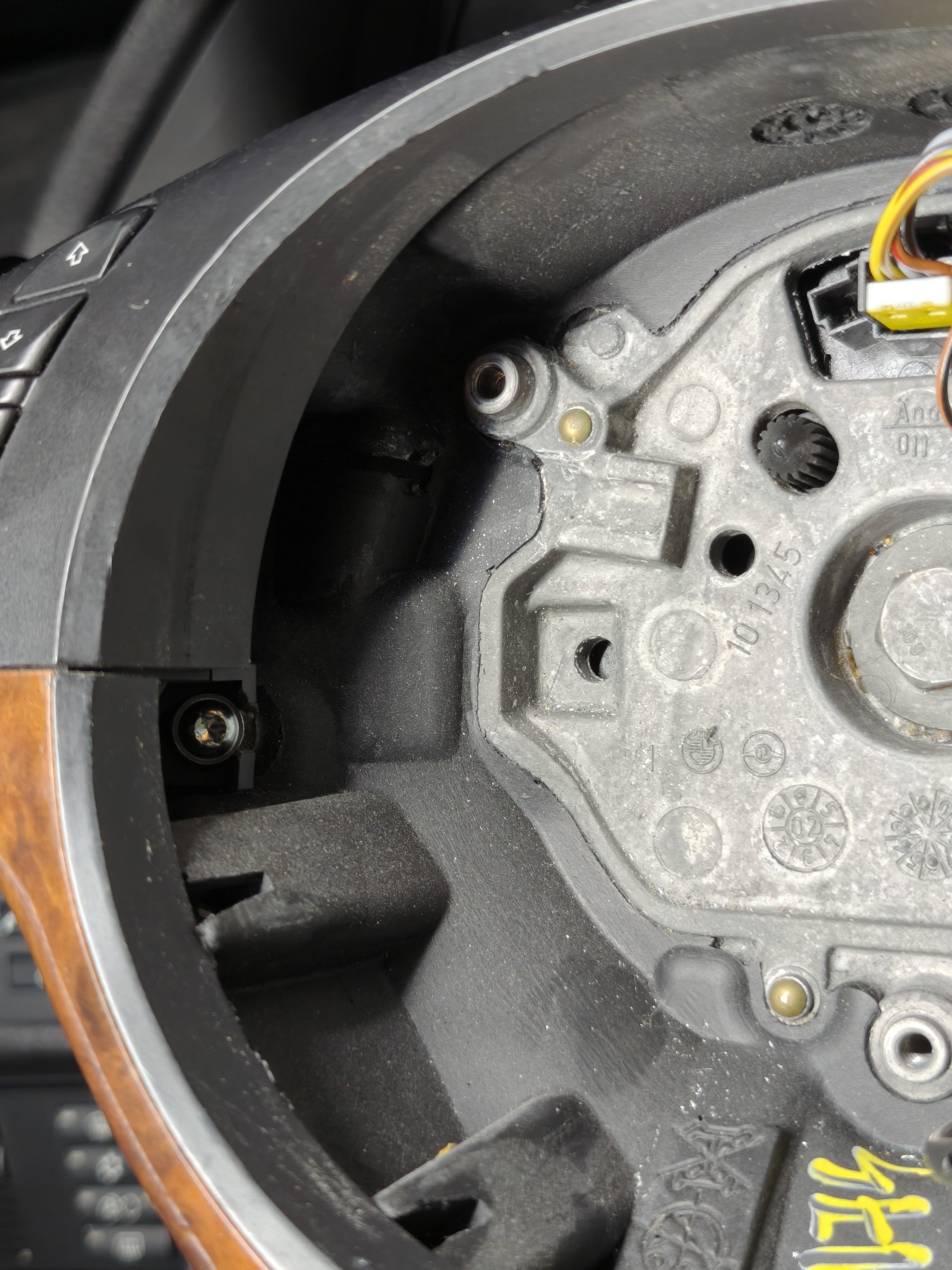

Noamit 4 Report post Posted May 26 So after much neglect I came back to this car to do a little more investigation and... didn't get far, The only new discovery is that the horn DOES honk even if the airbag and horn is removed from the steering wheel. What could that mean? Some grounding issue? Quote Share this post Link to post Share on other sites

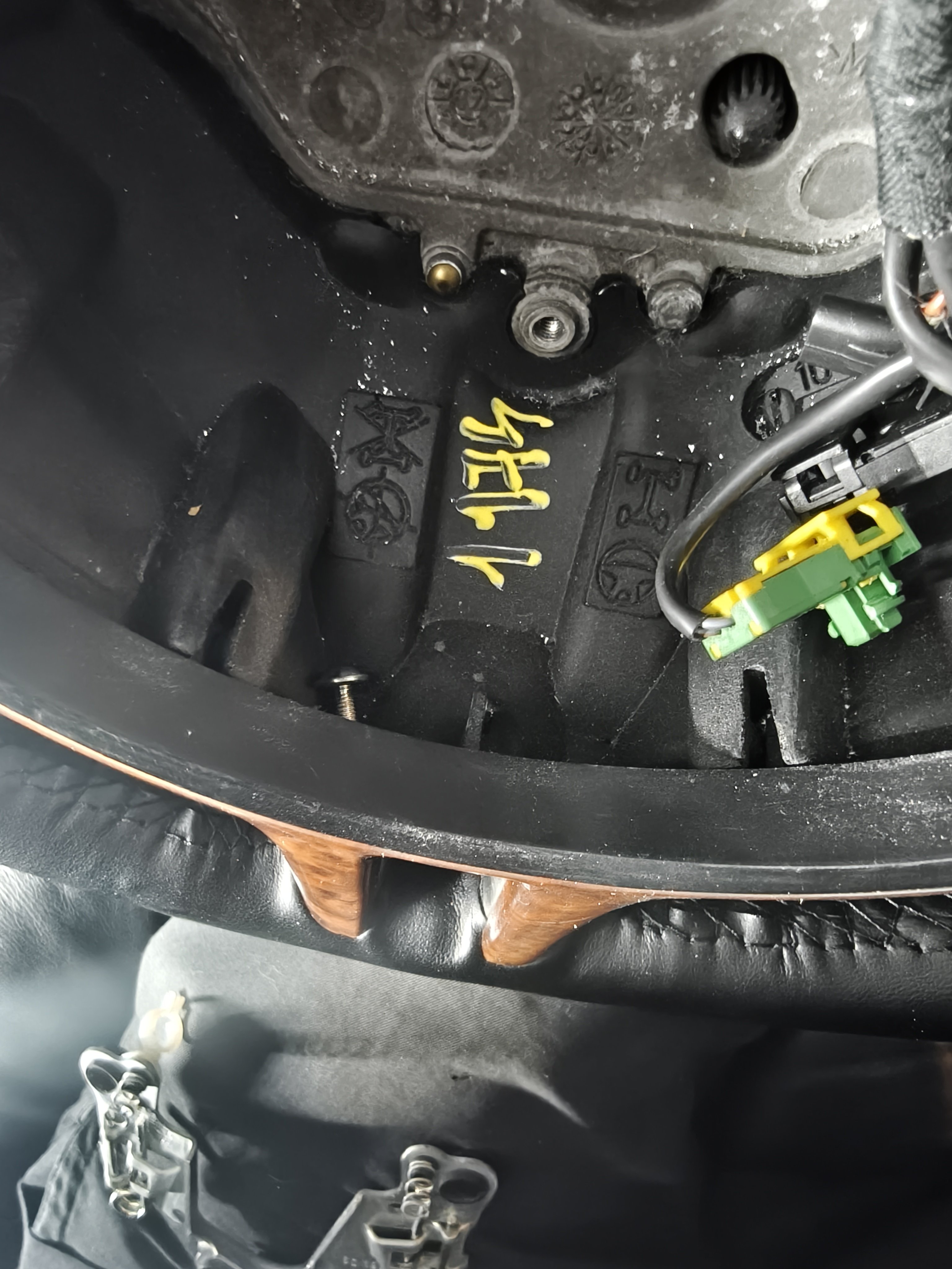

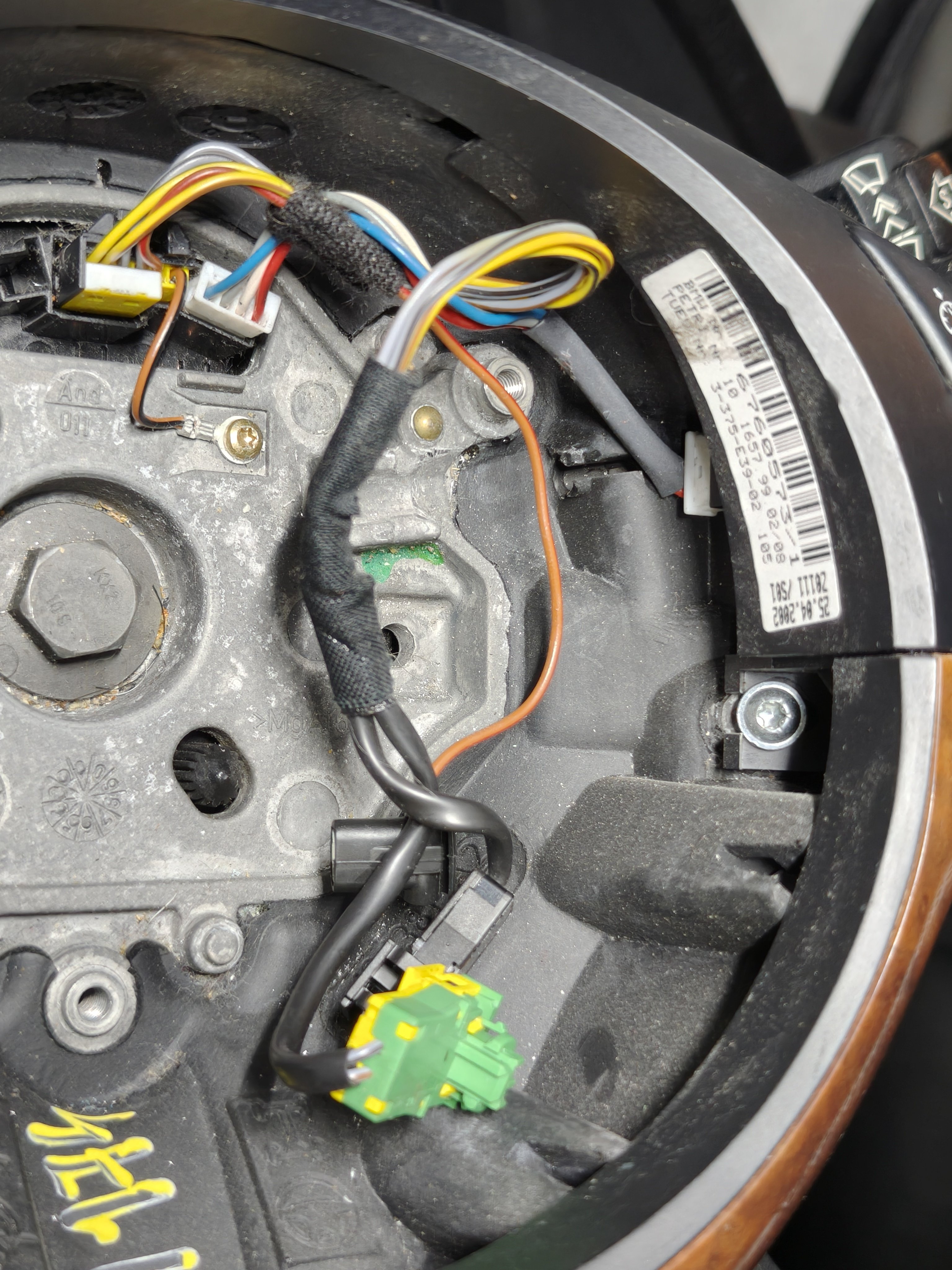

Eagle 1773 Report post Posted May 26 For starters the 3rd photo shows a missing torx screw on the LHS, don't know where that is gone, are you sure there is nothing stuck on the in between the horn plate? Failing id re-seat all the connections and the ground, then there should be a connector under the lower steering wheel shroud the goes to the clock spring, if you disconnect that and it stops then its clock spring, wheel or wiring issue in the steering wheel area. 1 Quote Share this post Link to post Share on other sites

Noamit 4 Report post Posted June 5 I tried looking up the horn relay location but I couldn't find it... Does 530i have them? If so, where can I find it? On 5/26/2025 at 3:25 PM, Eagle said: For starters the 3rd photo shows a missing torx screw on the LHS, don't know where that is gone, are you sure there is nothing stuck on the in between the horn plate? It fell to the bottom of the wheel! Thanks for spotting it. It's back in its place now. I couldn't do much today but on the weekend I'll try re-seating the connectors Eagle mentioned and see how I go. Thanks 🙏 Quote Share this post Link to post Share on other sites

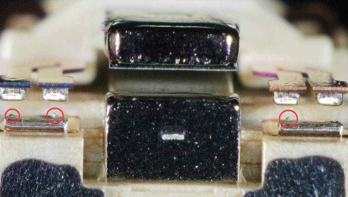

Driftit 2204 Report post Posted June 25 Awesome. Good to hear you sorted it. The relay may have had too much current drawn through it at some stage. It can cause the contacts to arc and build up little bits of metal which can catch or be so close that they touch when there is vibration present. I have just been dealing with this at work. Found a 100-150mA draw that was being caused by this relay being both closed and open. This is super magnified as the relay is only about the size of your little finger nail. But you can see the build up. Quote Share this post Link to post Share on other sites
