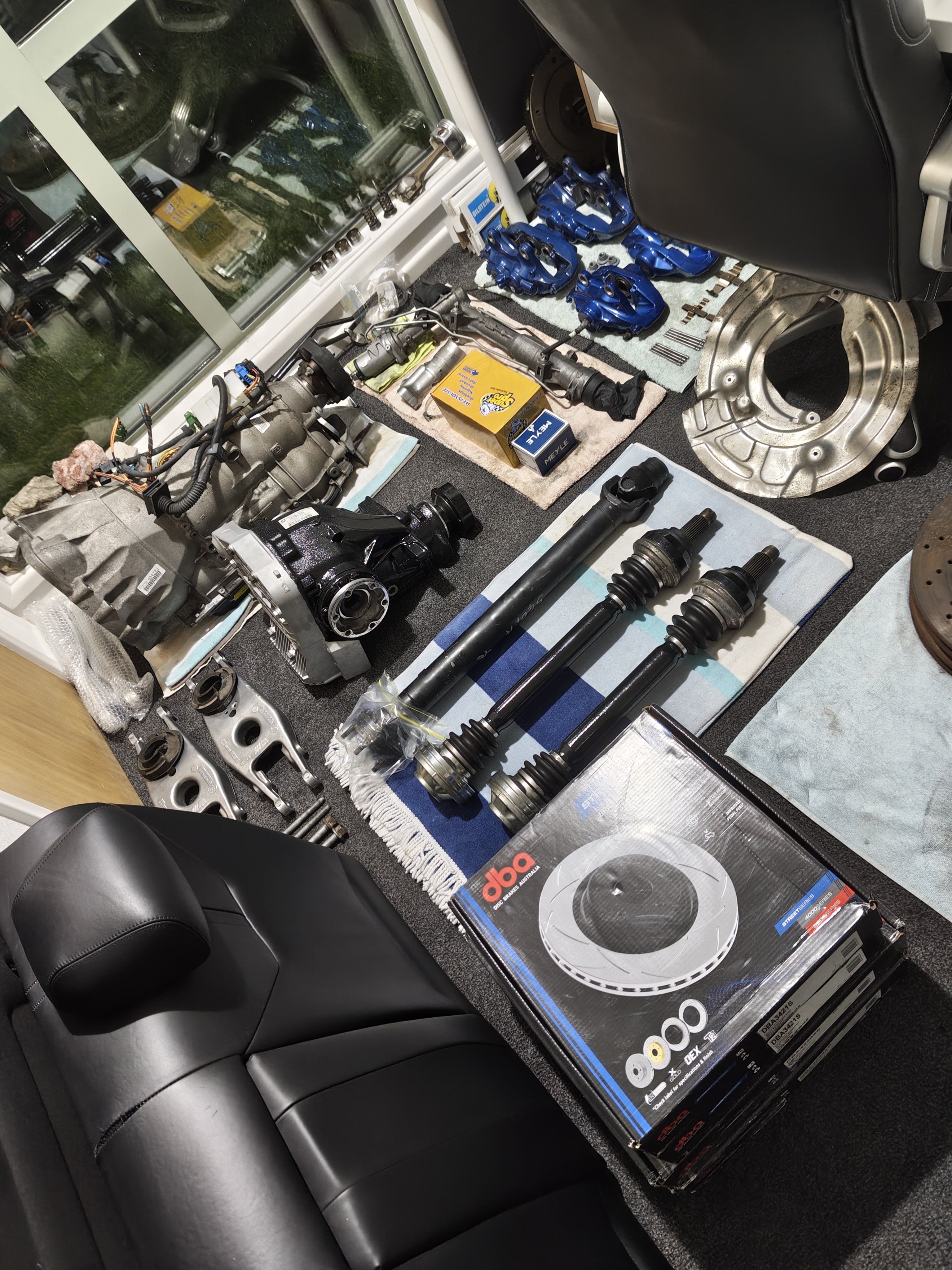

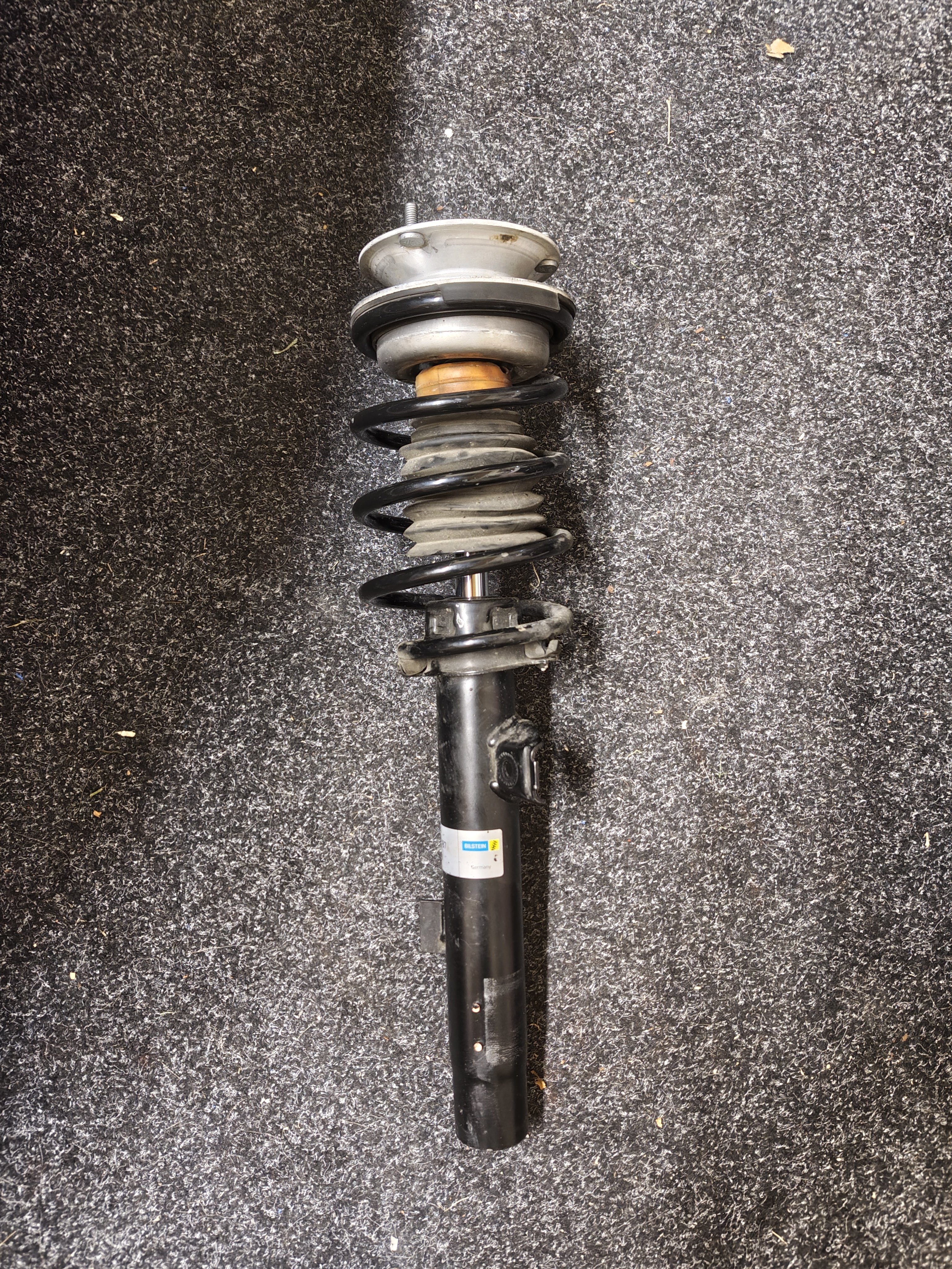

Hutty008 61 Report post Posted July 2 And these are some of the part that I have been collecting this year and it will my job to install over the next 2-3 months ready for summer. Main things with be an M3 LSD, axles, steering rack, rear subframe, rear spring arms and some M3 coilovers. Along with f8x m2 brakes a GM to 6hp21 swap just to name a few. 6 Quote Share this post Link to post Share on other sites

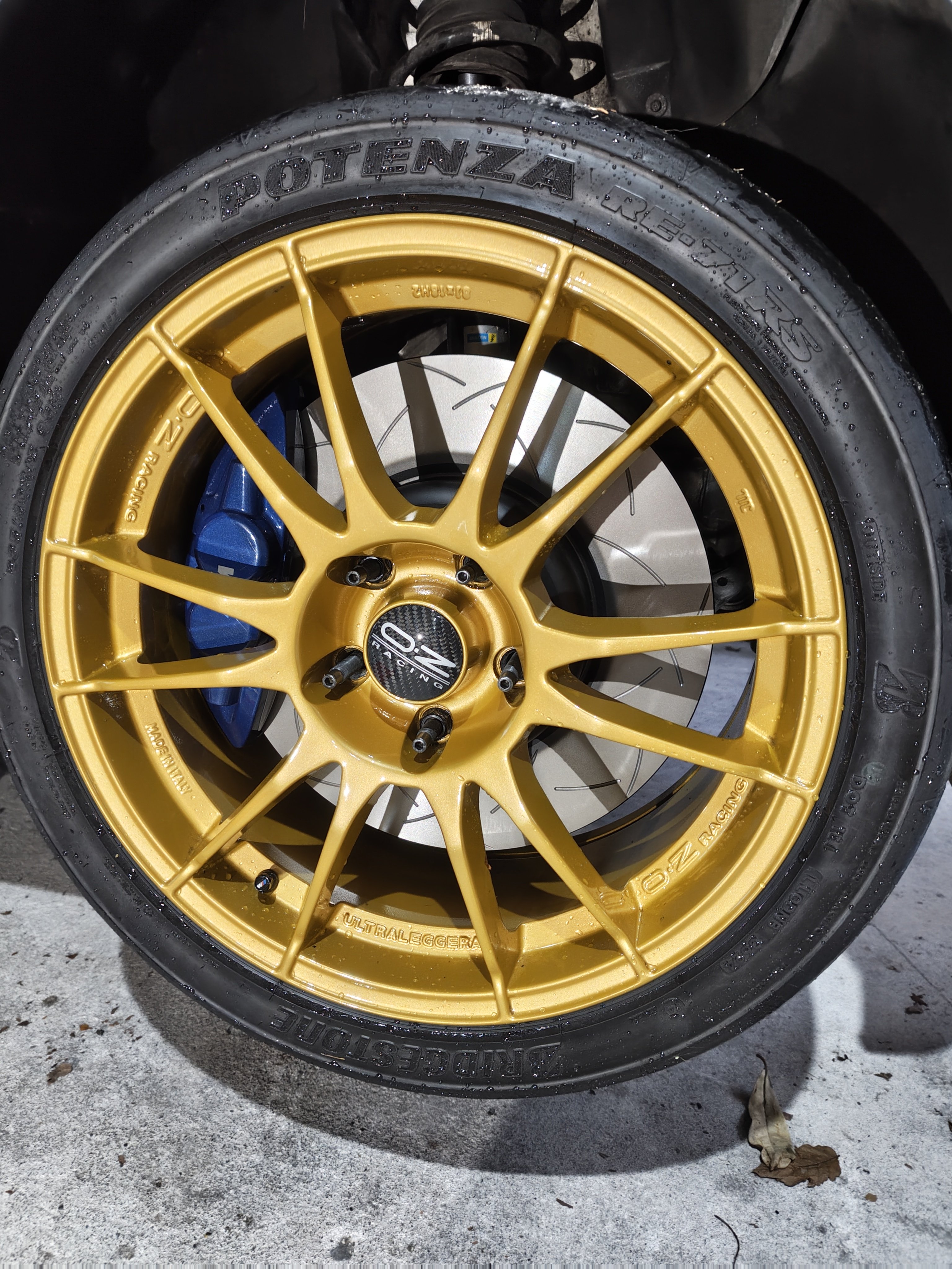

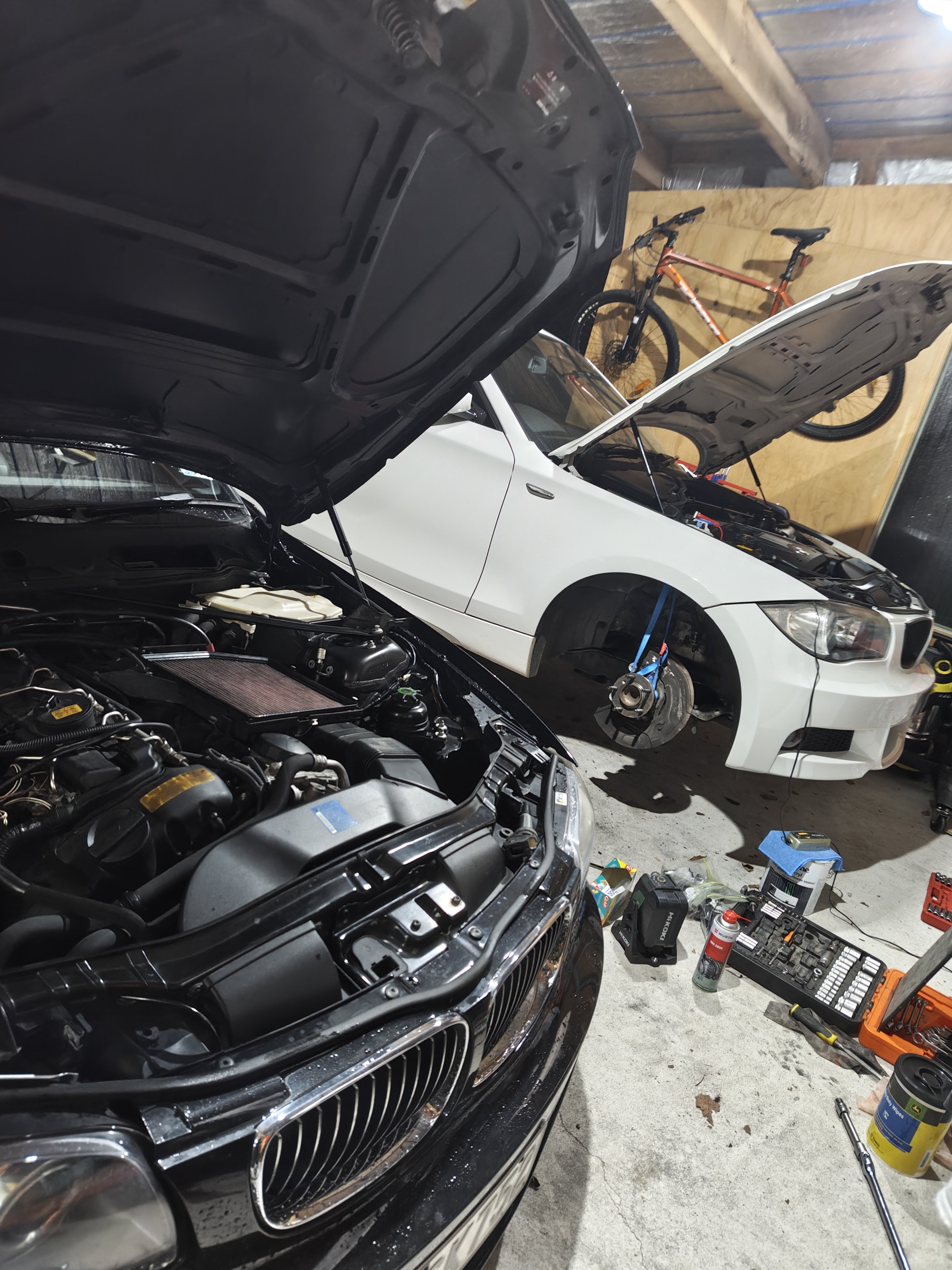

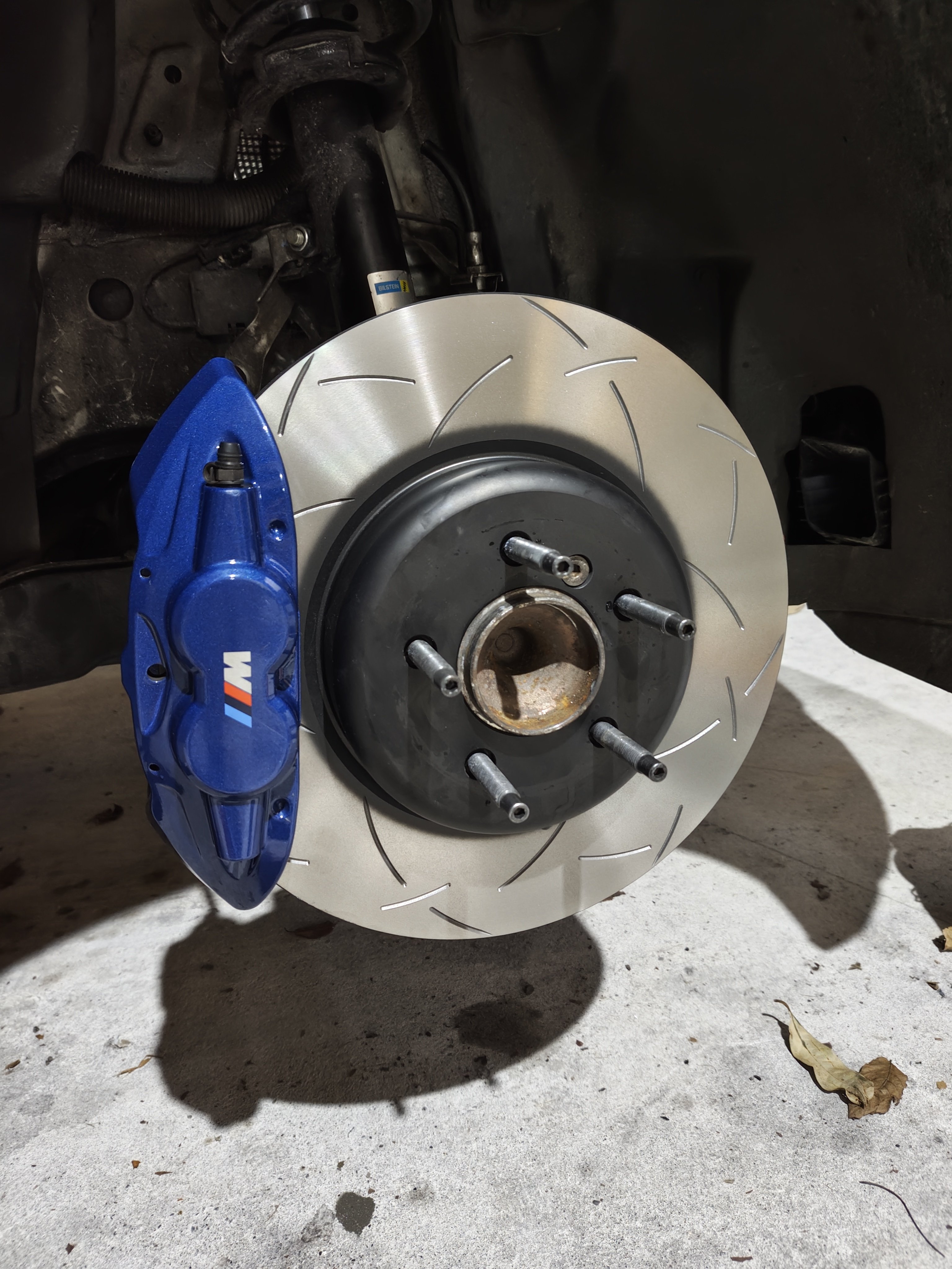

Hutty008 61 Report post Posted July 3 Started getting the shocks and brakes off today, also test fitted the f8x brakes while I still had the chance. Next time this car rolls under it own power it going to be a completely different car. Its going to take a while but it will be worth the wait. 5 Quote Share this post Link to post Share on other sites

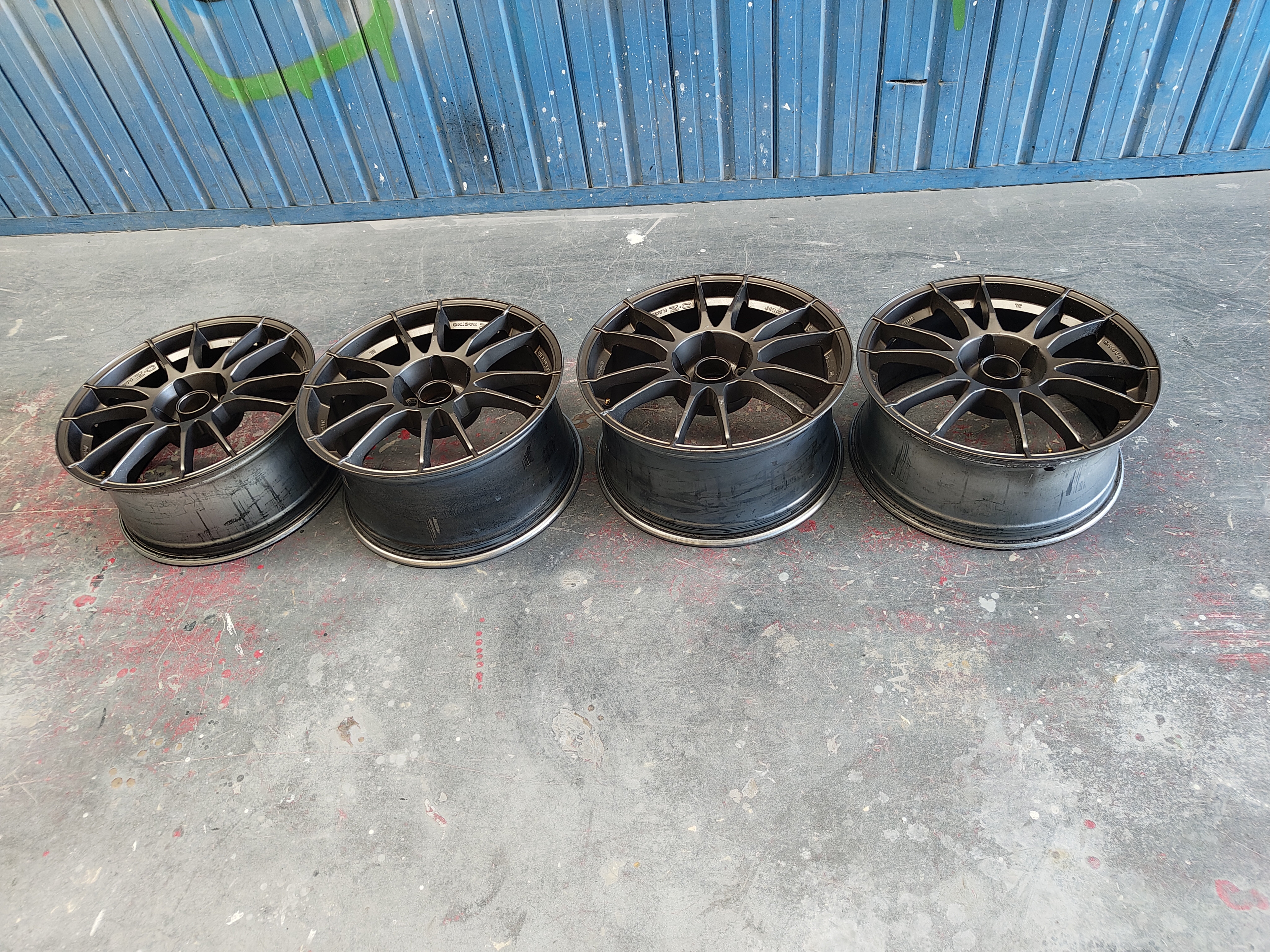

M3AN 4189 Report post Posted July 3 F'ing love those wheels. 4 Quote Share this post Link to post Share on other sites
BreakMyWindow 1995 Report post Posted July 4 Awesome car! How much do those wheels weigh? Quote Share this post Link to post Share on other sites
Hutty008 61 Report post Posted July 5 11 hours ago, BreakMyWindow said: Awesome car! How much do those wheels weigh? They are a staggered set 8 inch front and 9 inch rear, I weighed them when the tyres where off for painting and they were roughly 8.8kg for the fronts and 9.5kg for the rears 1 Quote Share this post Link to post Share on other sites
BreakMyWindow 1995 Report post Posted July 5 5 minutes ago, Hutty008 said: They are a staggered set 8 inch front and 9 inch rear, I weighed them when the tyres where off for painting and they were roughly 8.8kg for the fronts and 9.5kg for the rears Decent bit of weight savings, at least with the style 207’s. What’s your experience with temps on the track? Just fitted an LCI cluster to mine so i can back off when it gets to north of 130. Quote Share this post Link to post Share on other sites

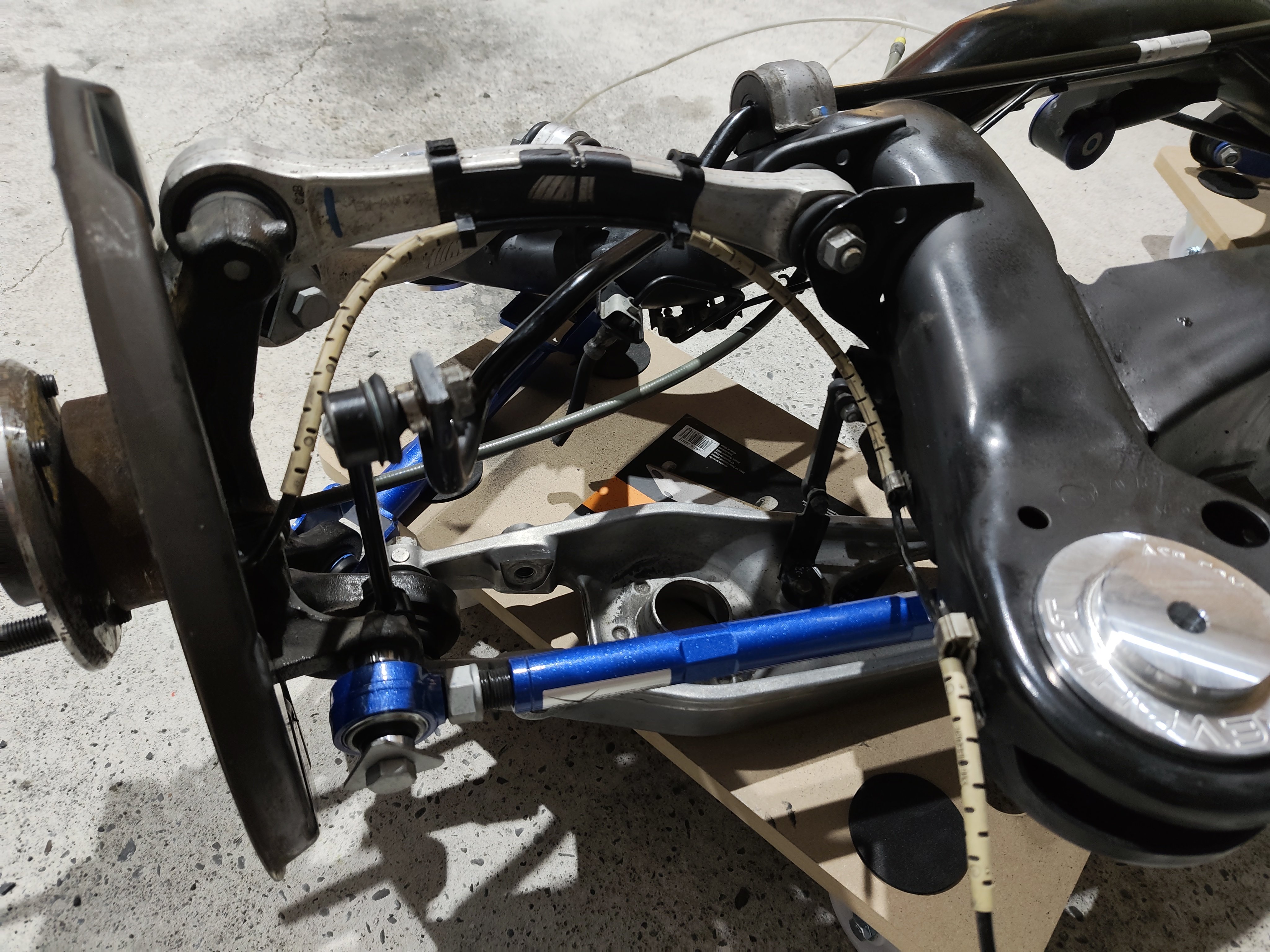

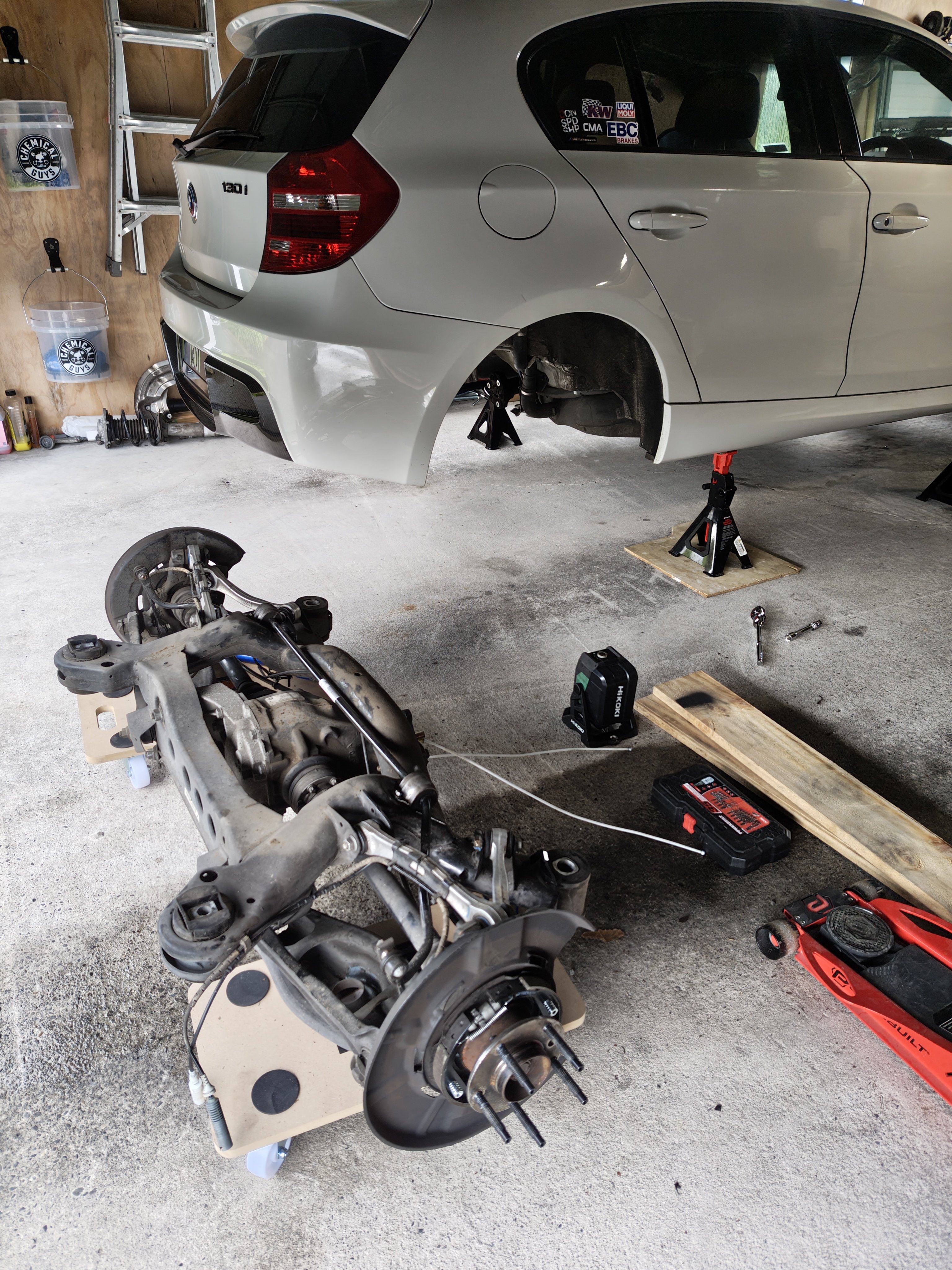

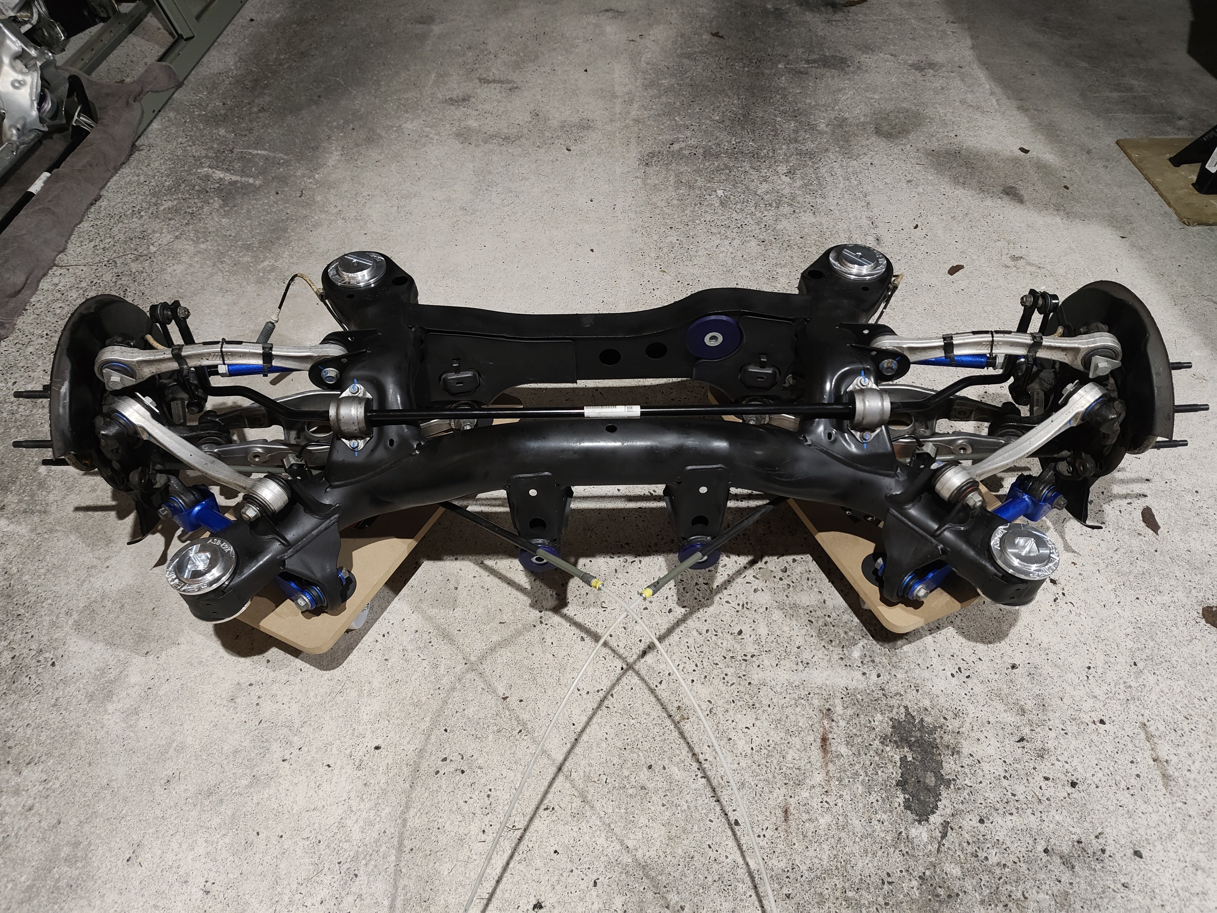

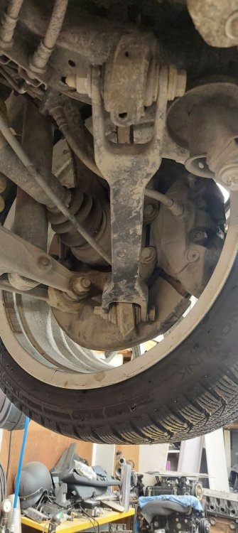

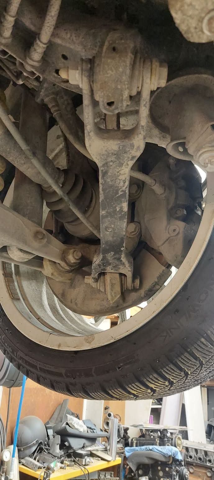

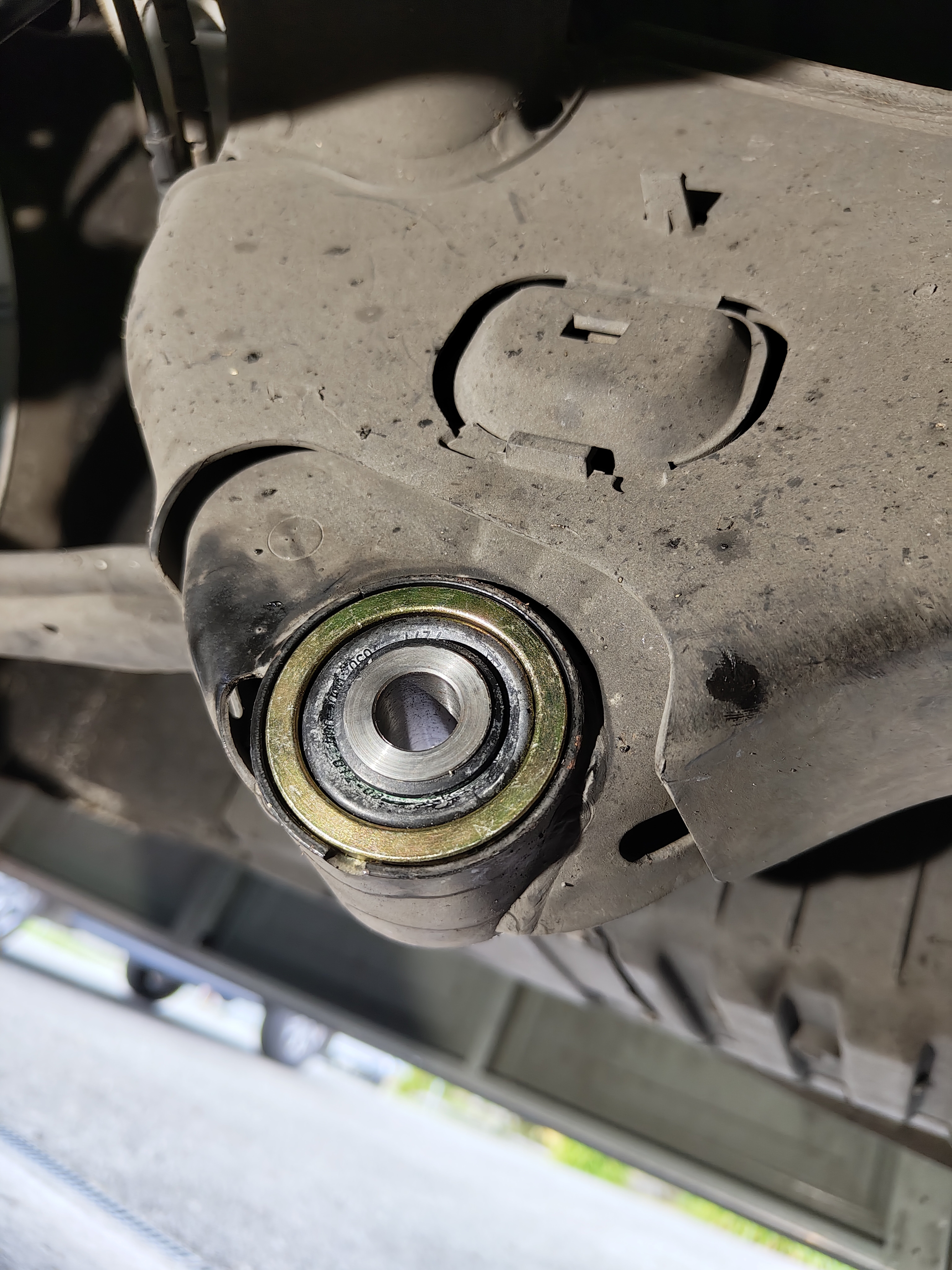

Hutty008 61 Report post Posted July 15 Dropped the subframe today. I decided last week to stay with the non-m subframe as the trailing arm mounts on a slightly different angle, it would be ok as in putting ball joints into there but just doesn't sit right with my OCD ( can be seen in the photo below ). As such I order some hardrace toe arms instead of using the M3 ones. Next step is to install the aluminum subframe bushing which should turn up tomorrow, replace the diff bushings, install hardrace toes arms with eccentric lockout, replace the trailing rubber bushings with ball joints and install the m3 spring arms ready for m3 shocks. Should make for the perfect rear end, fully ball joints and solid subframe bushings. 5 Quote Share this post Link to post Share on other sites

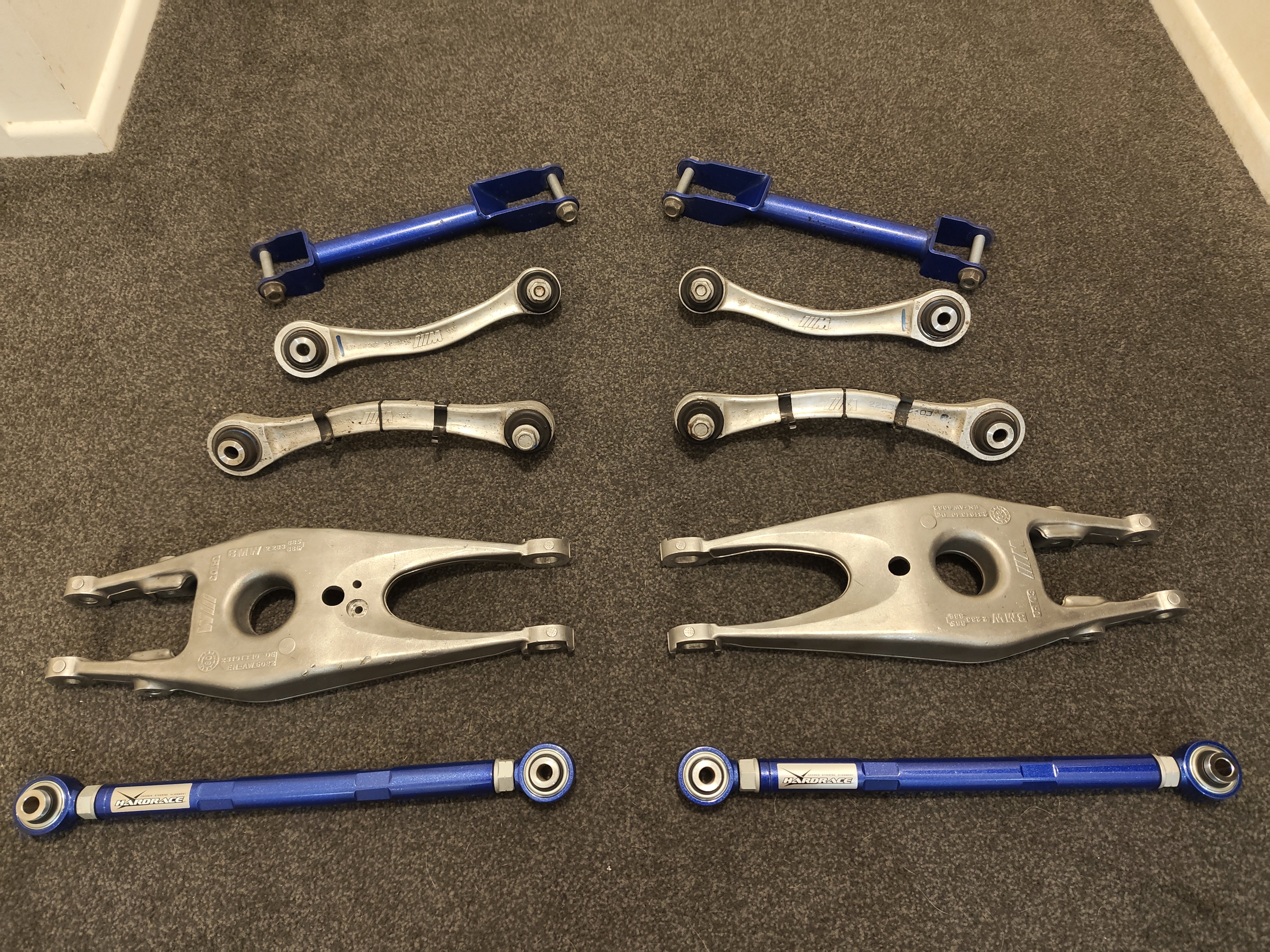

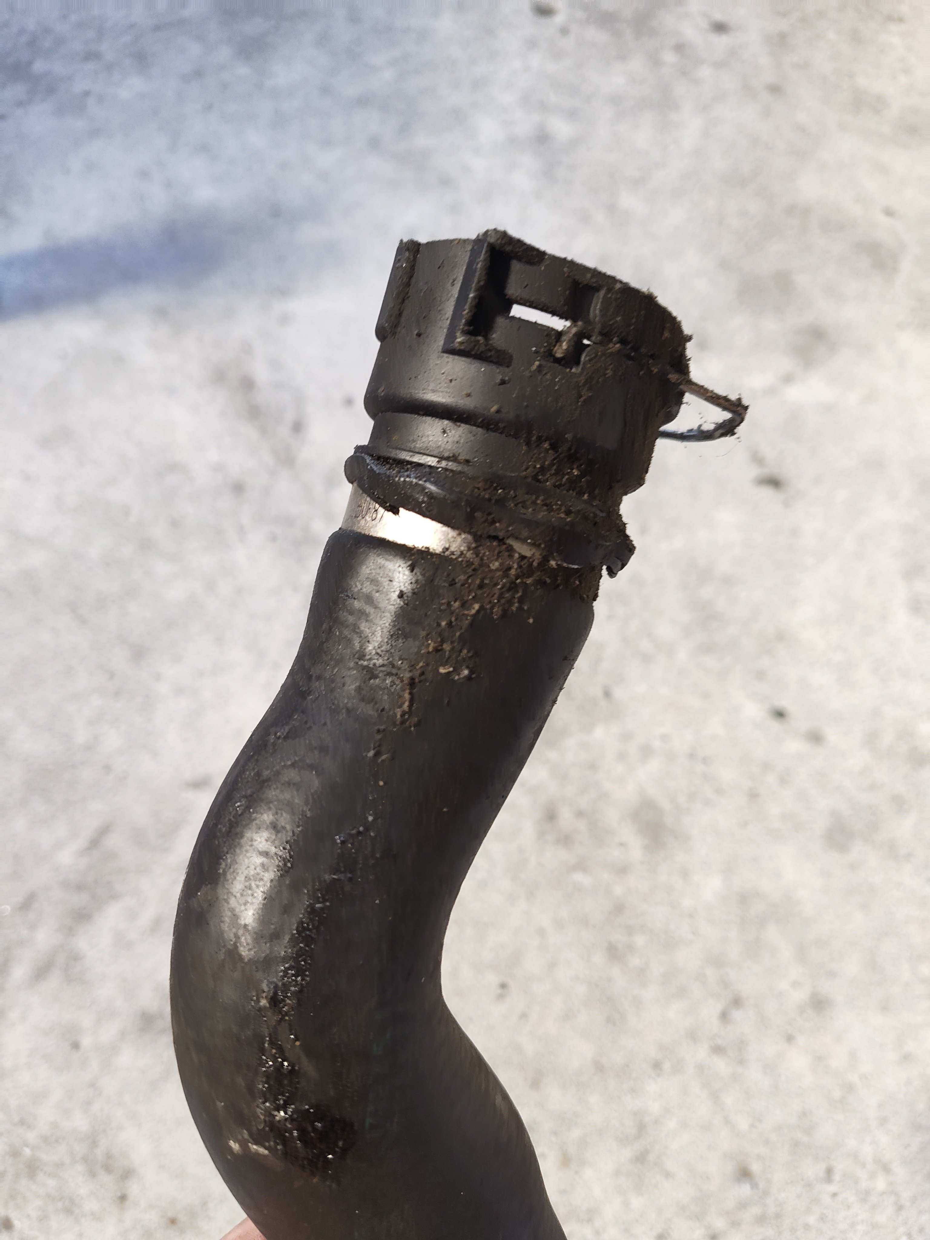

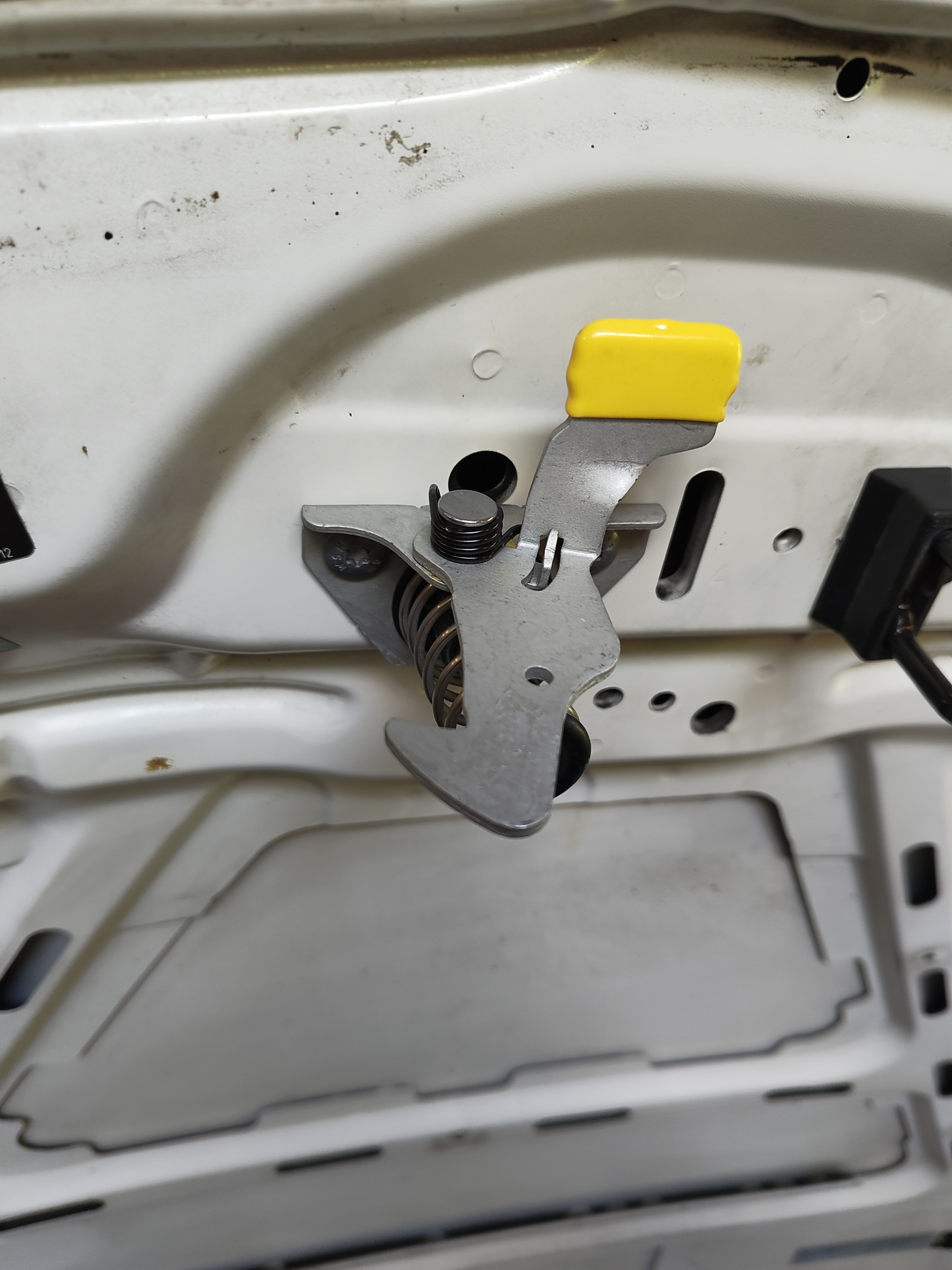

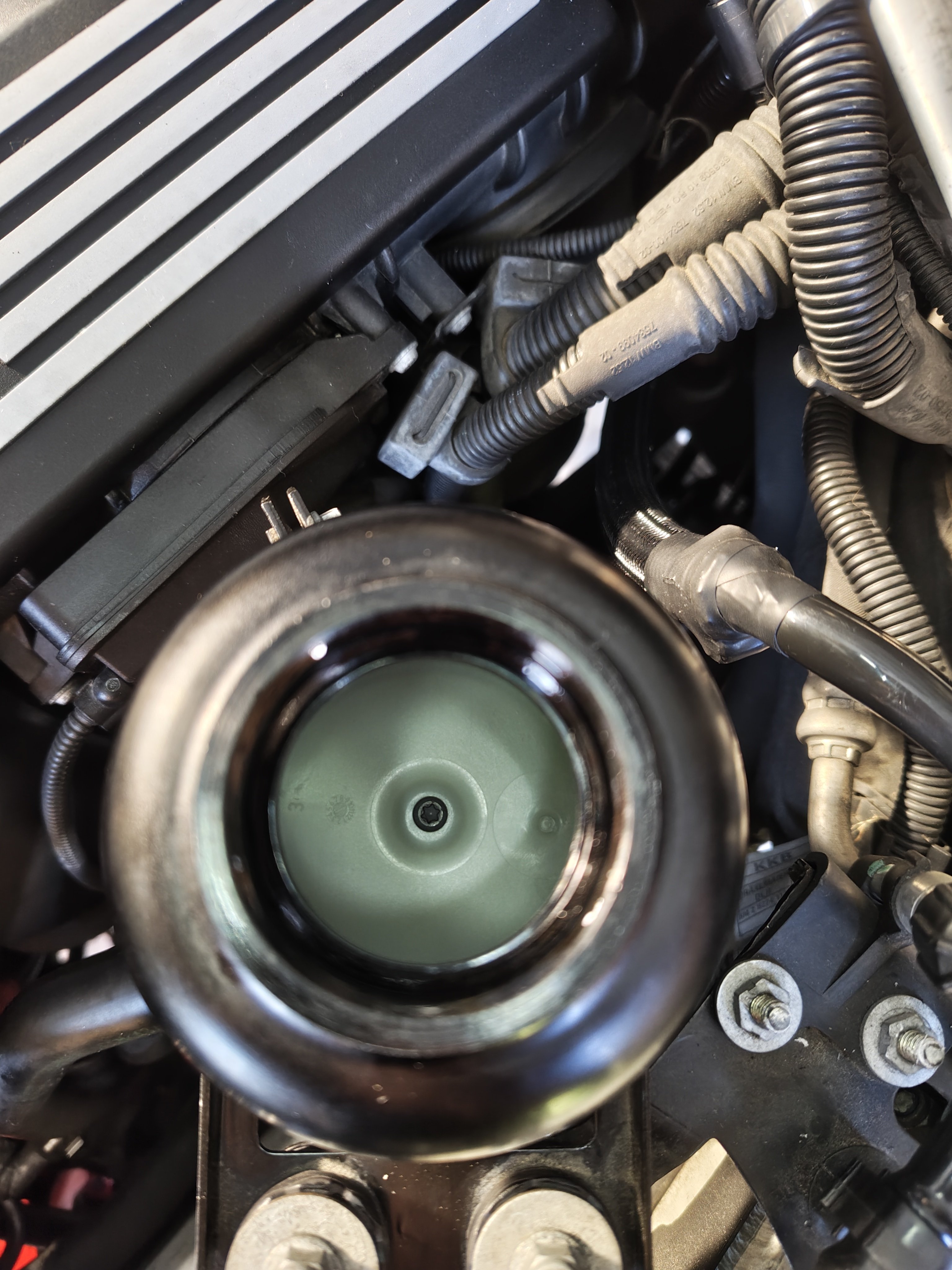

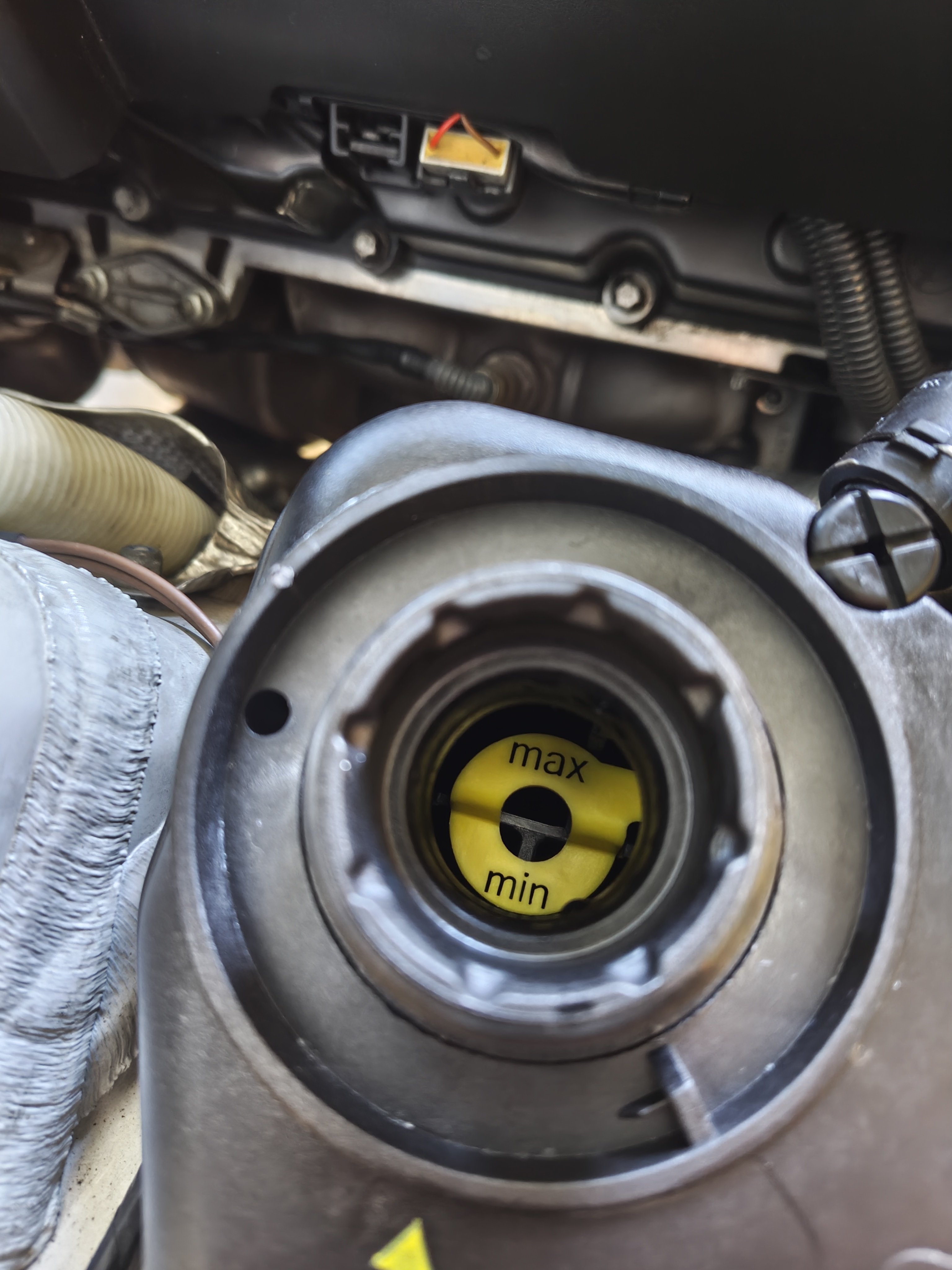

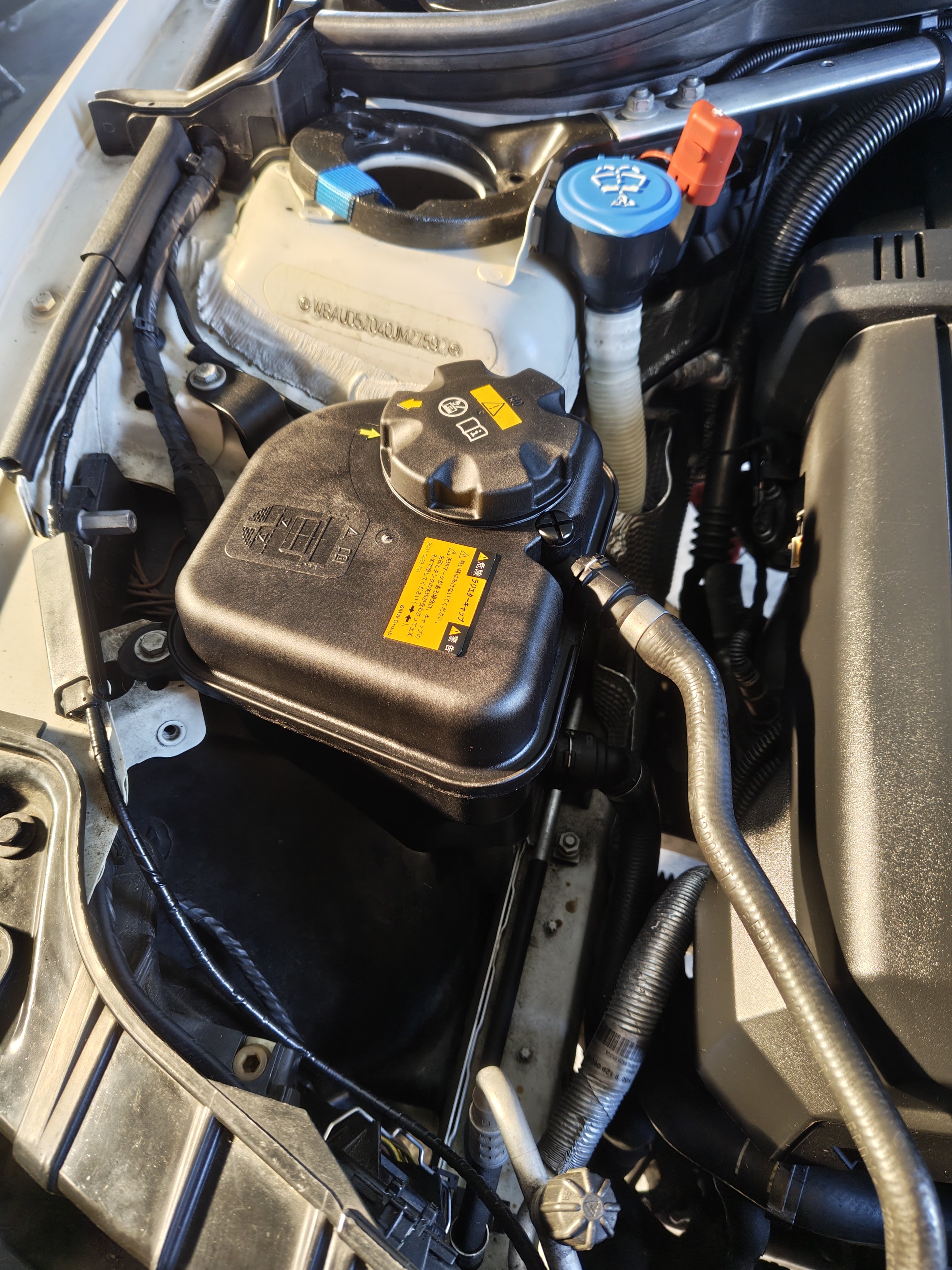

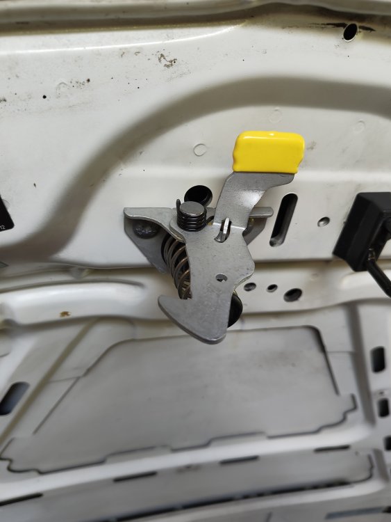

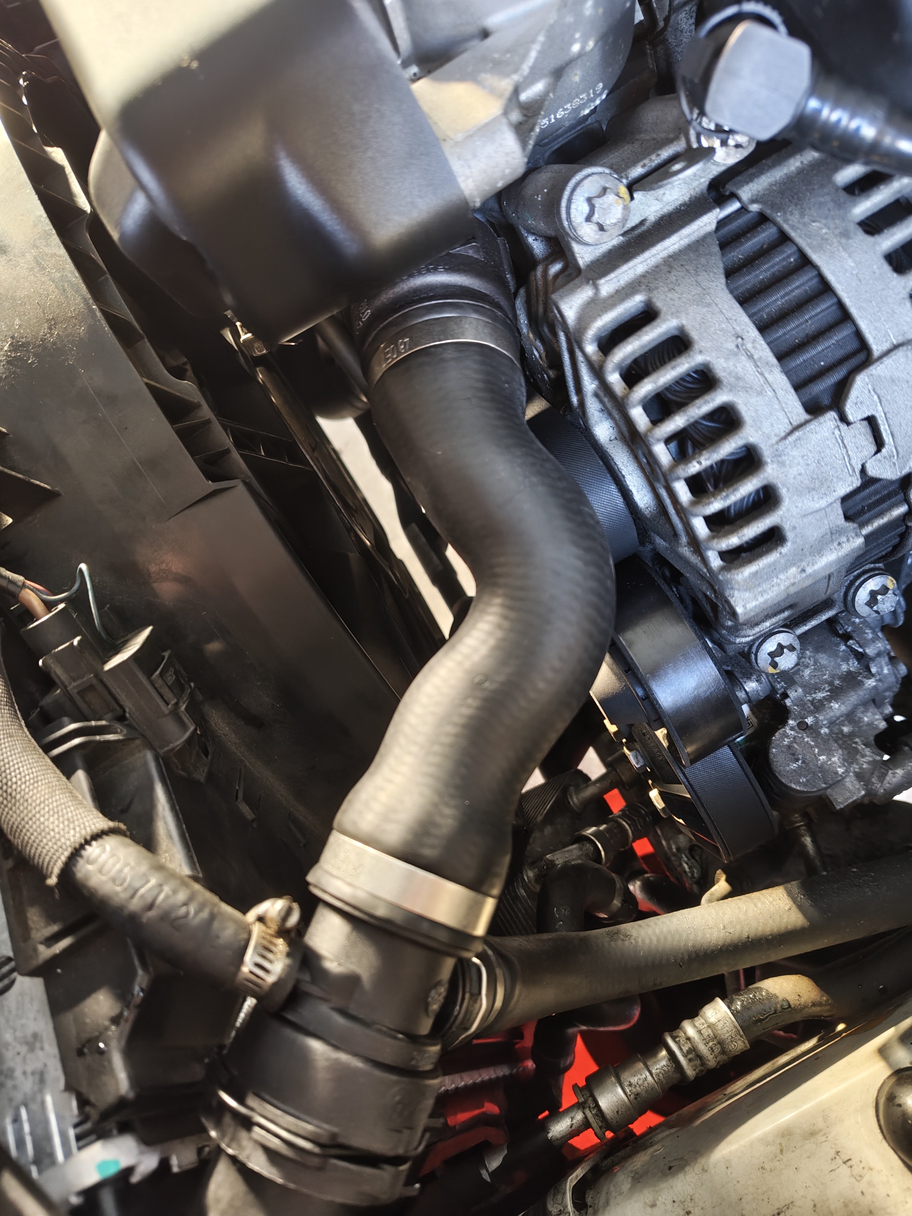

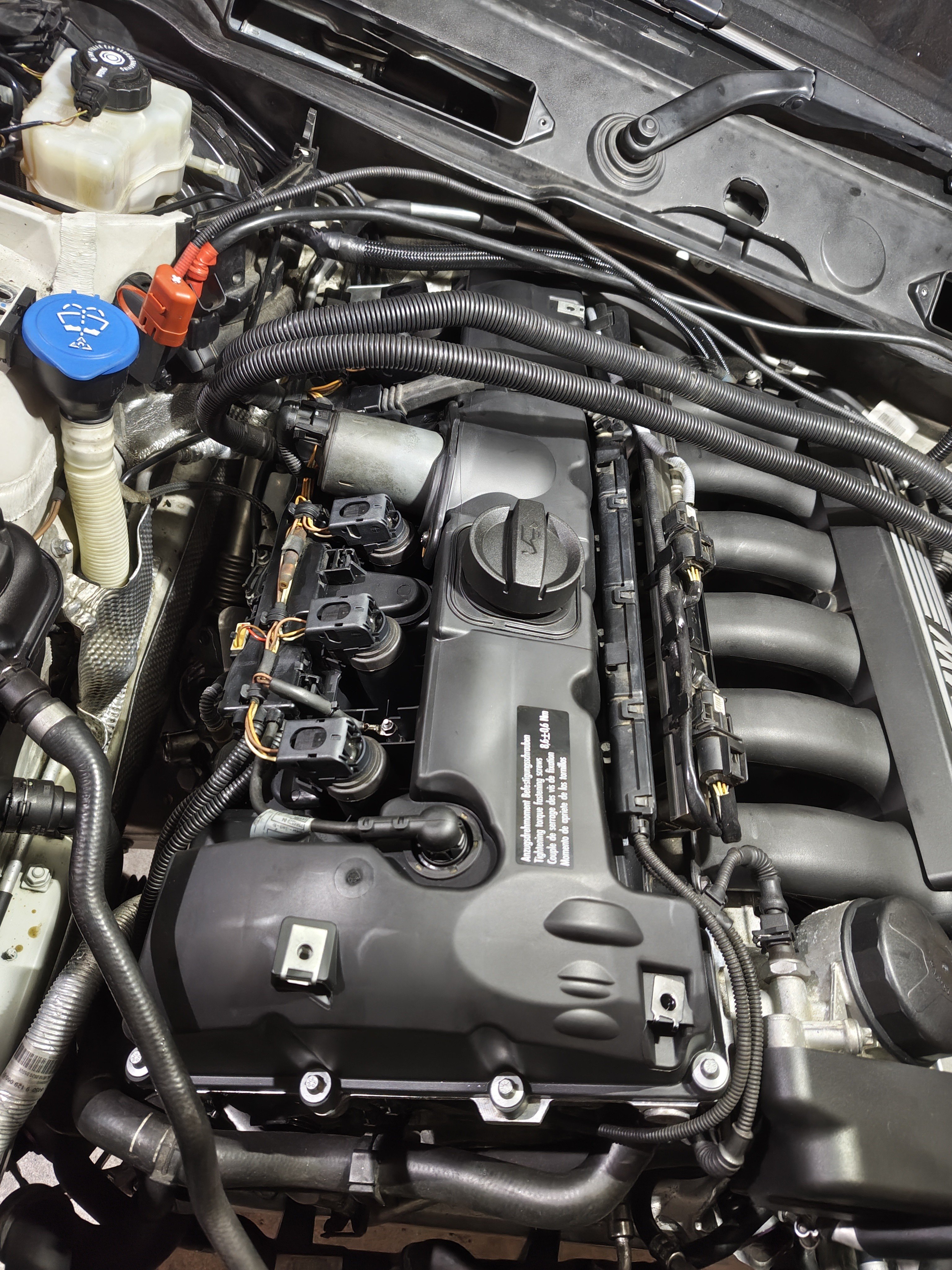

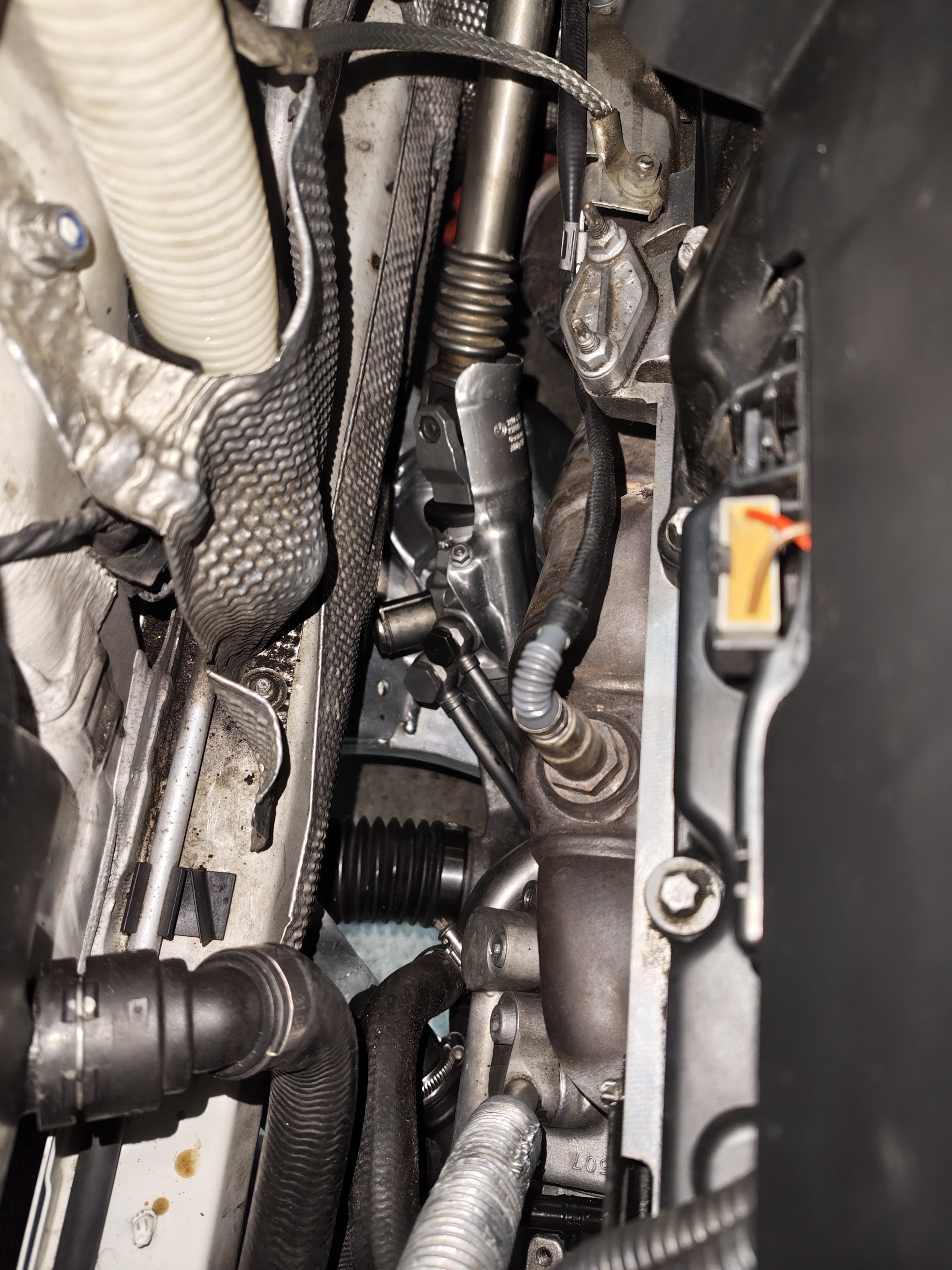

Hutty008 61 Report post Posted July 16 Started today off with some odd jobs. New coolant expansion tank, I used an n55 one which all bolted up, has a much better level indicator which was the reason I made the switch, I even transferred over the factory Japanese sticker. Also did a new geniune BMW upper radiator hose, very surprised the old one was not leaking as it was completely f*!ked. Along with that I did a new hood latch as the old one didn't have the yellow rubber piece and was surface rusting and I installed a new power steering reservoir as with the M3 rack going in I want the whole system cleaned out. Next week I will be doing a new Eccentric shaft sensor as mine has been seeping oil though the pins and will be doing a new valve cover while I'm there as mine is original and there is no way I'm doing that good again any time soon. After that I will be dropping the front subframe to the the oil pan gasket, some new engine mounts and the water pump feed hose. I noticed when I did the water pump and thermostat that it was a bit swollen from past oil leaks and I have already replaced the other u-shaped hose next to it so that's the last one on my list. 3 Quote Share this post Link to post Share on other sites

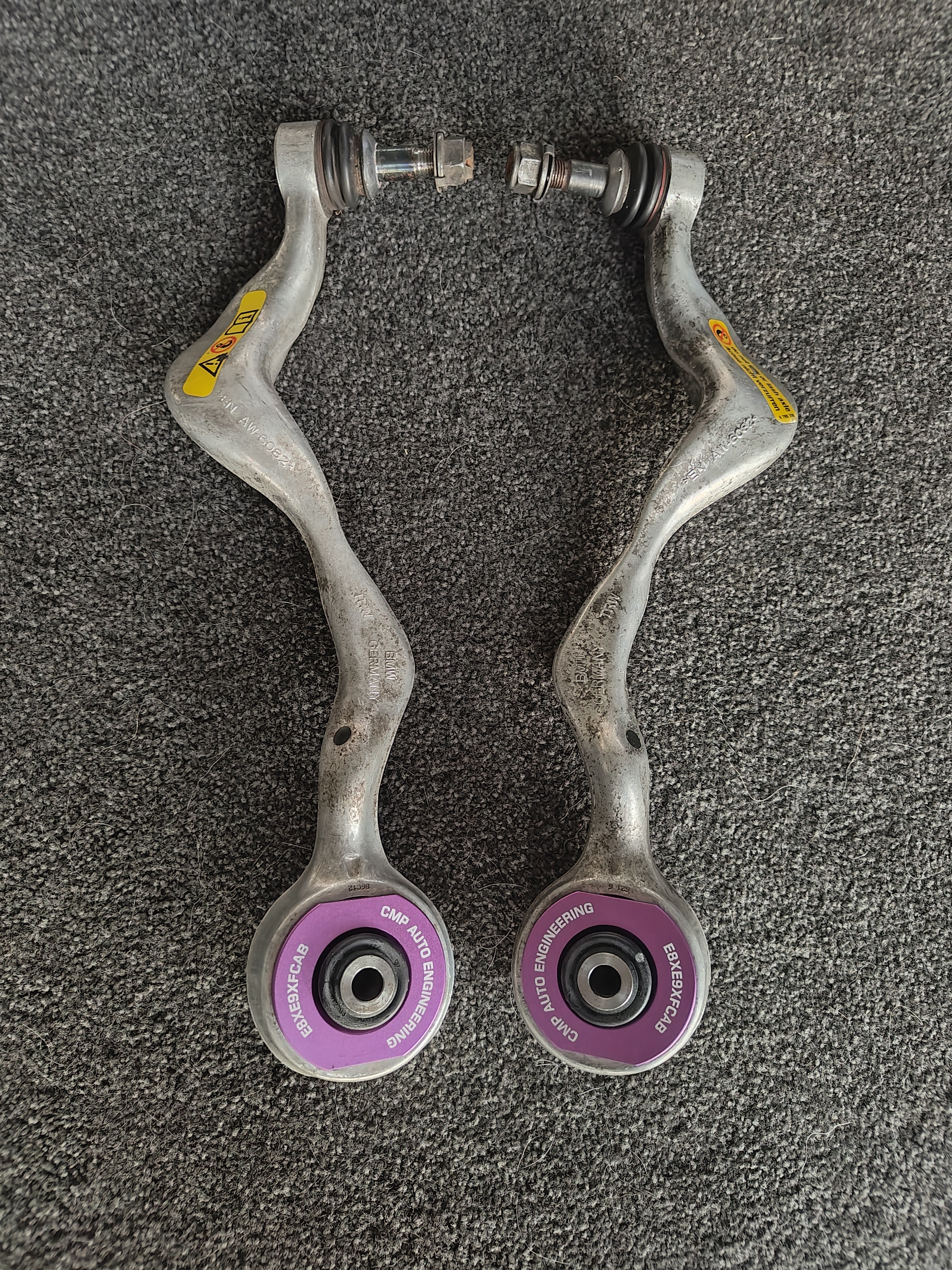

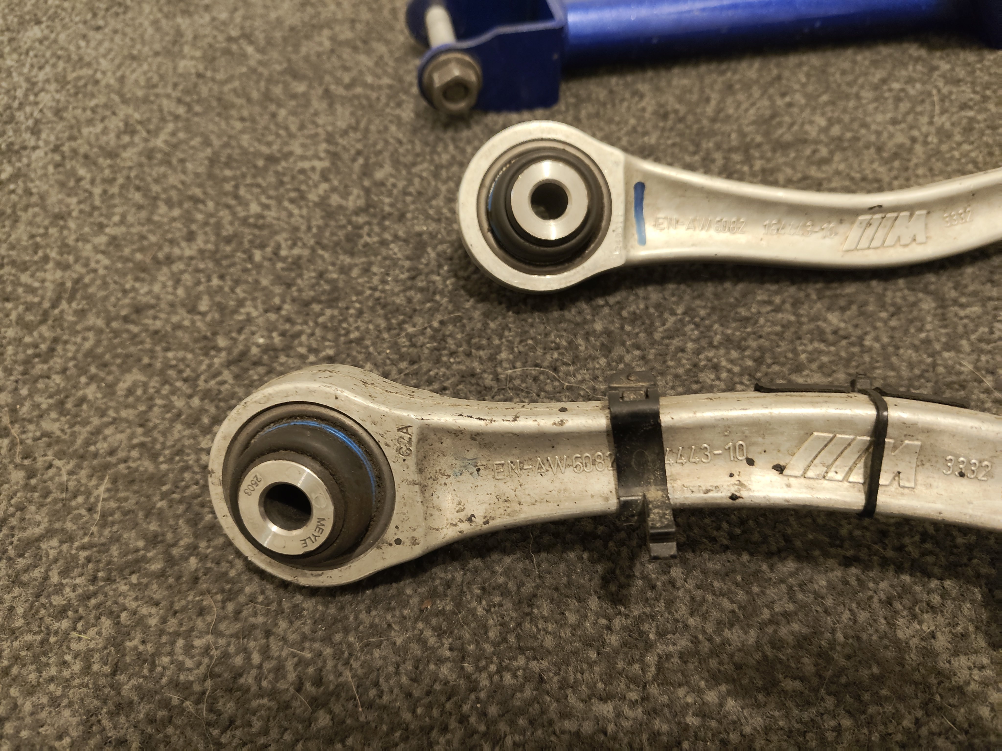

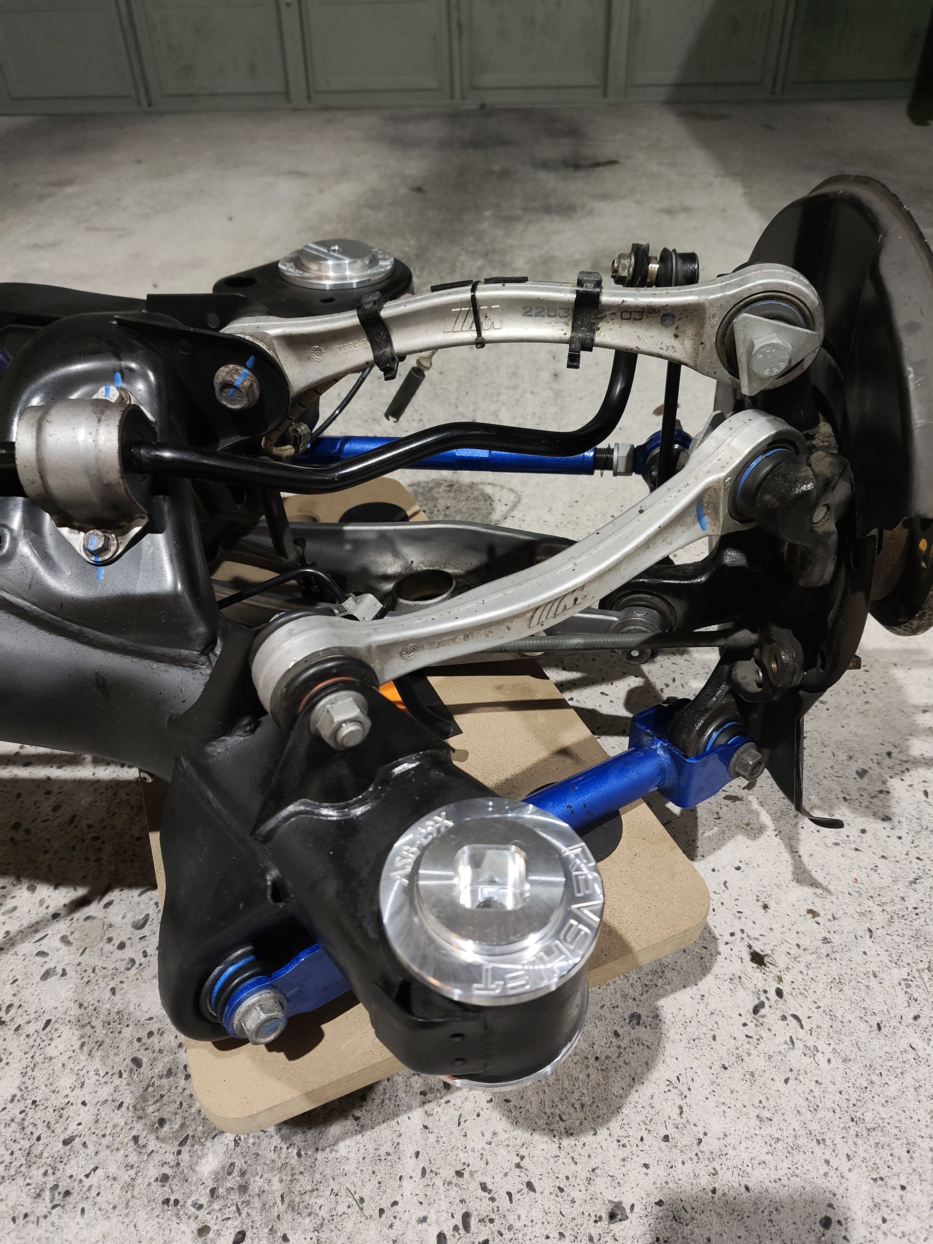

Hutty008 61 Report post Posted July 16 (edited) These are all the rear arms I will be running. I previously converted the M3 upper arms to ball joints on the knuckle side using through the use of CMP engineering shims. Edited July 17 by Hutty008 2 Quote Share this post Link to post Share on other sites

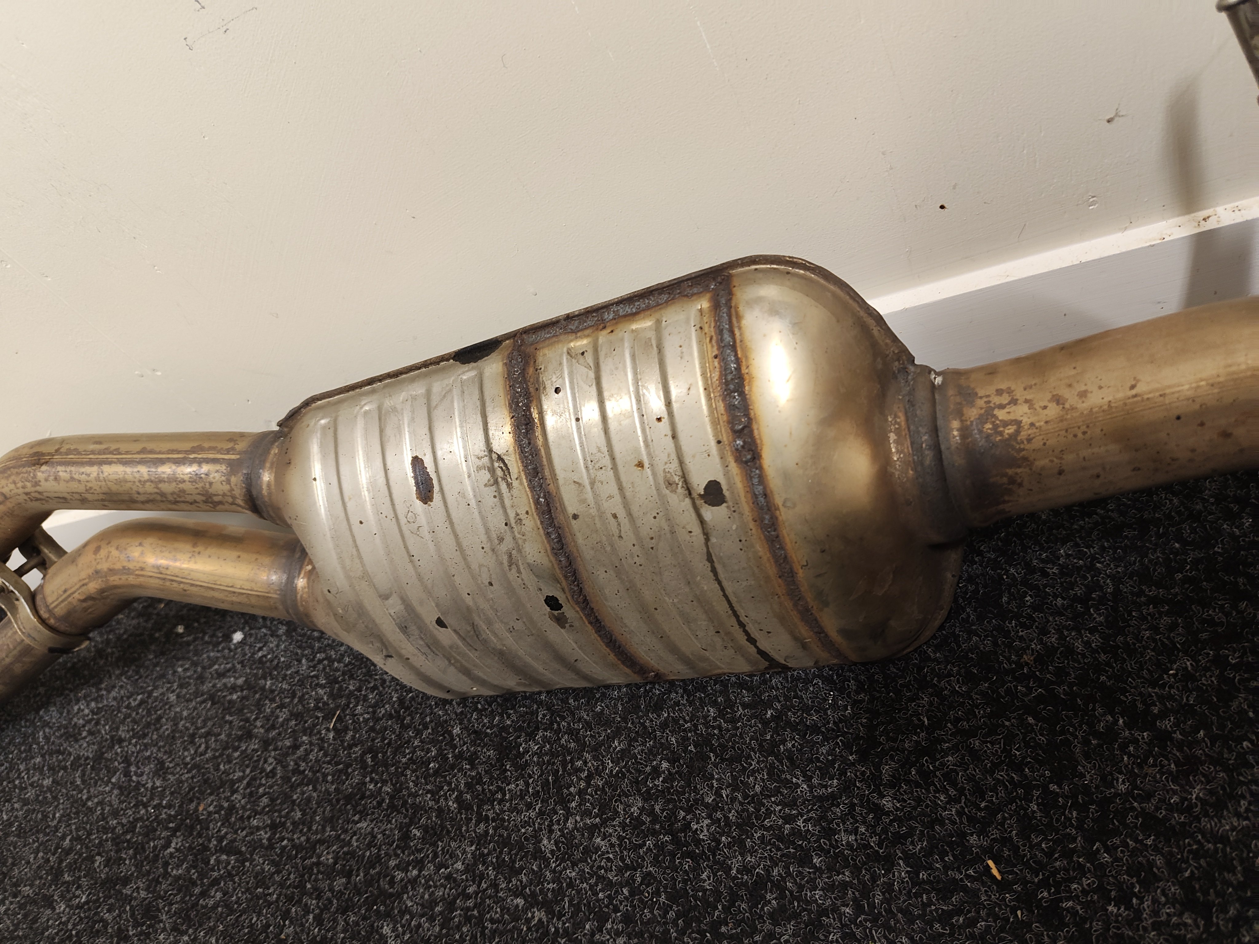

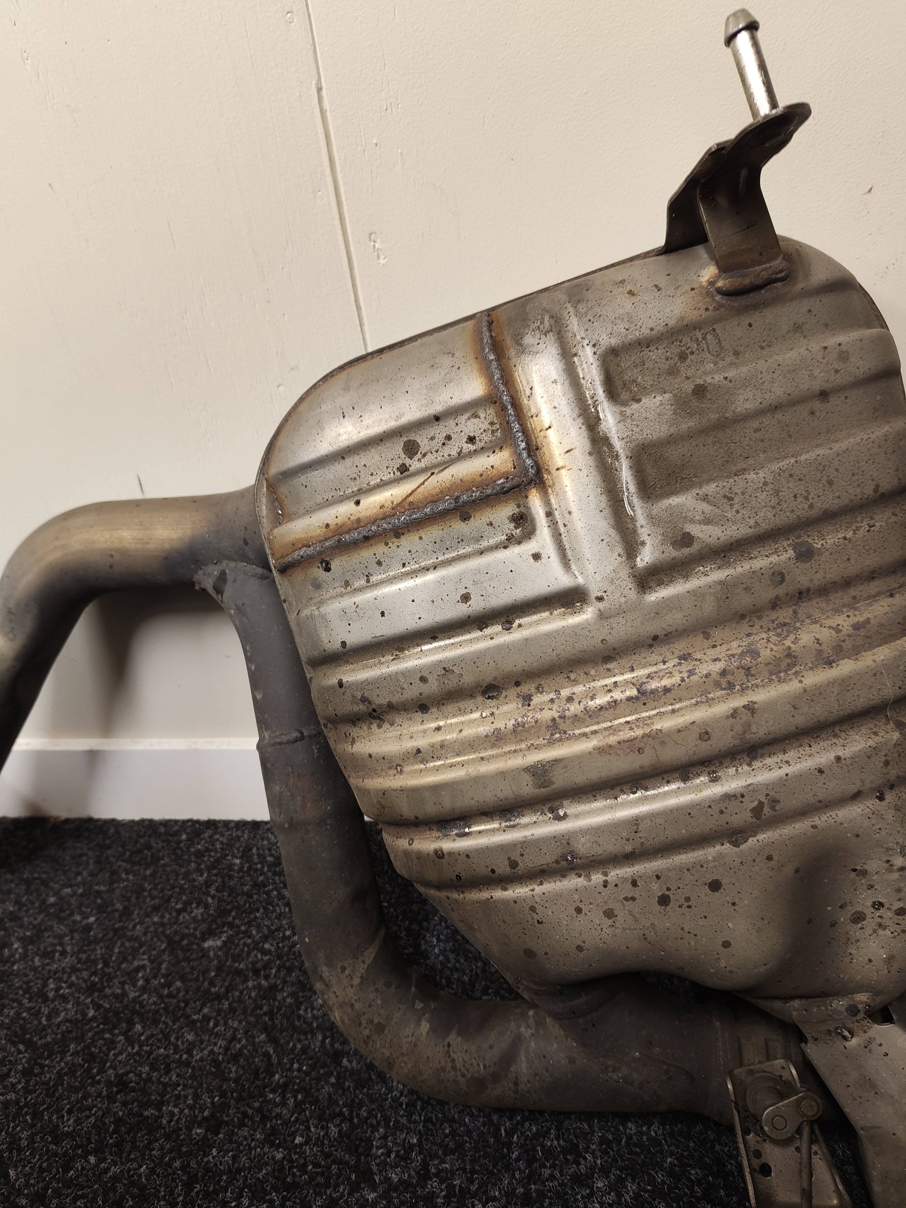

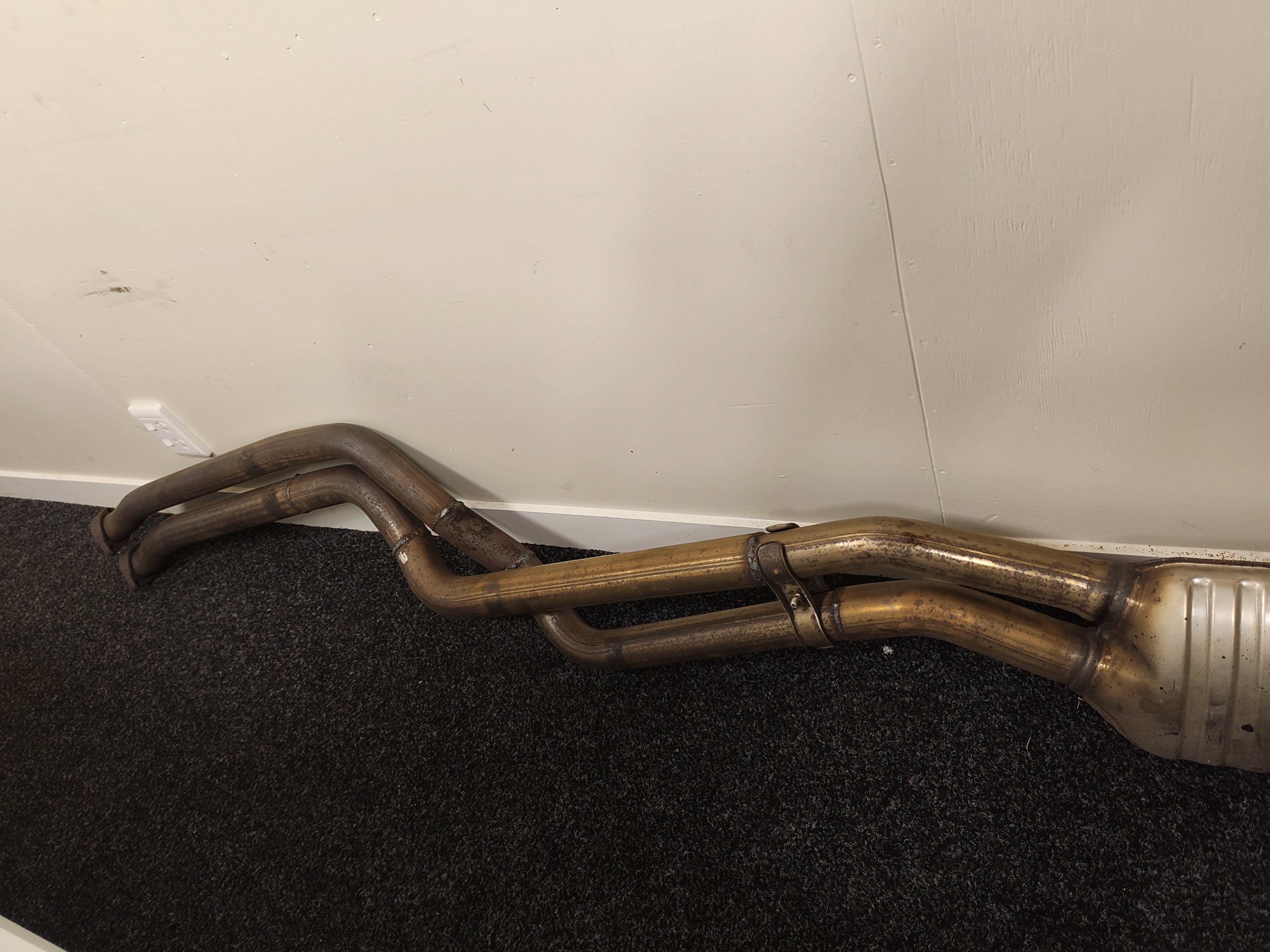

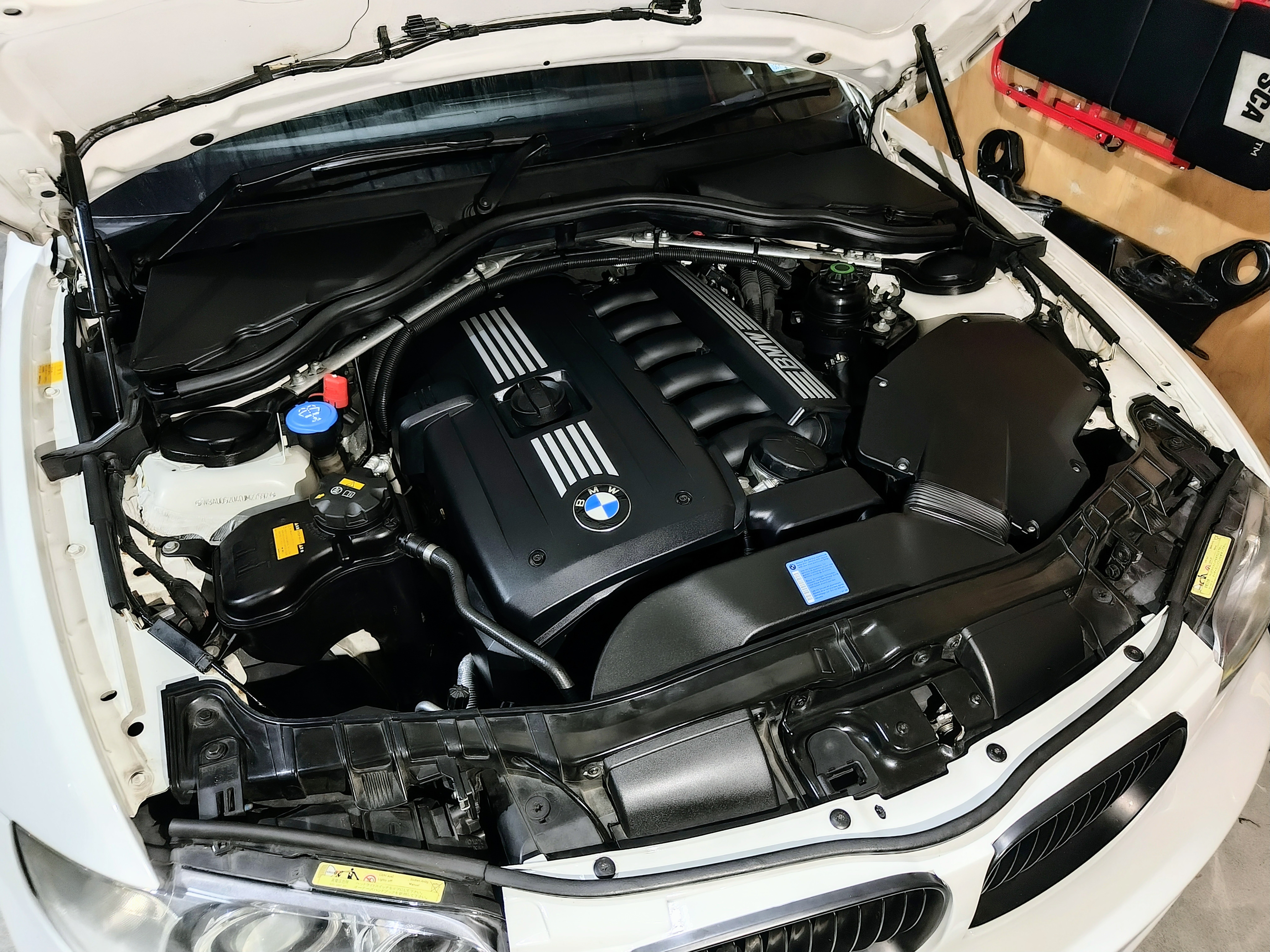

Hutty008 61 Report post Posted July 16 Also a lock at my exhaust setup for those who it might insert. Muffler has a bypass pipe to the valve side and has the first camber pipe wrapped. The resonator has also been wrapped. And the mid-pipe has been crossed over and had some added in to make it equal length like the laptop exhaust. 3 Quote Share this post Link to post Share on other sites

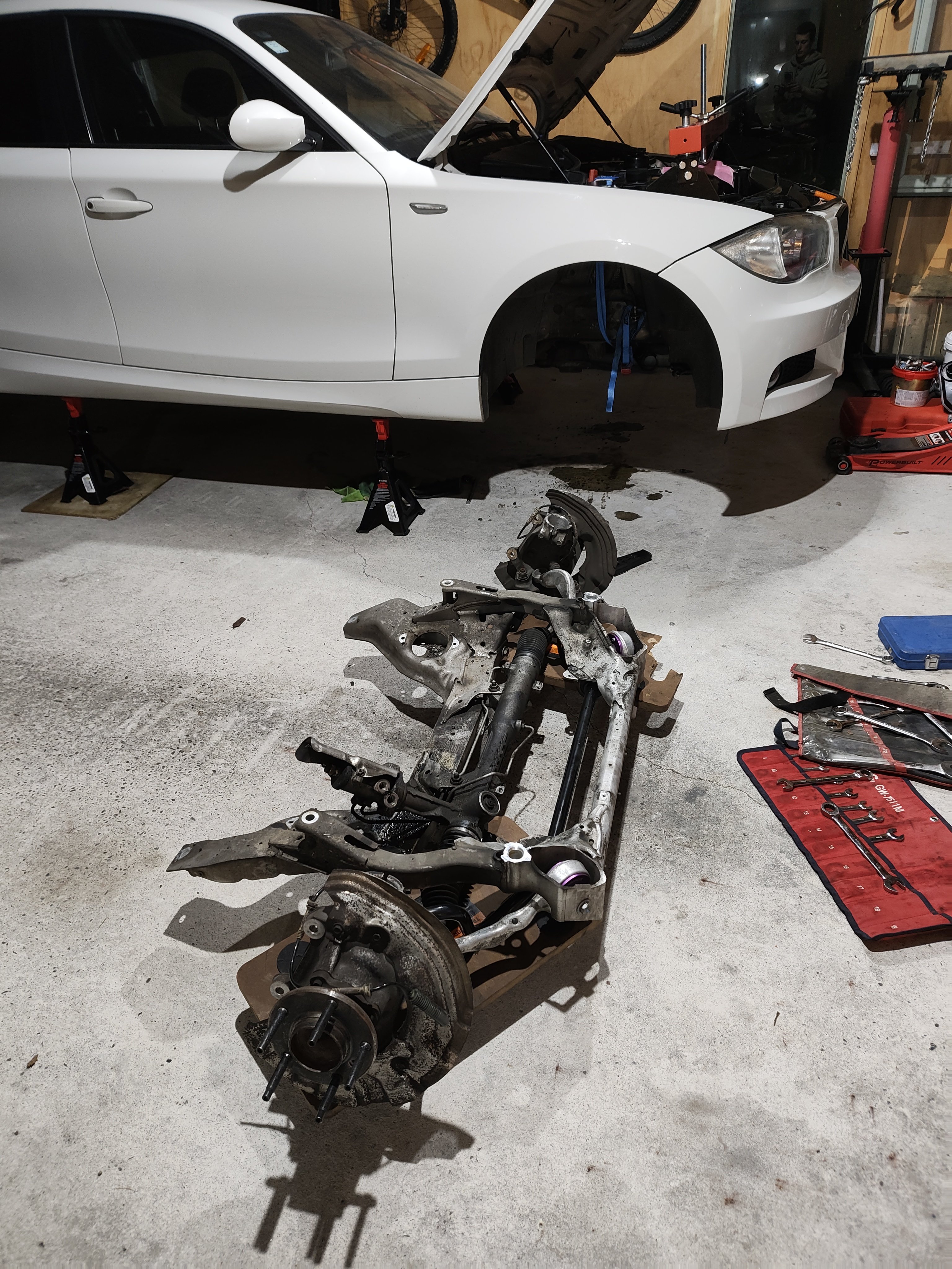

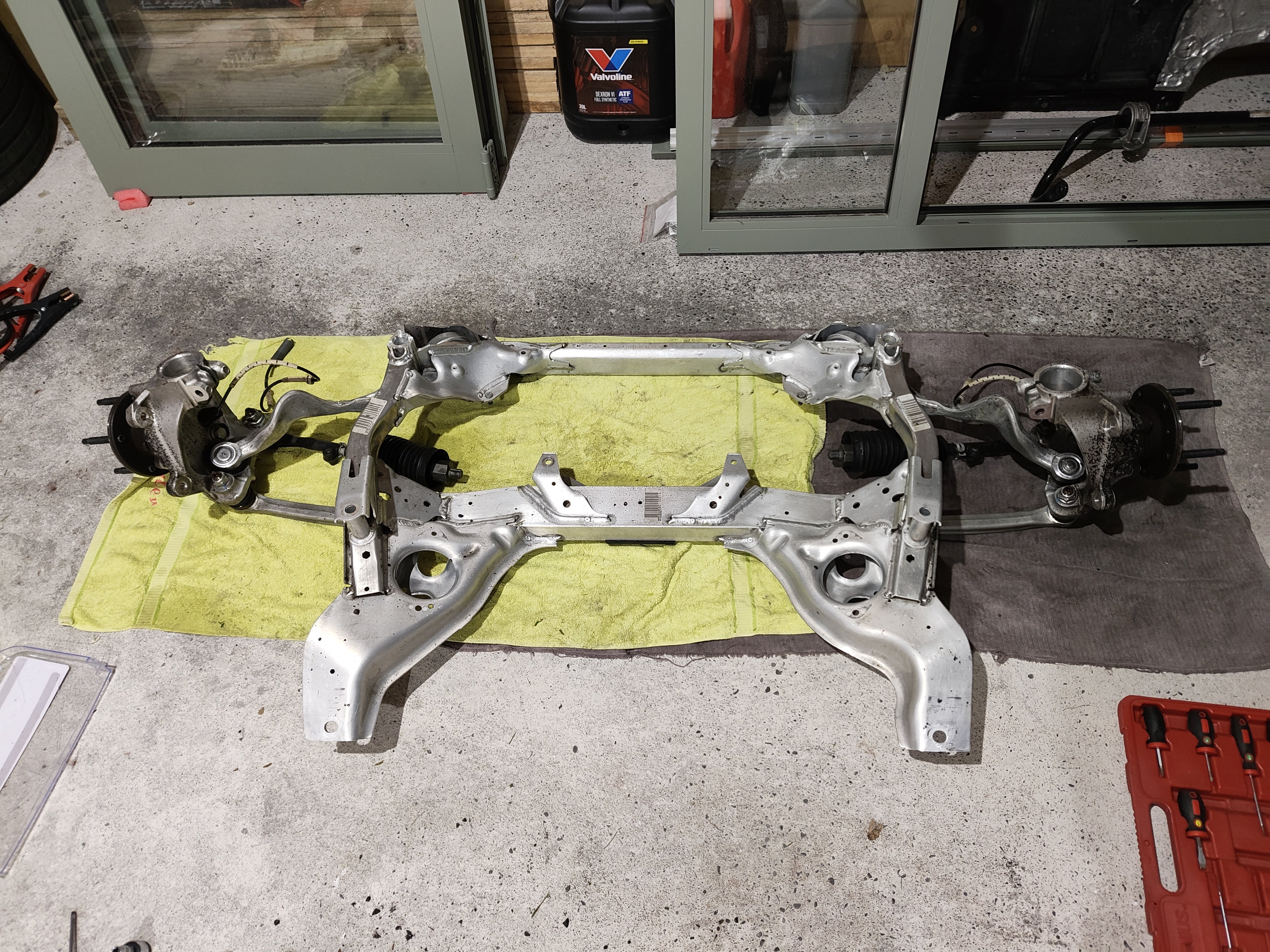

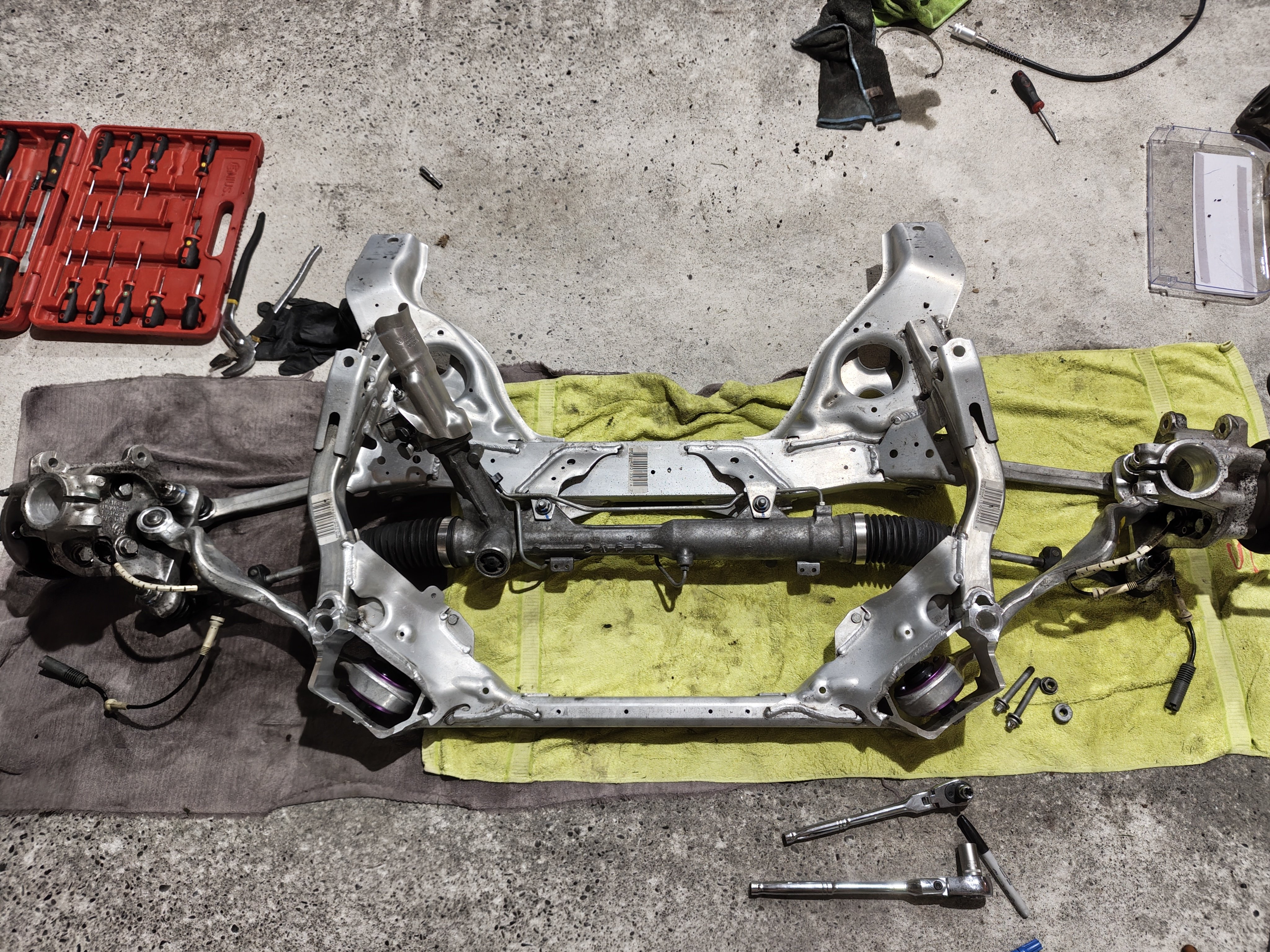

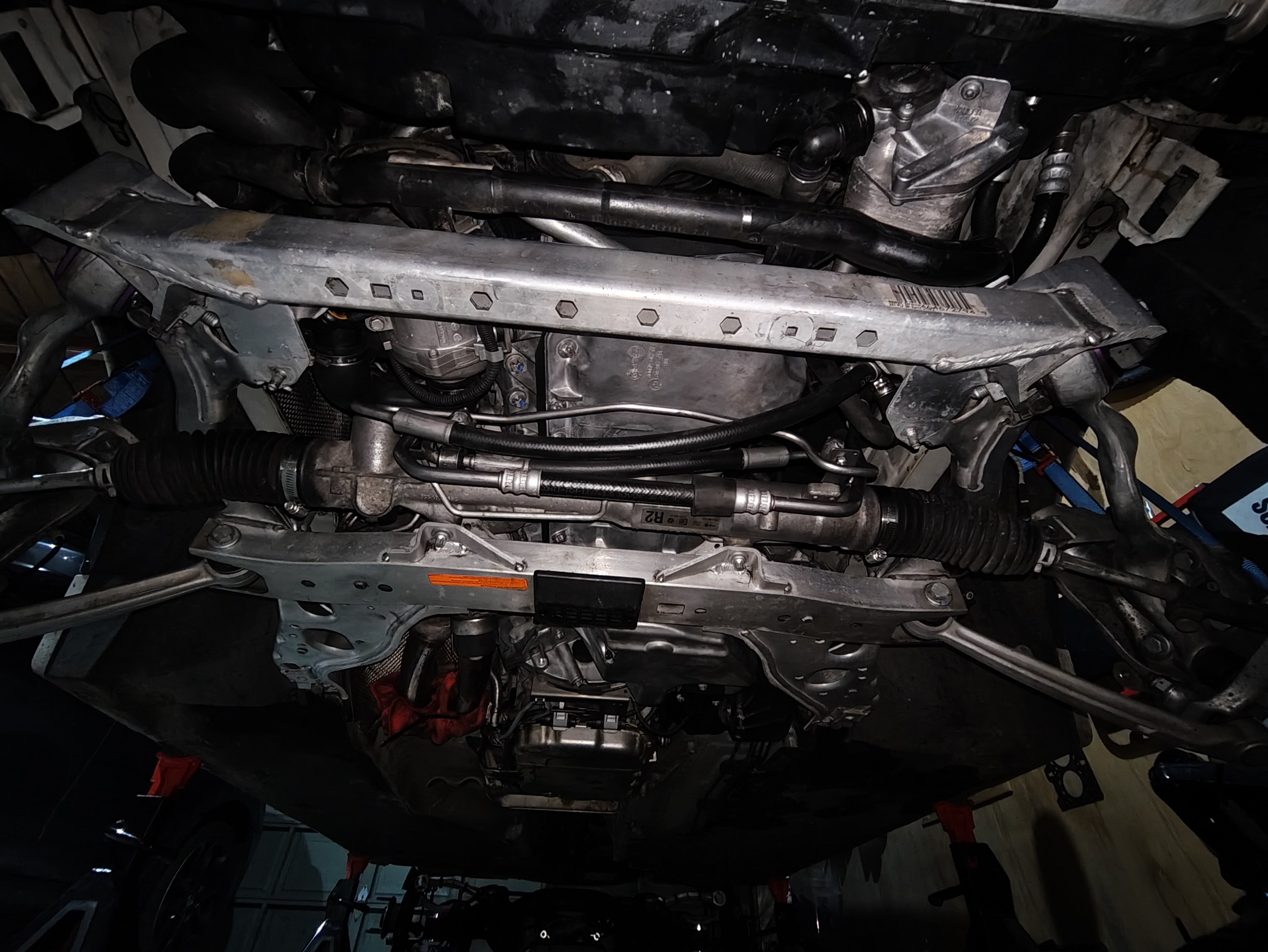

Hutty008 61 Report post Posted July 20 (edited) Front subframe out ready for the sump gasket job. It cleaned up real good and I swapped the M3 steering rack on ready to go back in. Before that though there is lots and lots of cleaning to do to the underside of the engine bay, then new sump gasket and engine mounts can go in. Probably my favorite but about having it completely apart is to clean it spotless. Edited July 20 by Hutty008 4 1 Quote Share this post Link to post Share on other sites

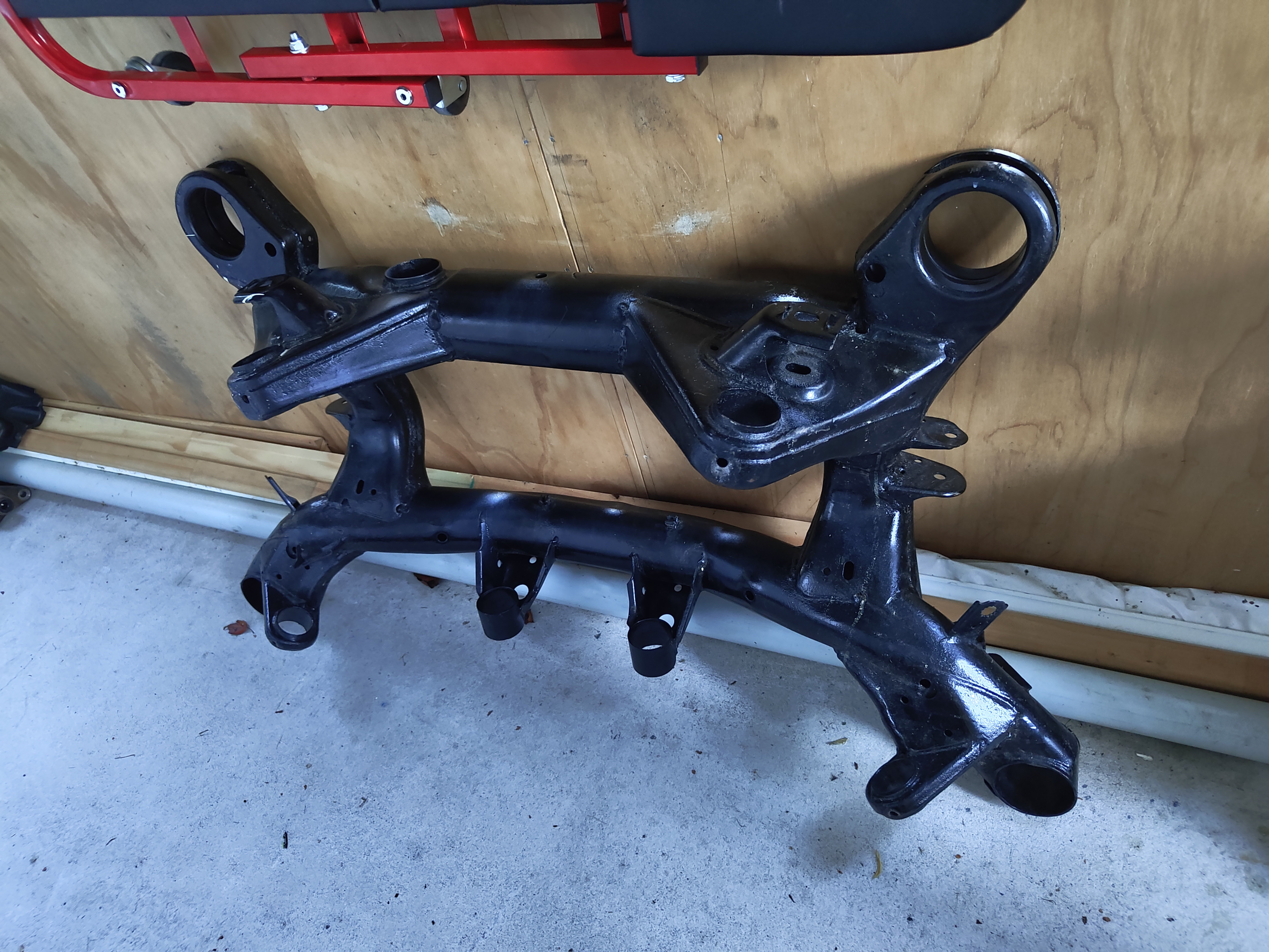

Hutty008 61 Report post Posted July 22 (edited) Rear subframe prepared and ready to go in. Treated the surface rust spots were the weld lines were and painted any gaps in the paint, low effort compared to refinishing the whole thing but should definitely prevent further rust. Installed all the new bits as well, aluminum subframe bushings, super pro diff bushings, ball joints in the trailing arm, M3 spring arms, hard race toe arms, SPL eccentric lockout kit and new knuckle side bolts. Edited July 22 by Hutty008 5 Quote Share this post Link to post Share on other sites

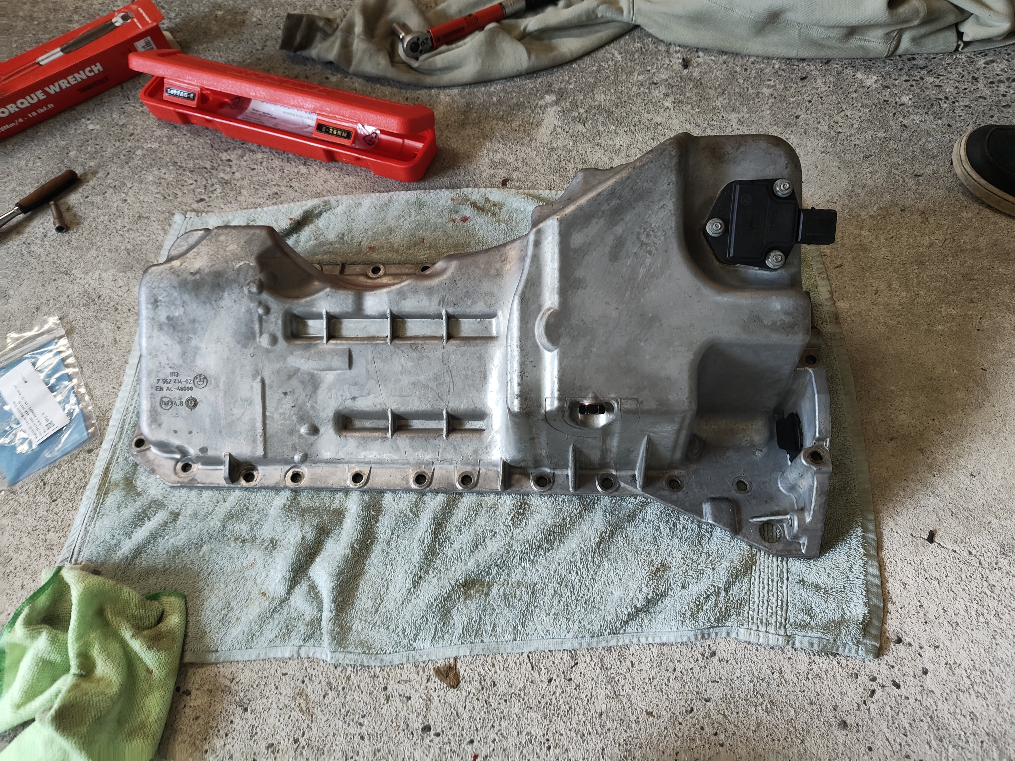

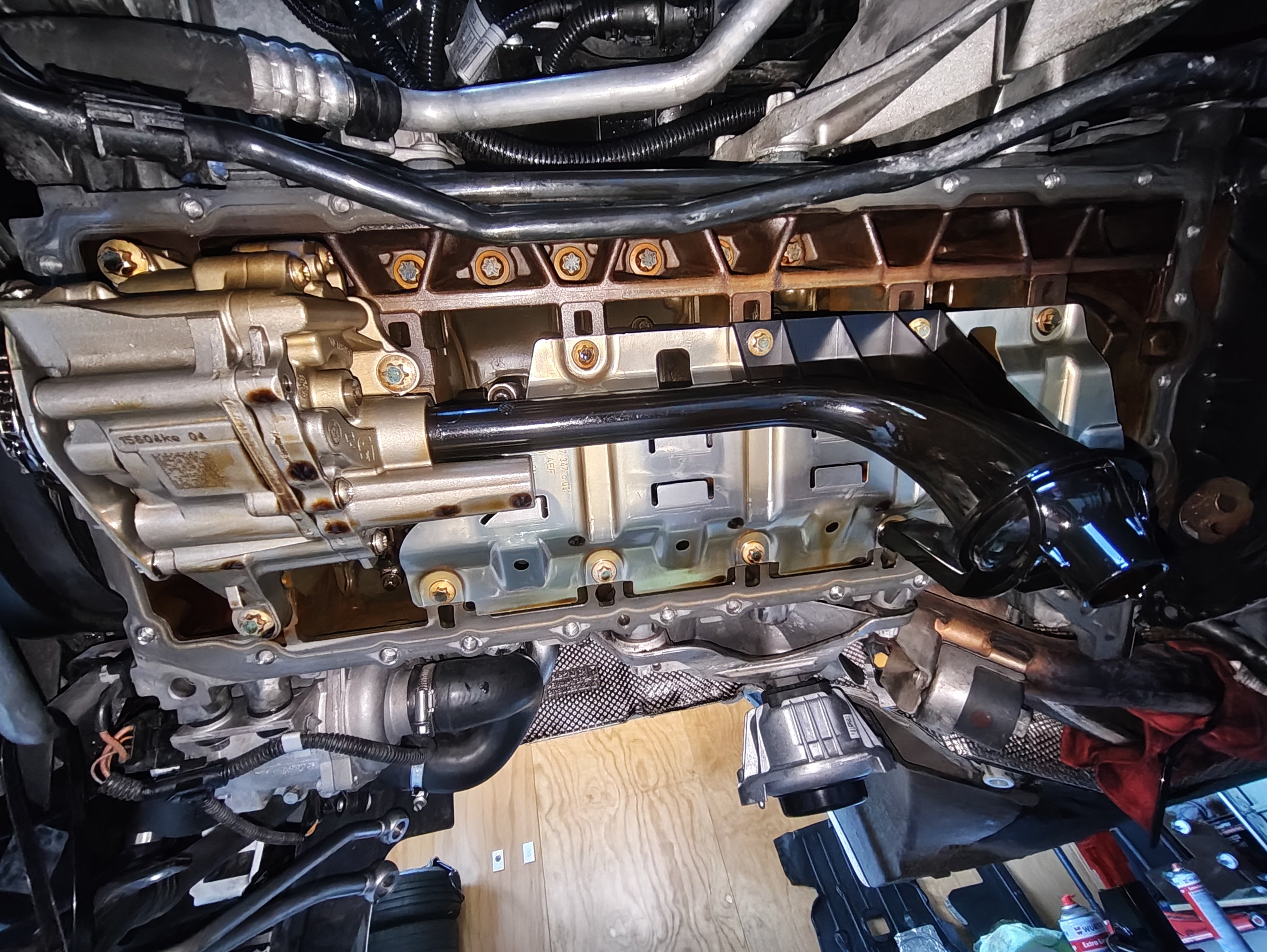

Hutty008 61 Report post Posted August 6 Bit of an update on the past few weeks. Got the sump gasket replaced, engine mounts replacement and the front subframe back in. All is nice and tidy however I think the M3 steering rack is leaking so it will have to be sent off to be rebuilt, will wait until I get the car started to confirm the leak first though. 1 Quote Share this post Link to post Share on other sites

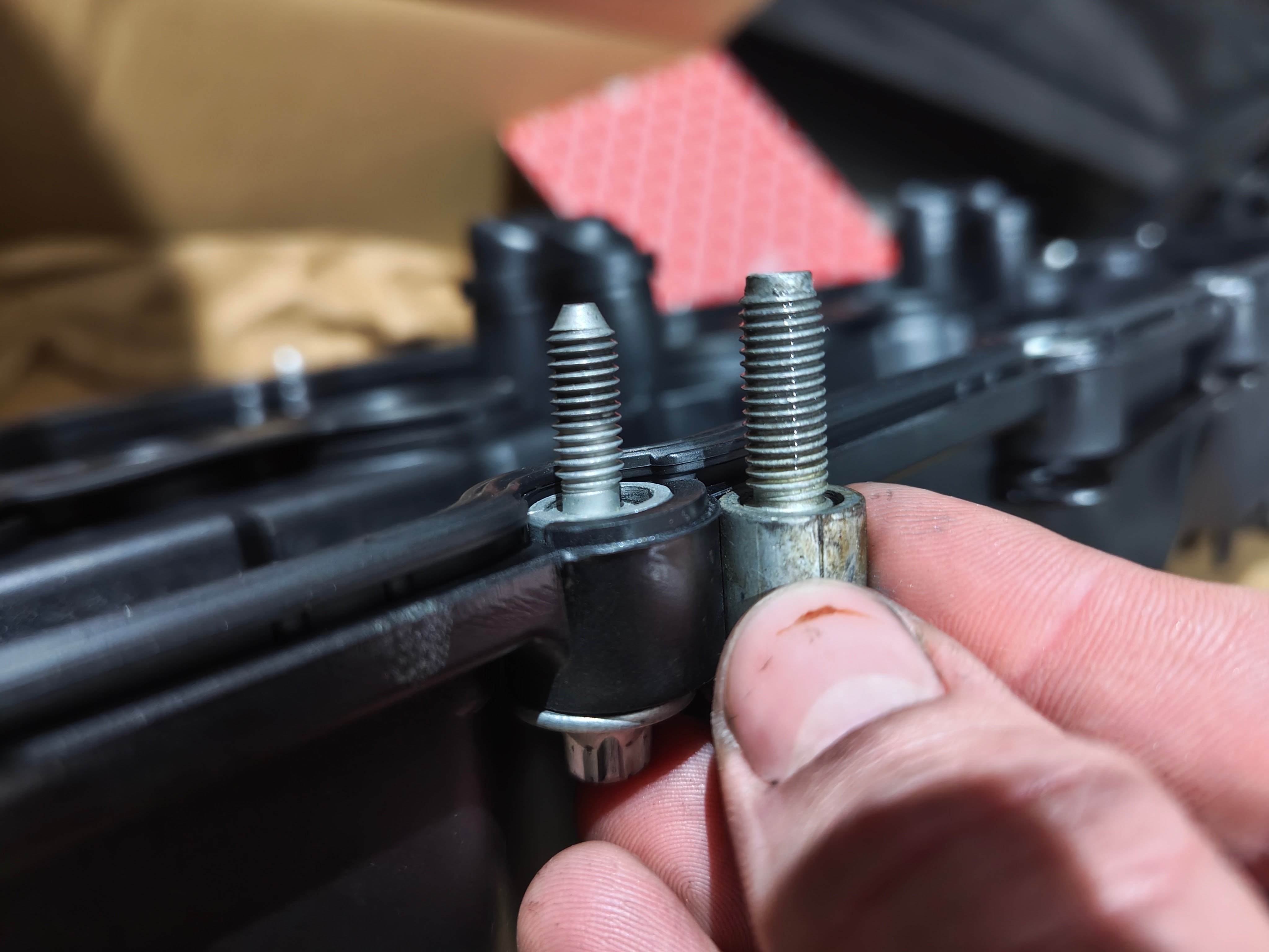

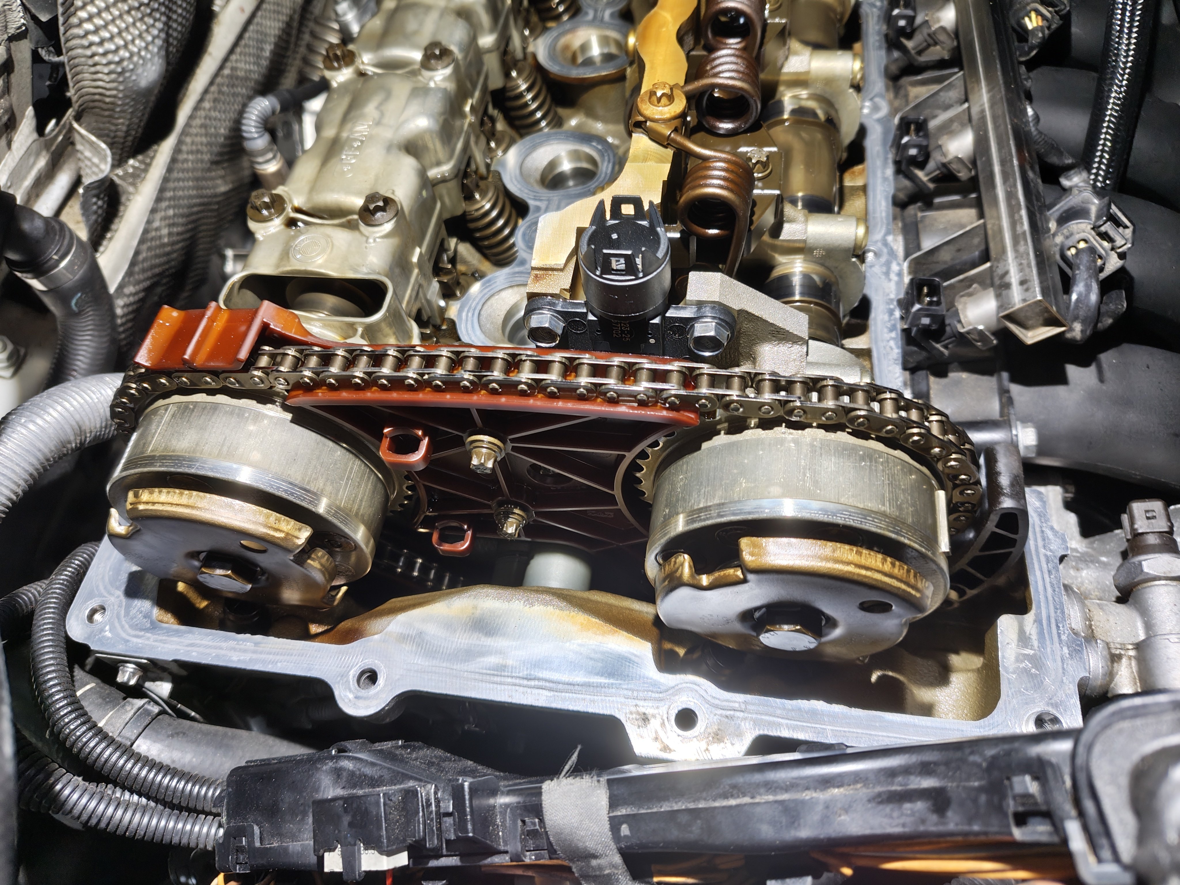

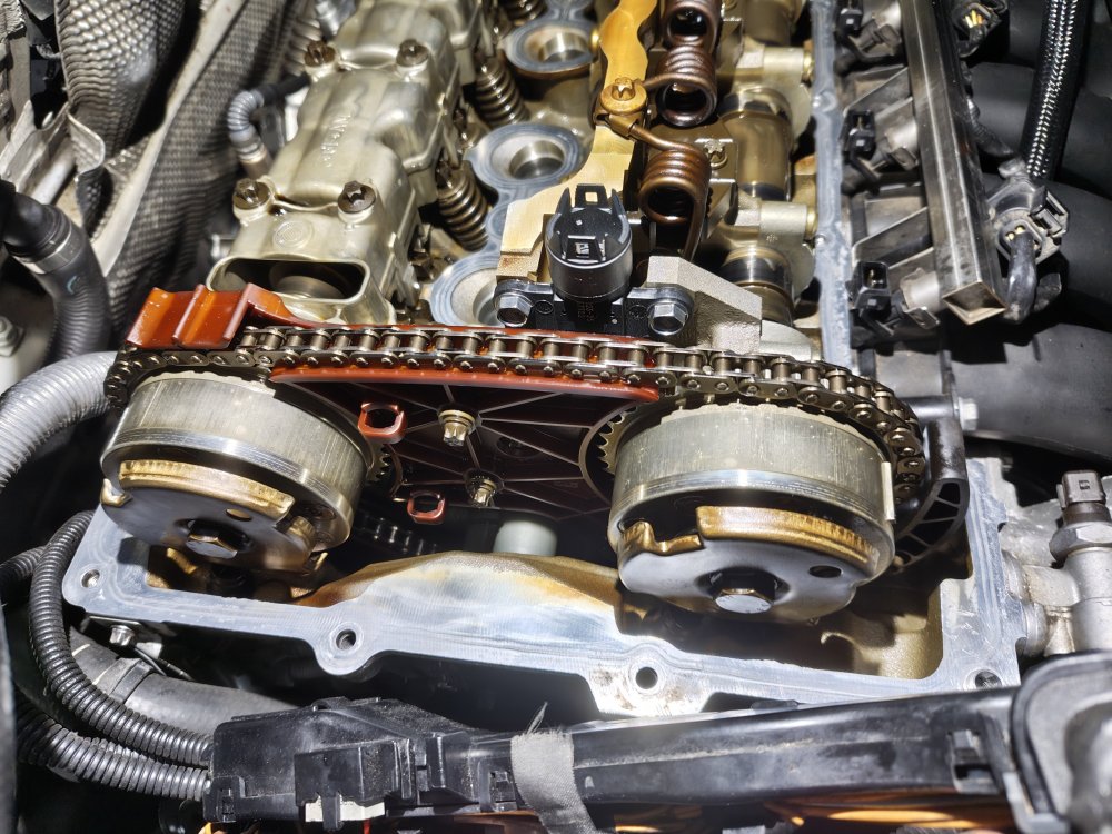

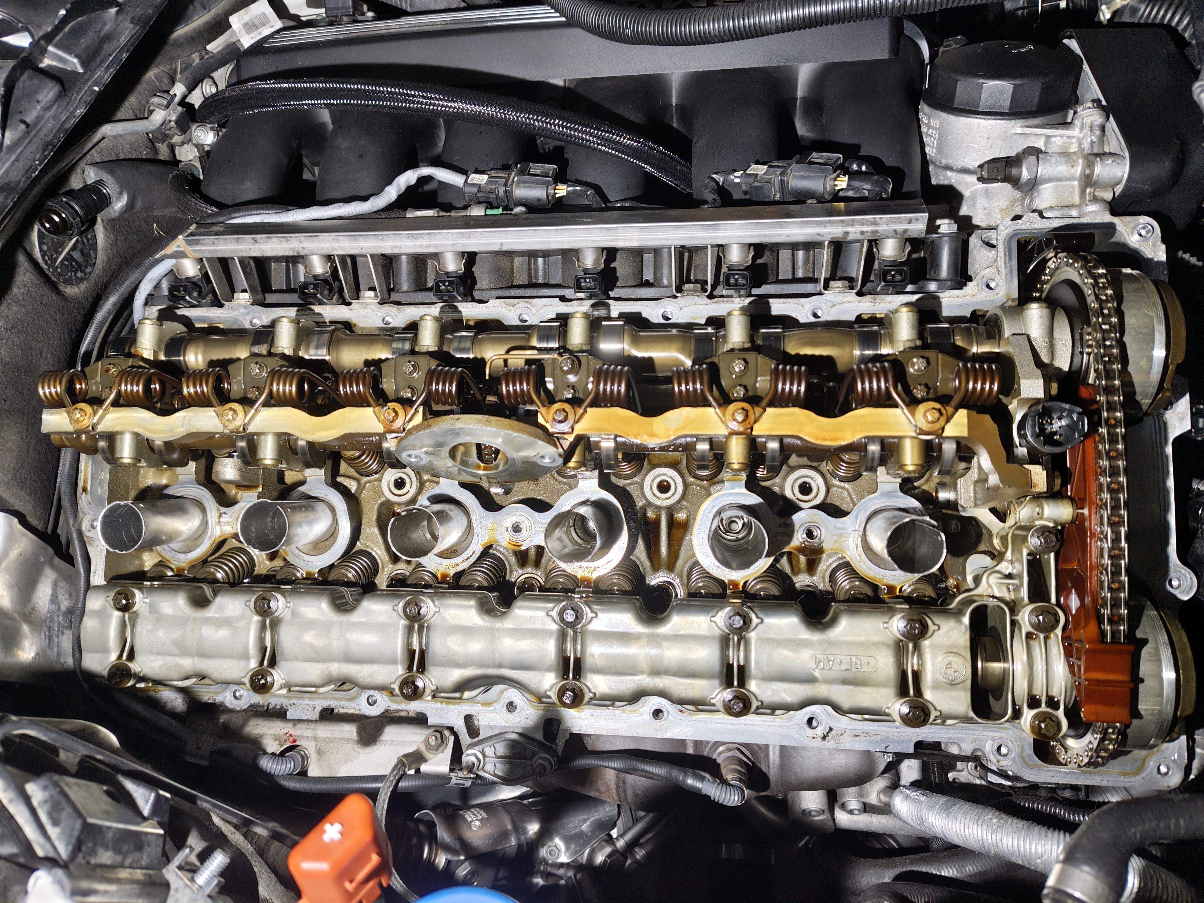

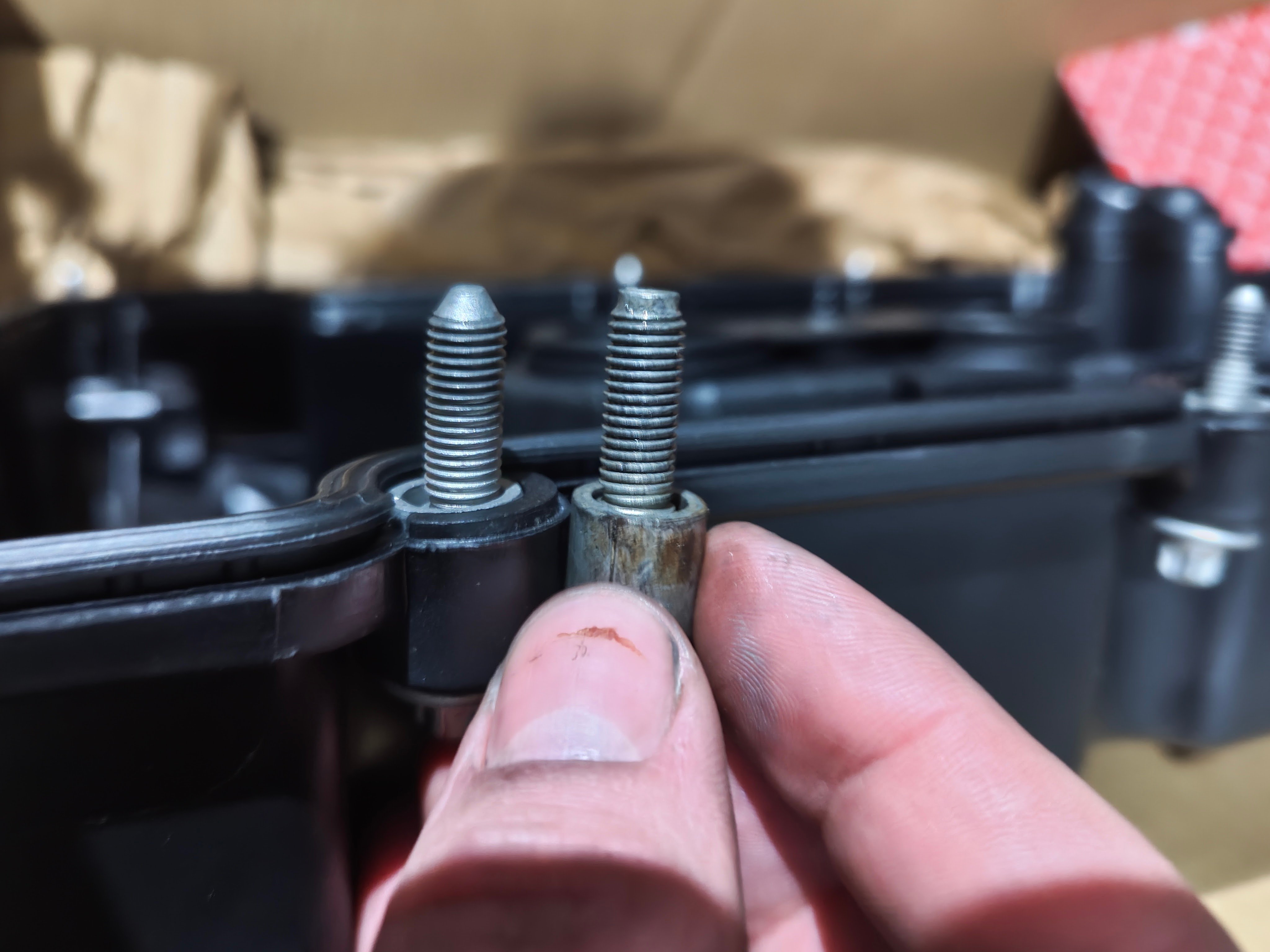

Hutty008 61 Report post Posted August 6 Also got the eccentric shaft sensor replaced as mine was leaking oil through the pins, it hadn't given a code or anything so be sure to check yours. As for the valve cover the one Elring one I had got off FCP had small bolts in most of the slots, upon a back and forwards with FCP they sent me a new one luckily that one was all correct so the first one must have been a manufacturing error. FCP didn't want the error one back so I decided to hammer out the 12 wrong bolts with the captive bits and I will push in 12 of my old bolts to make it all correct, giving me another new valve cover for a new car which a deal is in the works for. 1 Quote Share this post Link to post Share on other sites
