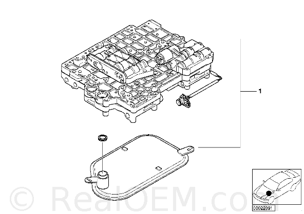

hybrid 1045 Report post Posted November 25, 2009 They can come in GM or ZF variants. The earlier 02 backwards suffered from drum failure (loss of reverese gear). There is a revised replacement part for this that isn't too expensive (relativly speaking) however you only normally find out if it ruptures which then requires a full gearbox rebuild. This is due to the drum being made faily thin. It totally depends on how the person treated the car and if they waited for the gearbox to engage before putting their foot on the gas. Next that goes wrong with them which is also seen in the e39 is worn valve guide (this part) This causes the gearbox to thump between gears under certain conditions. This again can happen when ever and is totally on how the car has been treated. All in all they are fine, but if they are abused then they will cause problems like all gear boxes. Anything else that may go wrong with them is just normal auto gear box problems (torque converter, piston, soliniods etc etc) I wouldnt worry too much, Getting it plugged in and diagnosed (EGS) will be a good start, this is covered in the BMW pre-purchase inspection (not AA) you should get before purchase . And take a few for a drive to get an idea. They are generally one of the smoothest gearboxes around and are fantastic as far as auto gearboxes go. I can't speak for the GM version and to tell you truth I haven't heard of them in NZ (im not a mechanic so I dont get to see them) Quote Share this post Link to post Share on other sites
