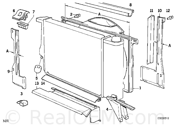

melowpuf 19 Report post Posted May 9, 2010 (edited) Step 1: get the BIGGEST hammer you can find... Step 2: Go to James' car Step 3: Stand on the roof of his car Step 4: Swing hammer as hard as you can into his windscreen whilst jumping and screaming as loud as you can.. Step 5: walk calmly back to your car. Step 6: get a screwdriver and on the top corners of the shroud you will find some round plastic clips (number 2 in the diagram below). these clips are expanded by a plastic pin through the middle of them.. On the radiator side of these clips place a screwdriver (flathead) and lever gently to press the pins out enough to be able to grip them with a pair of long nose pliers from the engine side of the clip. Remove the pin and then the clip should come out also. then manouvre the shroud up out of the enging bay.. Alternatively wait for James to come home. grab his car keys. lure him outside.. run back inside and lock the door.. tell him to fix it. Edited May 9, 2010 by melowpuf Quote Share this post Link to post Share on other sites
Docile 64 Report post Posted May 9, 2010 (edited) wtf.. what kind of BF is he??.. change of waterpump is only like 1 - 2 hours max... above picture: two push pins on both side. no.12. need screw driver to push middle pins out then the lock can be pushed out. although it will be bit hard. need to remove: fan clutch + fan. need 32MM wrench + special tool or a makeshift 1. shroud waterhoses fan belt Edited May 9, 2010 by Docile Quote Share this post Link to post Share on other sites
