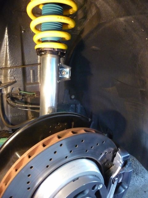

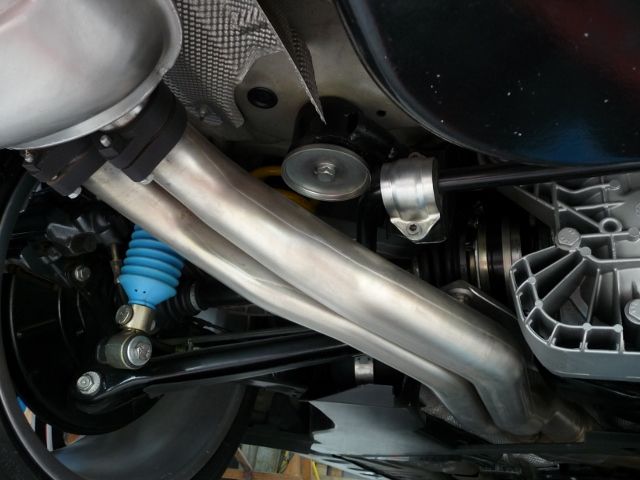

central3 31 Report post Posted January 1, 2013 After 3 months off the road the M3 is (almost) ready to go again. Work has included replacing the Champiro tyres with a second hand set of Michelin PS2’s (thanks Mark), fitment of a set of AC Bilstien PS9’s (thanks Tom), replacement of conrod bearings (plus ARP bolts), checking and crack testing of the Vanos oil pump drive tabs, checking of the camshaft bolts, valve clearance adjustment (4 of), oil change (including cooler flush and oil gallery purge), new plugs, new coolant, replacement of HP power steering hose (thanks Ray), gearbox oil change, fuel filter change, PS flush and fluid change, centre console replacement (with arm rest delete), OEM short shifter, new battery and wheel spacers (20mm front and 9mm rear). All went well until the first start up attempt a few weeks ago. Not good, rough idle and way down on power (limp mode). Assumed I had stuffed up the cam timing when I pulled the Vanos off so I ordered a set of timing tools from the US (cam alignment toll and cam check tool). Reset the timing but the engine fault remained. Asked Tom (M3_Power) for help and with his very generous assistance found the Vanos solenoid pack had faulty connections on the printed circuit board (refer M3F post here). I managed to get the unit apart and resoldered the joints. Cleared the fault codes and restarted. Bingo – the car runs strongly and as an added bonus the surge/hesitation problem I have been putting up with for the past year or so has gone. Now I need to get the suspension certified, get a wheel alignment and run in the bearings (TIS recommends 1,200 miles before reving over 5,000 rpm). After my “cosmetic make over†late 2011 and this integrity/performance work I have got the car to where I want it. Bimmersport, M3F and forum members (Tom especially) have been a huge resource. Looking forward to some summertime km’s now. I am having trouble uploading photos so please follow Photos Quote Share this post Link to post Share on other sites
M3_Power 636 Report post Posted January 1, 2013 (edited) Glad to hear that you got it all sorted Paul The car is looking superb!!! (better than new I am sure!!) One thing I noticed in the photos but can't be certain - did you use the washers I included for the rear shock? (if you didn't, best to use them instead of the ones you have on there) - how you liking the coilovers? And bloody hell they are CLEAN!!! Here the photos: Before soldering After Soldering Edited January 1, 2013 by M3_Power Quote Share this post Link to post Share on other sites
central3 31 Report post Posted January 1, 2013 Glad to hear that you got it all sorted Paul The car is looking superb!!! (better than new I am sure!!) One thing I noticed in the photos but can't be certain - did you use the washers I included for the rear shock? (if you didn't, best to use them instead of the ones you have on there) - how you liking the coilovers? And bloody hell they are CLEAN!!! Here the photos: Before soldering After Soldering Cheers Tom - I used the washers ex the OEM shocks but after your comment I can see your ones are a larger diameter, will change out soon. I have the shocks on the softest setting (9) for the meantime but even at this they feel taut, looking forward to experiementing once I get a few kilometers under the belt. Thanks again for all of your help Quote Share this post Link to post Share on other sites
