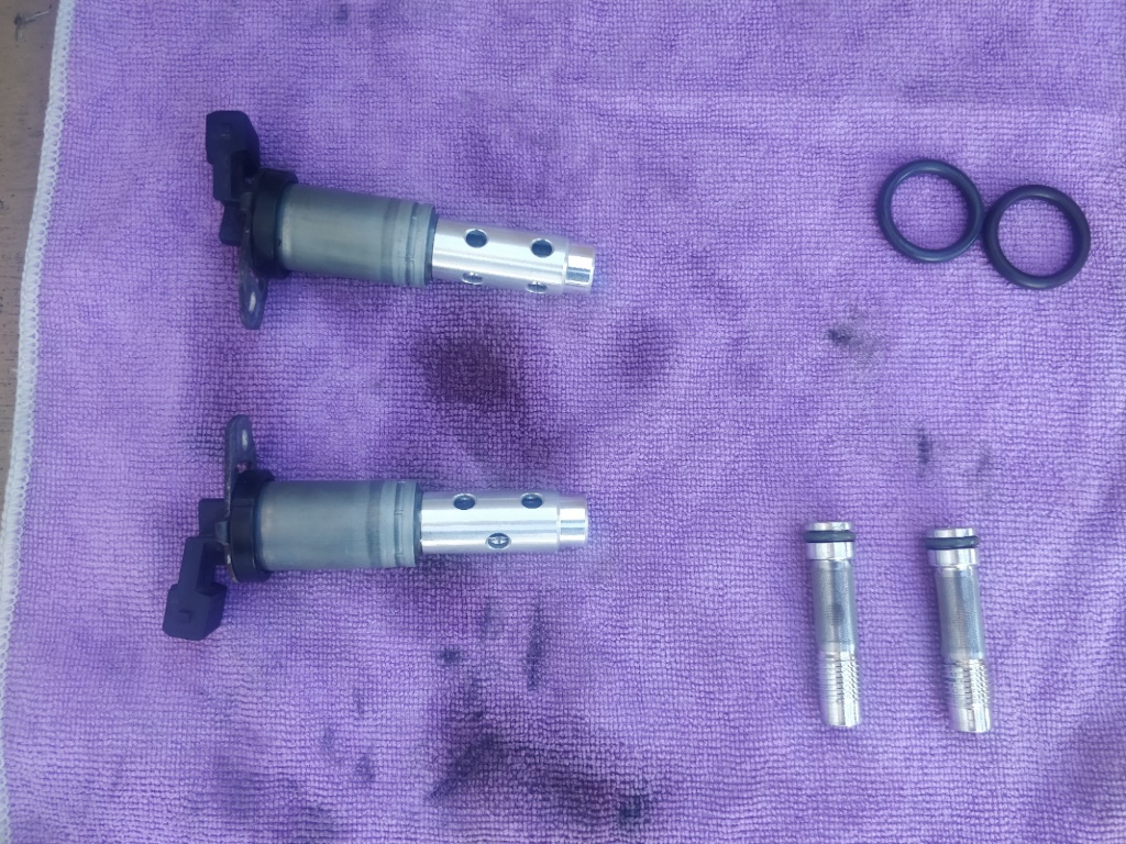

M3AN 4191 Report post Posted August 30, 2020 (edited) It's running seriously sweet now, the replacement O2 sensor worked a treat, no engine codes. ? I took the opportunity to clean the VANOS solenoids and filters and they came up primo, a perfect match for the fresh oil. I took it for a spin this afternoon and damn it drives and pulls nice now, it idles dead even (@650) and pulls cleanly right up to redline and you can really feel the lump of torque come on mid-range. Valve cover gasket has been replaced recently too and it's weeping slightly from the sump gasket as expected but no proper leaks. I agree @qube, I have a Bimmersporter with first option, if that doesn't work out I'll bump up the price and put it out there to see what happens. Edited September 4, 2020 by M3AN Quote Share this post Link to post Share on other sites
