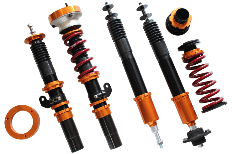

elias 460 Report post Posted March 14, 2022 (edited) Hello, Ive put some coilovers in my e82 135i, and now it seems my spring rate is stiffer than the subframe bushings which makes for an interesting driving experience to say the least. Have seen 2 possible solutions to this, bussing inserts or replacing bushings with solid/poly/m3. Anybody done either of these? Are the inserts any good or best to just go straight to new bushings? Labour seems very very steep on the install been quoted about $1000 for labour. Was thinking of DIY, have done a fair bit of work on my car, including the coilover install obviously but not sure about dropping the whole subframe... if anyone here's done it would be interesting to hear how it went, getting the old bushes out and new ones in, photo of car for reference. any advice, experiences etc is much appreciated! Edited March 14, 2022 by elias spelling Quote Share this post Link to post Share on other sites
M3AN 4198 Report post Posted March 14, 2022 I put insets in my E87 with coilovers, to be honest I didn't notice much difference but then my suspension is pretty well sorted and designed for the vehicle. Many of the UK owners swear by them though and they're a lot less expensive than a full bushing kit and trivial to install whereas new bushings is a subframe out job so much more involved. For the sake of ~$120 I'd go for the inserts, if they don't work you'll know soon enough and you could sell them as nearly new when you installed new bushings. But I'm not sure you should be using bushings to compensate for unsuitable springs, can you exchange them? 1 Quote Share this post Link to post Share on other sites
elias 460 Report post Posted March 14, 2022 thanks for the reply, much appreciated, yes can change them, they're not true rear coil-overs spring sits next to the strut, was thinking of putting in some springs from bc coilovers, they recommend 12k for the rear, although I think mine right now might be 12k, not 100% sure will have to check. Just when I hit a bump sometimes it feels like the rear of the car sways Side to side a bit which is a weird feeling. Out of curiosity what suspension are you running? How was the install on the inserts, fairly straight forward? Quote Share this post Link to post Share on other sites
M3AN 4198 Report post Posted March 14, 2022 (edited) Interesting, the swaying could of course be shot bushes and if that's the case inserts won't do much, I'd give them a visual inspection first and shove a screwdriver or other lever in them and give it a wiggle around. My suspension is a JDM custom setup by Orange Wolf with Eibach springs (F: 8kg, R: 10kg), it's high quality and the ride is sublime. Inserts are an easy DIY. Put a jack under the diff, loosen off the bolts but keep them all engaged and then, one-by-one, remove a bolt, lower the jack enough, install inserts, jack back up, insert bolt (keep it loose), move to next bolt, repeat x4. You may need a pry bar to lever the subframe down a little at each corner, it stiffens up as you go around so by the time you get the last one it could be tight. Do the front two, then the rear two IIRC for easiest access. Took me well under an hour (~40 mins) including getting the car up and down. I have Nolathane inserts but I think Super Pro are a smidgen cheaper and just as good. Edited March 14, 2022 by M3AN 1 Quote Share this post Link to post Share on other sites

elias 460 Report post Posted March 14, 2022 47 minutes ago, M3AN said: Interesting, the swaying could of course be shot bushes and if that's the case inserts won't do much, I'd give them a visual inspection first and shove a screwdriver or other lever in them and give it a wiggle around. My suspension is a JDM custom setup by Orange Wolf with Eibach springs (F: 8kg, R: 10kg), it's high quality and the ride is sublime. Inserts are an easy DIY. Put a jack under the diff, loosen off the bolts but keep them all engaged and then, one-by-one, remove a bolt, lower the jack enough, install inserts, jack back up, insert bolt (keep it loose), move to next bolt, repeat x4. You may need a pry bar to lever the subframe down a little at each corner, it stiffens up as you go around so by the time you get the last one it could be tight. Do the front two, then the rear two IIRC for easiest access. Took me well under an hour (~40 mins) including getting the car up and down. I have Nolathane inserts but I think Super Pro are a smidgen cheaper and just as good. right ok yeah maybe the bushings are just shot, I will check, car has done 130,000km. interesting that your setup seems to be much softer front springs than mine, Ive got a set of Aragosta coilovers, look quite similar to yours actually but a bit different, also JDM, with Rana springs(come with aragosta's) which I bought second hand after a guy removed them from a jap import car so it would pass compliance, if im not stupid, my front springs say 14k on them which seems insane compared to yours... and strange have front stiffer than rear, from what I can tell its 14k front 12k rear, might have to change front springs, I wonder how that would affect the damping though. Might have to give those inserts a go then, fcp sells the whiteline ones for about 50usd$, about 120nzd by the time its here, might be worth a go. Definitely strange about the spring rates, the fronts do feel very very stiff Quote Share this post Link to post Share on other sites
