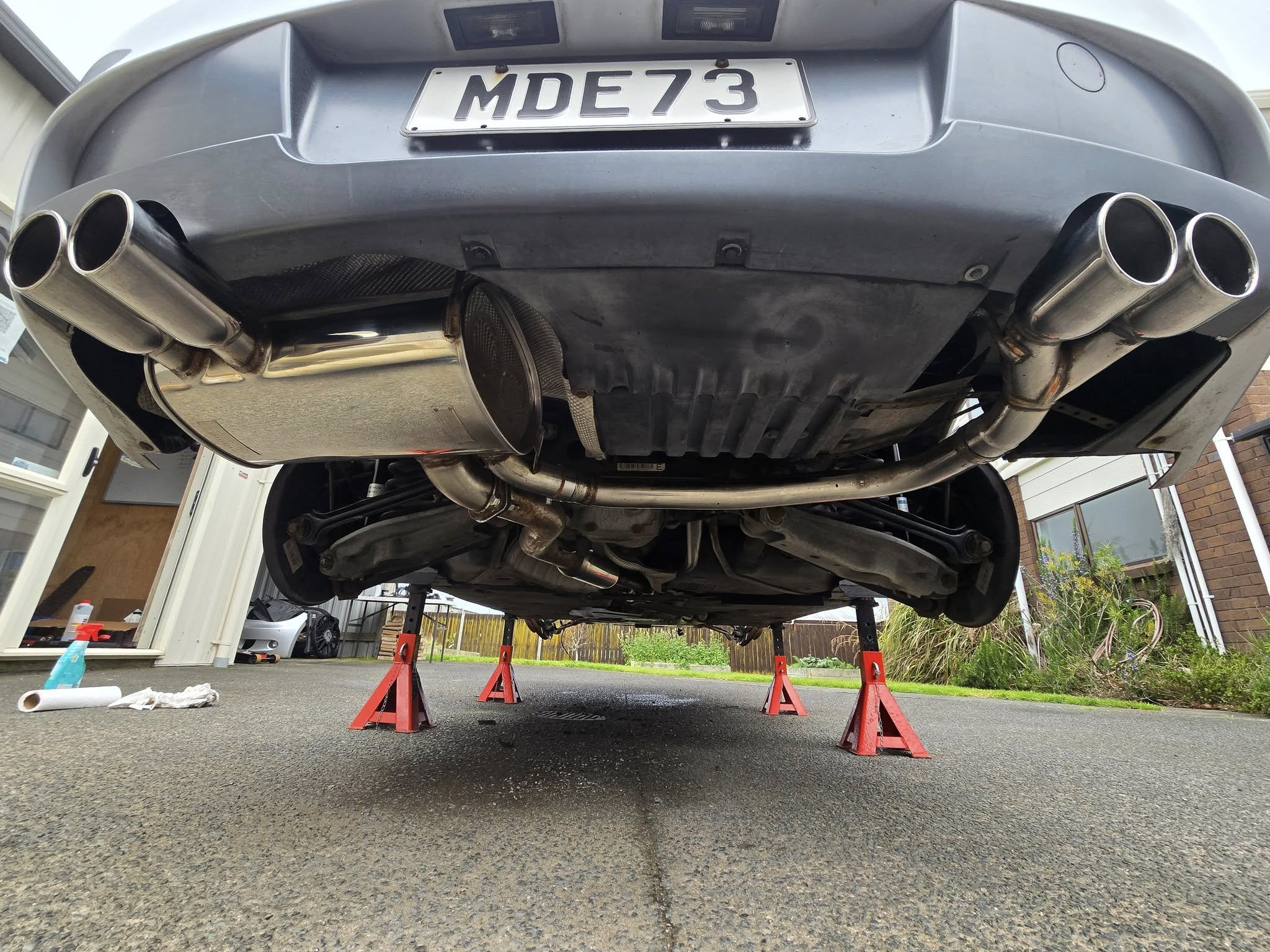

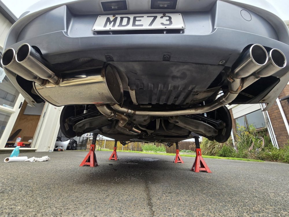

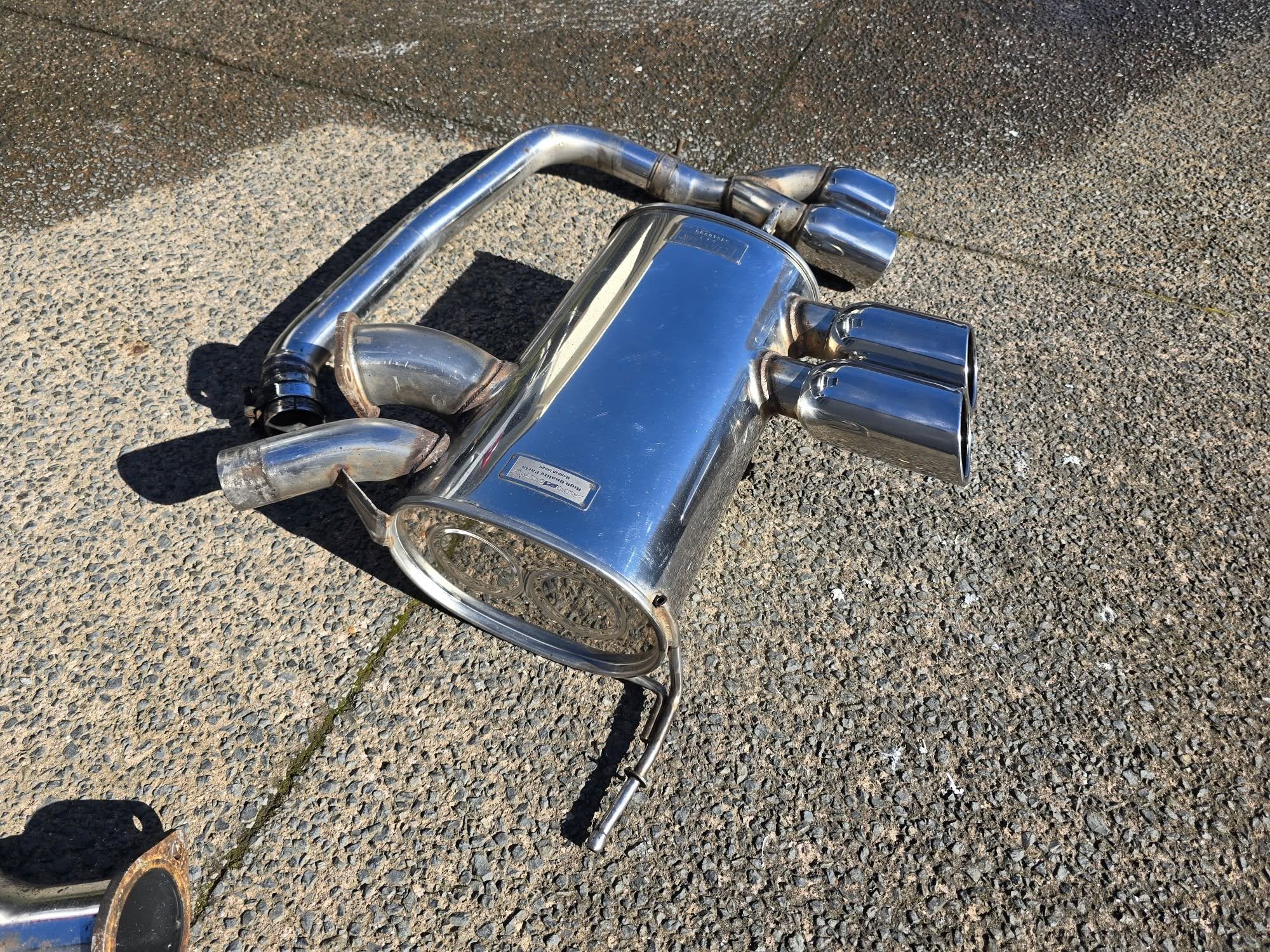

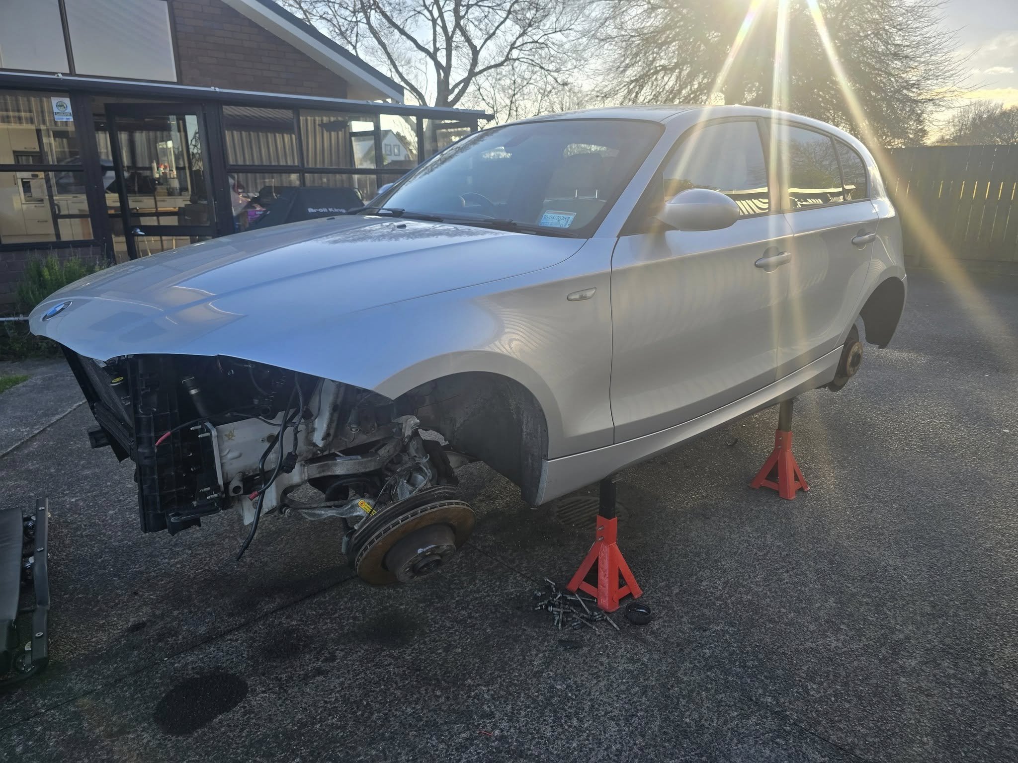

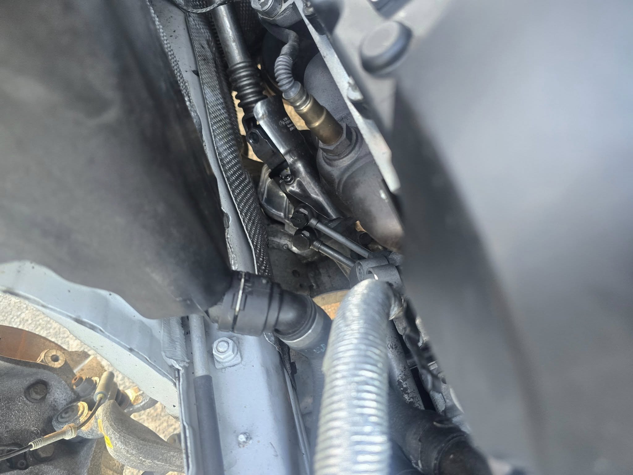

On topic - After finding new exhaust parts - I've only just realised that the exhaust on 130s is different diameters before the stock center resonator, 50 and 55mm, monday morning mind blown.
  • Like 2
I found that out to recently also but its not exclusive to 130i's. At least the M52\M54's in E36\46\39\60's all had 45mm and 50mm (which went all the way to rear in E36 and E46 true twin pipe).
Not exactly sure what the logic behind it is.
I made a clean spot, then the rest of it looked terrible, so made another one... then had to stop myself... that'll do Donkey :D
Despite the stupidity, call it period correctness, of the 4 tips its a actually really well made exhaust.
  • Like 6

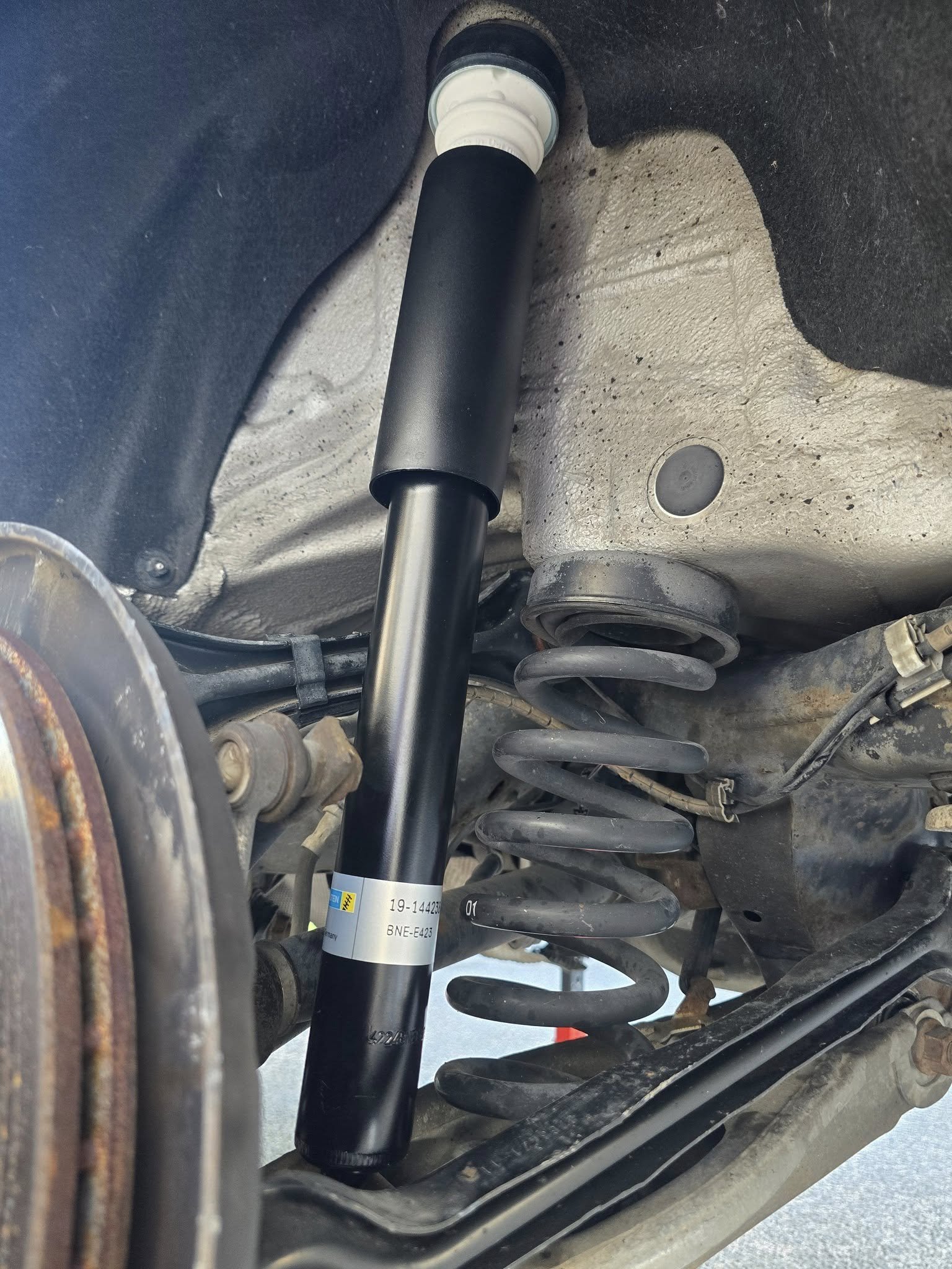

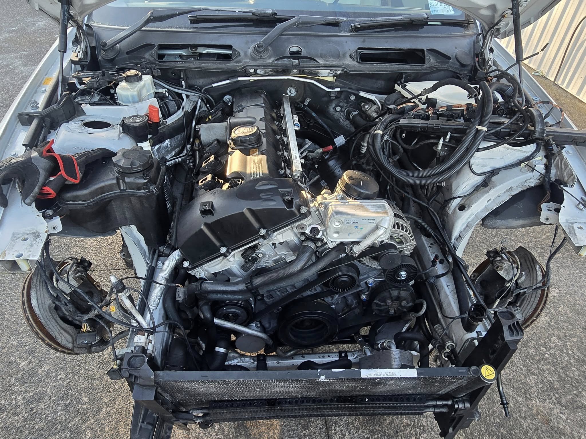

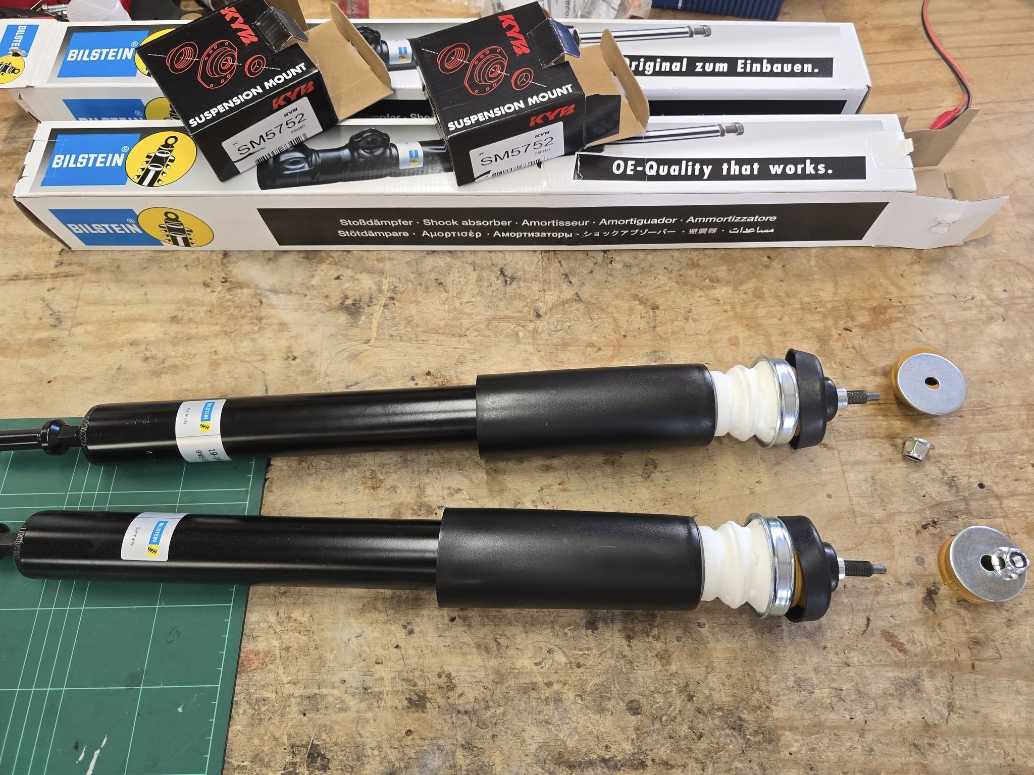

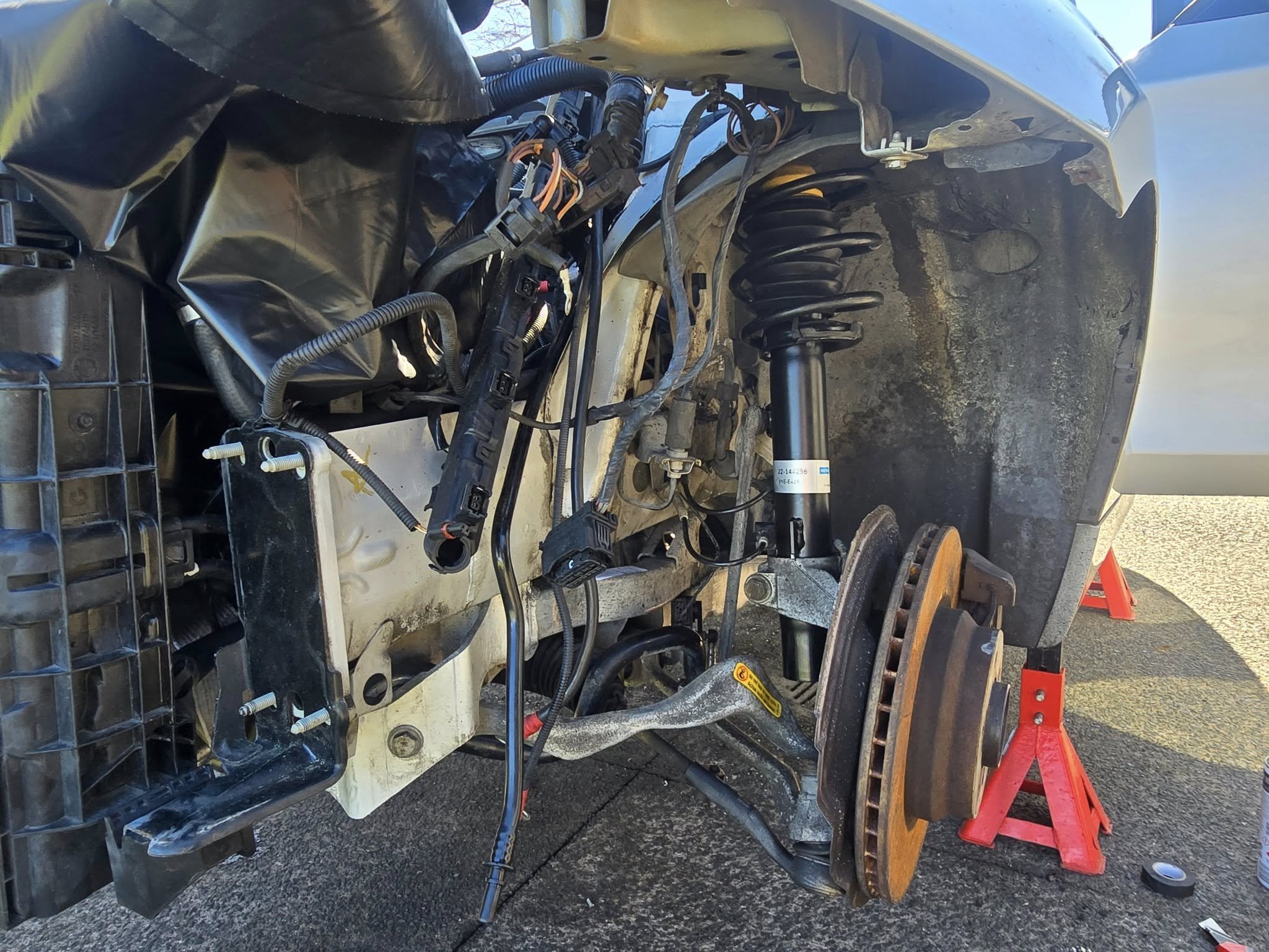

Decided to follow the manufacturers suggested bump stop install, may work slightly better...

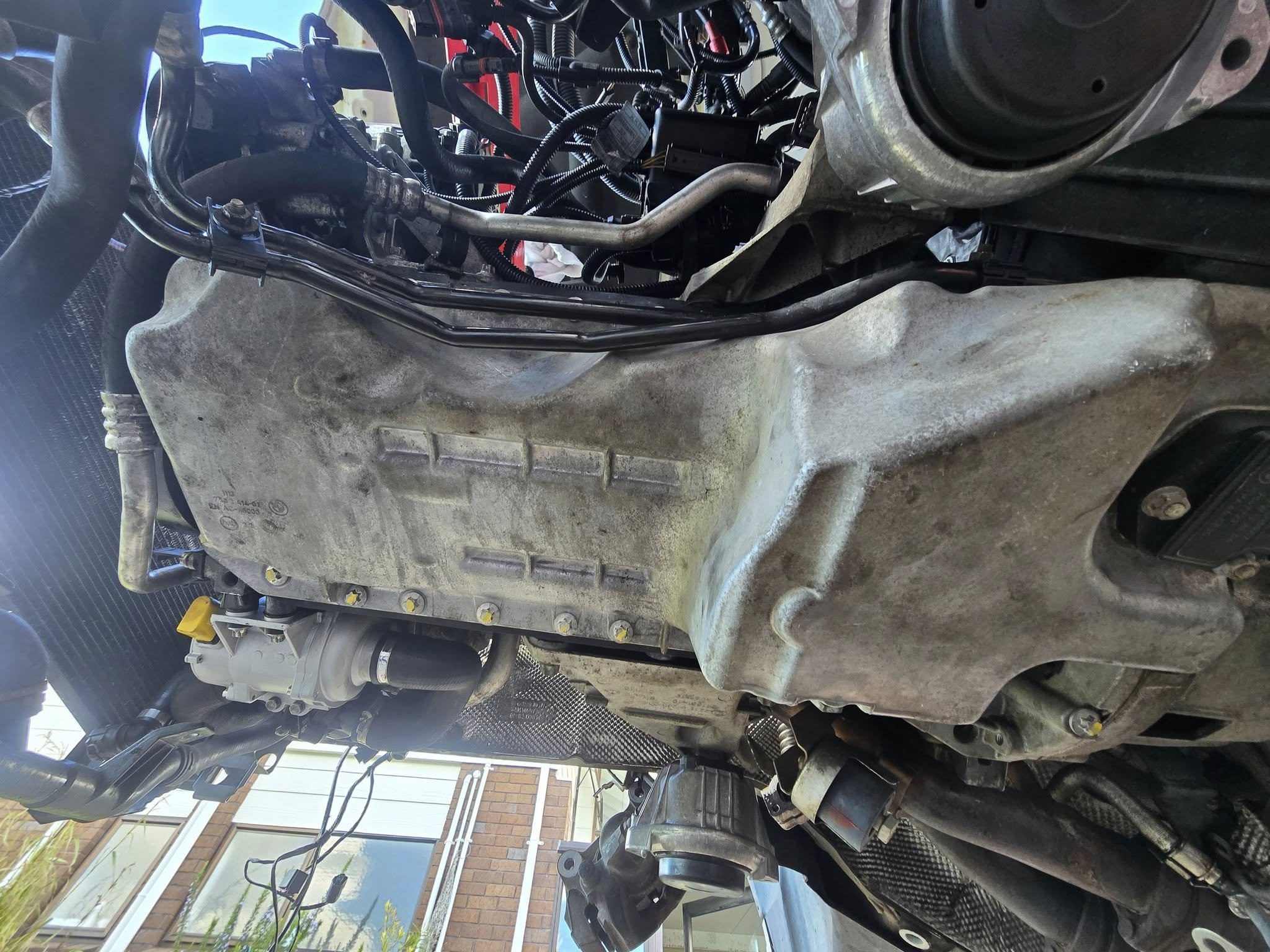

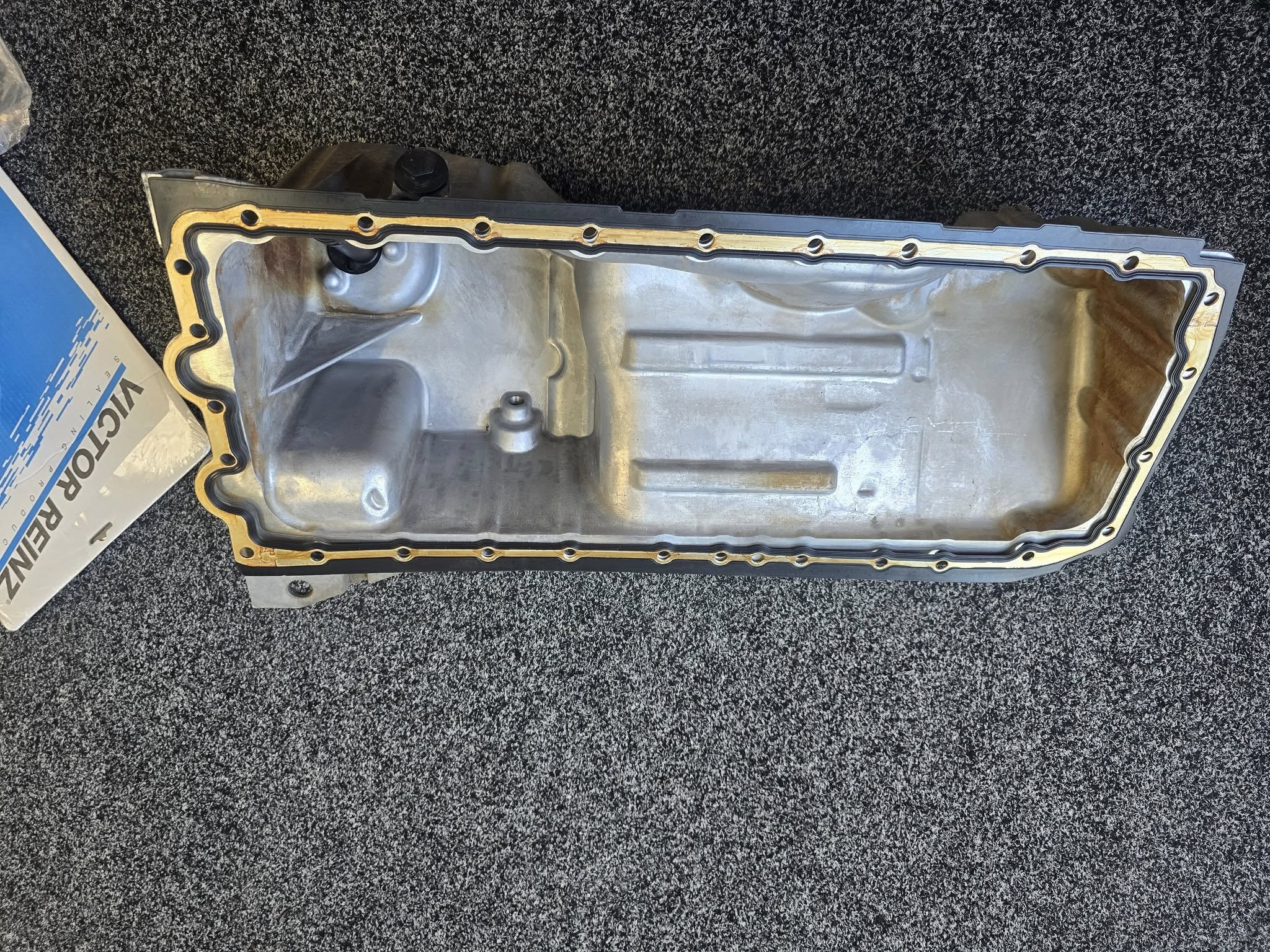

Sump on, for some reason this one was a bitch to get on. Fourth n52 sump I've done but first auto 130, dunno if was the transmission cooler line location or my torn shoulder tendons (still recovering from bike crash) but there was a few more four letter words than "sump" and "auto" used in installation.

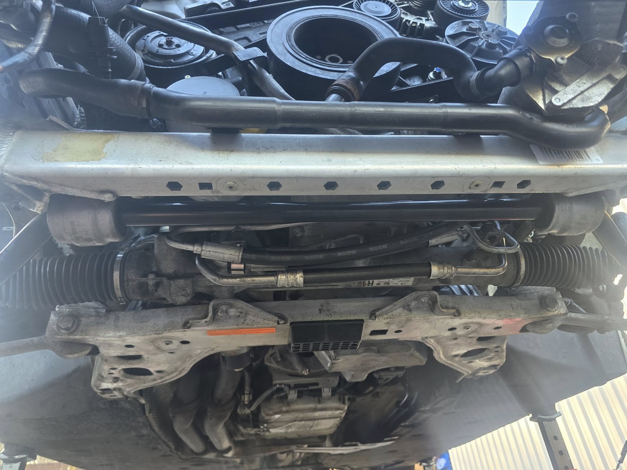

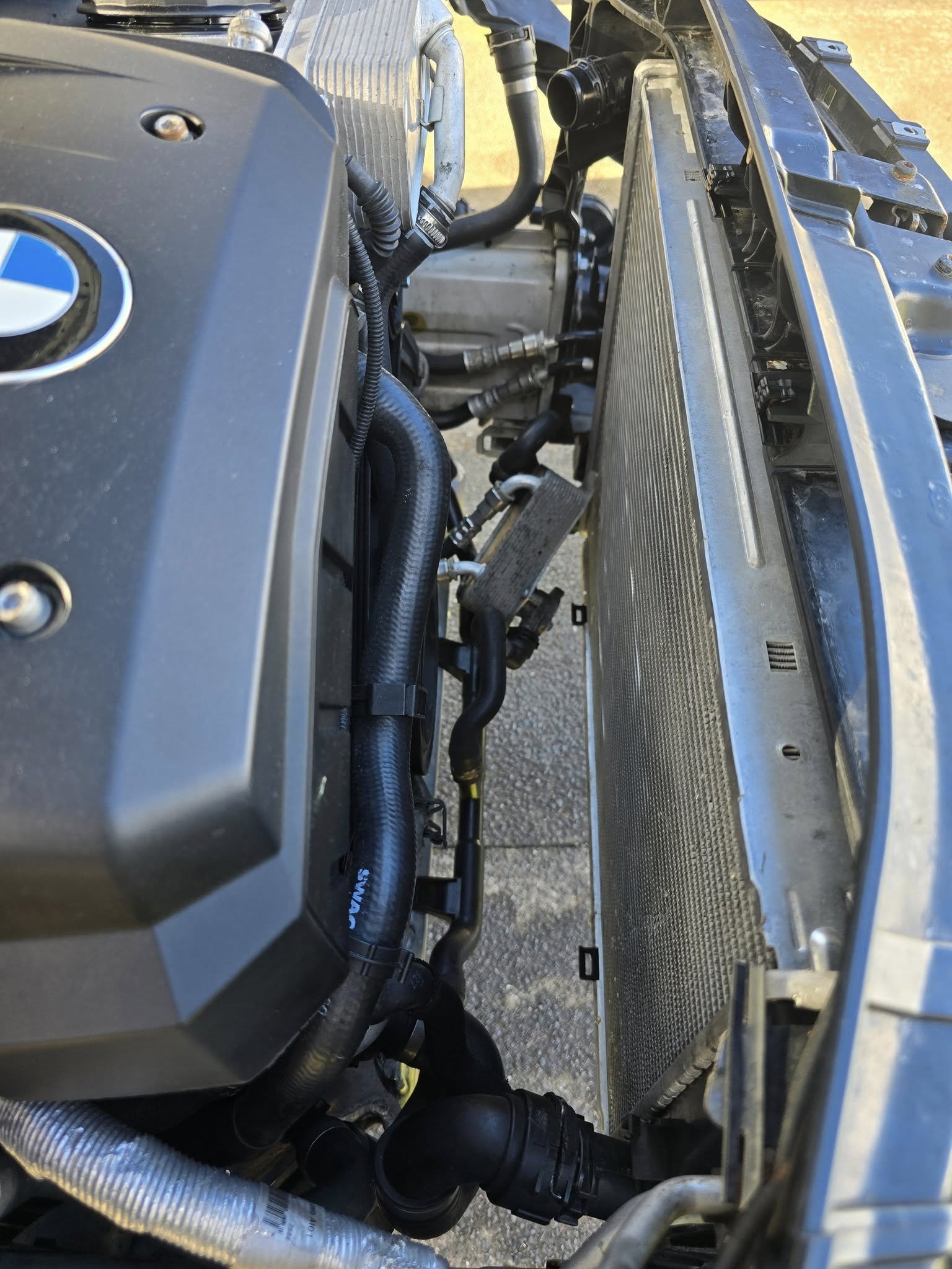

Front subframe can now go on and will get some real progress.
