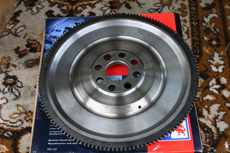

bravo 34 Report post Posted October 16, 2006 This pic shows a flywheel with quite a step on it I can't for the life of me remember how much of a step mine had to start with. The above flywheel is not off an m20 but looks very similar. I'm surprised no-one here knows. Bloody frustrating to say the least. Quote Share this post Link to post Share on other sites
Guest Ken Report post Posted October 16, 2006 Just a thought and any "real" engineers out there may well dismiss this but my flywheel has drilled indentations around the periphery for balancing purposes. Therefore, would providing a raised portion allow you to resurface without cutting into the area with the balancing indentations? If so, the height of the lip shouldnt really matter, so long as the overall thickness of the flywheel is within whatever specifications you can find. Quote Share this post Link to post Share on other sites
