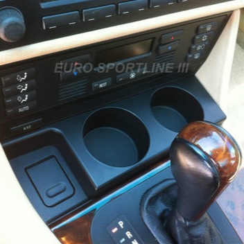

jeffbebe 1587 Report post Posted March 29, 2012 I've got a '96 E39 528i as with most of the E39's the rubbish cup holder doesn't work anymore. I've replaced the rear one with coin storage but have searched endlessly for a decent after market front cup holder. I don't want a springloaded one that pops out of the ashtray. I don't want a crap plastic one that hooks to the side of the seat. I want one that looks genuine and fits where the old one is. Well I found one that looks absolutely perfect and it's only about NZ$30 inc shipping on eBay. It looks like this installed: But can I find one for a RHD car?! No, not anywhere. If anyone knows where I can get a RHD version of this slick aftermarket cup holder I'll be absolutely stoked! Quote Share this post Link to post Share on other sites

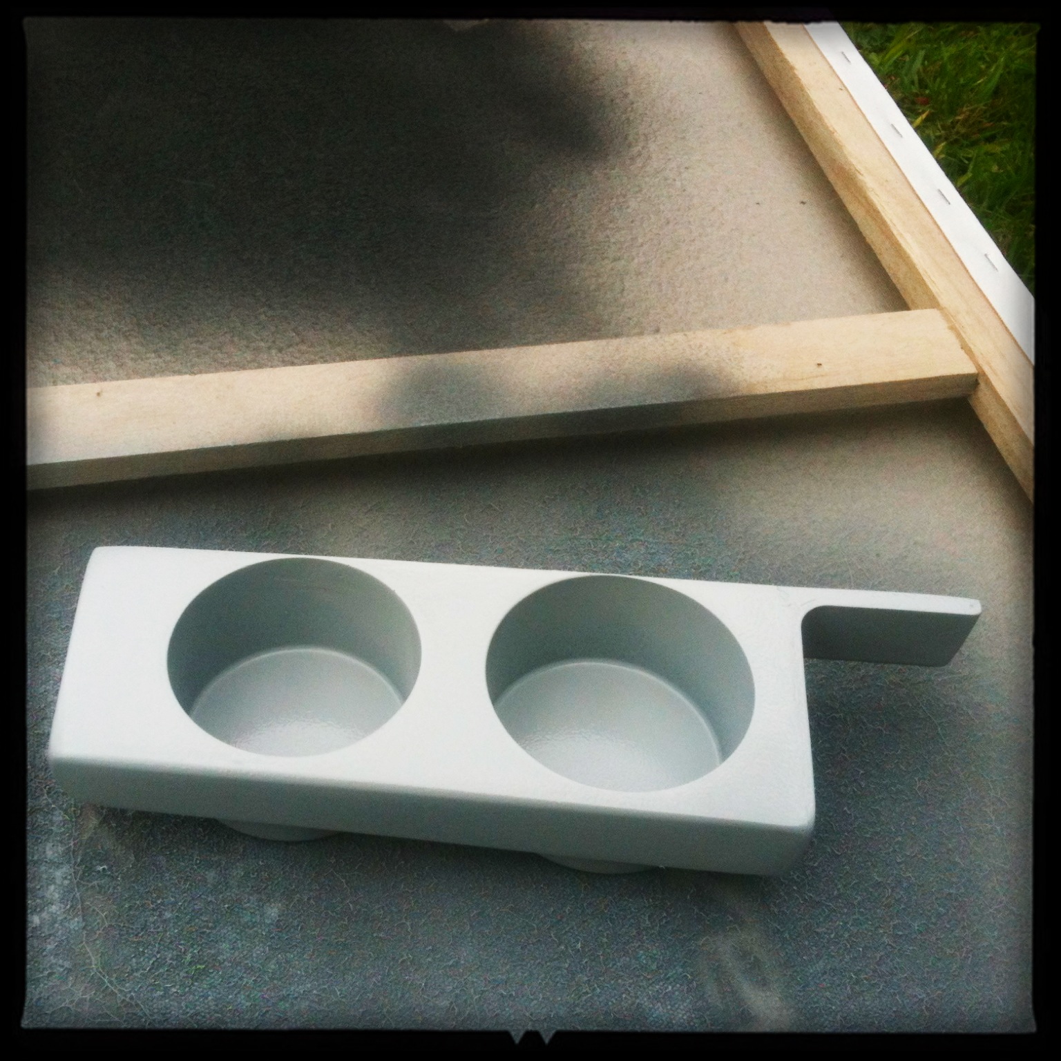

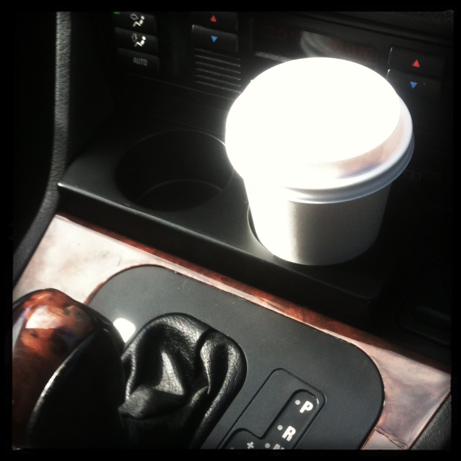

jeffbebe 1587 Report post Posted April 21, 2012 So, in the end I decided to buy the one I liked from ebay for an LHD car and DIY modify it to fit my RHD E39. Here's a quick how to [moderators, feel free to put this in the DIY section]. I'm pretty happy with the results: 1) This is what I bought (cost about NZ$25 incl shipping): 2) I cut the sides off with a fine tooth hacksaw and glued the pieces back together to fit the space for a right hand drive car. Then filled any gaps, etc with some plastic putty (bought some cheap sandable filler from Mitre 10) and sanded to shape with fine grain sandpaper - sorry, only thought to take pics when I was almost finished: 3) Primed with cheap off the shelf spray paint (this will highlight any bumps/cracks in your filler and sanding so you can fix those up before the final coat of paint): 4) Finished with 3 coats of matte black (cheapest I could find) spray paint: 5) Fixed in place with a bit of 3M tape on the underside - not ideal but effective - and here's the finished result which I'm very happy with. As you can see it'll hold a bigger latte size coffee cup, the passenger holder is slightly smaller as the tray is narrower but will still hold a coke can or long black size coffee cup: Quote Share this post Link to post Share on other sites
