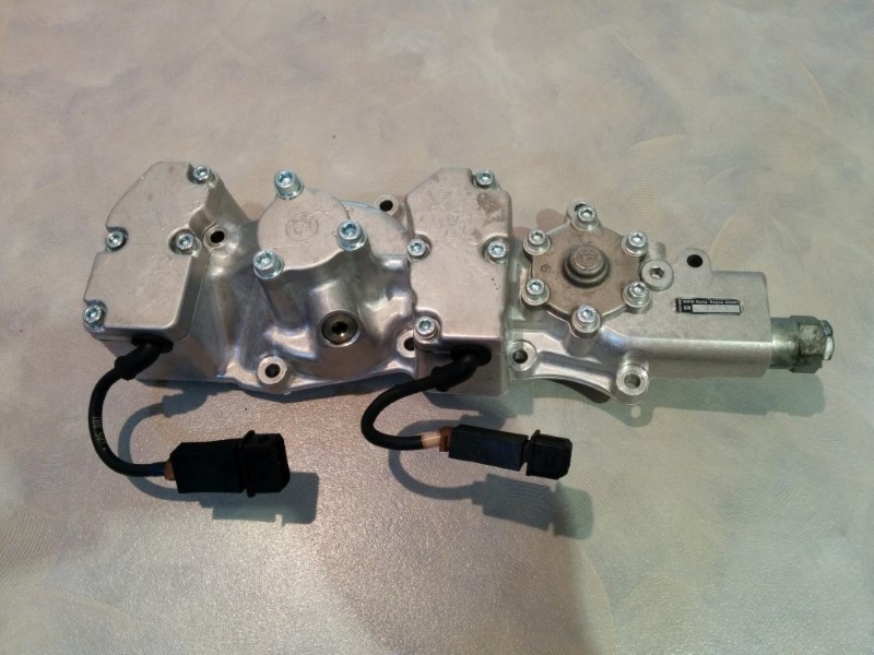

M3AN 4201 Report post Posted January 17, 2015 (edited) Who knew you could borrow a S50 double VANOS unit? Hoping to get this in tomorrow if it proves necessary after some more investigation. Cheers Mark. Edited May 13, 2018 by M3AN Quote Share this post Link to post Share on other sites

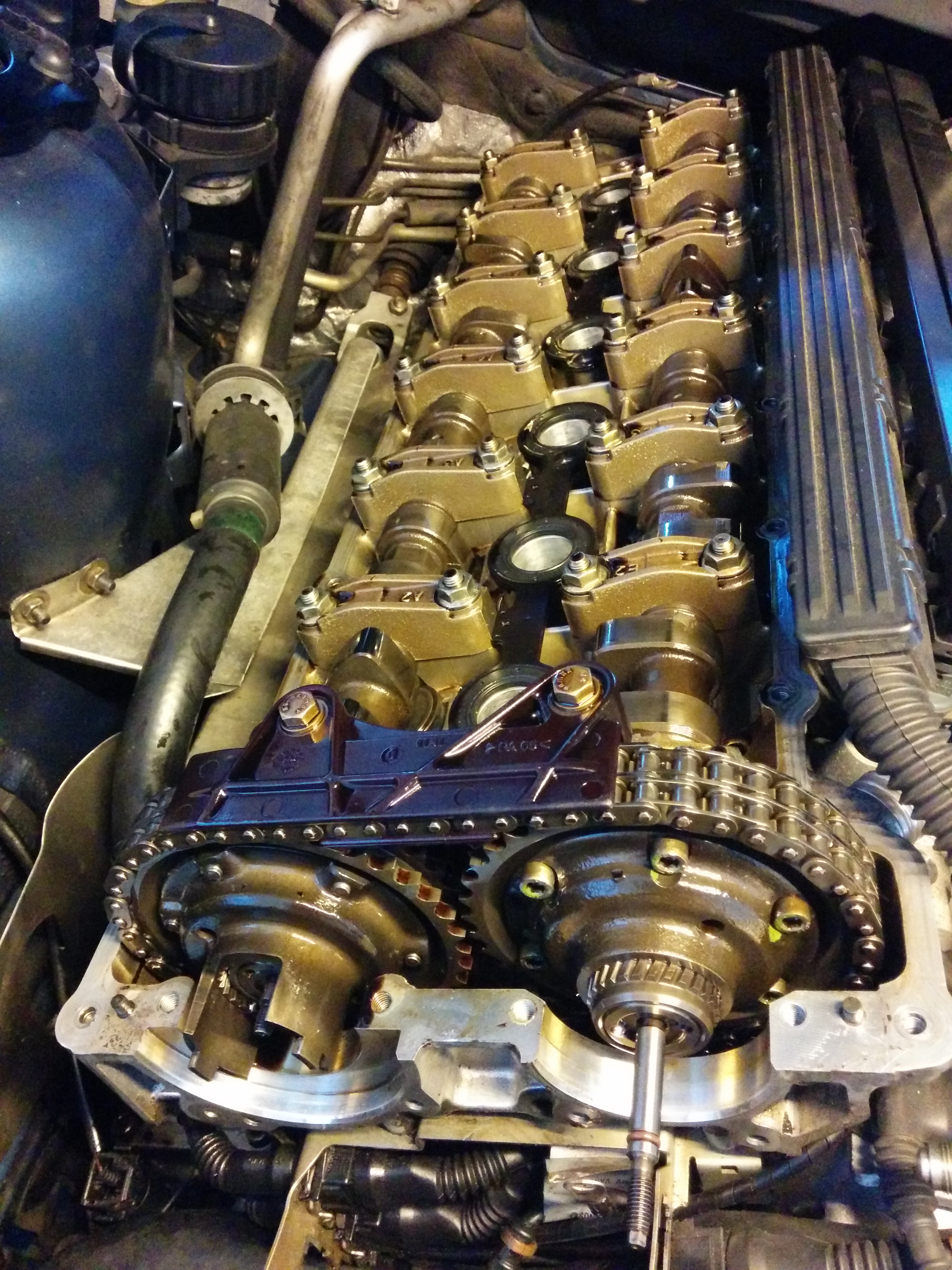

M3AN 4201 Report post Posted January 18, 2015 (edited) Here we go again... Edited May 13, 2018 by M3AN Quote Share this post Link to post Share on other sites

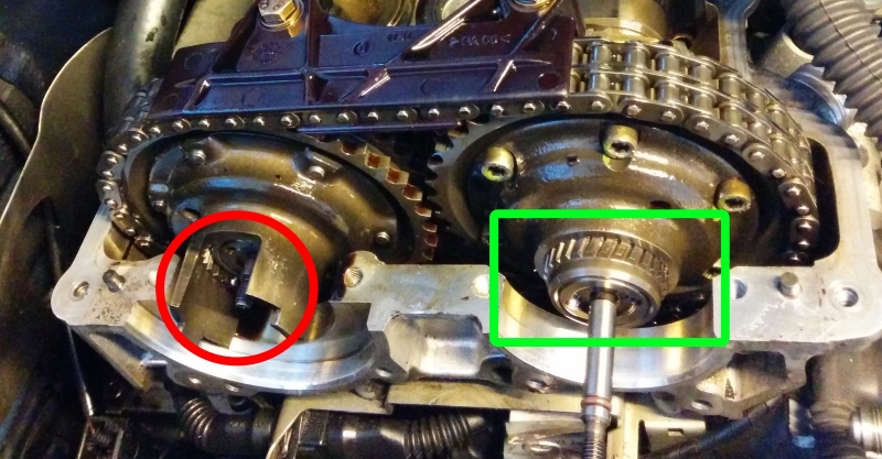

M3AN 4201 Report post Posted January 18, 2015 (edited) Those with keen eyes that know VANOS might spot the difference... the "depth" of the splined shaft in the red circle should be similar (ish) to the one in the green rectangle. It should protrude some. Also when we took the cap off the exhaust cylinder cover on the VANOS it blew out pressurised oil which indicates that the exhaust solenoids had failed closed (or open, I'm not sure actually). I think I'll need to remove the exhaust cam tomorrow to get to that shaft but it is what it is, then I'll re-time and chuck the new VANOS on. Edited May 13, 2018 by M3AN Quote Share this post Link to post Share on other sites
BreakMyWindow 2004 Report post Posted January 18, 2015 Plenty of evidence the oil services have been religiously done. Very clean in there. Quote Share this post Link to post Share on other sites
M3AN 4201 Report post Posted January 18, 2015 Yeah, I've owned it for most of its life (>2/3) and have been pretty meticulous with as much as I can. However I pulled my plugs today as a part of this procedure and they all had shocking gaps and need to be replaced immediately. I learned I need to check them more frequently and also check my last Inspection 1 receipt. Quote Share this post Link to post Share on other sites
