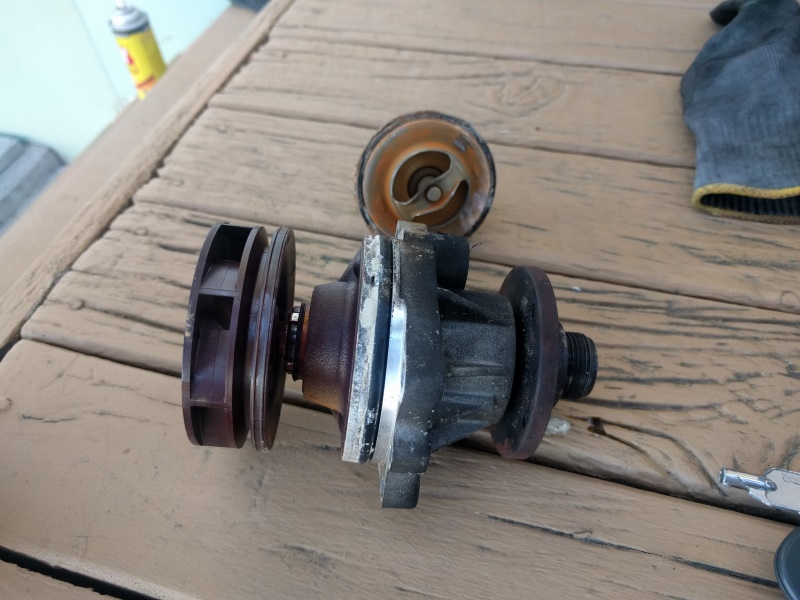

M3AN 4160 Report post Posted September 27, 2016 (edited) Second thing I did was blow up the radiator (was already dodgy) so, planning to overhaul the entire cooling system I ordered a new thermostat, aluminium housing for said and water pump which have all arrived from schmiedmann.com (4 days!). I'm still considering my radiator options but will get that locally. Radiator, trans cooler, expansion tank have been removed. Fan is still stuck on. :-/ All the the "coolant" was just rusty water. Need to drain the block next. It already had a newish expansion tank and an aluminium thermostat housing so it might also have a new pump but hey, peace of mind when it comes to e36 cooling right? Edited October 16, 2016 by M3AN Quote Share this post Link to post Share on other sites

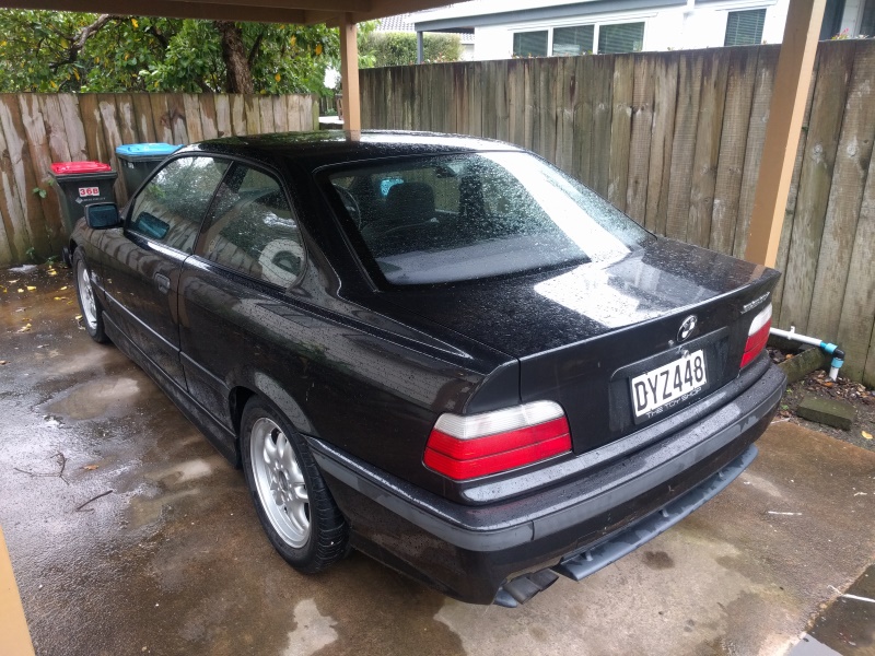

M3AN 4160 Report post Posted September 27, 2016 Purchased some vanity items also: 1 x rear lip spoiler as per E39 M5 - it's arrived and looks great, yet to be installed. 1 x set of matt black 'facelift' kidney grills for the pre-facelift front panel. Hopefully they fit well Silly expenditure really but I really do dislike the pre-facelift grills and I've always liked the lip spoilers on a the E36. Less than $100 for the lot, cheap and cheerful. Quote Share this post Link to post Share on other sites

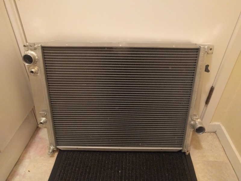

M3AN 4160 Report post Posted September 29, 2016 (edited) New and with with alu end tanks to boot. Purdy... Thanks to @richard for a good deal and great chat! He even threw in a fan cowl which I needed and some ancillaries I can probably reuse. Now, just gotta get that fan off! Edited May 29, 2018 by M3AN 3 Quote Share this post Link to post Share on other sites
BatMansWilly 74 Report post Posted September 29, 2016 1 hour ago, M3AN said: New and with with alu end tanks to boot. Purdy... Thanks to @richard for a good deal and great chat! He even threw in a fan cowl which I needed and some ancillaries I can probably reuse. Now, just gotta get that fan off! Looks nice! What did that set you back? If you don't mind me asking? Just sizing? Quote Share this post Link to post Share on other sites
M3AN 4160 Report post Posted September 29, 2016 12 minutes ago, BatMansWilly said: Looks nice! What did that set you back? If you don't mind me asking? Just sizing? NP. $200 including fan cowl, expansion tank, level sender and ancillary hoses. Really good value! Tank and sender are surplus to requirements and available if anyone needs them. Quote Share this post Link to post Share on other sites
E36_Turbo 84 Report post Posted September 29, 2016 2 hours ago, M3AN said: New and with with alu end tanks to boot. Purdy... Thanks to @richard for a good deal and great chat! He even threw in a fan cowl which I needed and some ancillaries I can probably reuse. Now, just gotta get that fan off! Awesome project mate, looking forward to seeing what you do with it ?, where on earth did you source this radiator? Quote Share this post Link to post Share on other sites
M3AN 4160 Report post Posted September 29, 2016 8 minutes ago, E36_Turbo said: Awesome project mate, looking forward to seeing what you do with it ?, where on earth did you source this radiator? Cheers bud, hoping it'll turn out okay for a thrash around auto lol! The rad came from a BS member here Richard. He got it new but wasn't suitable for his (cool) race car build so was just gathering dust in his (cool) workshop. And if you think this is sweet you should see his BBK... lust. 6 pot Wilwoods front and rear. They're absolutely massive and and for only $2k. OMG!!! 1 Quote Share this post Link to post Share on other sites
E36_Turbo 84 Report post Posted September 29, 2016 17 minutes ago, M3AN said: Cheers bud, hoping it'll turn out okay for a thrash around auto lol! The rad came from a BS member here Richard. He got it new but wasn't suitable for his (cool) race car build so was just gathering dust in his (cool) workshop. And if you think this is sweet you should see his BBK... lust. 6 pot Wilwoods front and rear. They're absolutely massive and and for only $2k. OMG!!! Arghh! It looks the business though! I was looking at something like this from CES motorsport in the U.S....Wilwoods are worth a fair bit, for a complete setup, that's just awesome haha. Will you be converting it to manual or keep it as auto ? 1 Quote Share this post Link to post Share on other sites
M3AN 4160 Report post Posted September 29, 2016 8 minutes ago, E36_Turbo said: Arghh! It looks the business though! I was looking at something like this from CES motorsport in the U.S....Wilwoods are worth a fair bit, for a complete setup, that's just awesome haha. Will you be converting it to manual or keep it as auto ? Keeping it auto for the time being, fine for a commuter. I think you can get full alu radiators here in NZ, check out some of the Trademe suppliers. Quote Share this post Link to post Share on other sites
*Glenn* 856 Report post Posted September 29, 2016 8 hours ago, M3AN said: New and with with alu end tanks to boot. Purdy... Thanks to @richard for a good deal and great chat! He even threw in a fan cowl which I needed and some ancillaries I can probably reuse. Now, just gotta get that fan off! Make sure you ground it properly and use a good quality type coolant...I would suggest flush the system and use 3 bottles of BMW coolant. 1 Quote Share this post Link to post Share on other sites
richard 384 Report post Posted September 29, 2016 7 hours ago, E36_Turbo said: Awesome project mate, looking forward to seeing what you do with it ?, where on earth did you source this radiator? you can get them from here in Penrose http://www.redlineperformance.co.nz/ Quote Share this post Link to post Share on other sites
BatMansWilly 74 Report post Posted September 29, 2016 12 hours ago, M3AN said: NP. $200 including fan cowl, expansion tank, level sender and ancillary hoses. Really good value! Tank and sender are surplus to requirements and available if anyone needs them. That's a good price, let us know how the install goes! Quote Share this post Link to post Share on other sites

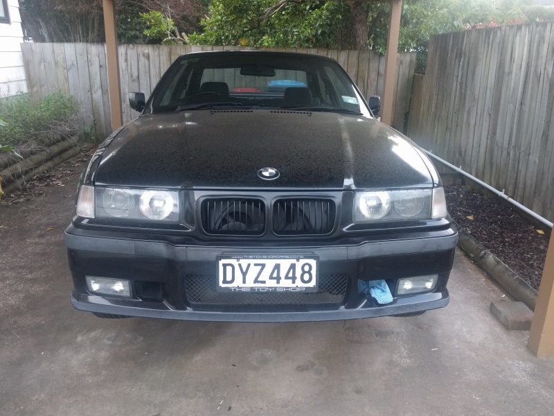

M3AN 4160 Report post Posted October 6, 2016 (edited) Exciting... lol. Black grills. Facelift type for the pre-facelift panel. They look heaps better I reckon. Not a perfect fit but cheap as chips. Edited May 29, 2018 by M3AN Quote Share this post Link to post Share on other sites

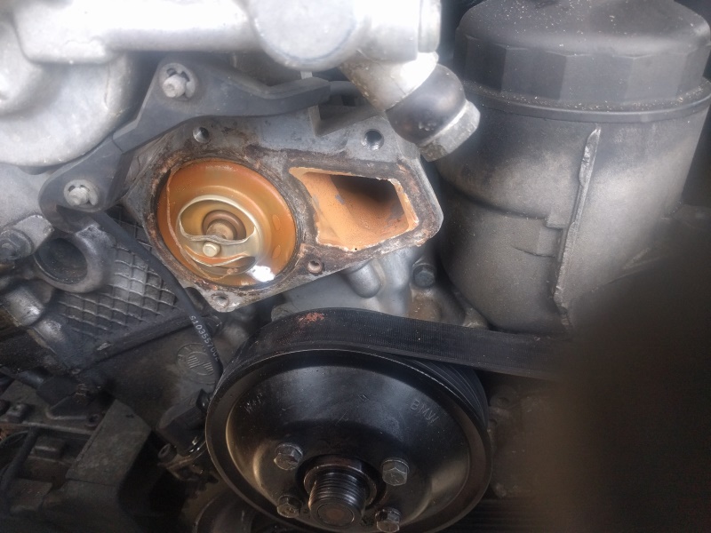

M3AN 4160 Report post Posted October 8, 2016 (edited) So I finally got the fan off thanks to Brad suggesting my access and leverage could be better with blades off. Duh. I didn't know you could take them off from the front. Not very pretty but it's all being replaced... Genuine BMW composite water pump, no axial play but you can never tell with these things. And boy I tell you want, it's a PITA with the "large" radiator that they chose to wind two hoses through the fan cowl. Even though I was replacing all of the hoses it's a massive challenge getting the hoses, clamps, cowl and expansion tank all in at the same time. Hint: assemble expansion tank, both tank hoses and cowl together as one then install after radiator into car, finally attach tank hoses to radiator overflow and engine block (remove airbox). But I still can't flush it because the damn threads on the temp sensor socket need to be chased, I can't screw the sensor in. Threads themselves look fine but there's a bit of a lip at the front that prevents engagement. So it's mostly reassembled and if I get time between chores and Bathurst tomorrow I'll finish it and flush. Otherwise Monday which I've taken off to recover from Bathurst, Japanese F1 and UFC 204 tomorrow (13+ hours of sport). Edited May 29, 2018 by M3AN 1 Quote Share this post Link to post Share on other sites
