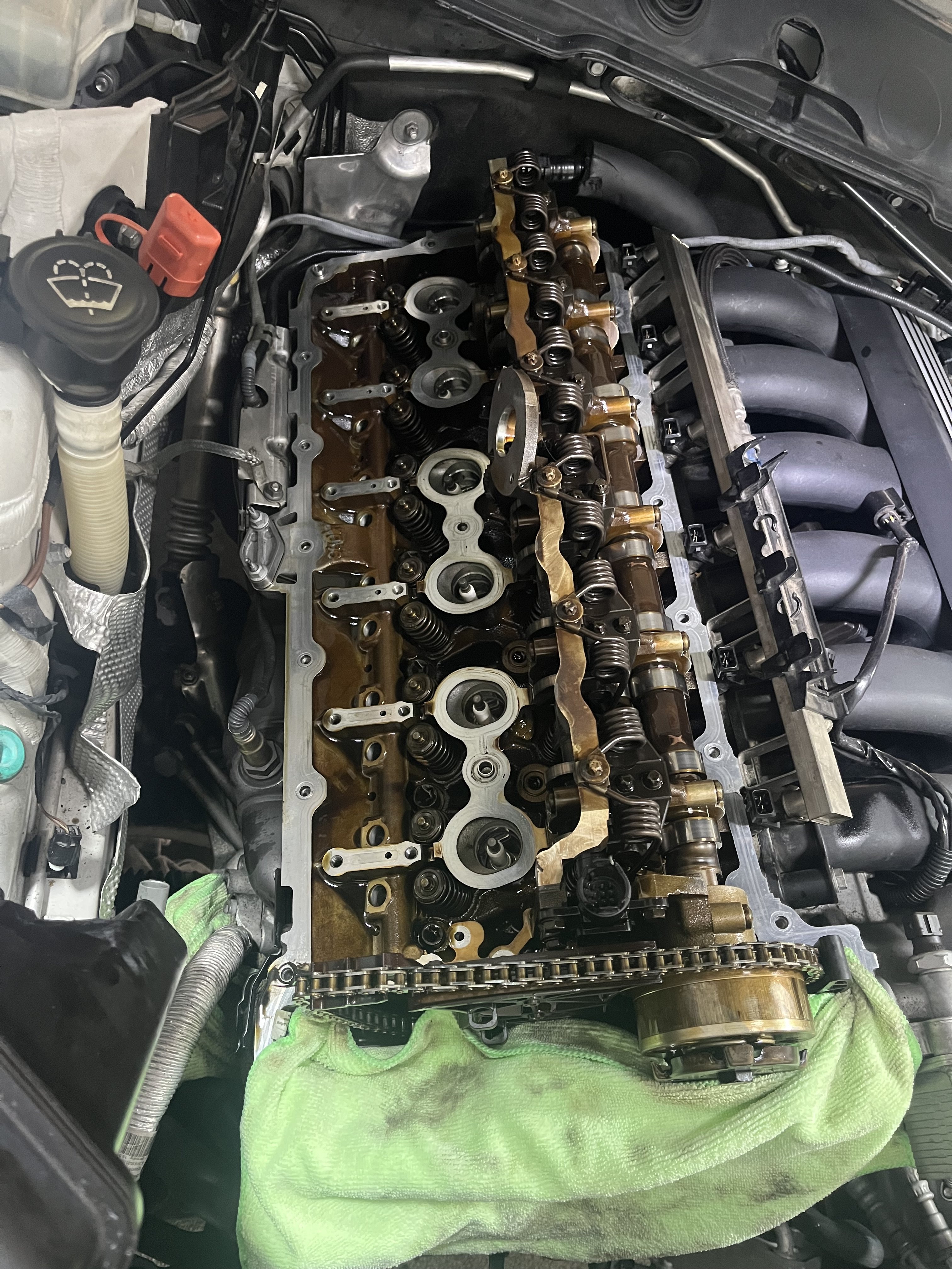

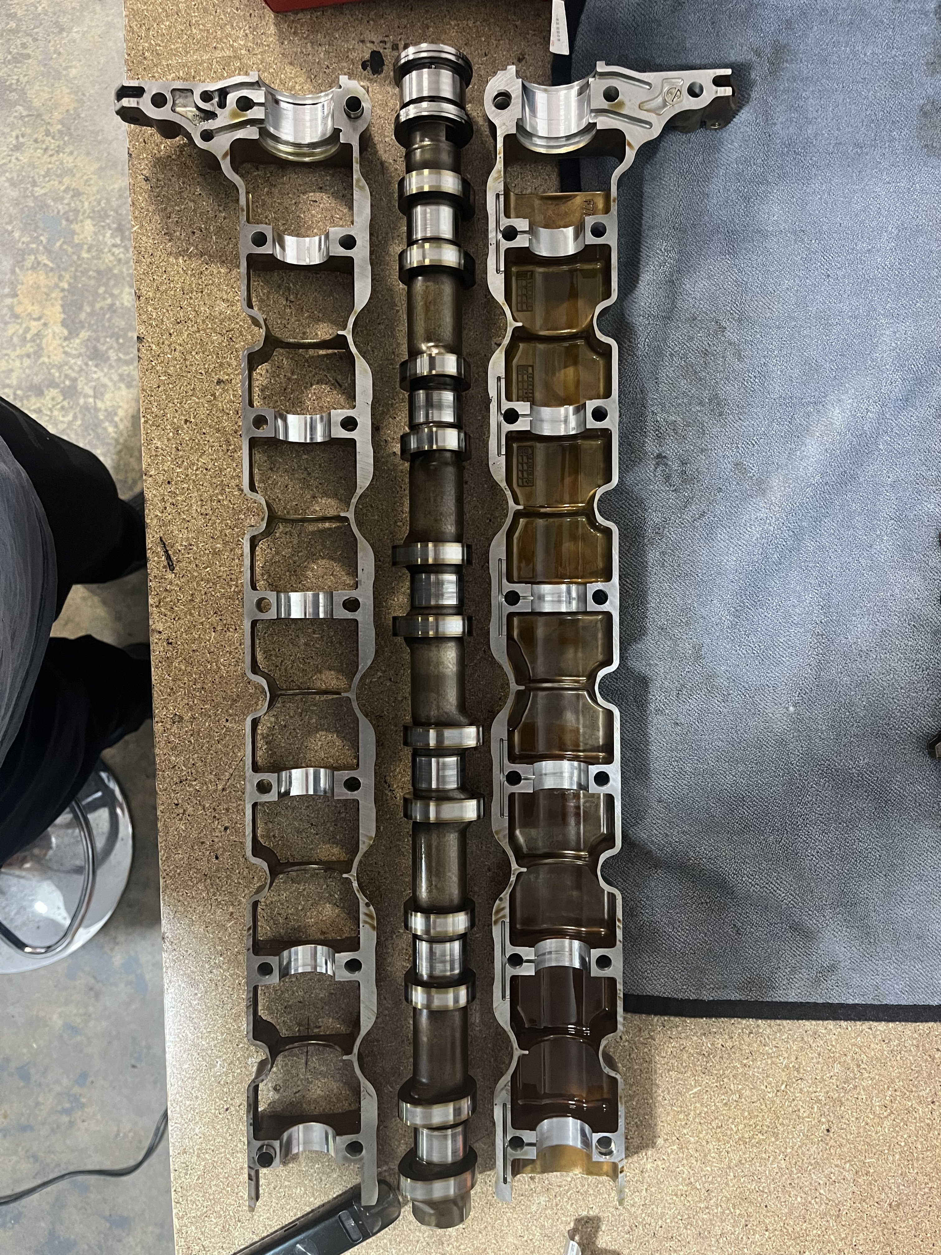

BreakMyWindow 2003 Report post Posted June 10 Been working away at rescuing this 08’ auto that had a suspected stretched timing chain. Turns out it’s got the same issue as my black one - Worn out exhaust cam bearings. A few little cosmetic things to do and she’ll be up for sale. IMG_4681.mov Quote Share this post Link to post Share on other sites
Driftit 2250 Report post Posted June 10 What's the symptoms it shows when this occurs? Quote Share this post Link to post Share on other sites
Driftit 2250 Report post Posted June 10 Also Some nice Pagids for the stock size caliper on TM. https://www.trademe.co.nz/a/motors/car-parts-accessories/bmw/brakes/listing/5358529014 Good for a track focused 130i. Quote Share this post Link to post Share on other sites
BreakMyWindow 2003 Report post Posted June 10 22 minutes ago, Driftit said: What's the symptoms it shows when this occurs? Have a listen to the video Quote Share this post Link to post Share on other sites
Driftit 2250 Report post Posted June 10 12 minutes ago, BreakMyWindow said: Have a listen to the video Ah you could easily mistake that for multiple lifters having failed. Is this due to infrequent oil servicing? Quote Share this post Link to post Share on other sites
TPO130i 14 Report post Posted June 10 1 hour ago, Driftit said: Also Some nice Pagids for the stock size caliper on TM. https://www.trademe.co.nz/a/motors/car-parts-accessories/bmw/brakes/listing/5358529014 Good for a track focused 130i. Thanks for that. They're actually on special at the moment at Race Brakes for $285 so will probably go that way. Cheers!! Quote Share this post Link to post Share on other sites
BreakMyWindow 2003 Report post Posted June 10 2 hours ago, Driftit said: Ah you could easily mistake that for multiple lifters having failed. Is this due to infrequent oil servicing? Not too sure, possibly low on oil. Last service it had in March i think they only put 4.5l in it, as when I drove it home from Hamilton it pretty much straight away asked for more oil. Checking the level in mm I put 2l in and it was around 72mm at normal temp on a flat surface. 1 Quote Share this post Link to post Share on other sites

BreakMyWindow 2003 Report post Posted June 25 Anyone know what the camshaft bearing ledge journal tolerance specs are? Can’t seem to find anything on the internet or ista. Quote Share this post Link to post Share on other sites
