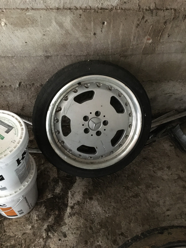

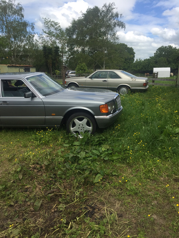

coop 261 Report post Posted September 6, 2020 (edited) I’m running Dunlop spot 300E 205 65 15 on my 560SEL. I was going to go Contis but he did me a decent price on them. Around $140 each off the top of my head. They are quiet but apart from that no comment on how they perform - the car had 18s before it with poor ride quality, and currently the rear SLS shocks are buggerEd so ride quality isn’t what it should be. I have a set of genuine 3 piece 18x8.5 monoblocks in need of a refurb if you may be interested. I think I have some spacers for the front to suit the 126. I don’t know how they’d look on a 126 sedan. I think they’d suit more the c126, 124 or the r129 chassis. My 560 came with replica 18” monoblocks and IMO it looked wrong for two reasons. It needed to be lowered as the profile of the tyre was dwarfed by the huge wheel arch gap. And the rim exposed the tiny rotors and calipers behind it. Edit - Ron, your post above reminds me of something I read from the 80s when these were new. F1 driver, it may have been Senna, was driving the 500 or 560 spec in Europe chasing a 911 and the Porsche couldn’t loose it. But yes, I’ve owned several of these cars including the under tyred 2200kg W140 (16 inch rim) and they can get a bit hairy at a decent pace. Edited September 6, 2020 by coop 1 Quote Share this post Link to post Share on other sites

leichtbau 525 Report post Posted September 18, 2020 On 9/6/2020 at 12:58 PM, coop said: I have a set of genuine 3 piece 18x8.5 monoblocks in need of a refurb if you may be interested. I think I have some spacers for the front to suit the 126. I don’t know how they’d look on a 126 sedan. I think they’d suit more the c126, 124 or the r129 chassis. I'd be tempted to buy another 124 just to fit those, wow! Quote Share this post Link to post Share on other sites
