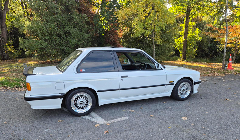

After a fair amount of procrastinating, I finally bit the bullet and took the car for cert.
I used Jody Thompson from Two Six Installation and fabrication in Rolleston - He is fantastic to deal with and I highly recommend his services.
The list of mods up for cert are as follows..
Brakes
BMW 325i discs front; BMW 325i calipers front, Larger (51mm) 325i front strut housing, braided brake hoses front & rear, manual pedal
Steering
BMW E46 purple tag rack and pinion
Suspension
Lowered front and rear; Ride heights: 335mm F, 320mm R +/-5%; Ride heights measured from the centre of the wheel to the bottom of the guard while empty and on level ground.
Wheels & Tyres
Rim size: 15x7 front and rear; Tyre size: 205/50 front and rear
Engine & Drive-train
2494cc BMW In-line 6 cylinder DOHC fuel Injected (M20b25) with BMW 5 speed manual gearbox (Getrag 260)

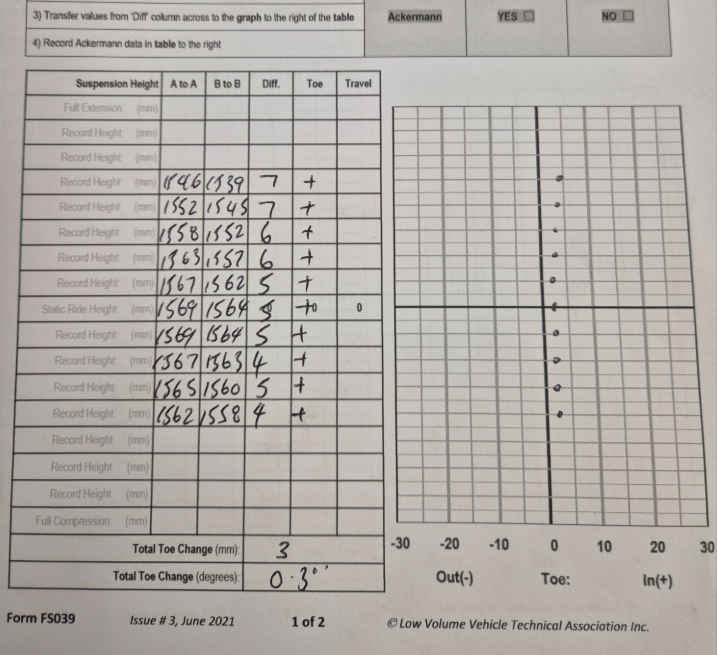

Jody didn’t have the correct category to certify the purple tag rack so he applied for an extension with LVVTA, this took sometime but he was granted the category extension, and we were able to go ahead with bump steer test.
Bump steer test results
As I had used factory bolt on parts for the manual conversion and engine repower, I didn’t need driveshaft hoops.. I was very happy about this!
Booked in to get a WoF this Thursday and then ill be road legal :)
