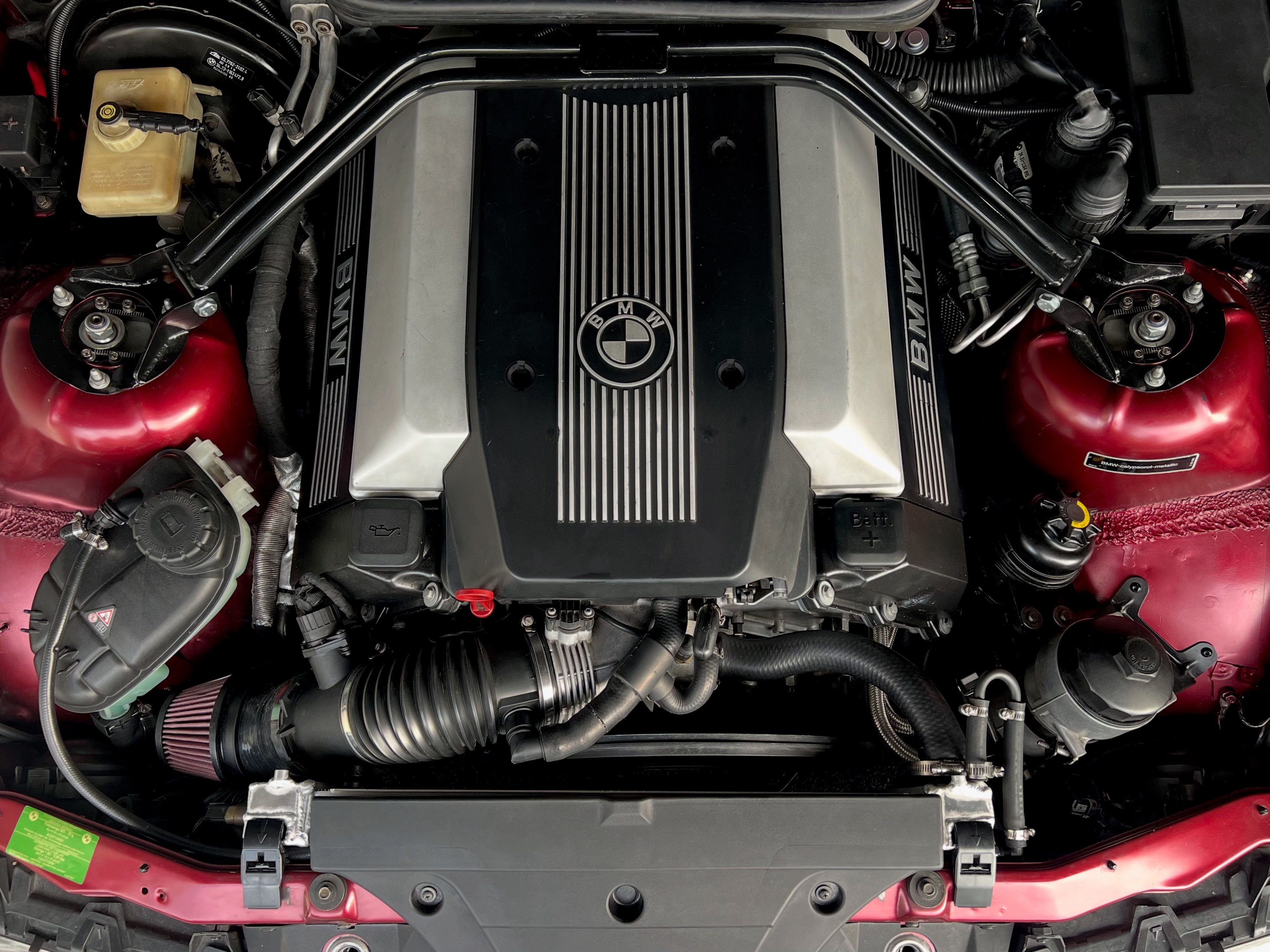

Started out with this lump. 135K kms on the clock and ran really well. Had been used as a farm vehicle then sat for a while so I got it for a song.
E36 V8
Spent the first couple of months stripping everything I would need and getting the motor ready.
E36 V8
It's a dirty job...
Untitled
The motor turned out to be in really good nick so really only needed a good clean. I replaced the valley pan, coolant hose o-rings, valve cover gaskets etc whilst the engine was out and stripped and powdercoated the typically sh*t valve covers.
Untitled
Untitled
After a bit of research I settled on a sump kit from a Polish company called Cybul. Build quality is great and came with modified sub-frame, engine mounts, custom sump (to fit over the steering rack) and a modified oil pump - though the latter is relatively straightforward to do yourself - though it's not quite the plug and play solution promised in a RHD car. Turns out this swap is a great deal easier LHD which is why BMW never did a production V8 and Alpina only did a LHD B8. Anyway, more on that later.

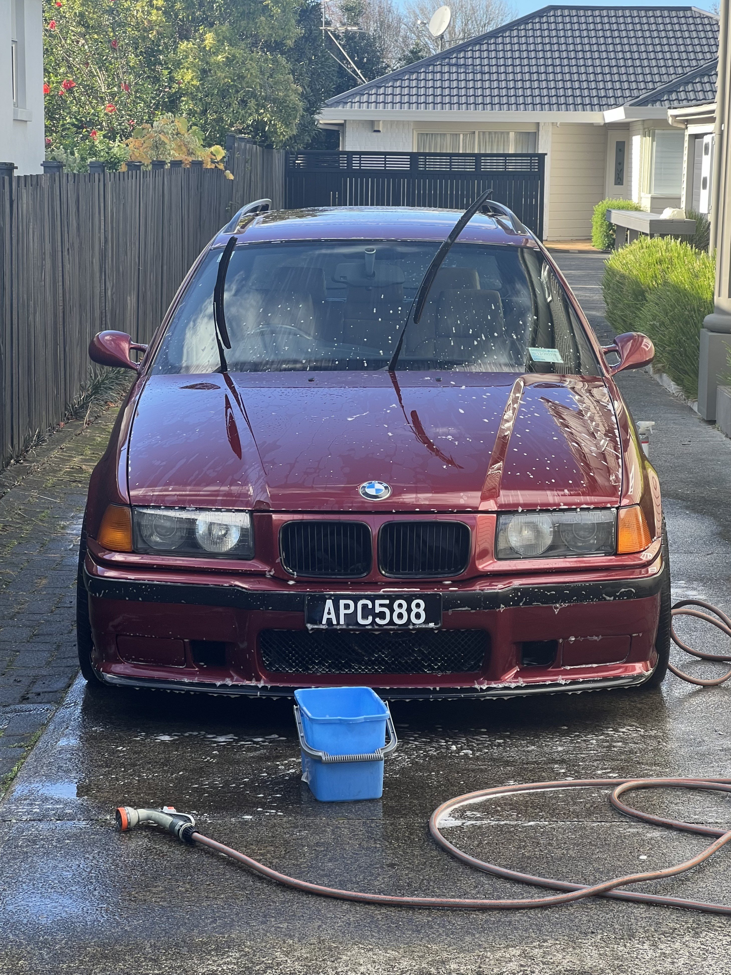

Blew a head gasket (cyls 1-4) so spent the past six months sorting that and coming up with a better expansion tank solution (from a Merc A180). Did chain guides and OSV at the same time and now it runs perfectly and not a drop of fluid leaking anywhere (probably for the first time since either the donor or the wagon left the factory!!). Gave it a wash to celebrate.
