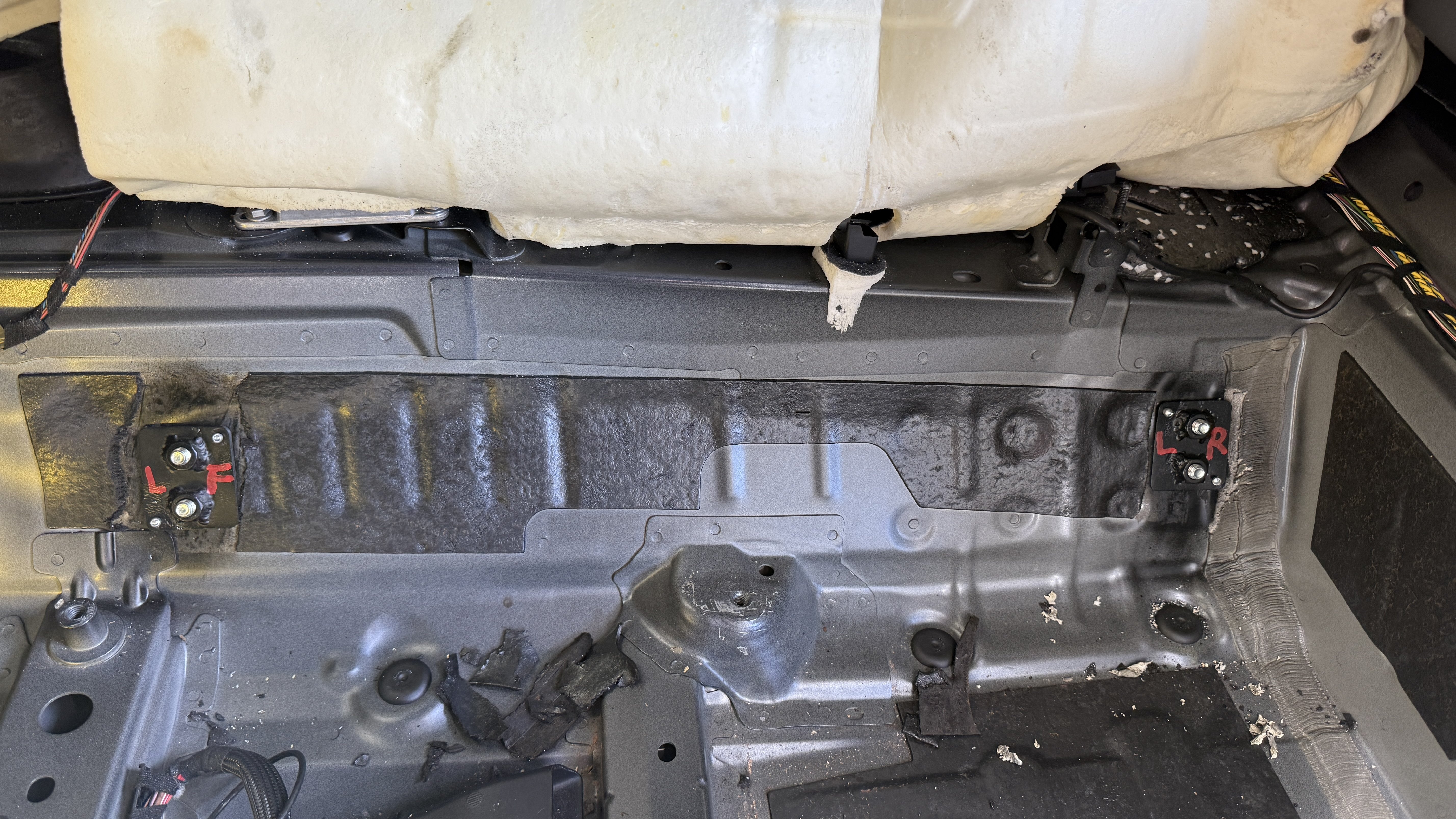

Installed F8x front subfame brackets.
Large case 3:46 M Factory LSD

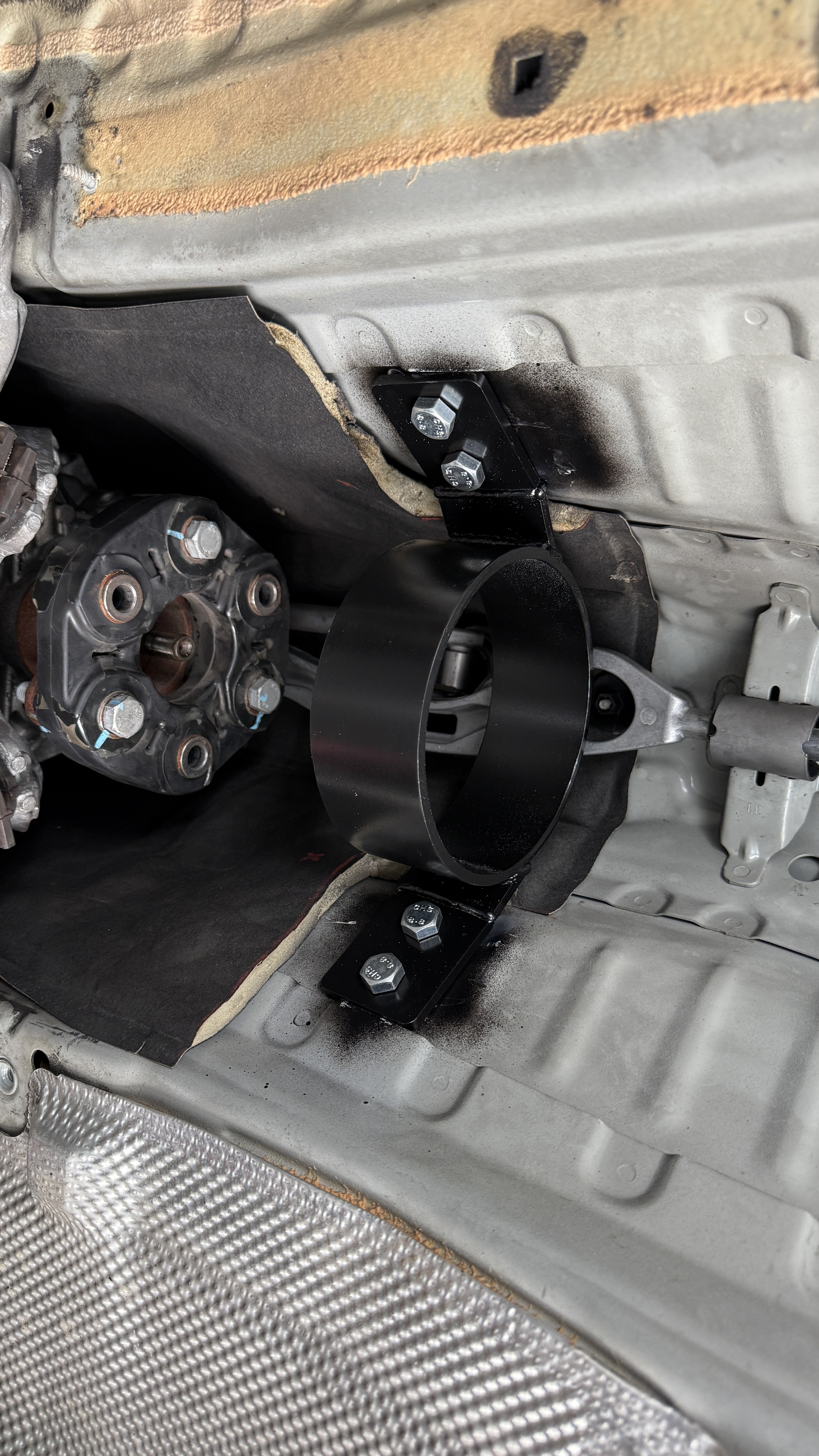

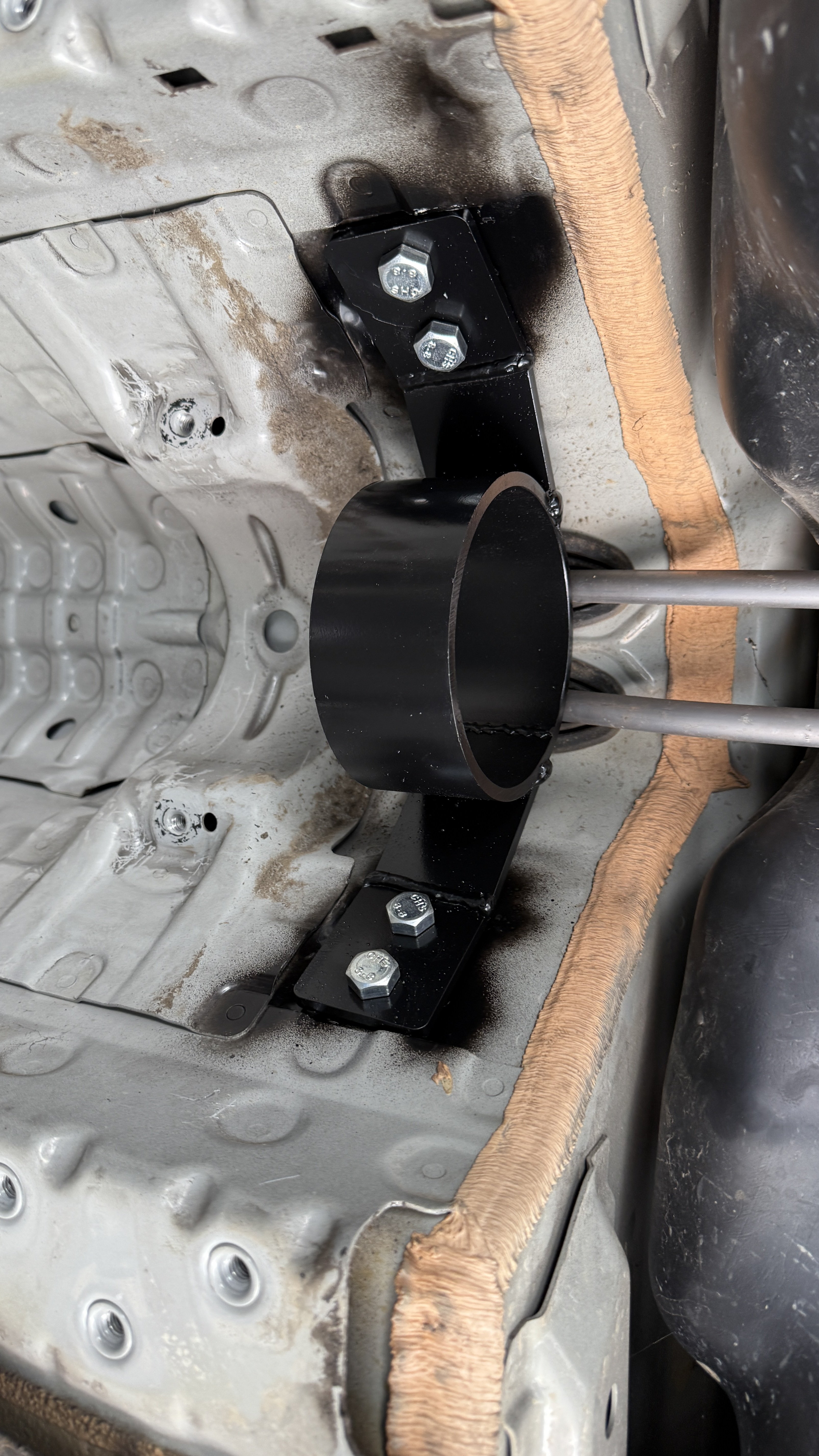

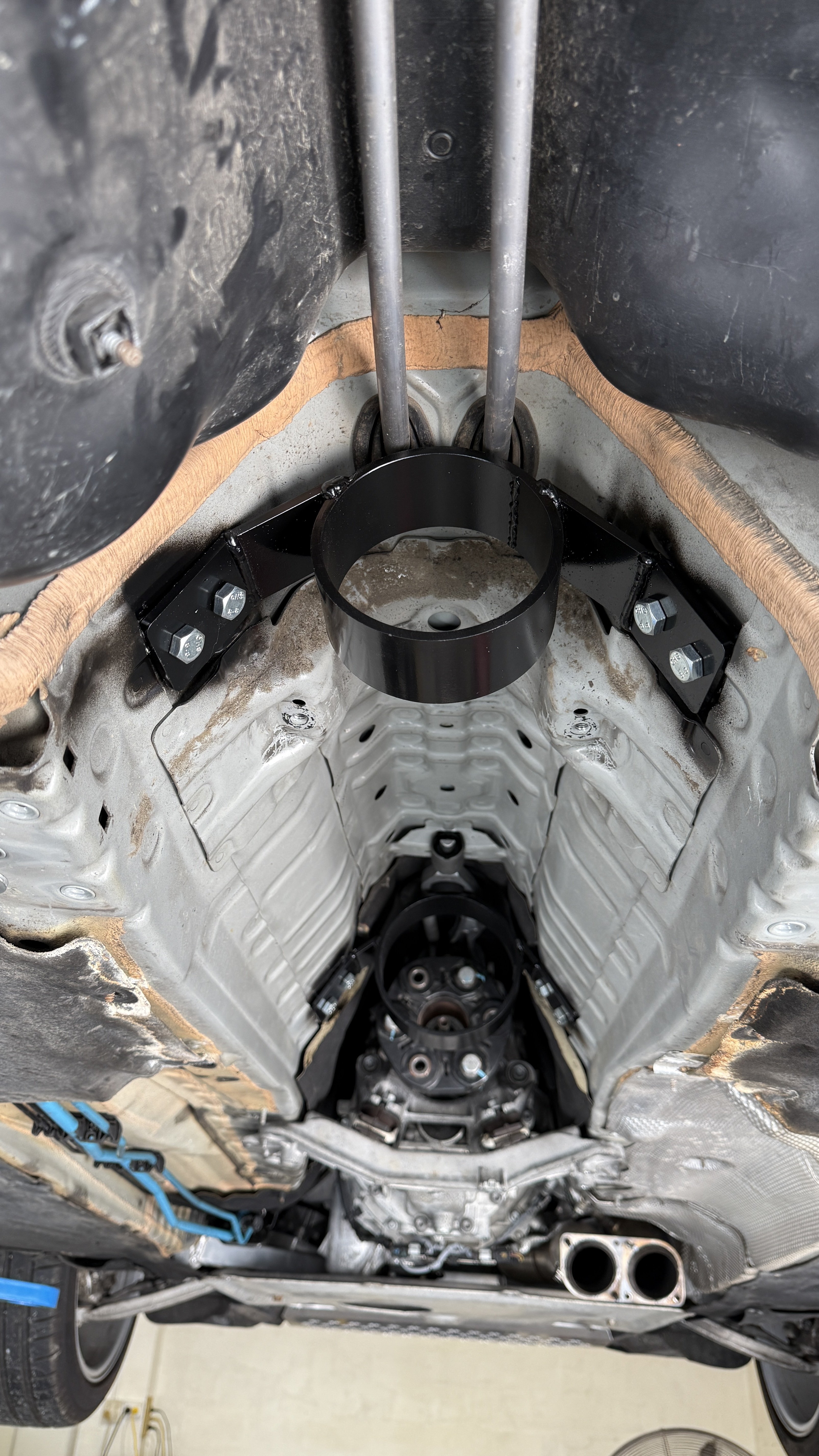

Prepped for cert. Drveshaft hoops installed.
