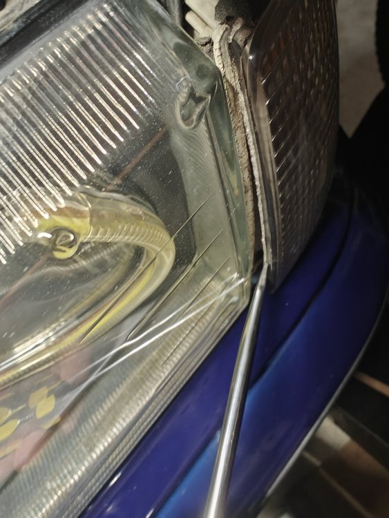

deedub 142 Report post Posted May 30 This is the left corner light on my E36. Any tips for resealing it? Or is it toast and I should get a new one? Seems hard to track down genuine clear corner lights. But I guess I can just look at aftermarket options. Quote Share this post Link to post Share on other sites

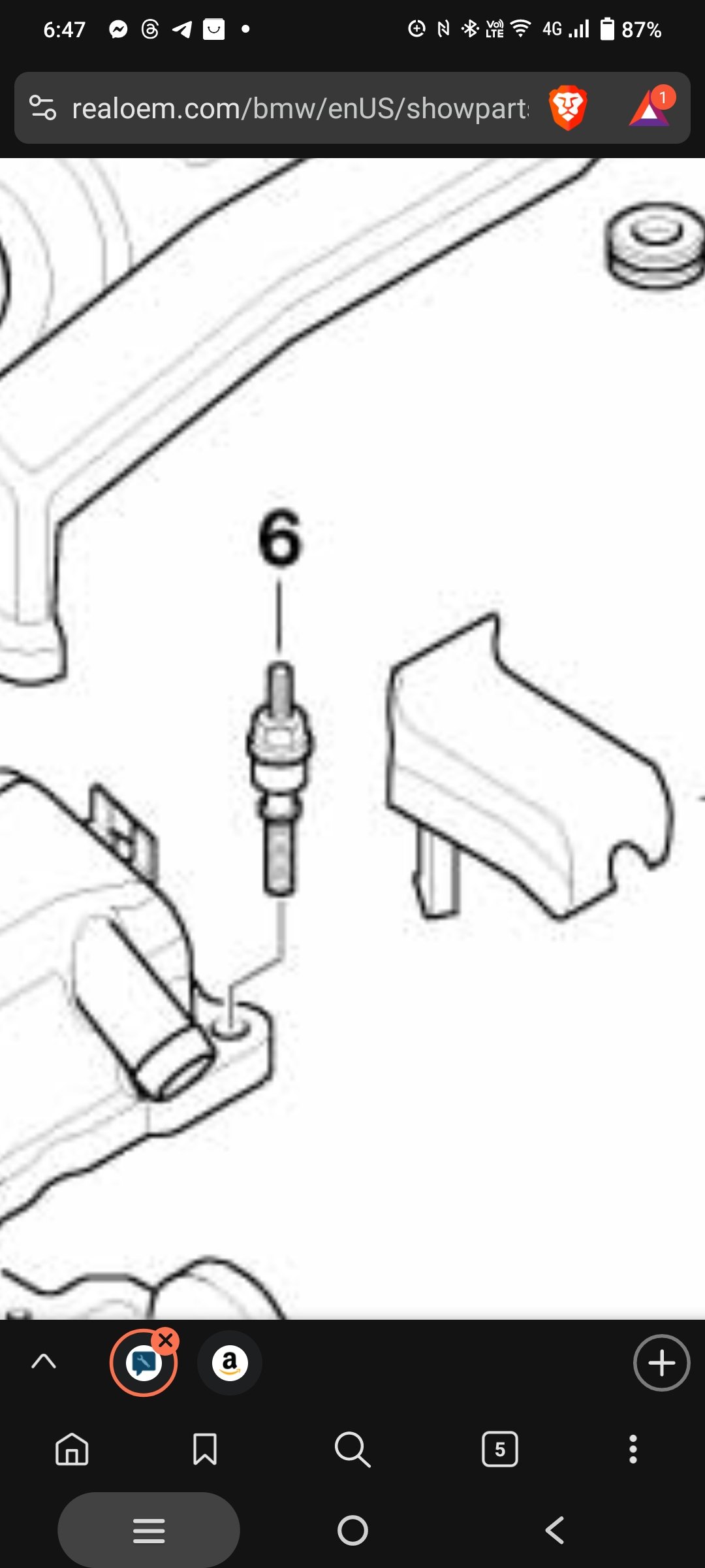

Toksis 3 Report post Posted July 6 How you open this bolt easily rear right of the engine valve cover? I did open it but so takes like 80 percent of my time opening all the bolts Quote Share this post Link to post Share on other sites
M3AN 4183 Report post Posted July 6 (edited) 1 hour ago, Toksis said: How you open this bolt easily rear right of the engine valve cover? I did open it but so takes like 80 percent of my time opening all the bolts With lot's of extensions, elbows, and flex shafts... or remove engine. It's a royal PITA to get to some of them. Edited July 6 by M3AN 1 Quote Share this post Link to post Share on other sites
Toksis 3 Report post Posted July 6 @M3AN I really dont get the reason why bmw use that bolt other than making me harder to remove it. even a normal 10mm could not be use because of that protruding thingy on top. Quote Share this post Link to post Share on other sites
Vass 1073 Report post Posted July 6 Haven't touched an N46 in an E90 but am tinkering on an N42 in an E46 which is pretty much the same engine. That rear right one is a bit fiddly to get to but still easy enough, not might be a bit more room to play around with on an E46 for whatever reason, I'm not sure. I found a regular 1/4 ratchet and deep wall 10mm worked just fine, up to the point it was loose enough to thread out by hand. At least on an E46, the protruding stud is for a small bracket on the vacuum line going to the brake booster to keep that in place, then another 8mm nut that goes over top. Quote Share this post Link to post Share on other sites
