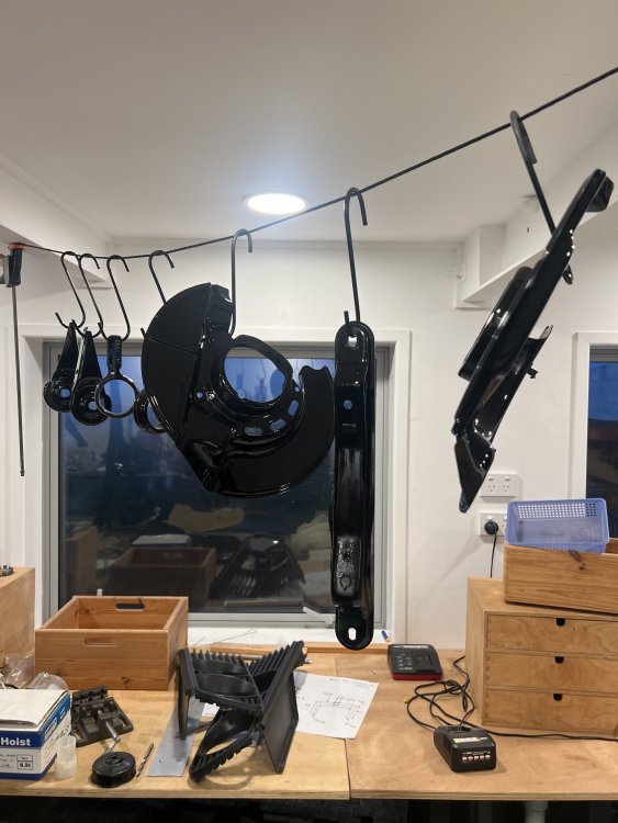

Sharp sandblasting up in dairy flat. Not the cheapest but good to deal with and did a thorough job. The photo of the parts hanging up is not bare metal just for reference that is after 2 coats of epoxy primer.

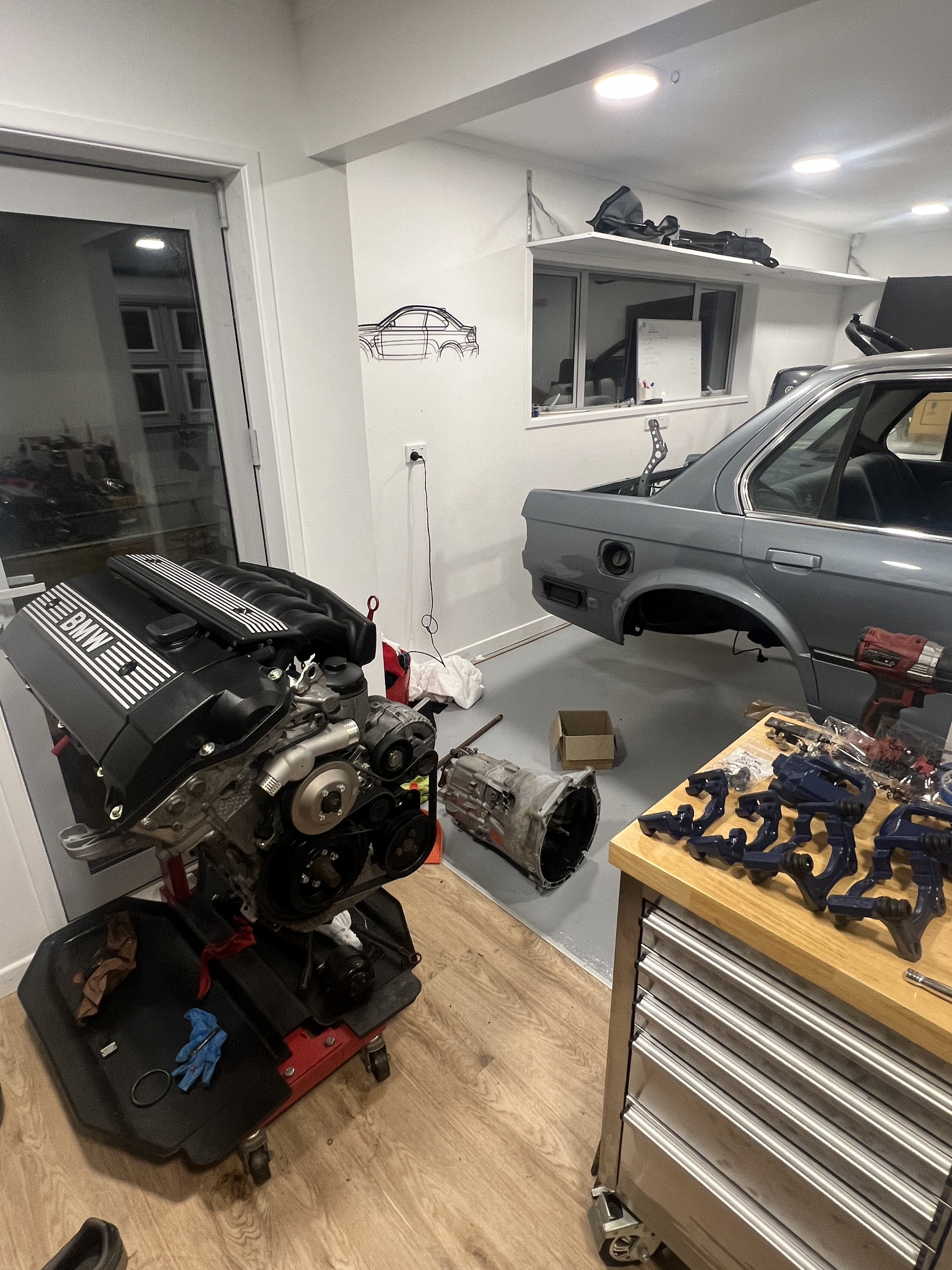

Got a little bit more work done recently, been busy making a plan for all the suspension stuff and figuring out which direction to go for the clutch/flywheel. Decided to keep it oem and stick with a dual mass flywheel and oem 240mm luk clutch kit.

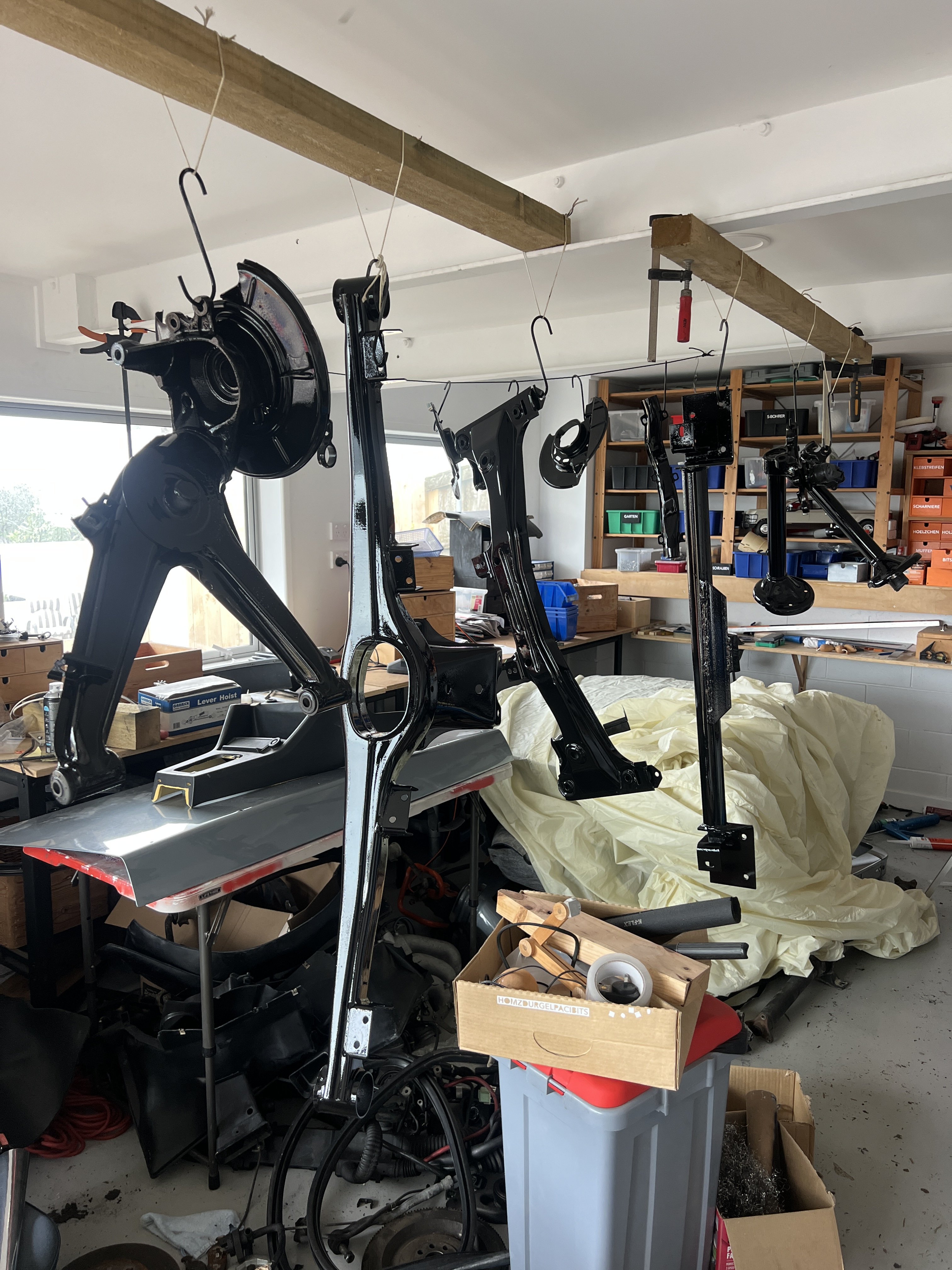

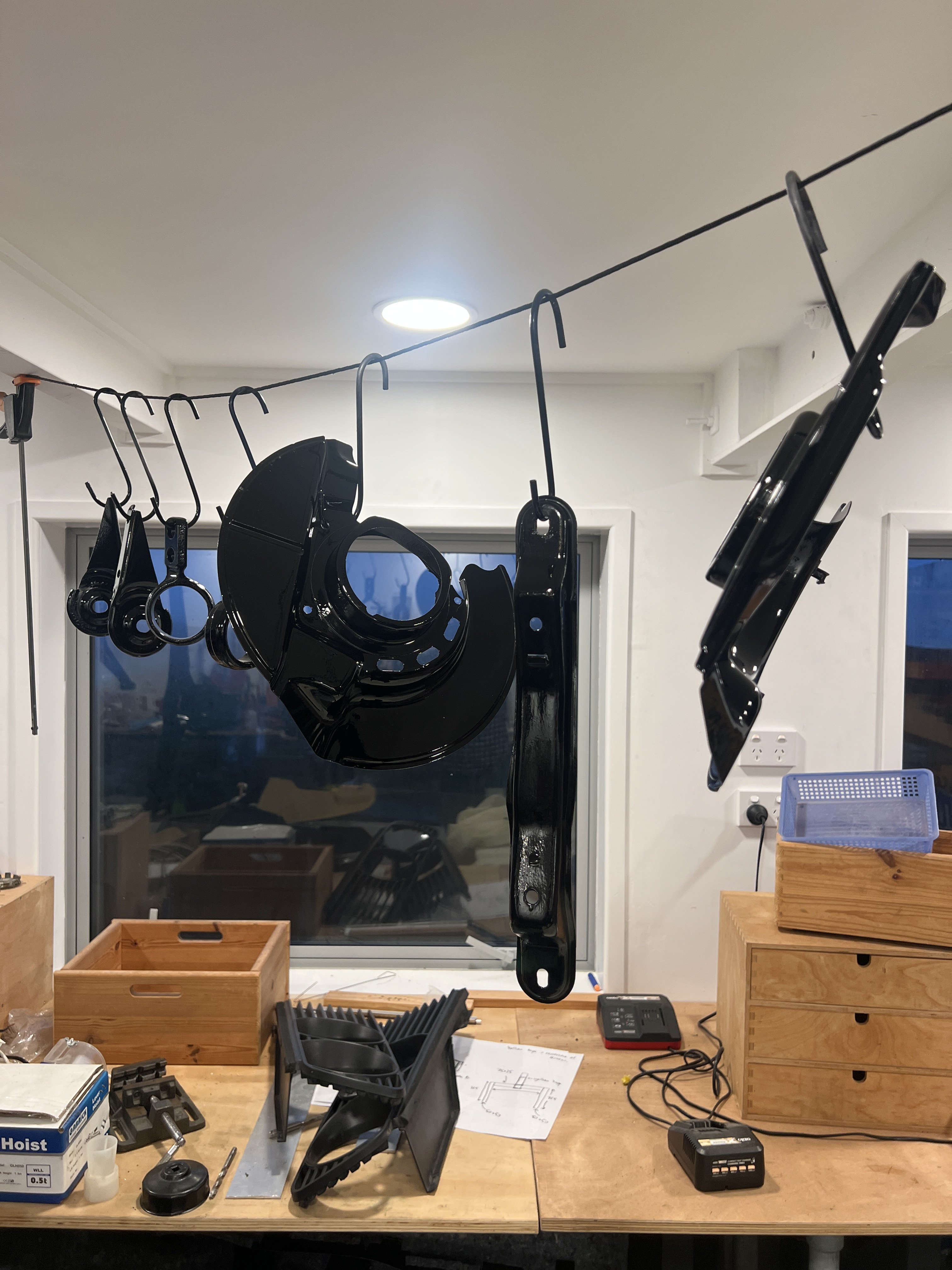

Got all the underside parts taken apart and sandblasted, in the process of getting painted at the moment.
gearbox is back from kayne Barrie now with fresh detents. More or less just need to order the clutch kit now and then can put the engine and gearbox into the car.
picked up a e90 325i auto front half driveshaft and a e36 medium case rear half from @Toast which so far seem to work together, will see if they end up the right length. Paid $80 for the front half instead of the $700 people charge for zf 5 Speed Front halves nowadays.
will need to swap the carrier bearing over to an e30 one as well. Fuel pump is back in the car too now ready to start replacing subframe, trailing arm bushings etc now and reassembling the rear end.

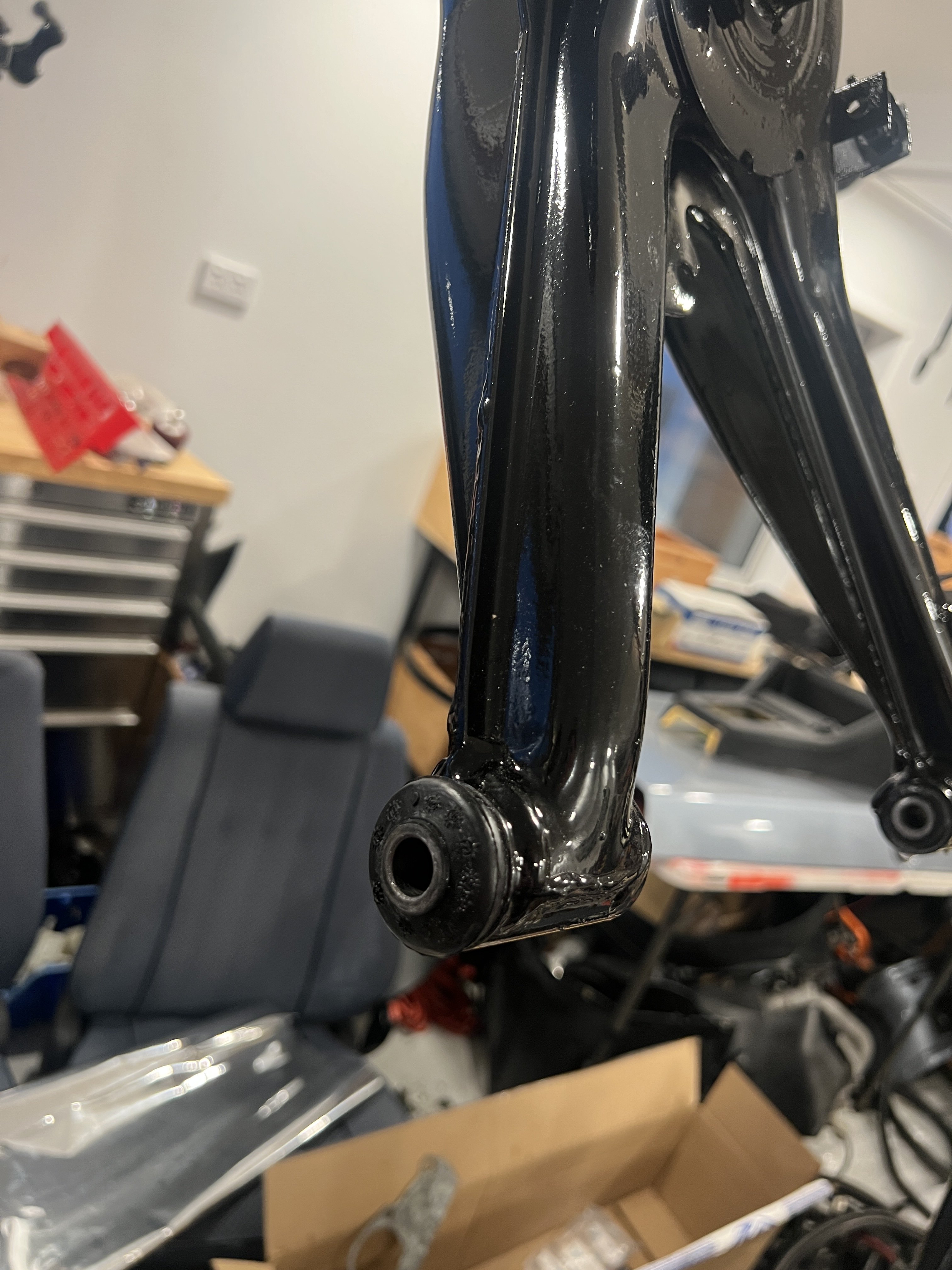

Been a bit slack but have got suspension parts on the way now. Underbody parts all painted black now, new subframe bushings and trailing arm bushings installed as well.

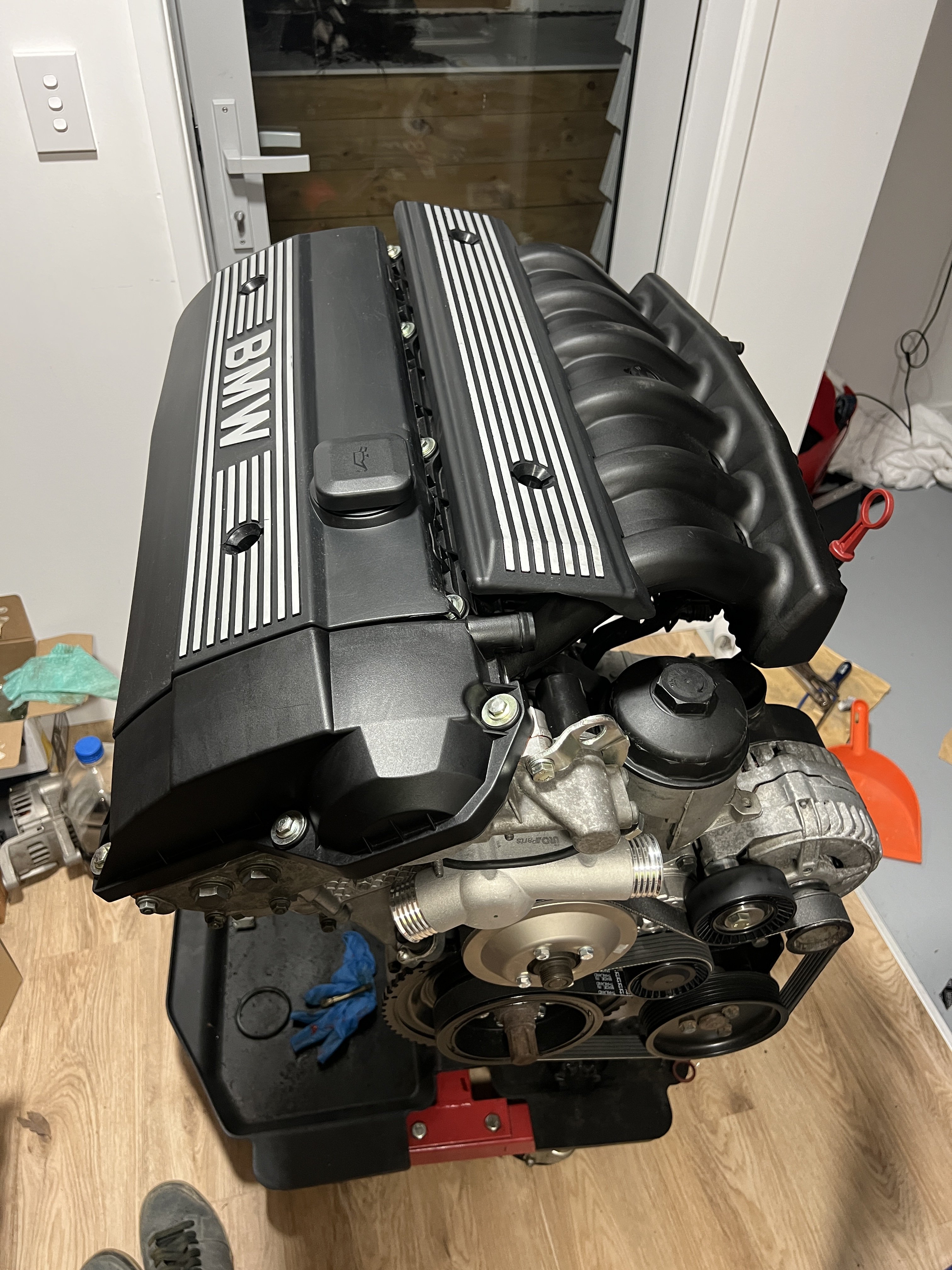

also aquired some engine vanity covers for the m52 thanks to Luke from Skunkworks, he’s been a huge help with sourcing parts, all the suspension parts, bushings, swaybar links, struts, springs, wheel bearings etc that I’ve ordered I’ve ordered through him, very helpful guy.

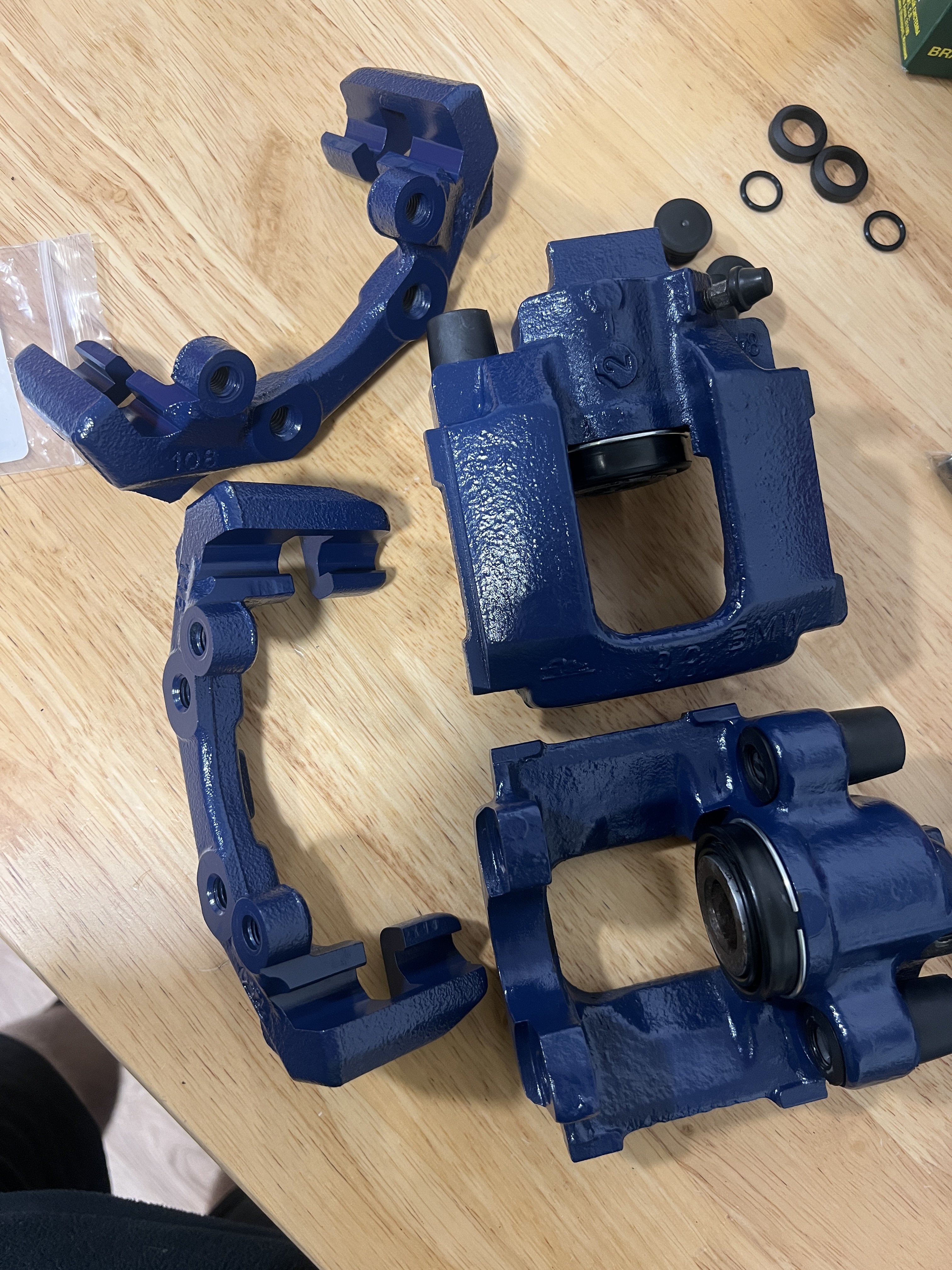

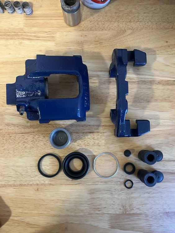

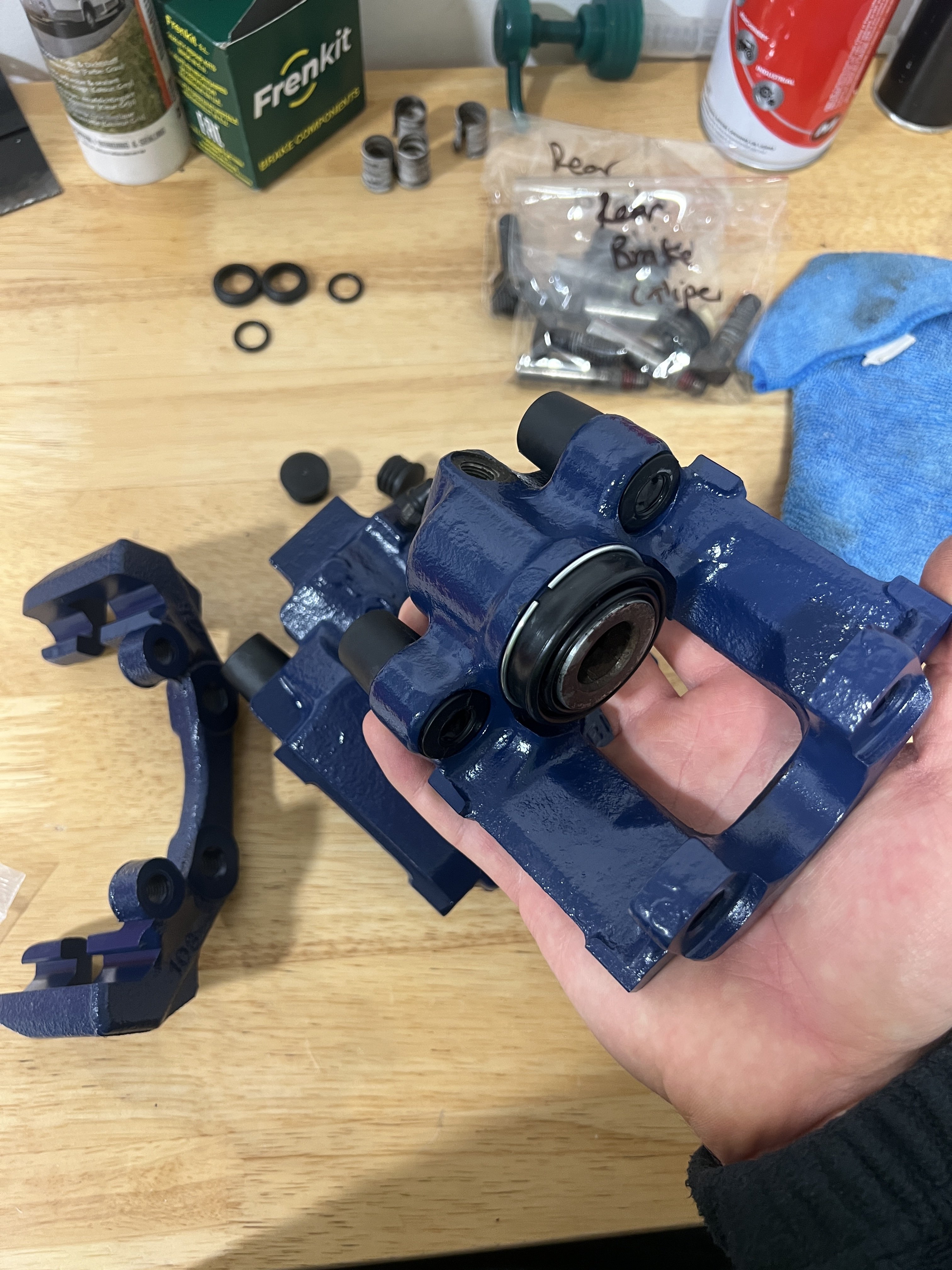

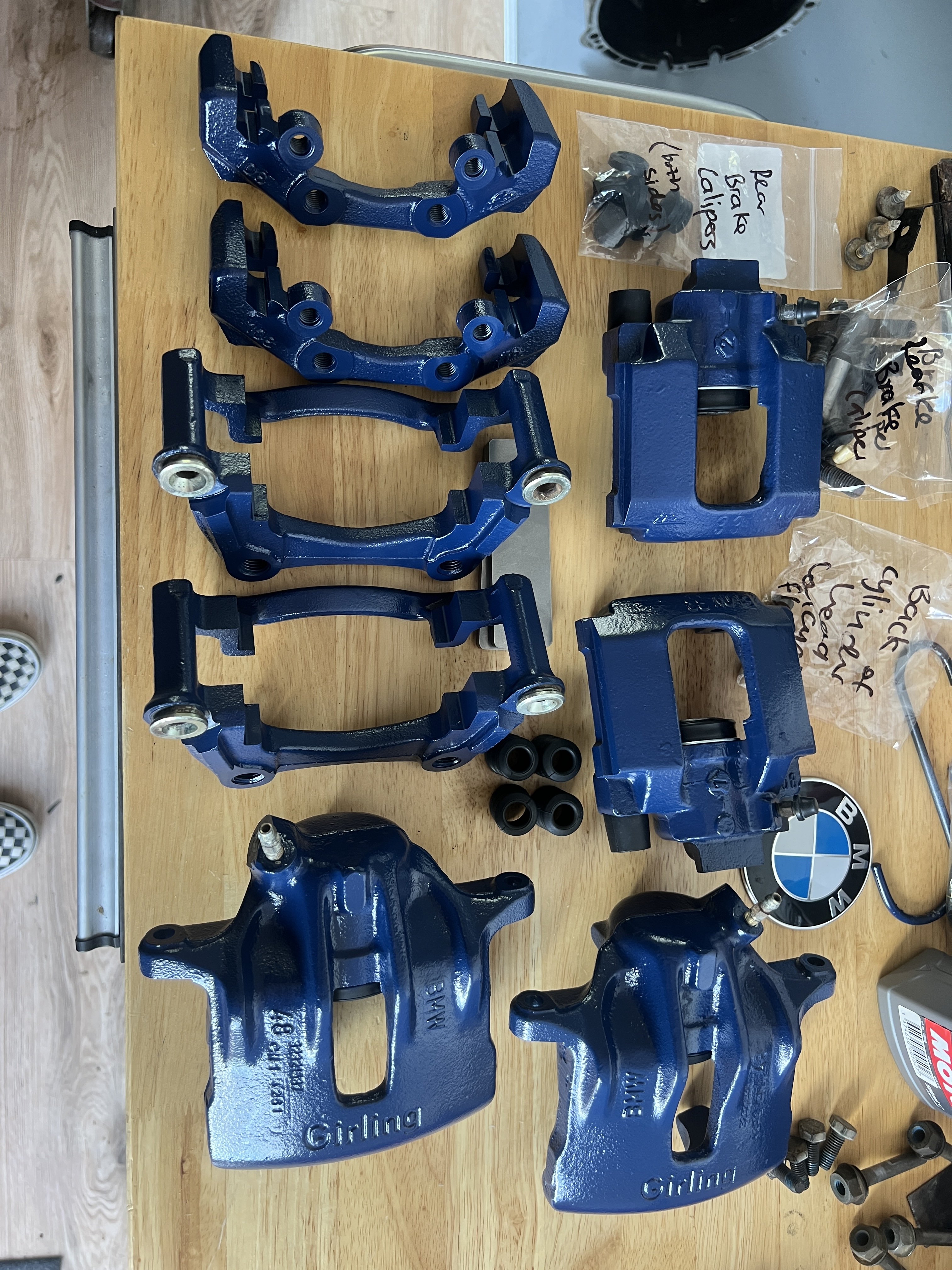

then got into the brakes, stripped them down, sandblasted, painted a coat of preventative rust converter, then painted a nice shade of blue, reassembled with new seals and bits all round, pistons came up great with a quick polish.
ready now to send a bunch of bolts off for zinc coating and then once all the other bits arrive the suspension parts can start being put back in the car.
