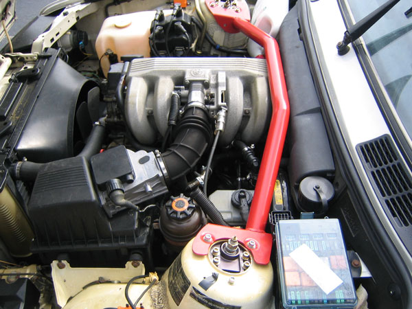

E30-323ti 66 Report post Posted January 11, 2012 Anything with hinges is just for bling... Build your own. Have a look at the 1pc sparco bars for the E30 chassis for some inspiration. Or even the Mason & Rouge Engineering bars for the E46 Mason Aluminium E30 Sparco. NB how it has a 3rd mount down the side of the tower also. Quote Share this post Link to post Share on other sites

E30-323ti 66 Report post Posted January 11, 2012 Yeah I've always been skeptical of the hinged ones... seems like a part that should be completely rigid! A good point about the custom fabrication... might be the way to go for my application. If I've made up what I have already, shouldn't be too hard to make up a custom brace. That's what I figured!! Get the welder out!! Quote Share this post Link to post Share on other sites
