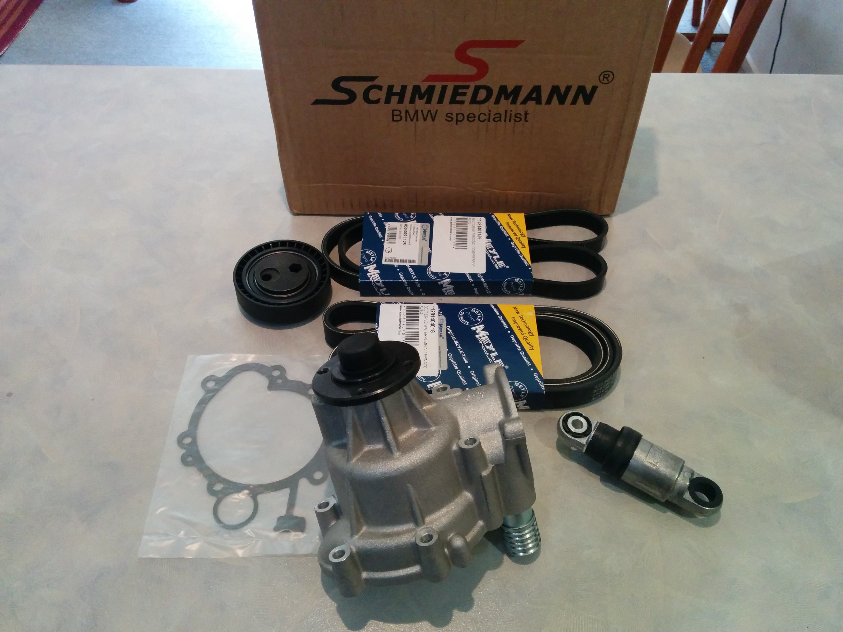

M3AN 4186 Report post Posted January 23, 2015 (edited) More parts arrived... water pump, belts and tensioners. Ordered on Sunday, shipped on Monday received on Friday, great work Schmiedmann! And no duty! Edited May 12, 2018 by M3AN Images 1 Quote Share this post Link to post Share on other sites

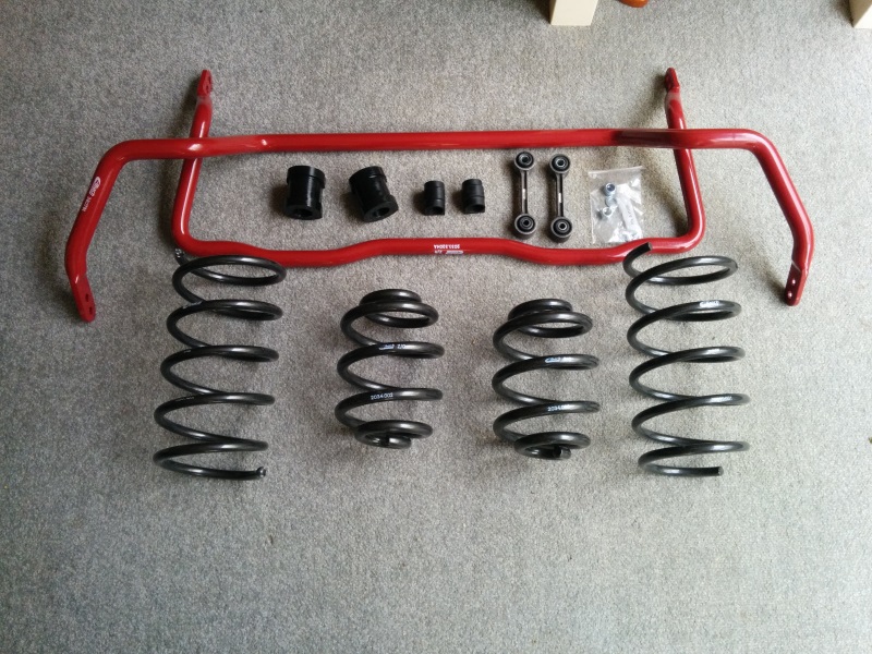

sweetm3 181 Report post Posted January 23, 2015 Nice mate Adjustable drop links ? Quote Share this post Link to post Share on other sites
M3AN 4186 Report post Posted January 23, 2015 Nice mate Adjustable drop links ? Cheers and no, the drop links aren't adjustable although the bars themselves are. With this kit you reuse the OEM front links and replace the rear links and since the suspension isn't height adjustable I shouldn't need to adjust the link length. The bars are set to soft, medium or hard based on which hole you use to attach to the drop links. I'll be using the hard front setting but I'm undecided about the rear yet. Quote Share this post Link to post Share on other sites

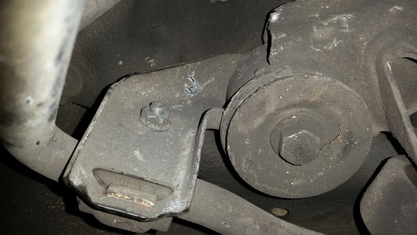

jaimzthedrummer 24 Report post Posted February 2, 2015 (edited) Hey Dave, Finally got around to reading the whole of this thread. Nice to piece together the details of what I've seen in the flesh! One thing that you didn't seem to have planned was the top plates for the rear strut towers. Did you have something going on back there or was it a precautionary measure? I often think about cracking of the chassis at the top of those towers. I understand it's a common problem and do a visual inspection often (not that I really know what I'm looking for..!). It had happened to my fronts but this was picked up in the pre-purchase inspection and got fixed as a condition of sale. Wonder if a strut brace like yours would help prevent further issues... I've got a power steering leak too but it's a slow viscous affair (I guess because it's been happening for a while and has created a long sticky snail trail). Doesn't leave anything on the ground. Anyways, VANOS and braided lines for me next. Thanks for the heads up with those. James Edited February 2, 2015 by jaimzthedrummer Quote Share this post Link to post Share on other sites
M3AN 4186 Report post Posted February 2, 2015 Hey buddy, glad to know it's of some use. The list never gets shorter so keep an eye on the thread! One thing that you didn't seem to have planned was the top plates for the rear strut towers. Did you have something going on back there or was it a precautionary measure? I often think about cracking of the chassis at the top of those towers. I understand it's a common problem and do a visual inspection often (not that I really know what I'm looking for..!). I had nothing going on, it was a precautionary measure. It's inexpensive and easy, not sure why I delayed it for so long. You can use stock Z3 parts to reinforce this spot, no need to go aftermarket (see here). It had happened to my fronts but this was picked up in the pre-purchase inspection and got fixed as a condition of sale. Wonder if a strut brace like yours would help prevent further issues... Good for your fronts, they actually reinforced those from the factory in 96+. A strut brace does away with the need for reinforcements but if you already have reinforcements after the repair you're good to go. I've got a power steering leak too but it's a slow viscous affair (I guess because it's been happening for a while and has created a long sticky snail trail). Doesn't leave anything on the ground. It will probably get worse, the silicon (?) inside the hoses deteriorates over time. New clamps will help, then after 18 months tighten those, but eventually you'll need new hoses. Take it to a hydraulics shop, not a mechanic! Quote Share this post Link to post Share on other sites
jaimzthedrummer 24 Report post Posted February 2, 2015 Good for your fronts, they actually reinforced those from the factory in 96+. A strut brace does away with the need for reinforcements but if you already have reinforcements after the repair you're good to go. No reinforcements... just the repair. I asked the ex owner about it (he's part of the race series exec and knows his stuff) and he said don't bother... just reweld if I see a crack! It's what he does with his race car... but maybe has a different perspective on things. I'll think about a brace or reinforcements :-) Thanks dude. Quote Share this post Link to post Share on other sites

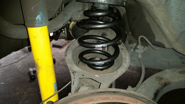

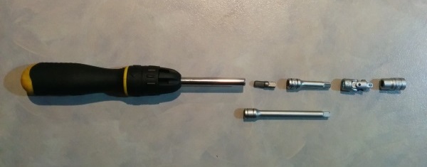

M3AN 4186 Report post Posted February 8, 2015 (edited) I replaced the chain guide yesterday and re-torqued everything up top which took a few hours but I learned a trick for the hard to get bolts on the valve cover. Ratcheting hex bit screwdriver -> hex to 1/4" socket adapter -> 1/4" universal joint -> 1/4" extension bar (to suit) -> 10mm socket or similar arrangement - perfect, wish I'd discovered this the first time. Took it for a test drive up to red line in a few gears and no codes so it seems okay. Eibach suspension (springs and bars) and rear reinforcements (rear trailing arm pockets and sway bar mounts) go in on Tuesday. New gaskets and HT bolts for VANOS rebuild should be here in the next few days. Big cleanup job ahead. Edited May 12, 2018 by M3AN Quote Share this post Link to post Share on other sites

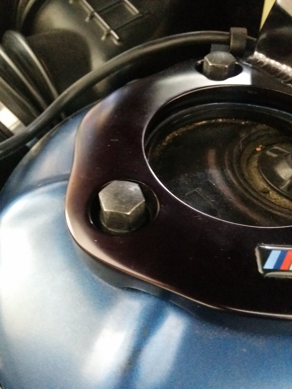

M3AN 4186 Report post Posted February 9, 2015 (edited) Just installed the official BMW Motorsport cap nuts on my front struts - these are the ones that come with the official Motorsport strut brace and are much cooler than the standard 13mm self locking nuts. Edited May 12, 2018 by M3AN Images 1 Quote Share this post Link to post Share on other sites

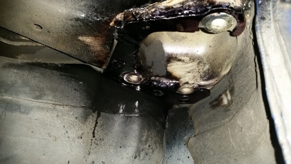

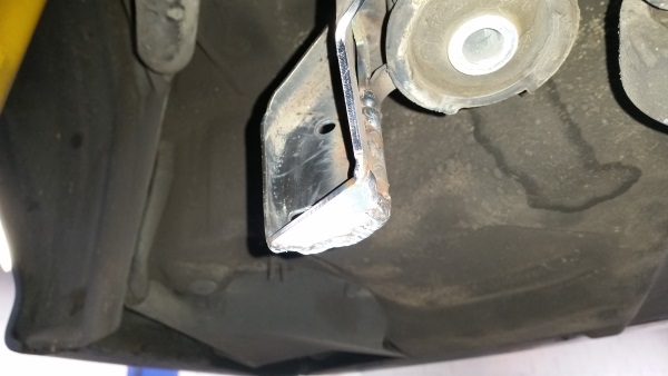

M3AN 4186 Report post Posted February 11, 2015 (edited) Yippee, some new bits! So yesterday I picked my car up from EUROHO's (SJ's) shop Apex Autos in Porana Road here on the Shore because I now have all of the suspension bits discussed here installed! As well as some reinforcements welded in. I only knew SJ though the forum until we met in person at the recent Coffee & Cars mini-meet and I subsequently found out that he and his dad have a workshop close to where I live and are also competent welders. After discussing what I needed doing and getting competent and confident replies as well as a more than reasonable estimate for the work I had no hesitation signing Apex up for the job. Boy did I make the correct decision! I can't recommend SJ, his dad and Apex enough. These guys aren't just mechanics they're enthusiasts and it shows in every aspect of their work. I received text and mms updates throughout the day, I visited during the job and they were happy to step me through everything and show me progress whilst it was up on the lift. Finally I went to pick her up and SJ had a massive cache of progress photos that I hadn't even asked for! (I was going to ask for photos but the estimate was so reasonable that I didn't think I deserved optional extras). Plus I got a loan car to boot! Without a doubt I'll be using them for more work now and this is not to detract from other other forum sponsors and contributors but when you find a winner you've got to run with that right? I can't recommend them enough, go down, have a chat and draw your own conclusions, I think you'll be happy. I'm glad I got the reinforcements welded in, especially the sway bar ones because boy the stock ones look very, very weak. I got mine from RallyRoad.net but any reputable aftermarket ones will do. If you're not tracking your car or have standard suspension they may not be necessary but it's piece of mind for me, especially with the up-rated suspension. Stock sway bar tab! Reinforced: RTAB reinforcements after a quick spray seal: New springs: So... how does it feel? In a word amazing. It is far, far more compliant than I imagined and is actually more comfortable that it used to be! How? Well I put it down to two things: 1. The spring rates are matched to these specific dampers with the E36 M3 in mind, it's all optimised to go together. 2. The springs are progressive rather than linear like stock therefore they actually 'start' softer than stock. Over typical undulations the car feels softer (vertically) but you can tell the springs get harder faster over more aggressive bumps. Pitch under hard braking is also less. The sway bars seem to have made quite a bit of difference to roll. I've not had the opportunity to get to any significant twisties yet but on some curvy roads that I know I can already feel a difference. It's certainly more confidence inspiring. I'm not used to it all yet but I am very happy. There's absolutely none of the bone jarring rattle and bump that I've experienced with some aftermarket suspension. I'd actually say this is how the car should have some, no M3 driver would reject this as a stock setup in my opinion. Interestingly the car doesn't seem much lower. I did use 15 mm spring pads in the rear because I'm running 255's and needed them to fit. I'm glad I did because the front hasn't come down by the claimed 25 mm and now the rake seems perfect. There's still quite the gap above the front wheel but it's not as cavernous as stock. Note that I was not going for a dumped look. Front gap: Rear gap: And finally I got it all aligned. Now often threads pop up here on the best place to get an alignment and I've previously used Peter Alder at Andrew Simms in Newmarket but he's since moved on. I'd prefer someone local and my brother suggested Wairau Alignment so I went and spoke to them. A brief chat and the fact that they could do it while I waited convinced me to proceed. What another fabulous experience. Caesar the tech that did my car is a BMW enthusiast from way back having owned many cars included an E30 M3 Evo Sport and a E30 335i that had a 635 CSi engine... and he has a couple of BMW bikes that he's prepped for racing including one he chucked a supercharger on... He was happy to show me the alignment equipment (laser of course) and how the machine worked and he stepped me through all of the settings and variations. And he took me for a shake-down drive just to verify. So now I can also recommend Wairau Alignment for those wanting great service on the Shore! Overall I'm delighted with the experience and the rest, happy as a pig in mud! But now the steering can't keep up and feels (relatively) terrible... see the next post... Some proper photos when I get her cleaned (edit: I didn't know it was a 'she' - no problem with that but I'm fascinated that I called 'her' that). Edited May 12, 2018 by M3AN 3 Quote Share this post Link to post Share on other sites
