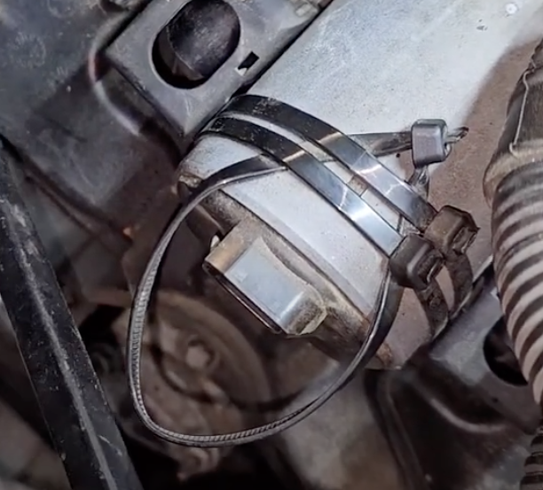

I think my silver 130 has been to the same garage, if it cant be fixed with a cable tie, it isnt worth fixing.

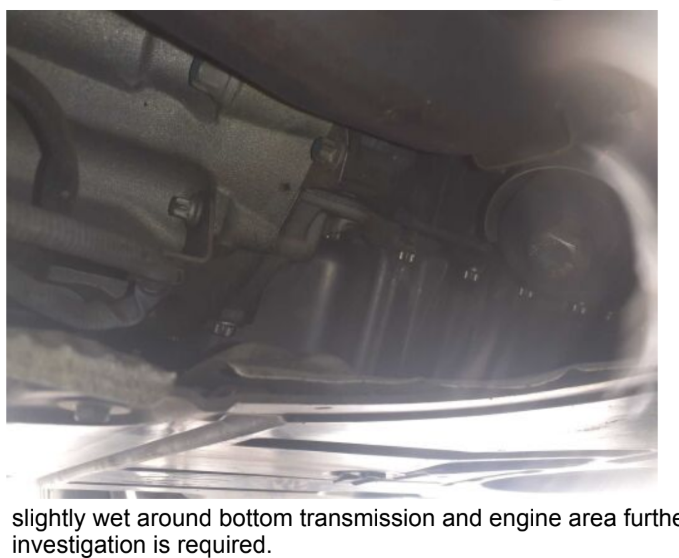

Hi - new to this forum, looking at buying a 2006 130i M Sport and AA pre purchase inspection threw up a few things....  I have found some answers already, but looking for advice!
Report mentions floor panels are wet and there is water in the boot - the owner suggested floor mats had been shampooed and replaced before they had fully dried, but I am not sure about the boot - is water ingress common?
The rest of the comments of concern are in the pics, and also oil light is on (it wasn't when we test drove at the weekend), so looking to understand whether these are genuine concerns, normal or roughly how much to investigate or fix.

The wet around the transmission will be the sump gasket, they all do it. Parts are cheap (couple of hundred max) but to do it requires dropping the subframe which is pretty labour intensive (6-8 hours in a shop would be standard charge, its DIYable if handy with a spanner though). Subframe out is also a great time to replace the engine mounts, which will be shagged if they are still factory ones, as well the waterpump and thermostat. (Doing this at the moment in the projects thread on the Silver Lemon, did my nice 130 few years ago as well)
The rocker cover gasket is also going, which again they all do, parts again are pretty cheap (couple of hundred again) and it'll take the average home gamer a few hours..
Neither leak look particularly bad yet though, but they will escalate quick.
Oil light - Which one? The oil capacity on these is electronic, so if its low the light will be on (scale on it only covers 1 liter though, half way means add 500ml) ... or it could be oil pressure... which is very bad and best bet is to walk away!

Yeah thats capacity, whole thing takes 6.5 liters, so its maybe a couple of hundred mls down.. nothing to worry about (they arent hugely accurate anyway and will vary every time started)

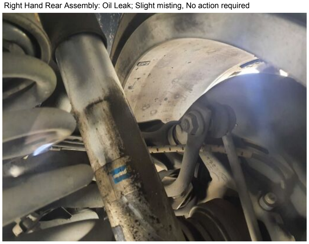

That rear shock will need replacing at the next WoF, that one won't pass, and you really need to do an entire axle at a time. Perhaps ask for a fresh 12 month WoF as a condition of sale, that will mean it's a dealer problem - although I suspect if you immediately failed a WoF after purchase, that could be on dealer but it would be a hassle, best try and get it sorted during purchase negotiations.

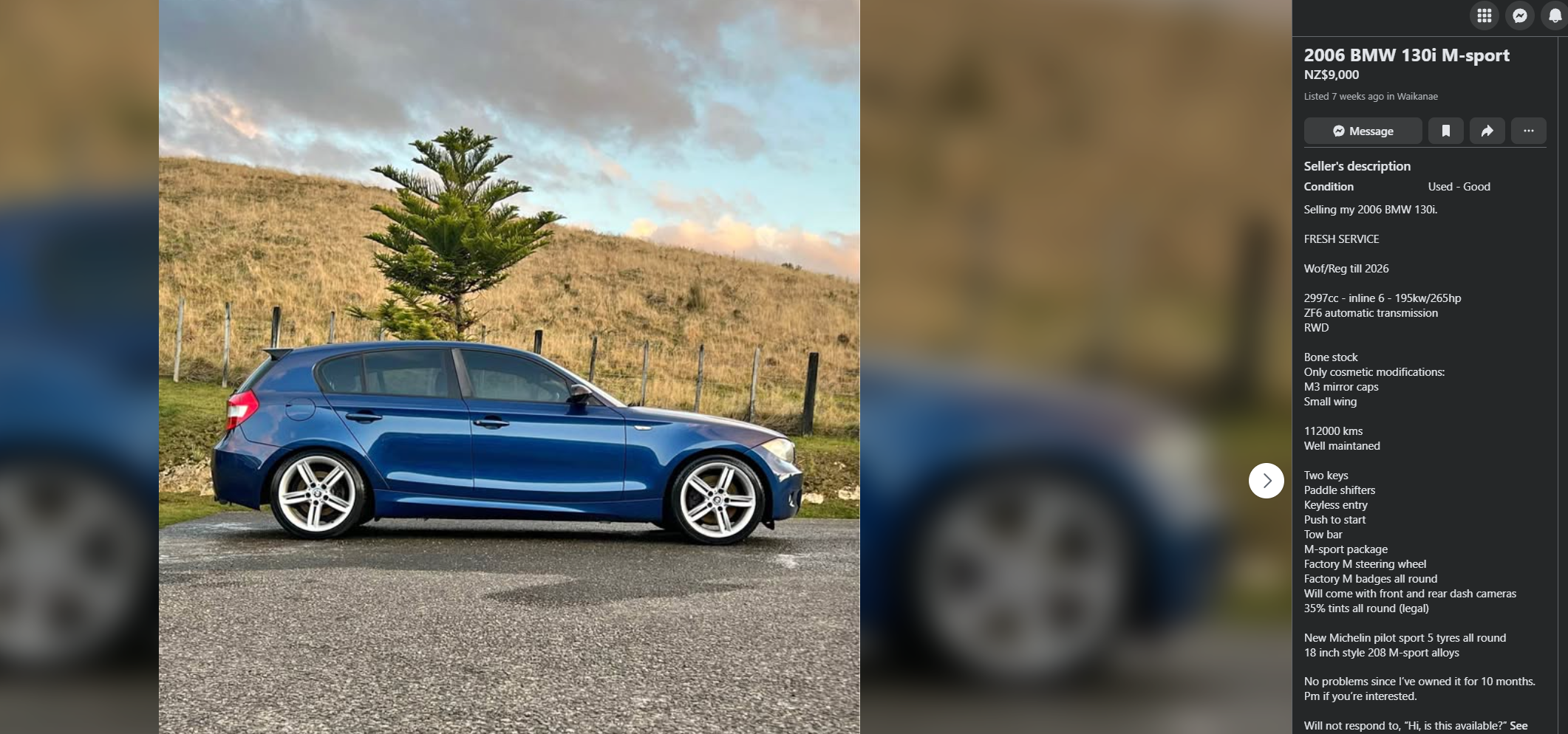

How much are they asking? Can't (read: won't) do FB myself.
Edited by M3AN
Thanks M3AN - $8k conditional on outcome of pre purchase inspection.  Seller seems keen to negotiate - however there is a white one on FB for $7k which looks like a forum car but not a preferred colour.

Id be talking him down, not because its not worth 8-9k (you will struggle to find a more fun/capable car for 8k than a 130) but because the market is stupidly flat at the moment, NZ has the cheapest 130s in the world. The real selling point for that one is the ZF gearbox and nice tyres! and it looks fairly unmolested, otherwise its pretty "common" for an uncommon car. 130s with the same issues, just in worse states of disrepair, can be had for sub 5k pretty easily and sometimes solid cars are around the same price point!
If you are paying a workshop to fix the issues above, the bill will be in the many thousands unfortunately. They are honestly pretty cheap to maintain for the most part if you are clever with parts sourcing and either find a local independent BMW specialist who is happy if you supply parts, or learn to swing a spanner, if not things can get a bit silly. I got a full set of B4 bilsteins for $650 couple of weeks ago for instance, sourcing locally would probably pay that per shock.

I don't think it's worth 7 to be honest. Wheels and tyres might be mint, but how much is all that worth to you? I agree with above, leaks and bits will be a few k$, might be able to defer some to next WoF. Engine and trans sumps can just drip forever really, depending on your tolerance levels.
Now, keep in mind, it took me months, and 7 or more cars, to find mine because I was particular about the little things like seeping sump gaskets. That was particularly anal - in the end, almost all of the 130's I inspected (from underneath, on jack stands), were leaking to some degree. You need to be pragmatic here with BMW's if you ever want to own one.
If you quite like it, and it's not actually leaking inside the cabin, offer $6.2, I think that's good market value for a pre-LCI auto if it's in good condition inside and out. Then put 2k aside for maintenance, years of trouble free after that I'm sure. Edit: tbh, this will not get everything fixed, it's probably a minimum, but that might still be enough for a few years.

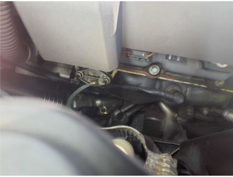

Upon further investigation it appears fuming thing only appears on cold start and goes away engine is up to temperature??? Also seems to come from drivers side of engine??
Before you start the car next check if the exhaust manifold is clean of oil that may have dripped onto it whilst sitting.

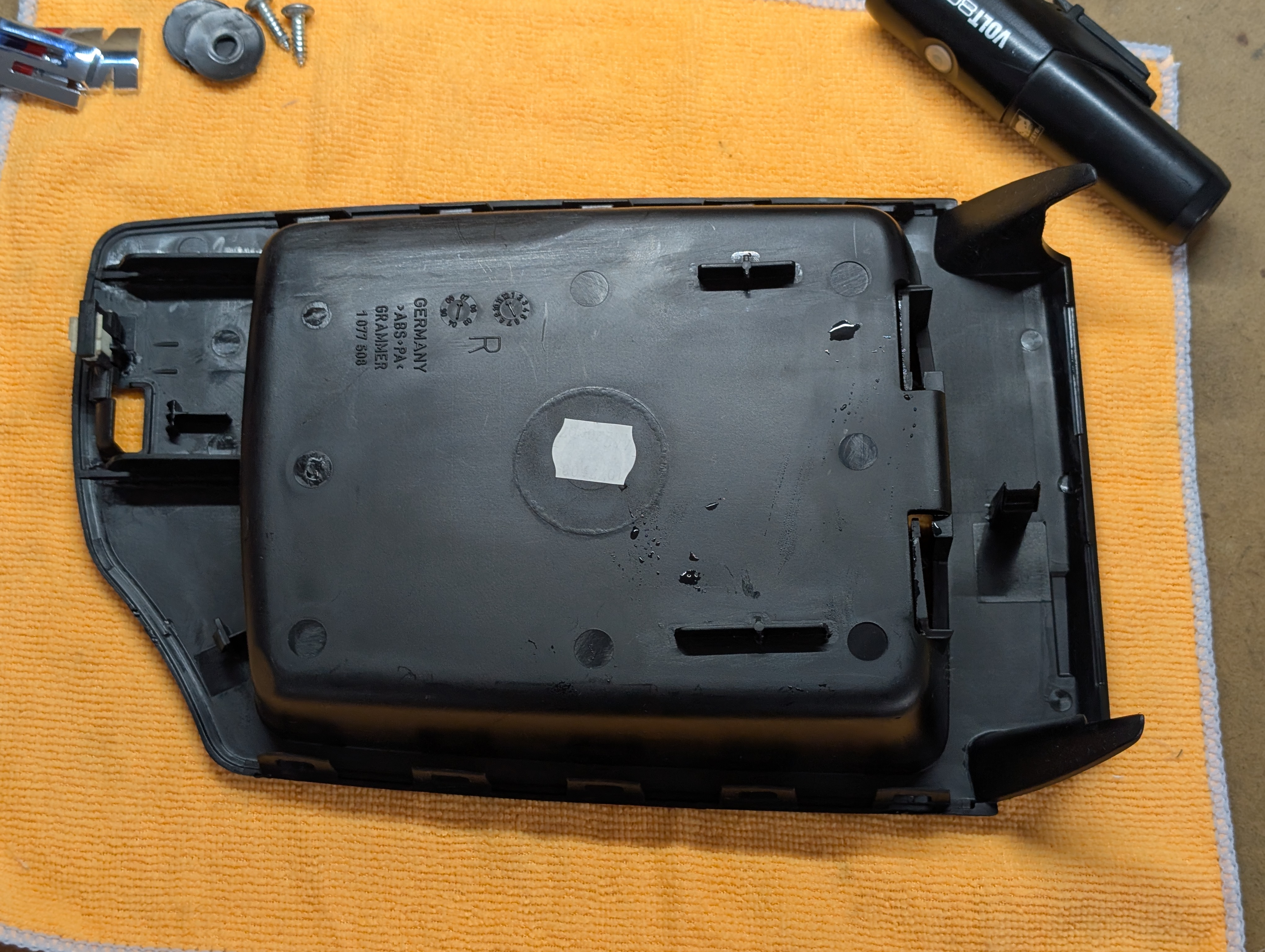

Replace the (surely useless) phone cradle tray in the armrest with this open style one for practicality. I think it's all in order, the clips are all fine, but if it doesn't work for you all I can (and will) offer is sympathy. Old one clips out, this one clips in. I'll even include a custom fit anti-slip, anti-rattle mat for you.
Not unique to the 130i of course, fit's any e-series with the same armrest.
Had a look but hard to see the exhaust manifold under all the plumbing ? [to the uneducated ] :)
Or have someone start the car while you're looking under the bonnet for any smoke while it warms up.
