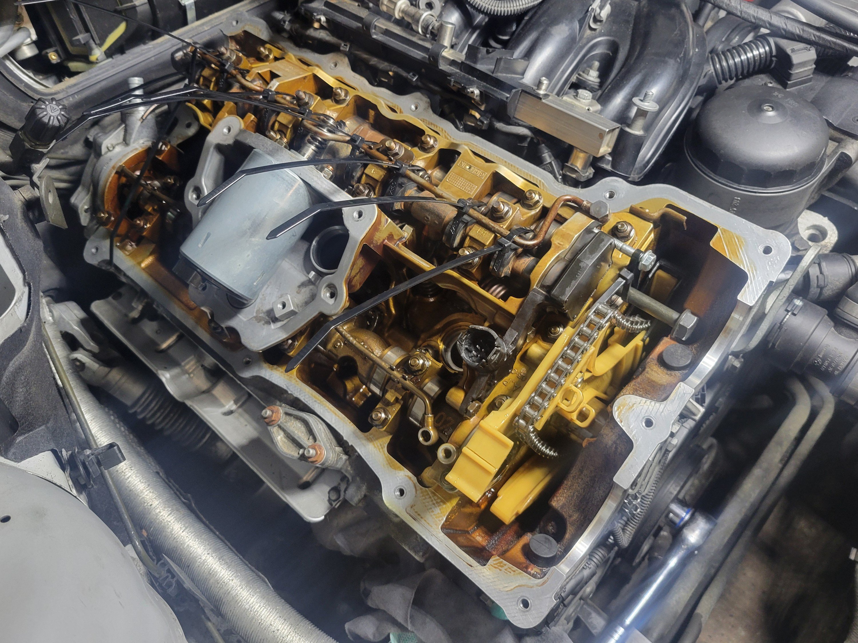

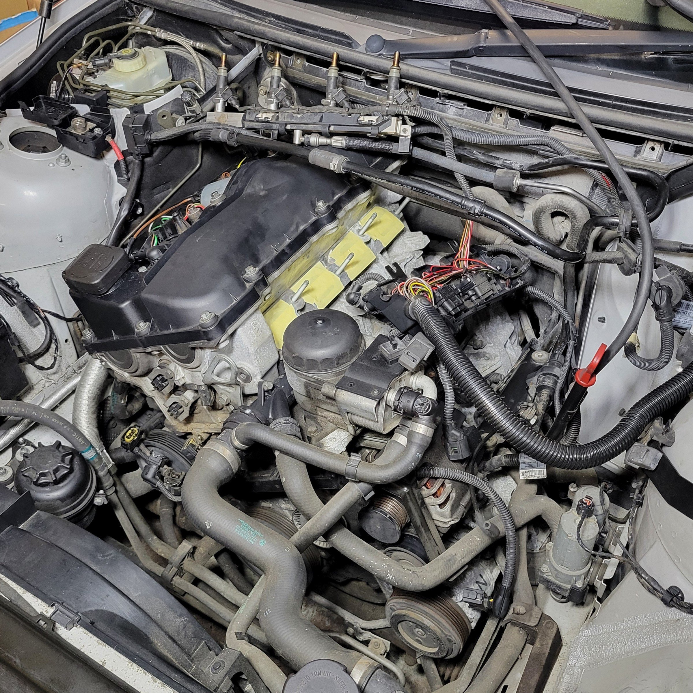

Removed the valve cover, checked & cleaned the eccentric shaft sensor, swapped in a spare valvetronic motor from a newer 120i, hooked it all up, ran the stop limit adaptation procedure with a scan tool - all ran fine indicating the valvetronic motor and eccentric shaft sensors were both operational. Buttoned it all up, still crank no start. Good thing is no VVT-related codes have come back since, suggesting the fault being to do with a faulty old valvetronic motor. Only code remaining in the DME is for the ambient temperature sensor, which is inconsequential.

Weirdly enough, with the injectors unhooked the car actually fired up for a few seconds and sounded pretty good doing it, much to my mate's audible surprise. The spray pattern seemed roughly consistent and we couldn't note any leakage afterwards with the ignition off either.
Spark plugs were completely soaked and reeked of fuel so we swapped in a spare set. Also swapped out some coils for newer spares, checking spark prior to dropping them in. Crank no start.
Decided to try another weird experiment by dropping the sparks & coils half way down into the cylinders, which did look quite cool.

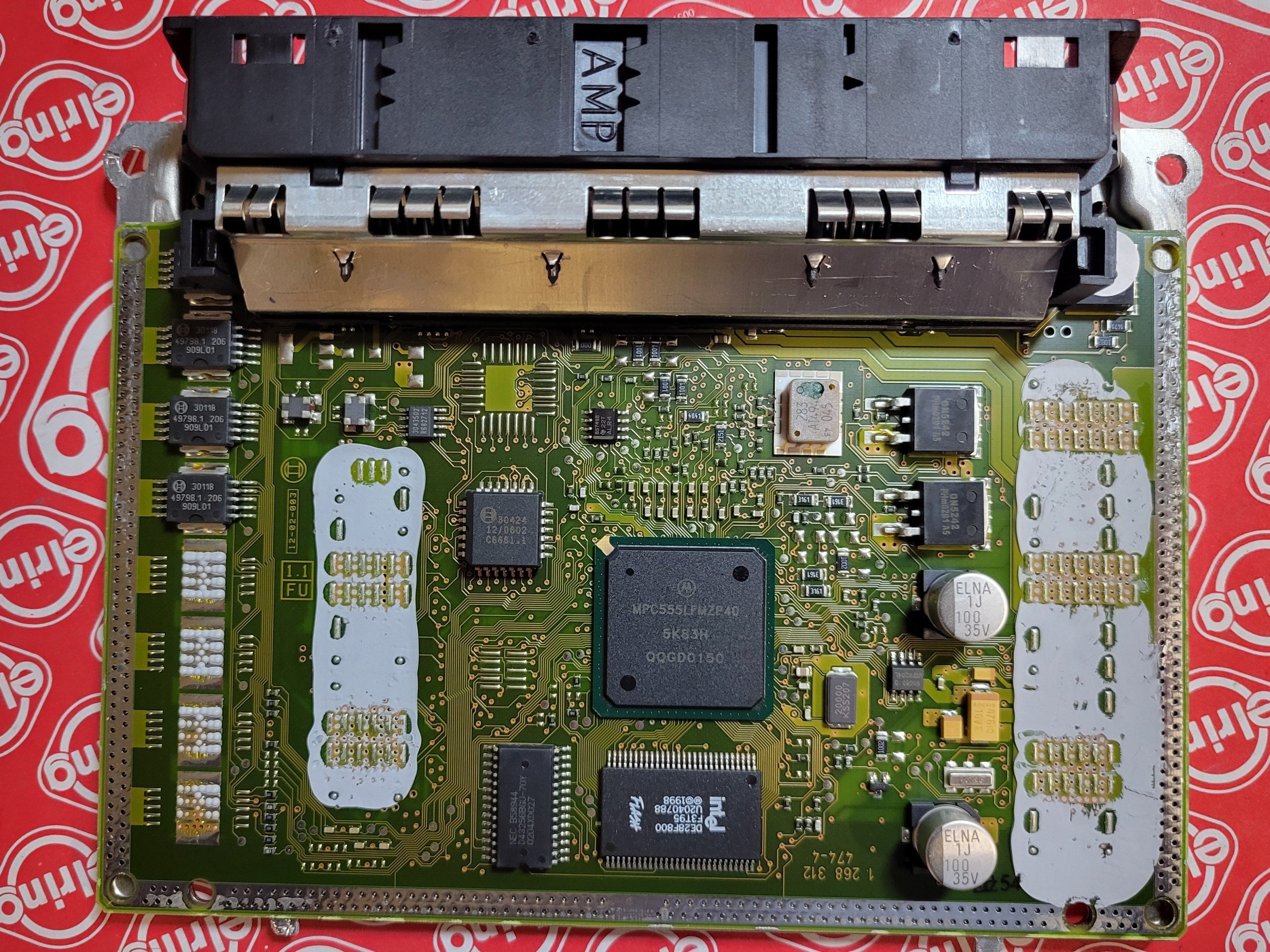

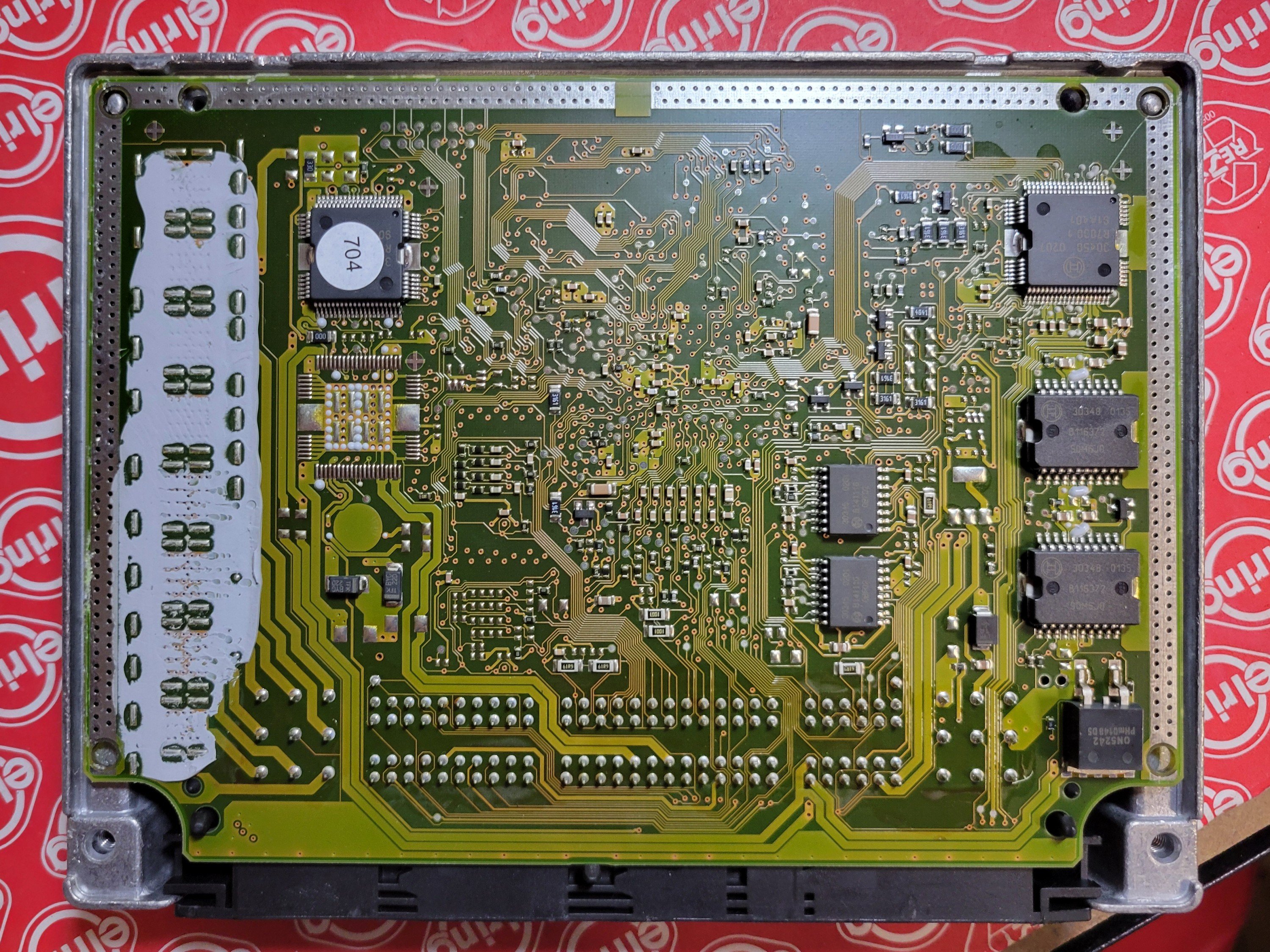

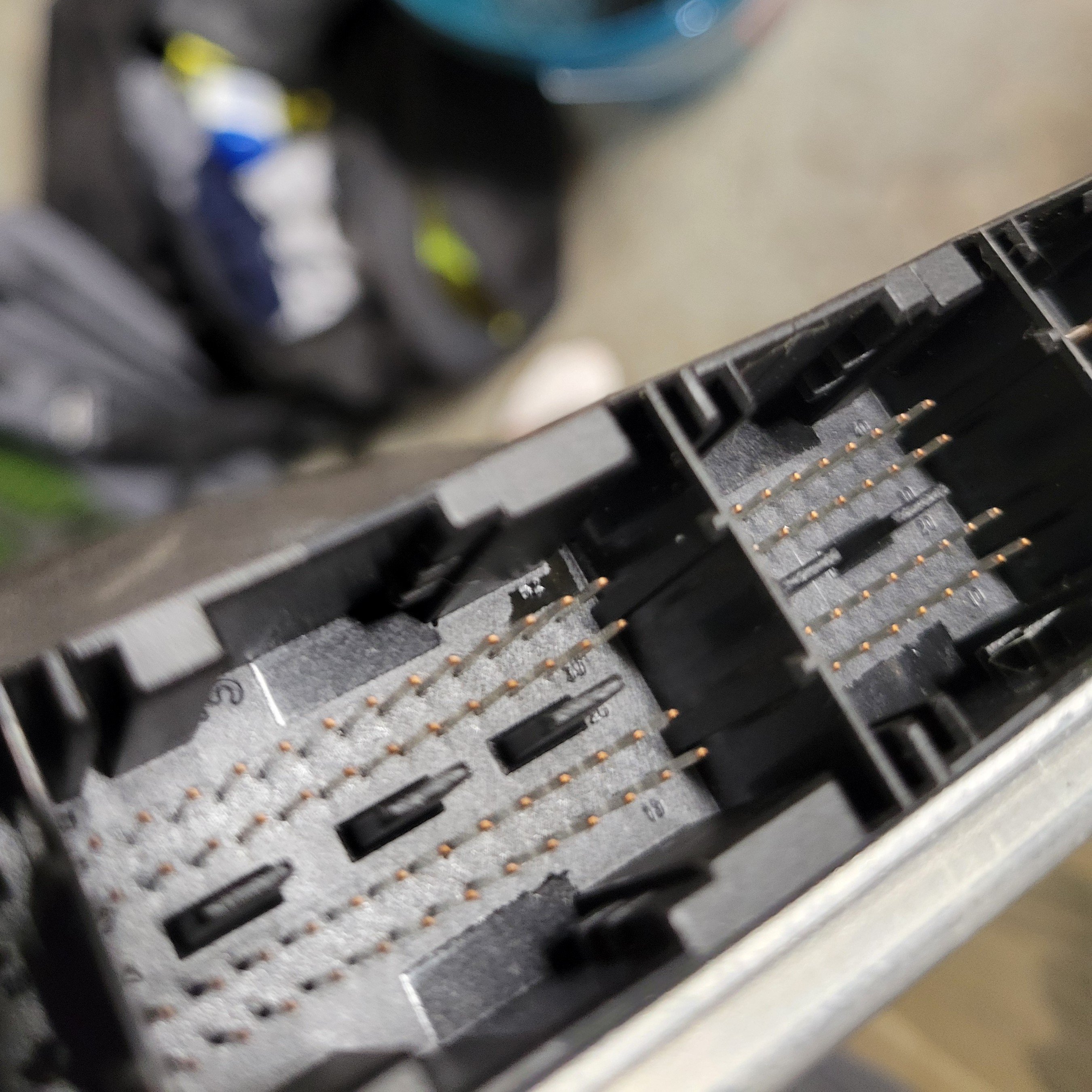

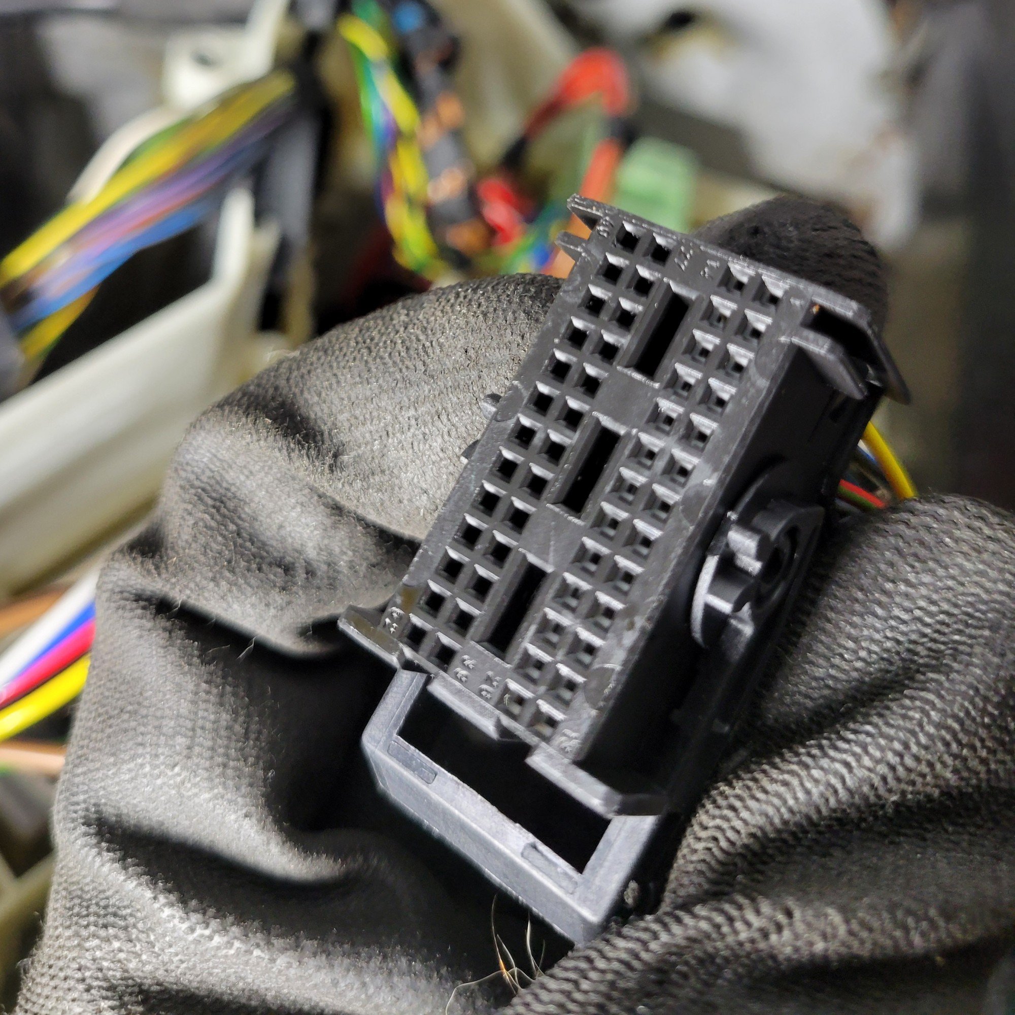

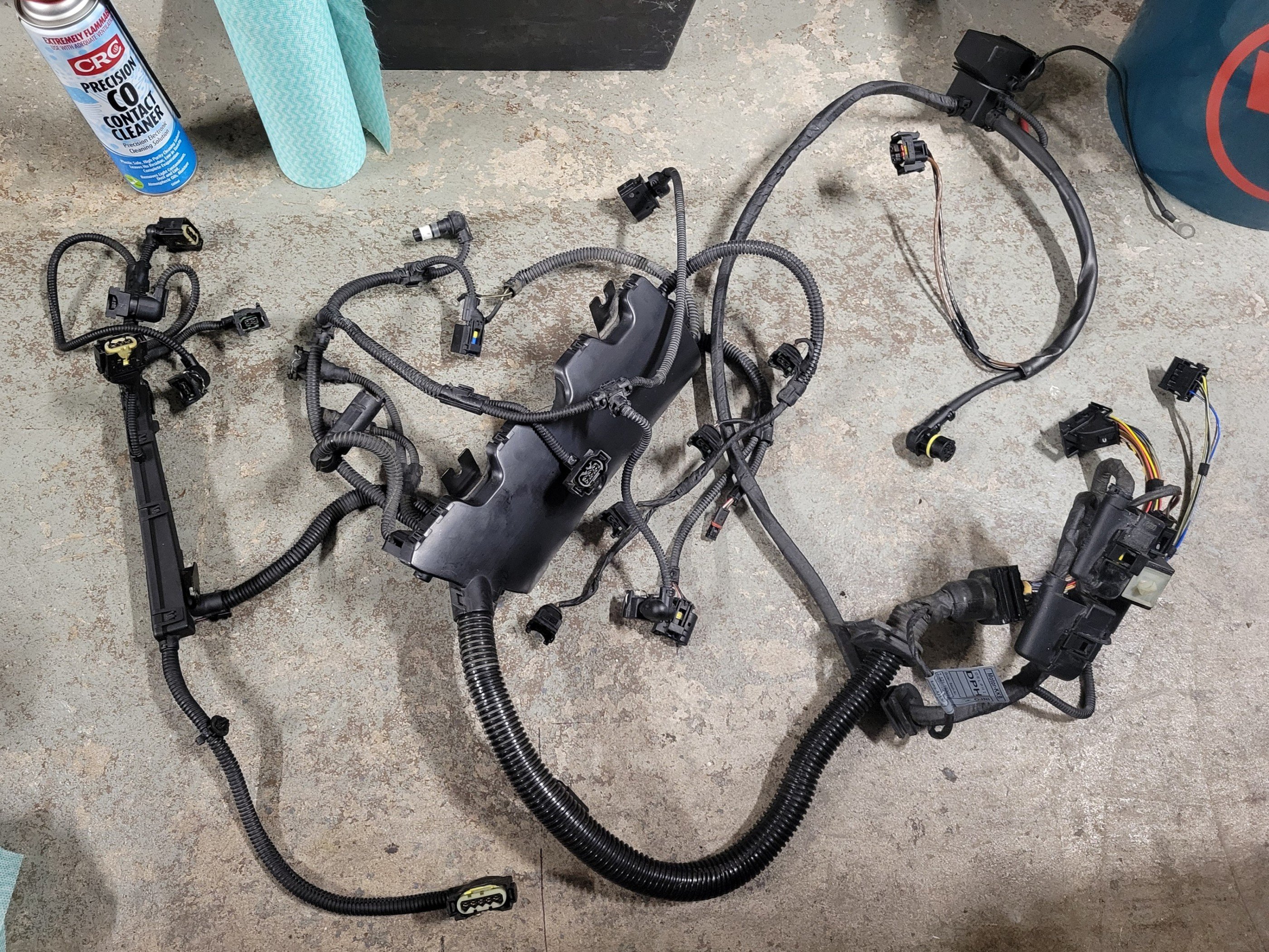

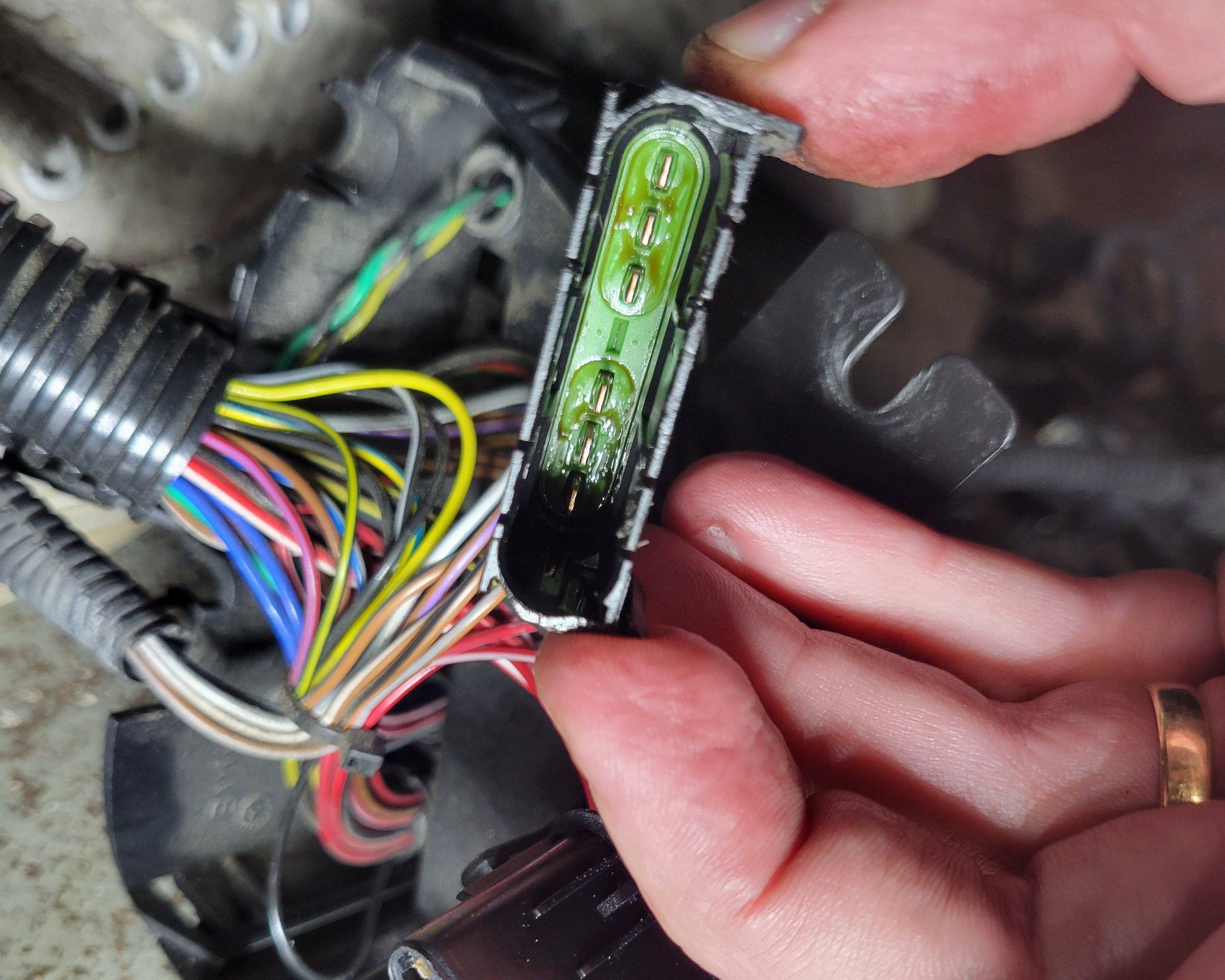

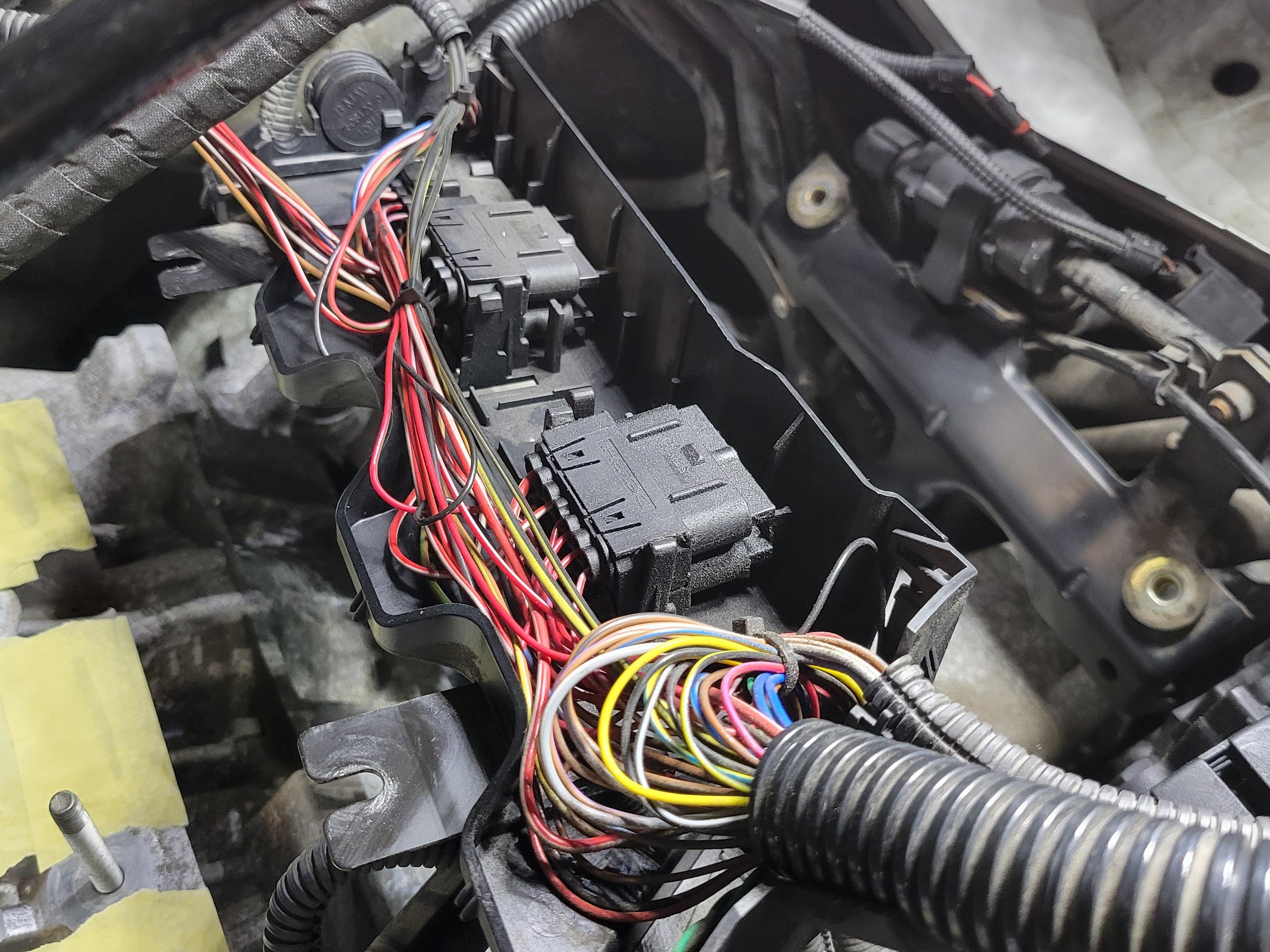

All I've done so far is disconnect the DME and inspect it. What I found was some oil on the main engine harness plug that had migrated along the wiring from one of the sensors/solenoids all the way to the DME, which is apparently a thing that happens... In our case it's just a tiny amount that I could see but the car hasn't run in a good 4 years now so it might have had more there and it's just dried out over time.
In any case, I sprayed both ends down with contact cleaner spray, then took the DME out of its casing to inspect for any other damage that might stand out but all looked fine to my unscrupulous eye.
That's about as far as I've gotten with it so far, am yet to reinstall the DME back into the car to see if that did anything. I want to again remove the intake manifold and give everything a going over before attempting another start, will then check/clean the ignition switch and try resync the DME to the EWS and eliminate that as a possible culprit.

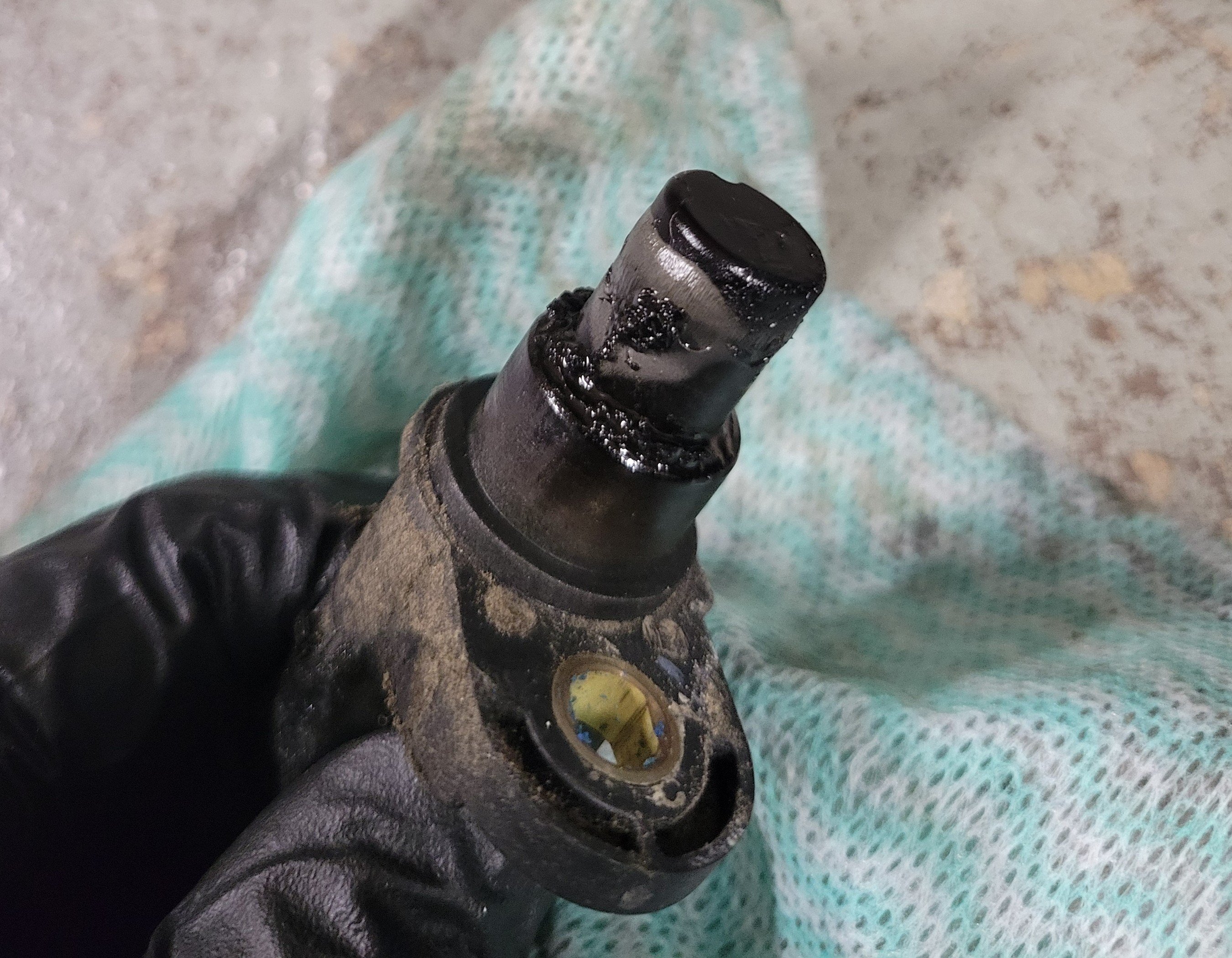

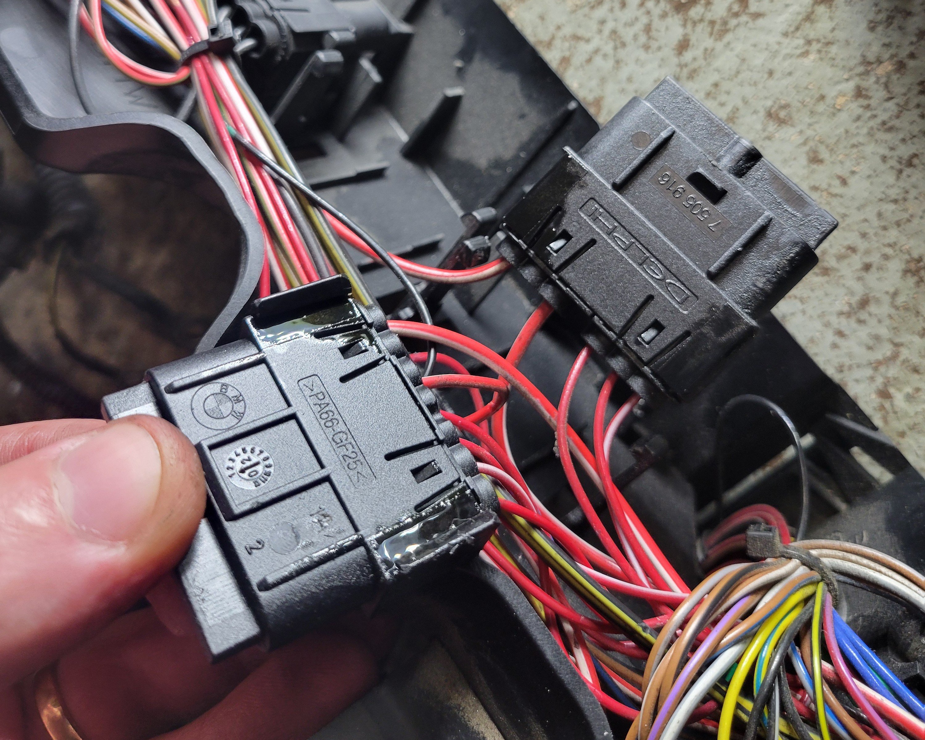

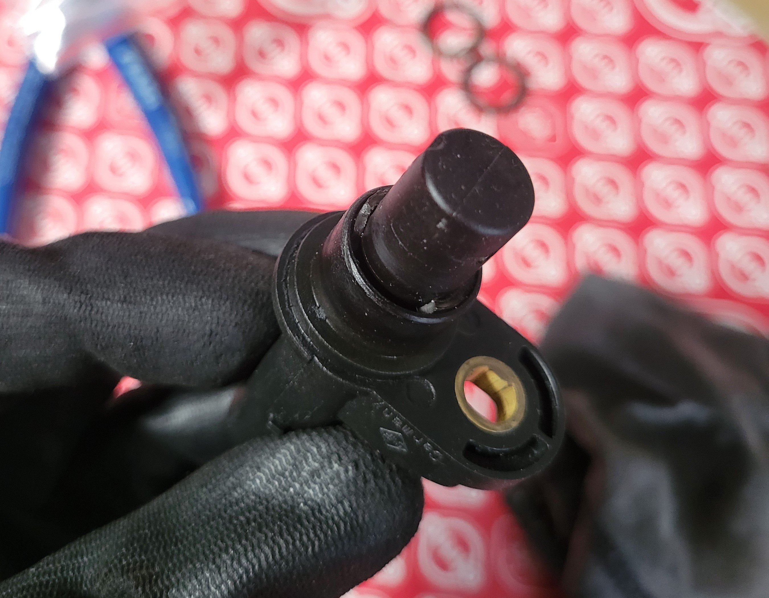

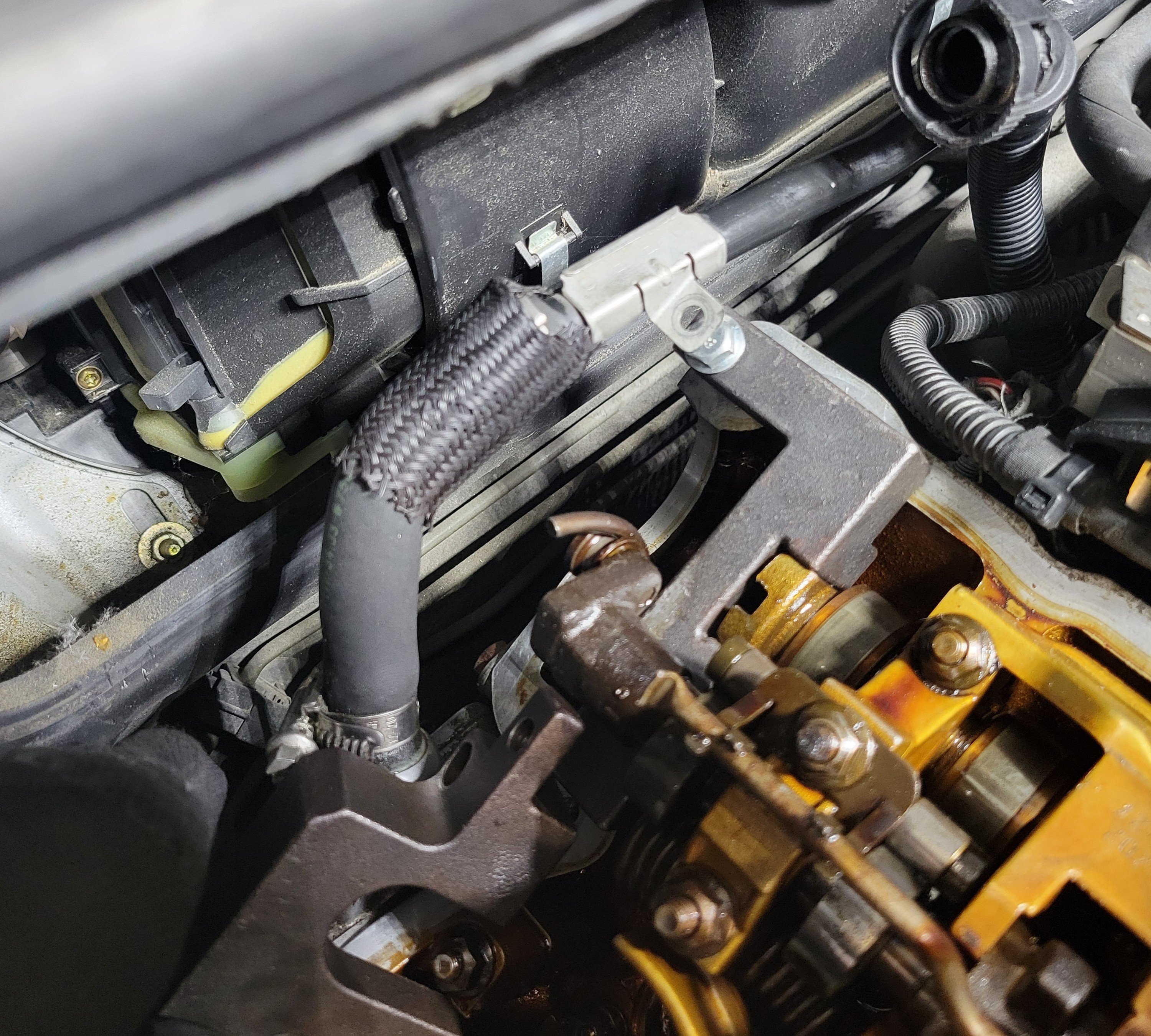

I traced the drenched plugs to the cam sensor wiring at the front of the engine. I also removed the cam sensors themselves to check them out. They were the older design ones with a thinner end bit becoming wider half way along with a rubber seal at the junction. That rubber seal had all but perished on one of the sensors and along with external leaks, seemed to also shooting oil straight through into the plug.
I swapped in some spare, newer design cam sensors I had handy, as well as the crank sensor for good measure. I then went through the whole loom with contact cleaner spray, tidied up the whole thing and reinstalled it.

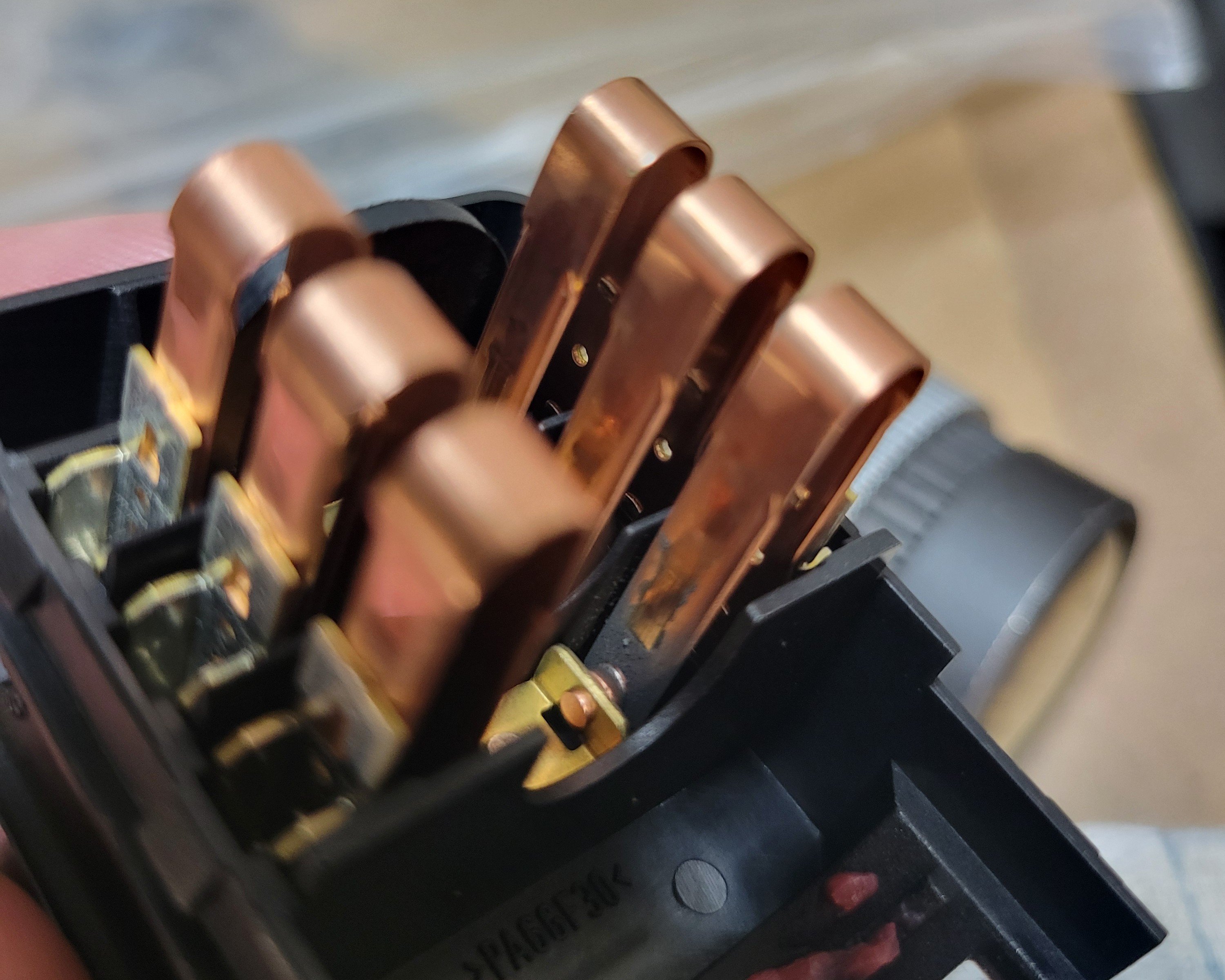

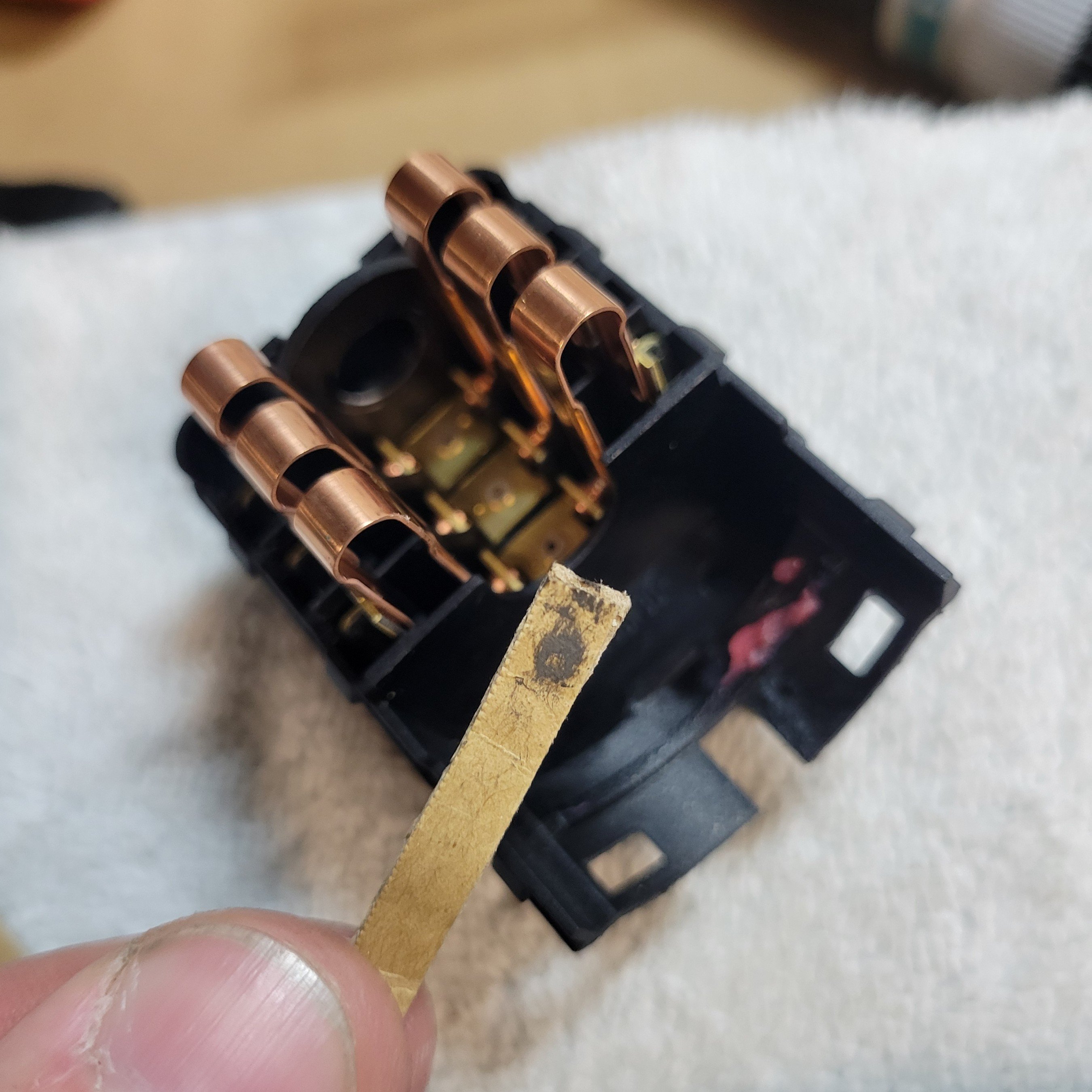

I then moved inside, removed the ignition switch and gave that a good clean. Those are known to cause all sorts of erratic electrical issues and was good to eliminate as a possible culprit. One of the connection spots was really gummed up with carbon dust so could have been beginning to be problematic.

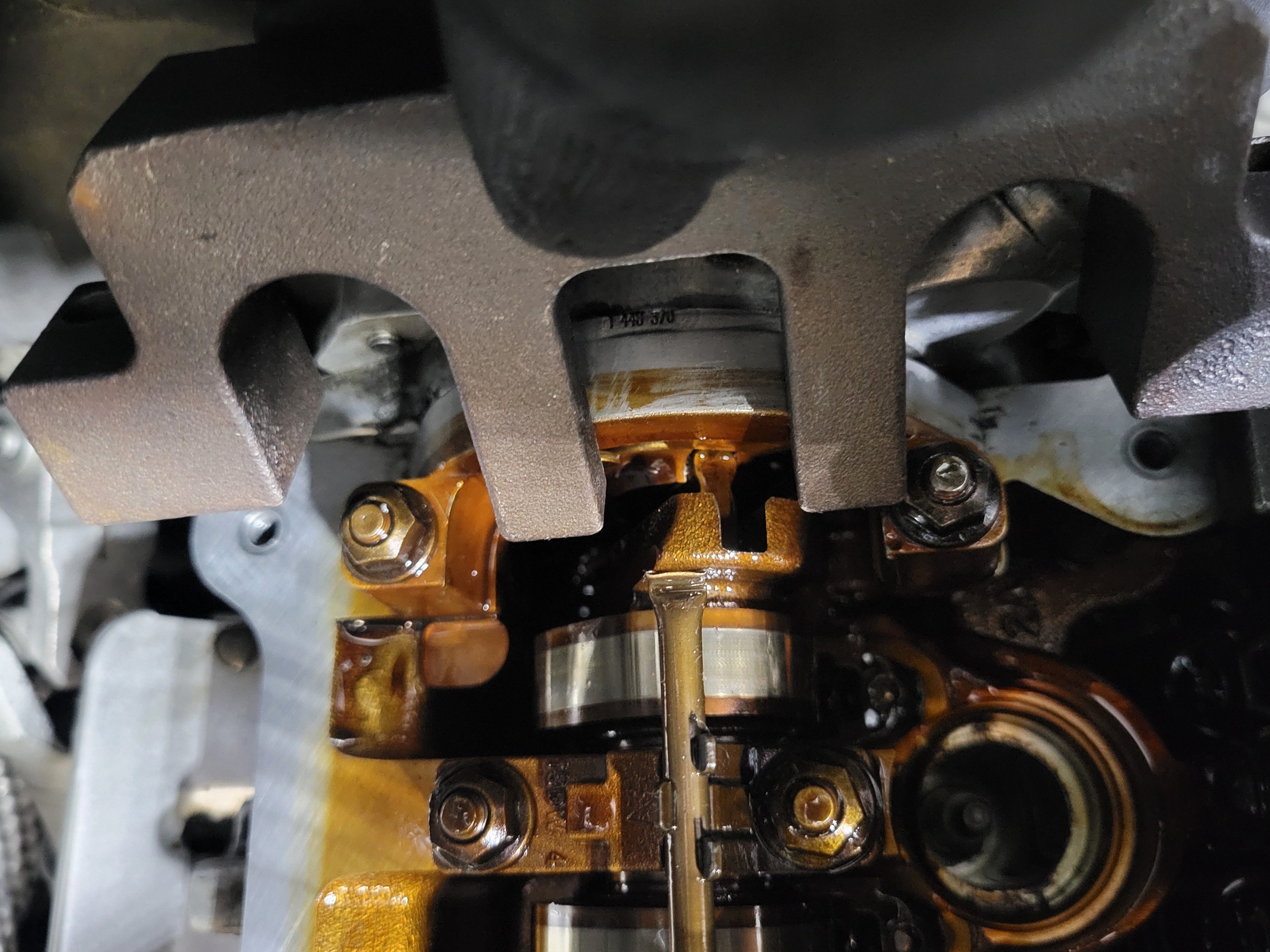

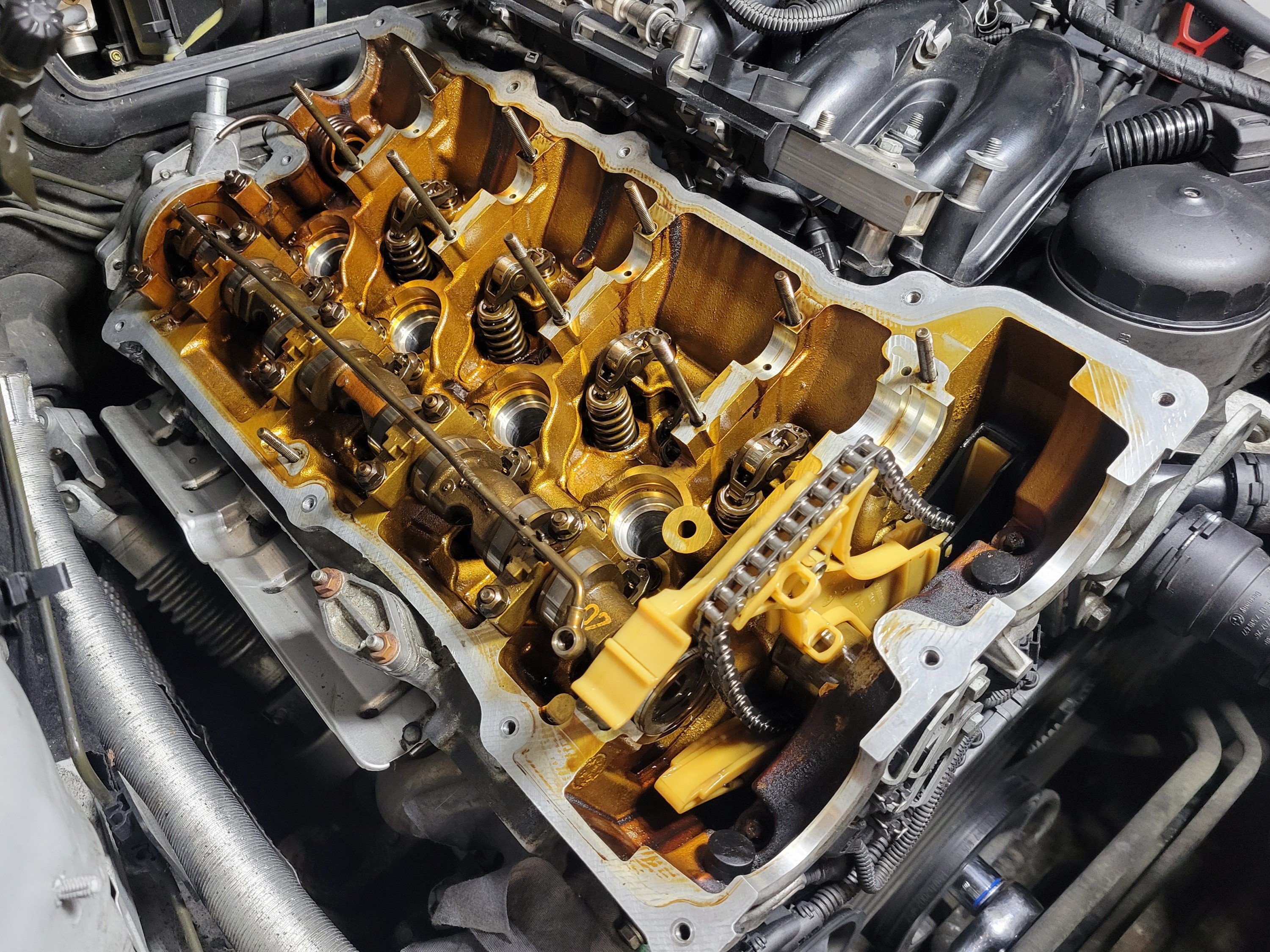

It was only at that point that I decided to do the thing I should have done as the first step. I borrowed a timing tool kit from a fella I'd bought some parts from a while ago, opened up the valve cover and had a fresh peek inside. The intake cam locking tool was a real tight squeeze to install but finally went in, only to then move over to the exhaust side and find it nowhere near fitting.
Bastard.
That was a massive oversight on our part. Should have checked timing as the first thing but I guess since we managed to get the car running and idling perfectly smoothly a couple of times we just assumed that the timing wouldn't have been the issue. It must only have been marginally out, not beyond what the valvetronic system could compensate for, but not consistently enough for some reason.

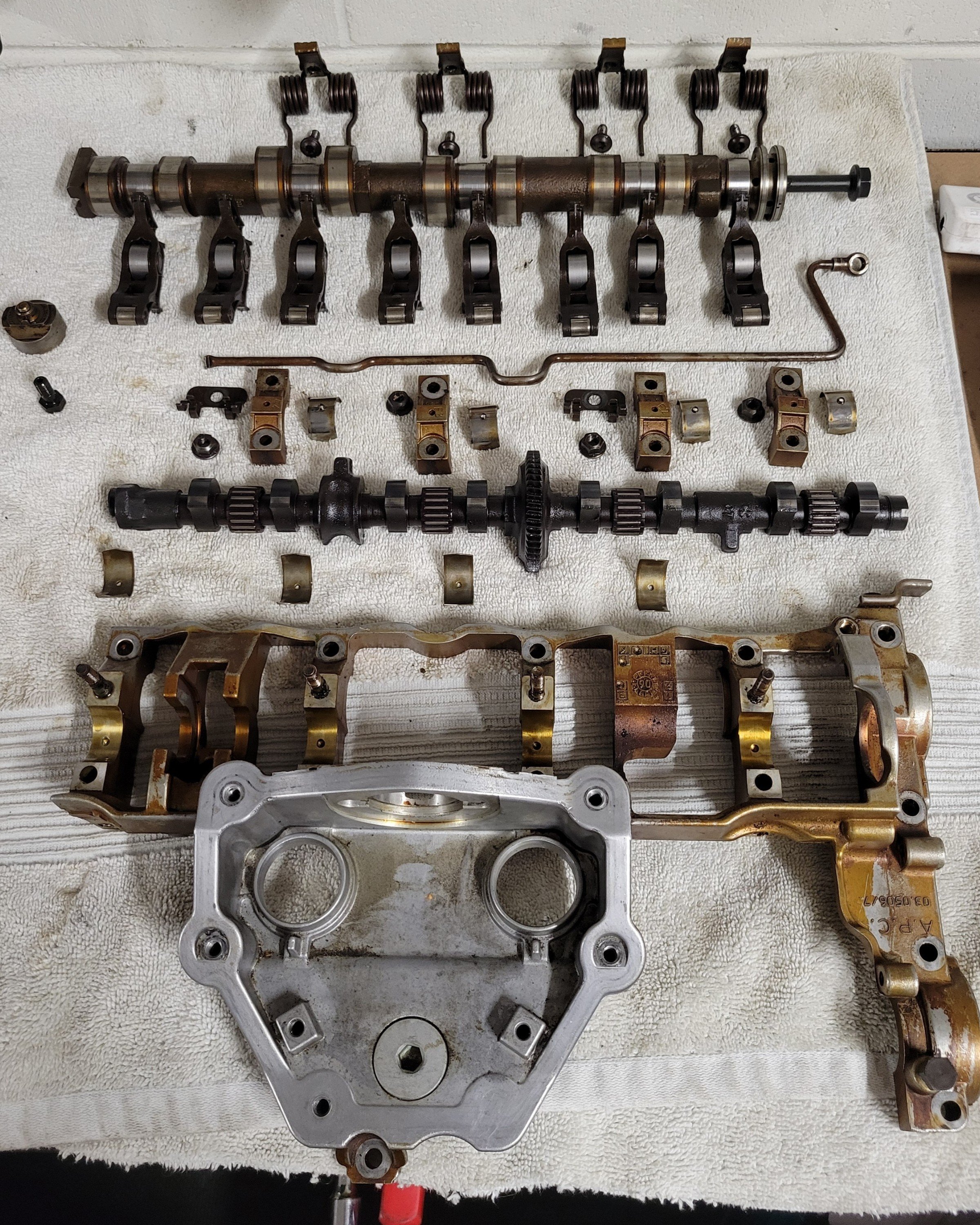

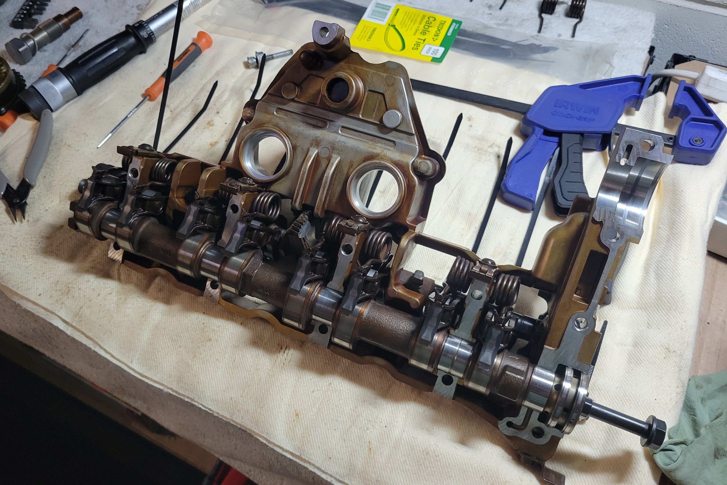

How, when and why it skipped timing is a bit of a mystery. The car has 165,331km's on the clock. At 160,736km's it had a timing chain, guide, tensioner etc replacement done at Christchurch BMW so it hadn't even done 5k km's since then. Weird one all around.

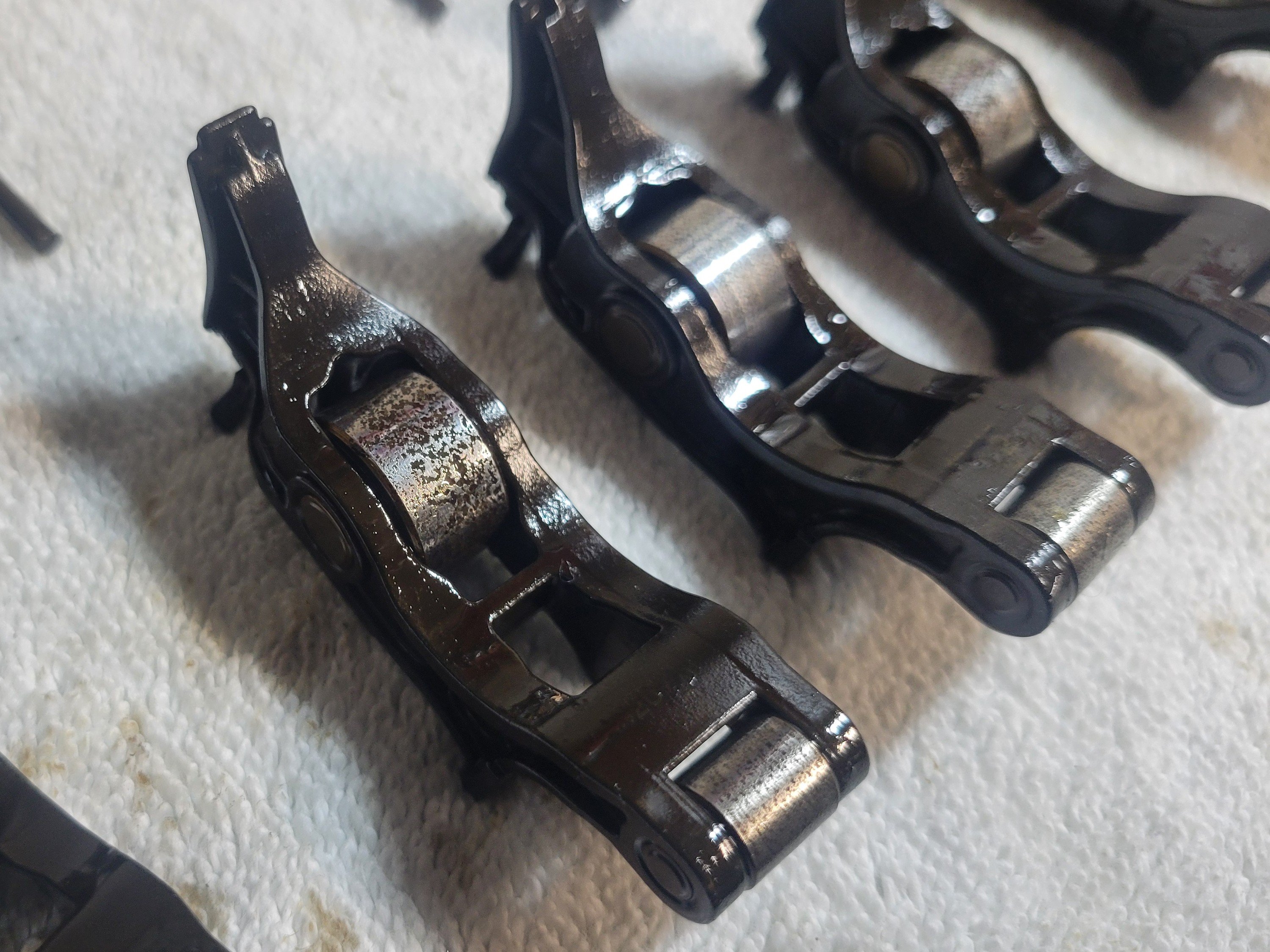

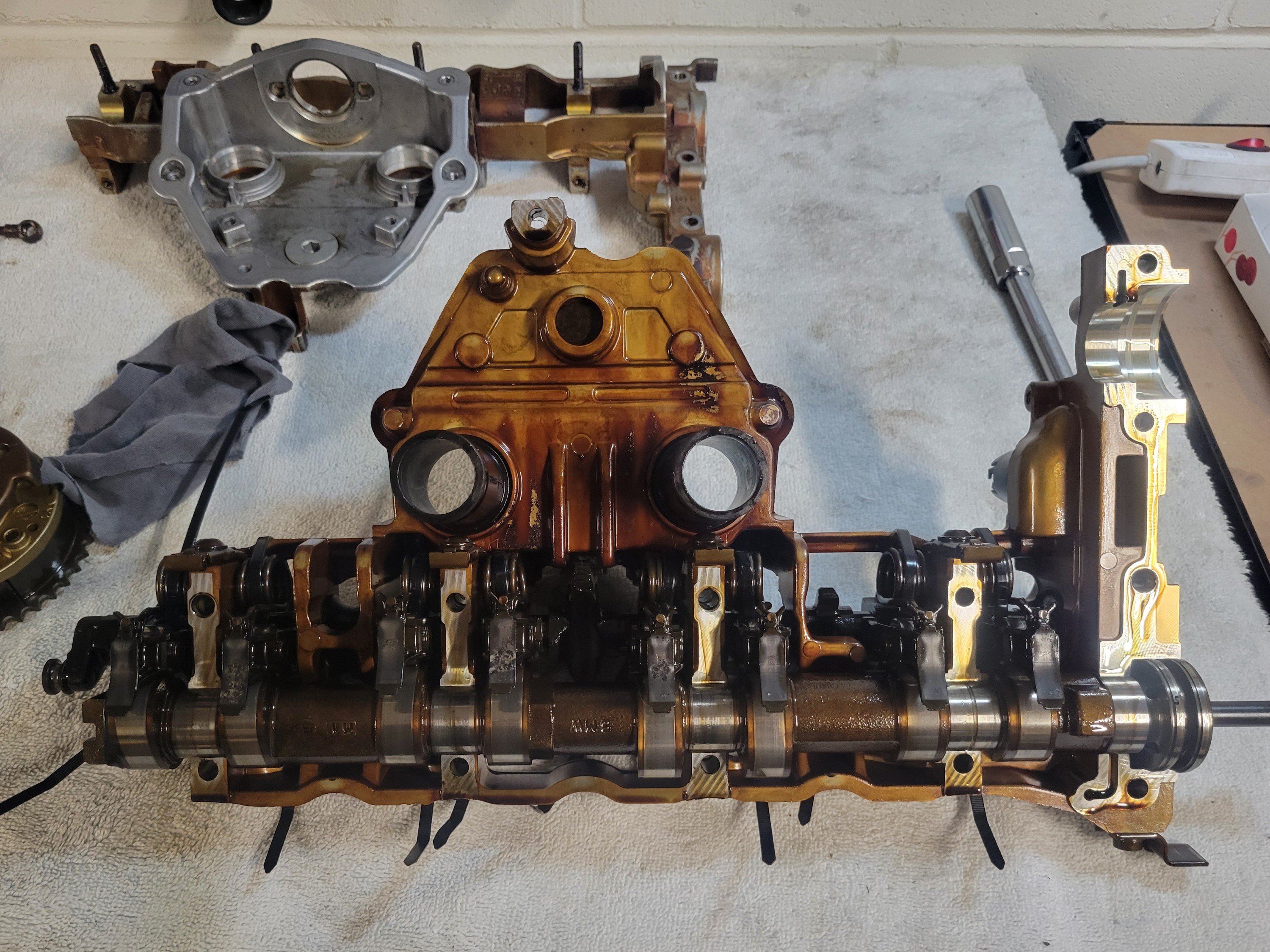

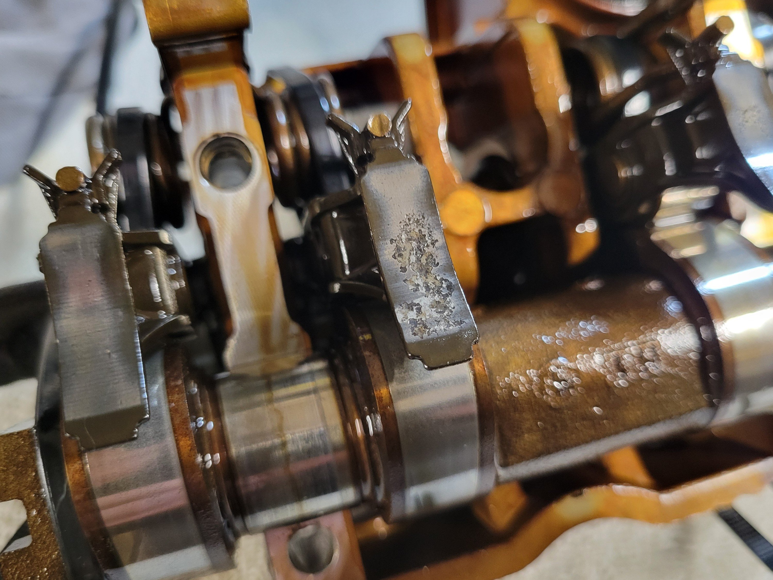

When picking up a spare valvetronic motor a year ago, it came with a whole valvetronic assembly that I parked up on a shelf but now came in quite handy. I figured since I'm disturbing timing anyway, I might as well remove the whole thing, give it a checkover and a clean. I started on the spare unit as a test run before removing the one from the car and tearing that one apart as well. The video series from BimmerZen was super useful throughout the whole process.

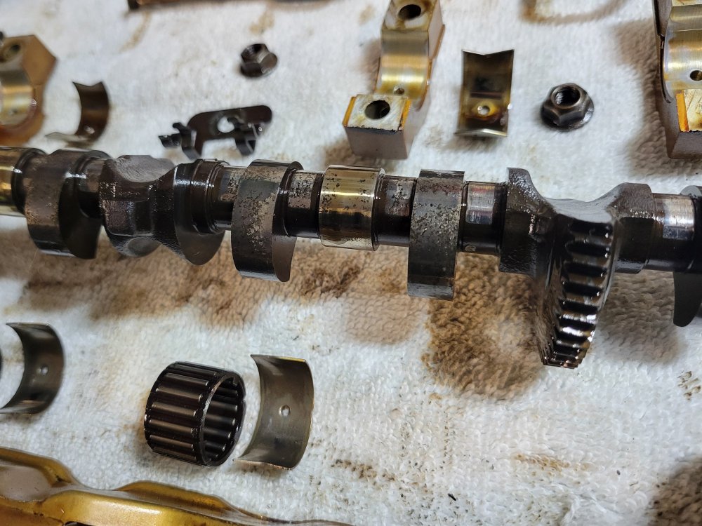

Straight away it became apparent that the unit that came off the car was in real shoddy state. Whether from neglect during its life or purely from sitting for close to 6 years now the surfaces on the tappet arms (or whatever you call them) and eccentric shaft had become quite badly pitted and looked really rough.
Luckily, I had the second unit on hand and between the two of them made up one decent one.

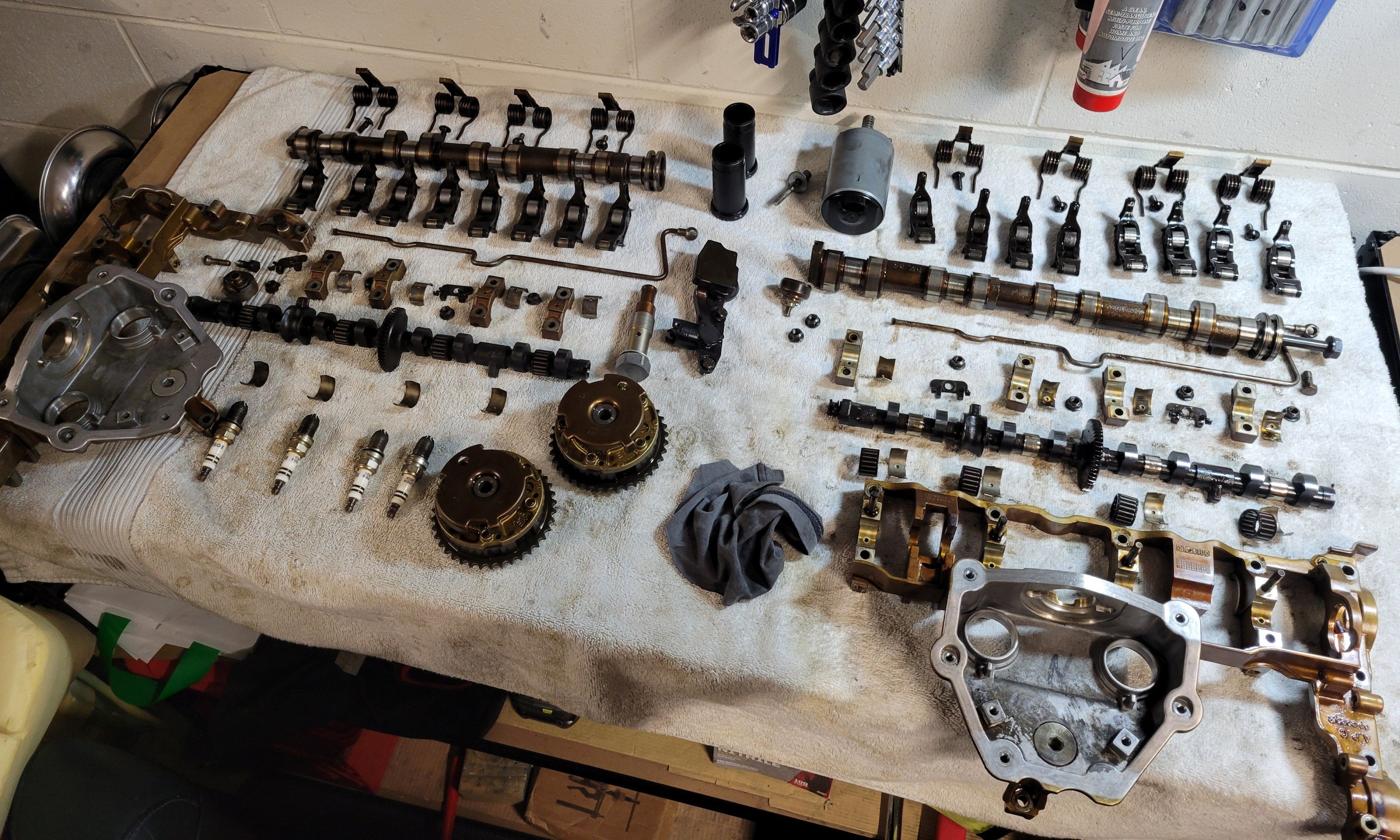

Got back to tinkering on this little nugget this past weekend. Since it was still misfiring, I decided to do a compression test to make sure the issue isn't with any of the valves getting jammed. Shockingly, the result was 225-230 PSI on all cylinders.
I was a bit taken aback by such high numbers. I then noticed that I had disconnected the valvetronic motor and the eccentric shaft sensor plugs when removing the coils. Wasn't sure if it'd influence the results I reconnected them and redid the test, this time around getting 175-185 PSI on all cylinders.
That ruled out compression being the issue. I then moved onto the smoke tester to check for vacuum leaks. Having removed the airbox and throttle body to insert the smoke tester adapter, I discovered a major f**kup, which turned out to be the cause of the backfiring - a vacuum hose from the EVAP valve was left dangling loose, unconnected from the intake manifold. It took a fair bit of force for it to clip in properly, not sure if I had missed it completely or hadn't seated it properly when reinstalling the intake. The throttle body and airbox obscure it pretty well so would have been easy to overlook but silly mistake on my part none the less.
I went ahead and did a smoke test anyway, which didn't reveal anything obvious. I then took off the valve cover and rechecked the timing - all perfectly in time still.

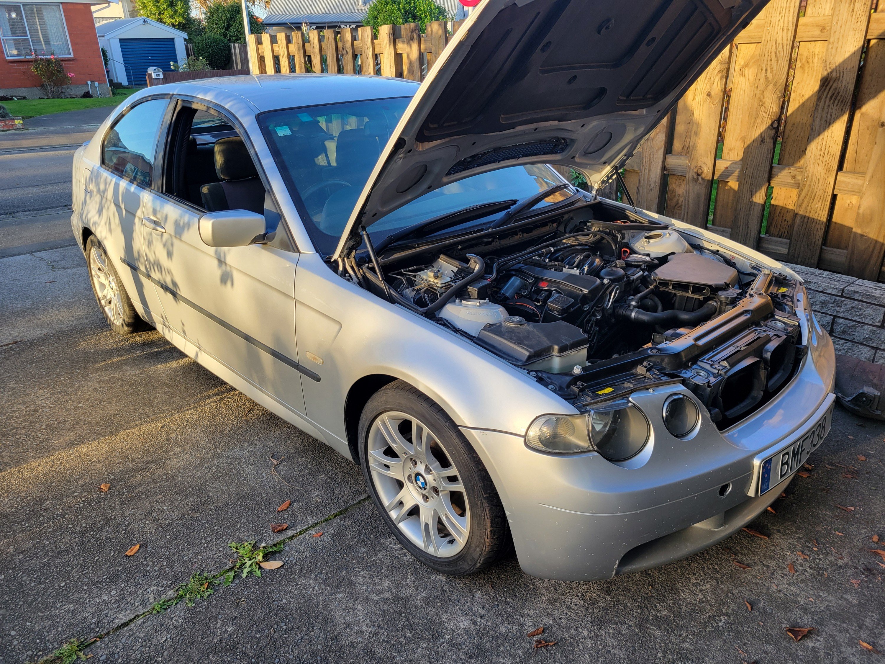

Road legal baby!

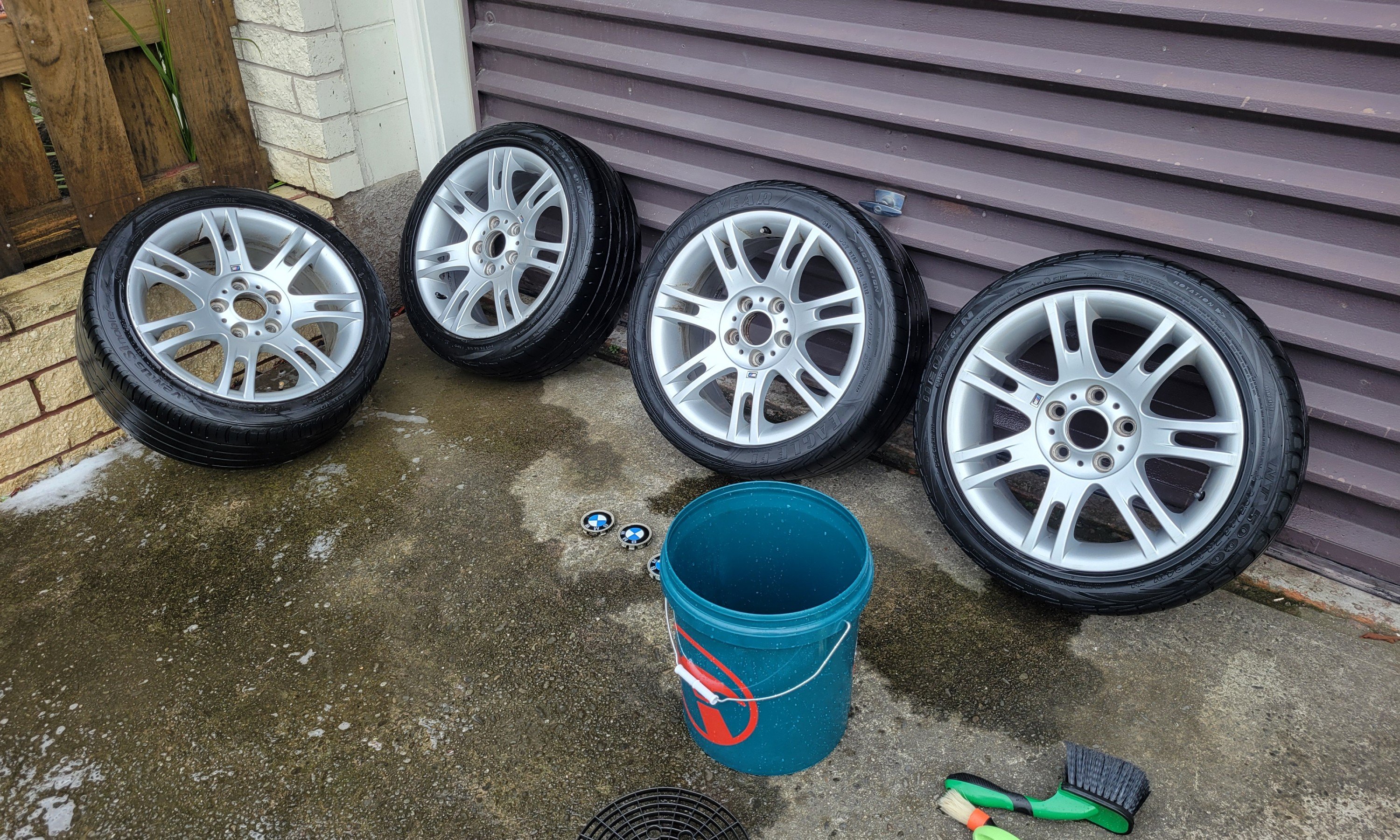

Didn't want to splurge on new tyres not knowing if it'd pass otherwise so just borrowed the wheels off the touring since it was up on jack stands anyway. Drove it in for the inspection and was shocked when it only needed a few minor bits to pass.
Both rear rego bulbs were blown. Easy fix.

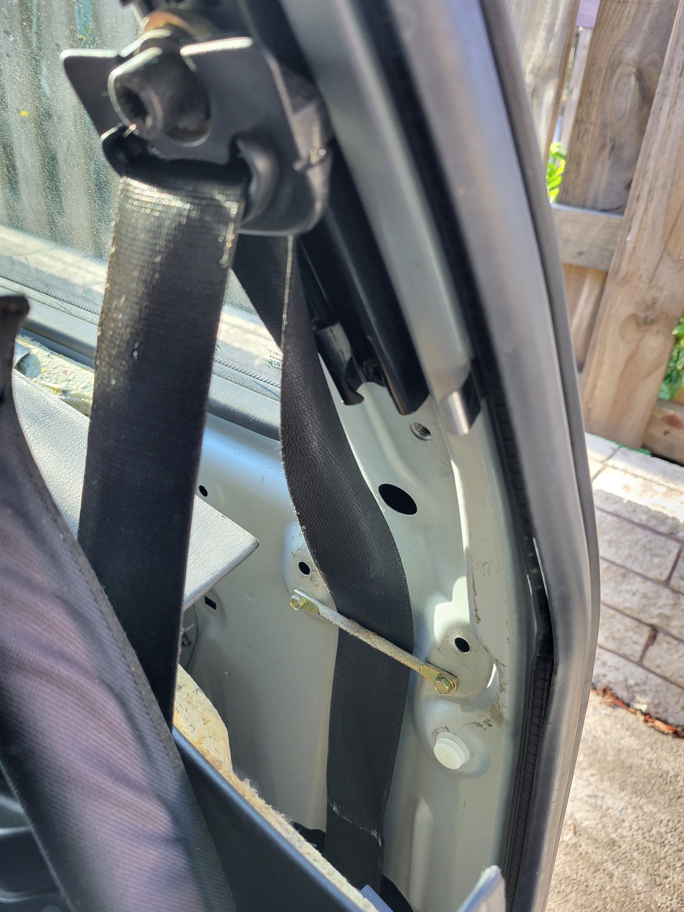

The passenger seatbelt was slow to retract, which turned out to be a weird one. It didn't look like it had ever been touched or that the panels had been off but the belt was somehow twisted. How or why that happened I've no clue. Had to twist the belt at the top pivot point, the belt buckle and at the base rail. Since I was messing with it, I also gave the belt a good clean and removed & wire wheeled the metal cross bar since it was all crusty and was catching on the belt.
The wiper one was also an odd one. The driver side one was leaving a spot untouched right in the middle of the wiper. Threw on a fresh set of wipers which I thought would fix it but it barely improved the situation. I then noticed that the middle of the wiper was barely touching the glass. Figured the spring in the wiper arm itself had stretched out. I had a spare one laying around that felt a bit firmer so just replaced the whole wiper arm, which also only barely improved its function. Ended up giving the glass a good clean, a quick polish and some SiO2 coating which didn't eliminate the issue completely but got it to a point where it passed anyway. Might have to revert to the oldschool truss-shaped wipers instead of the fancy aero blade ones. Super odd.
Took it in for reinspection and voila, she's all WoF'd & reg'd. The brakes was the main bit I was worried about since the rotors looked a bit pitted but they don't have a lip, the pads have plenty of meat left and it stops fine (or as fine as it would with its tiny 316ti brakes) so the inspector was happy that the pitting would clear up just with a bit of use. Happy days.

Gave its wheels a good scrub too. The front tyres have a wee bit of life left in them but the rears are completely bald so will have to get a new pair of those at the very least.

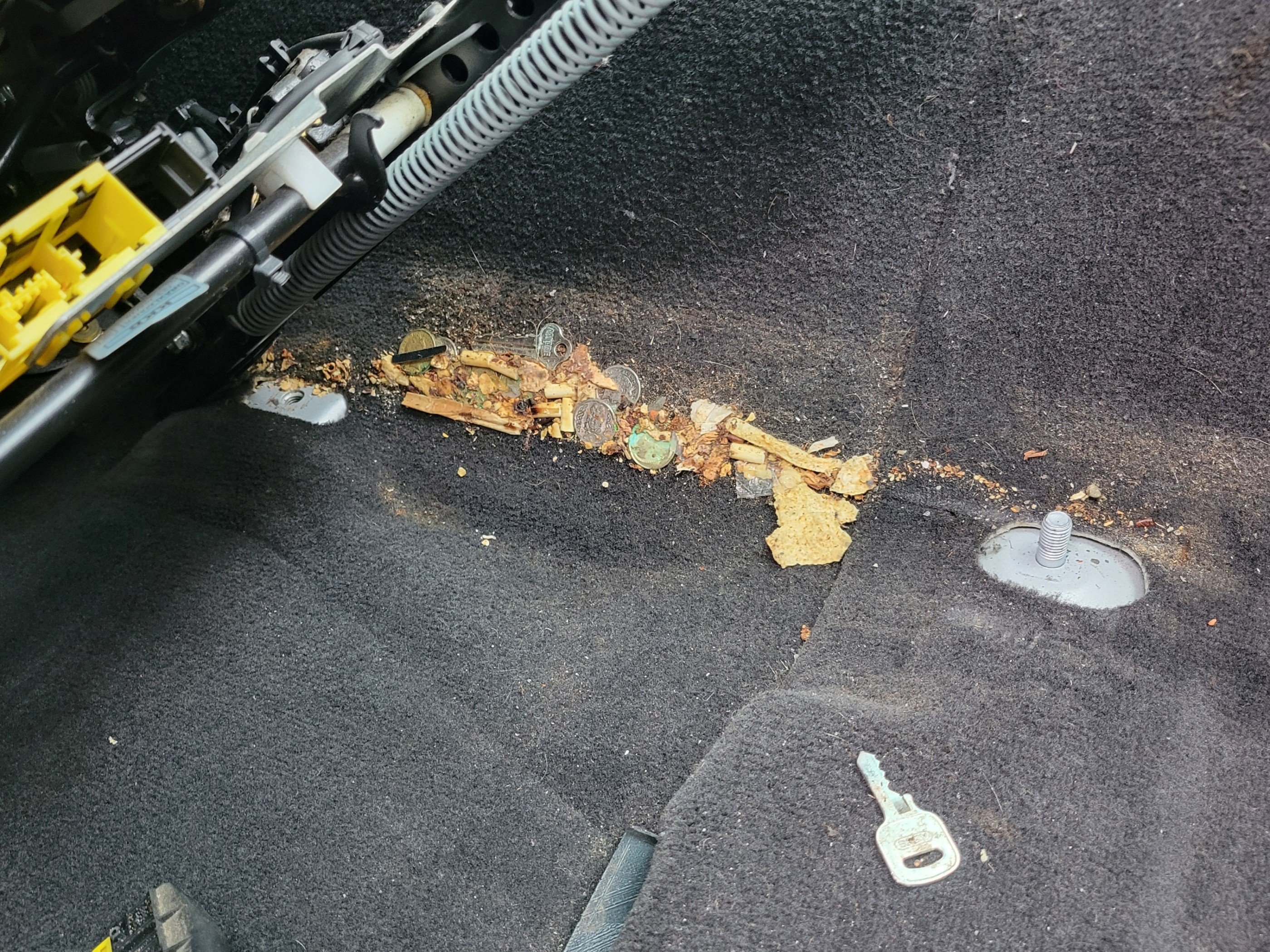

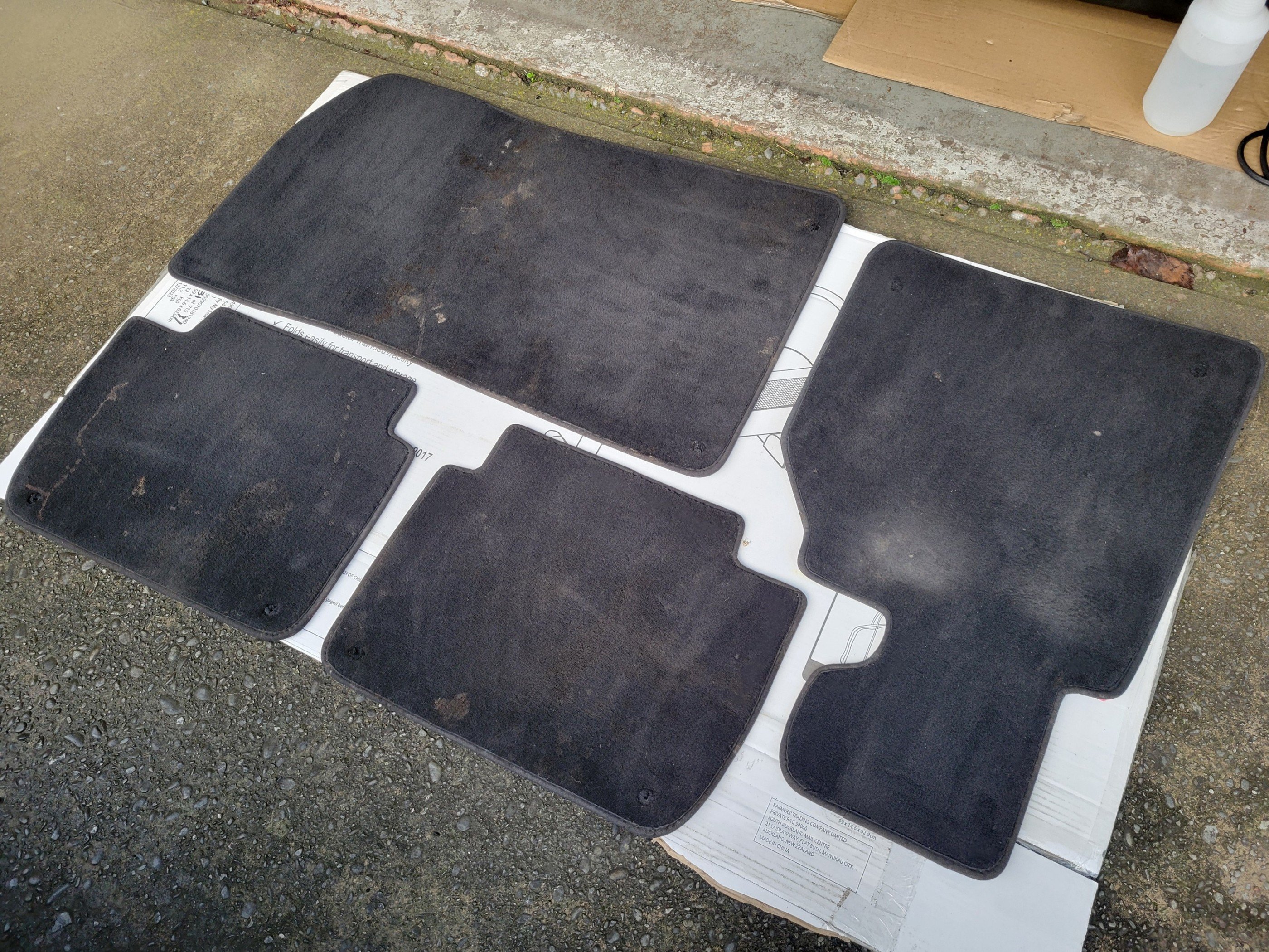

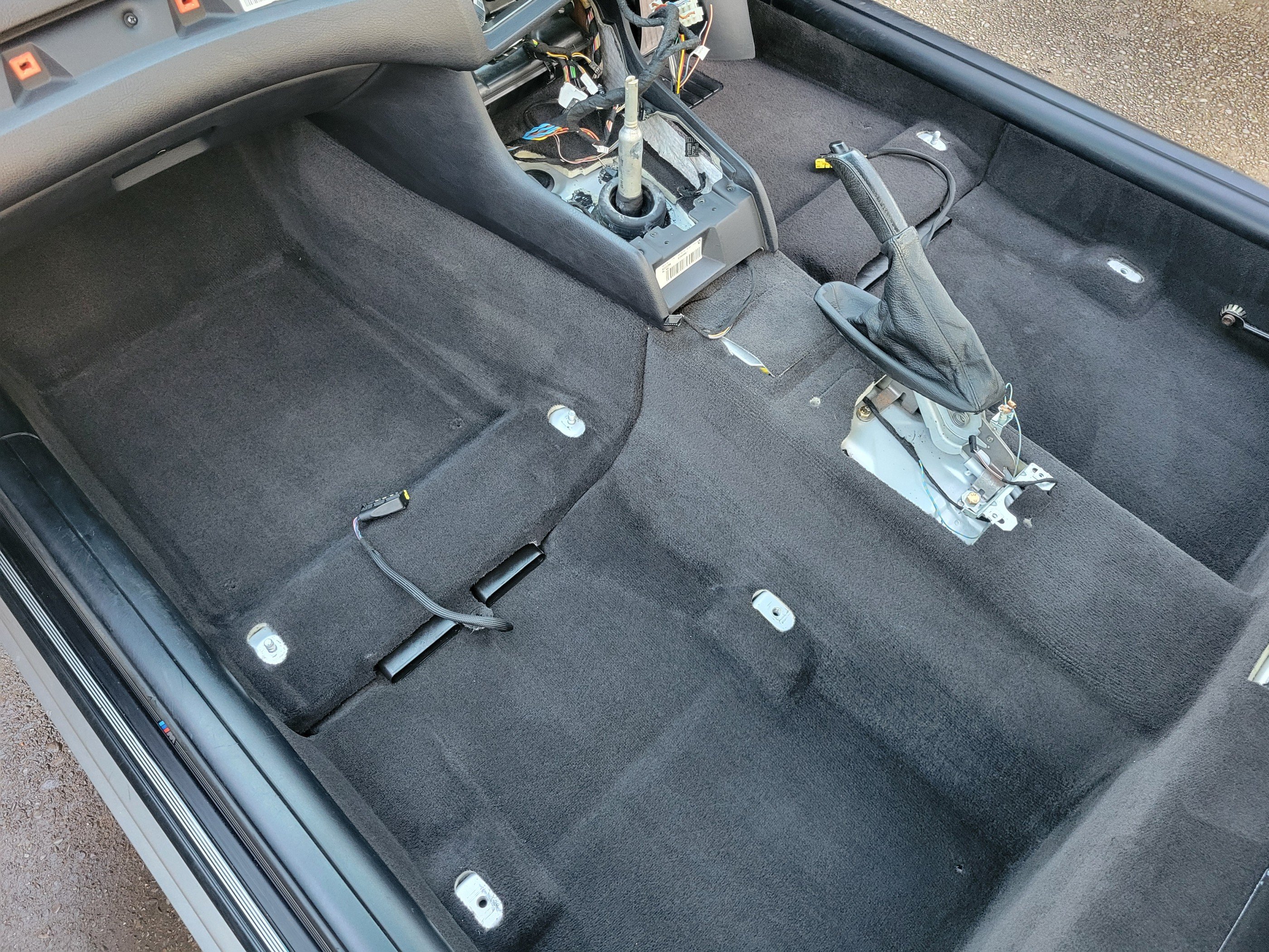

Prior to all that, I went to town on the interior since it was a truly disgusting place to be. Seemingly had coke repeatedly spilled over all the seats and interior panels, loose tobacco in every possible crevice, naturally chips and French fries all over the place too, with at least $6 in coins thrown in, bringing the purchase price down somewhat.
Pulled out the front seats and must have had 4-5 goes at either one with the Bissell until the water getting sucked out stopped being dark brown. Even after that many goes some stains still remained but a massive improvement none the less. The floor mats and carpets also took quite a few goes to get good. The carpet cleaner got the workout of its life, filling up the waste container at least twice with black-brown sewage.
Haven't even gotten around to the rear seat yet...

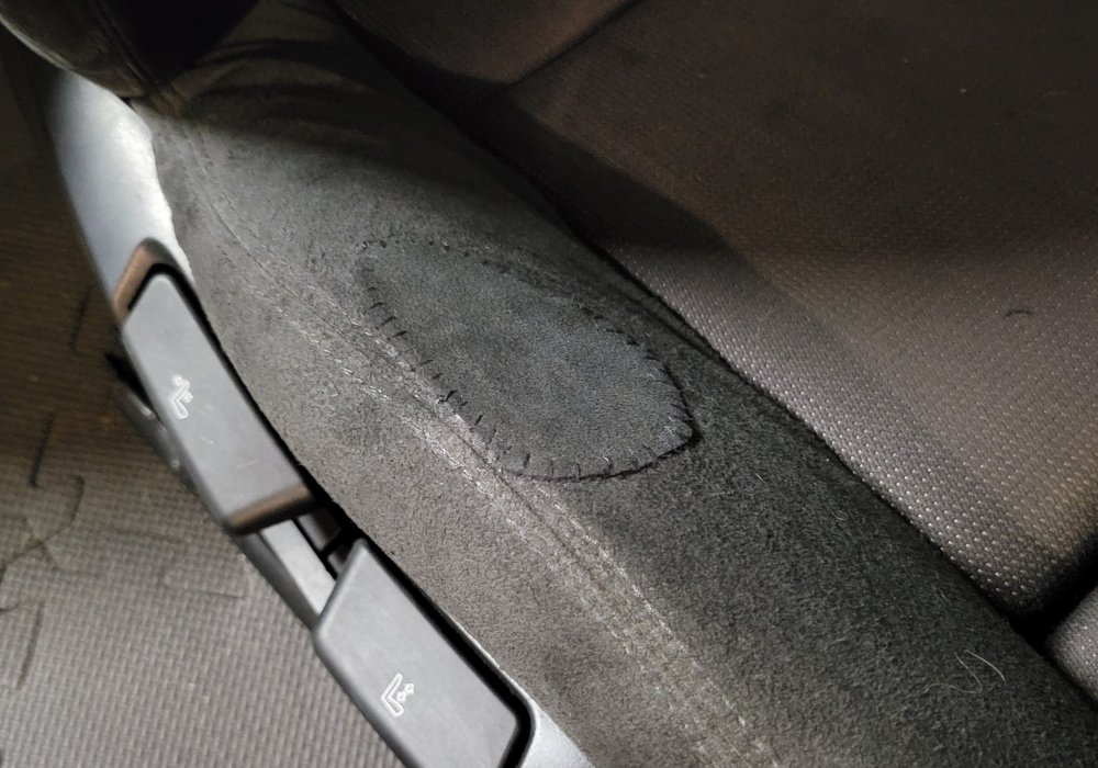

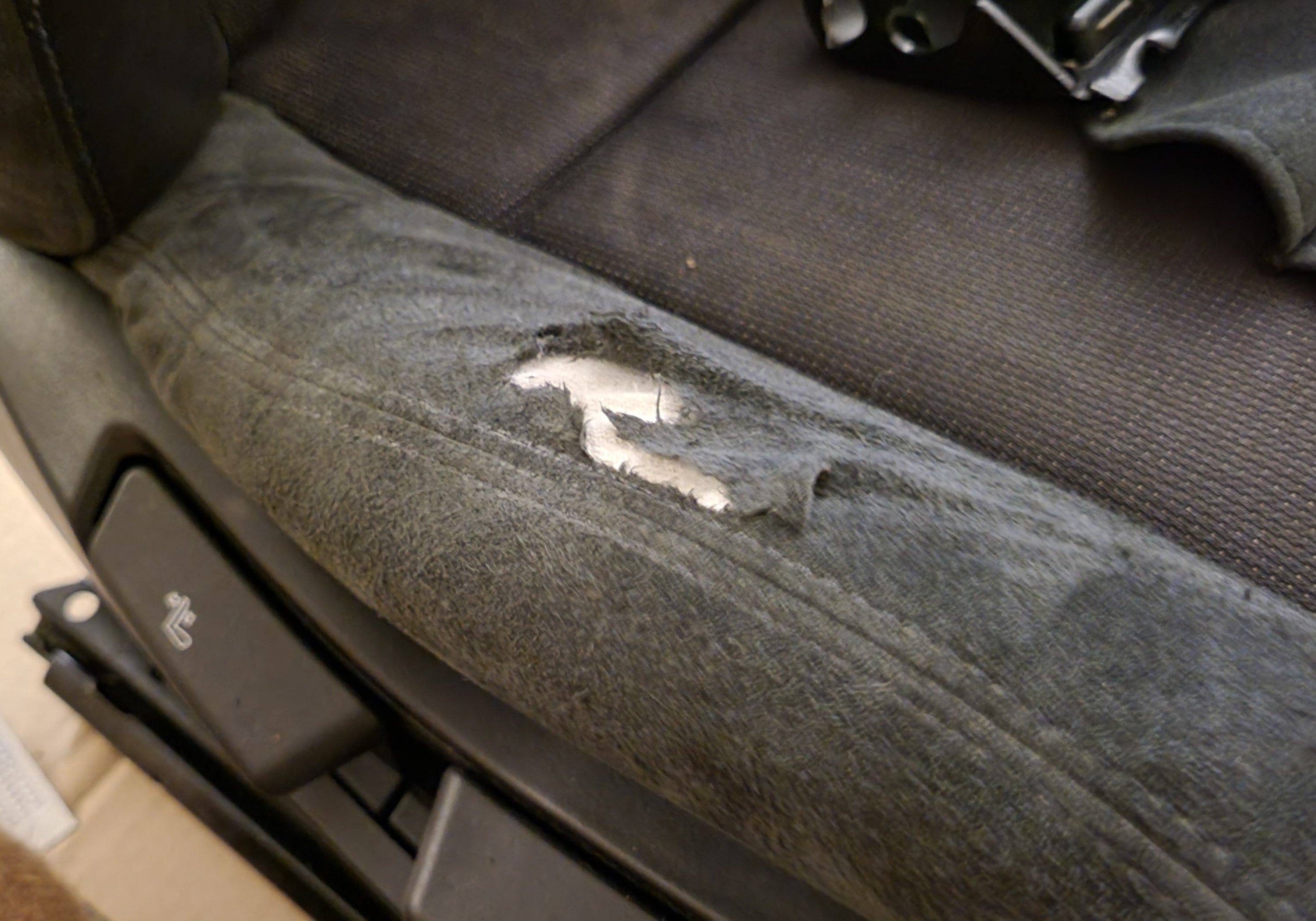

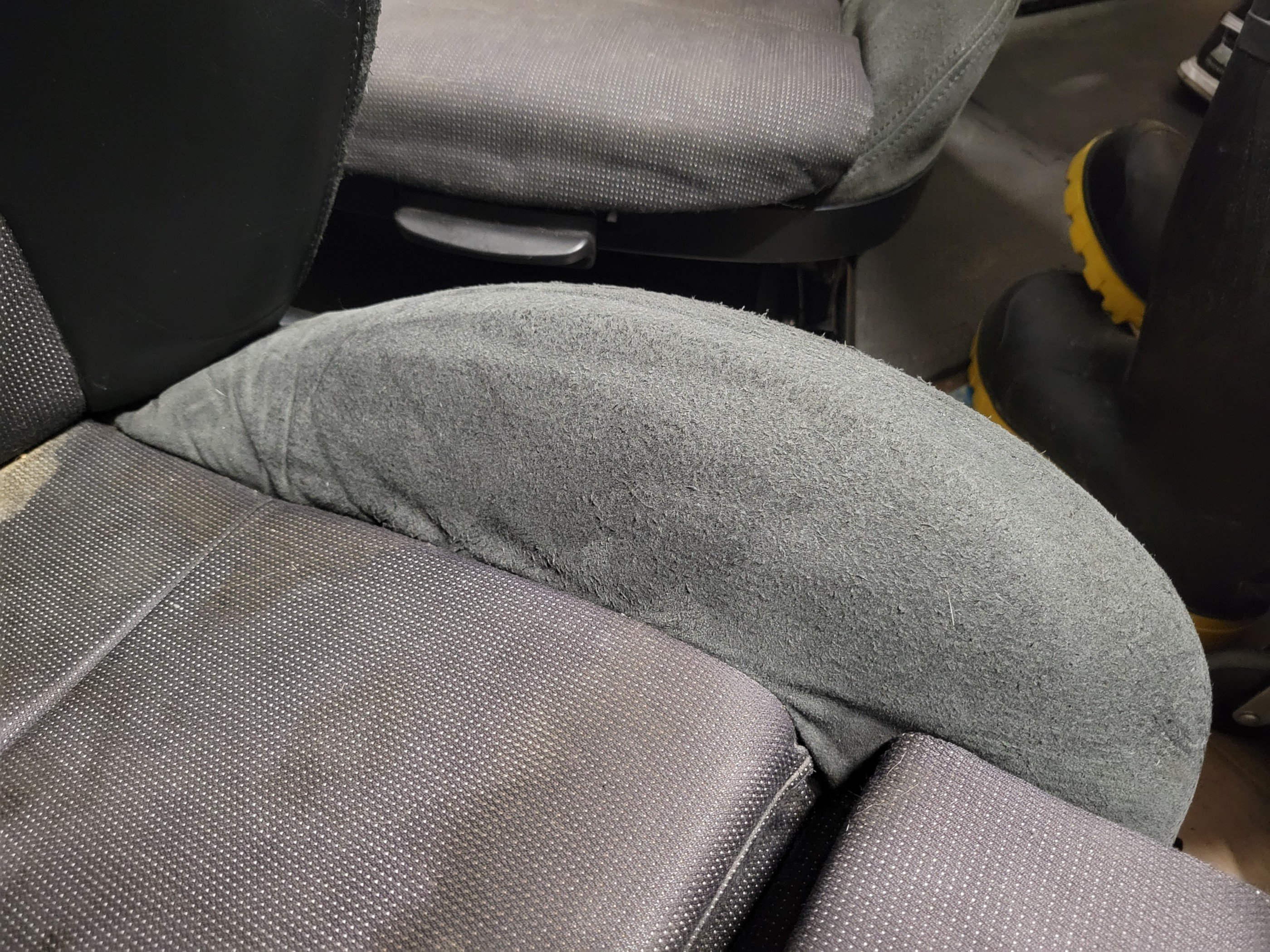

The driver's seat had a rip in it which the wife kindly patched up for me with some spare bit of fabric I had from an old rear seat armrest off the touring. Crude but good enough for a daily. I also did the old lint remover trick on the alcantara.

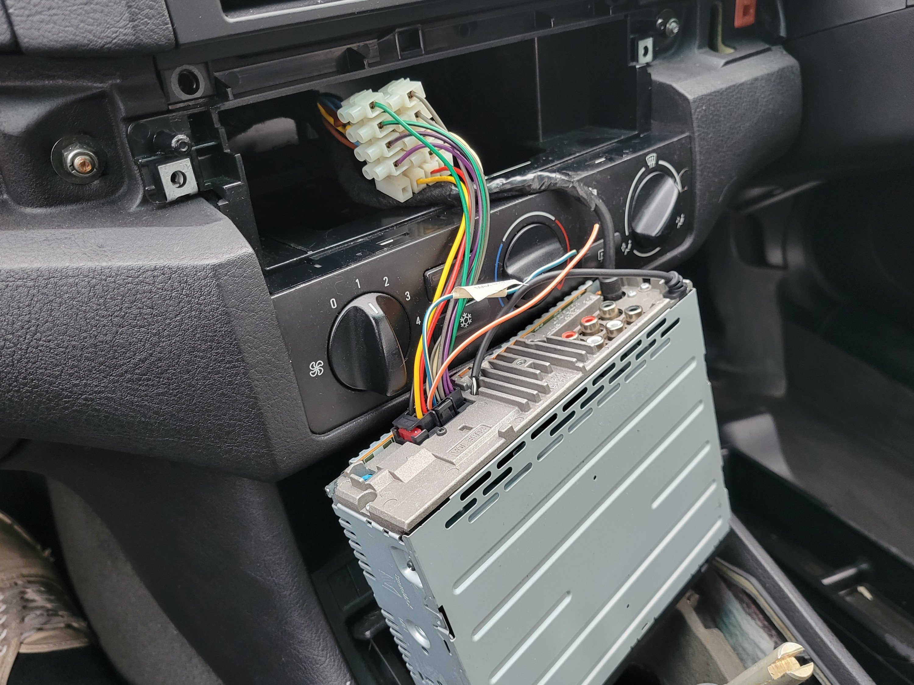

I managed to snag an Android headunit from PaP a while ago, identical unit to what I've got in the Touring so went ahead and installed it in place of a generic single din one someone had crudely "wired" in.

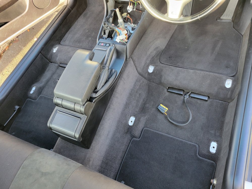

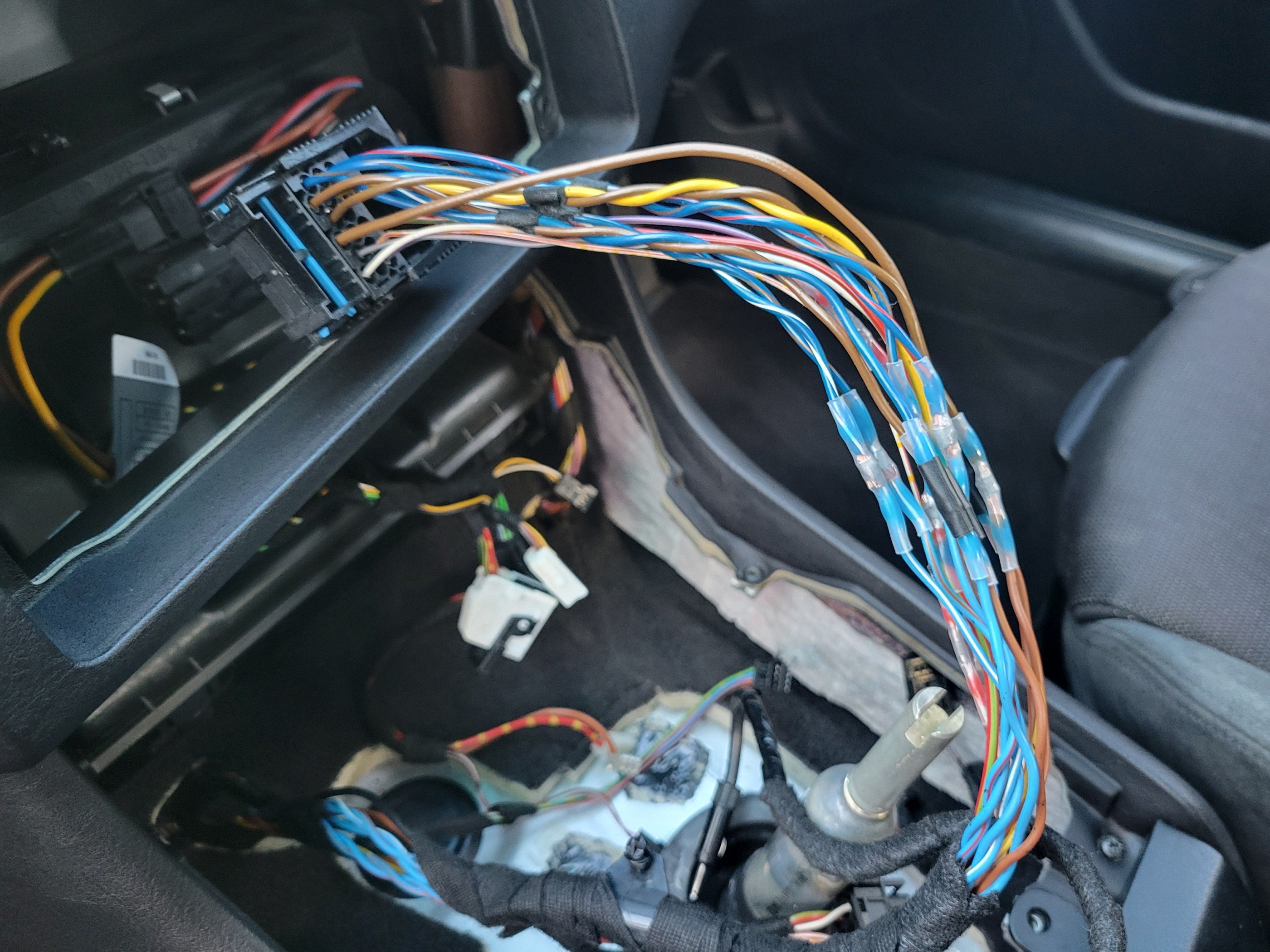

The spare body wiring loom came in handy once again and I reverted the wiring to factory spec. The Android unit comes with adapter wiring and if I ever decide to revert to a factory headunit it'll just be plug & play.

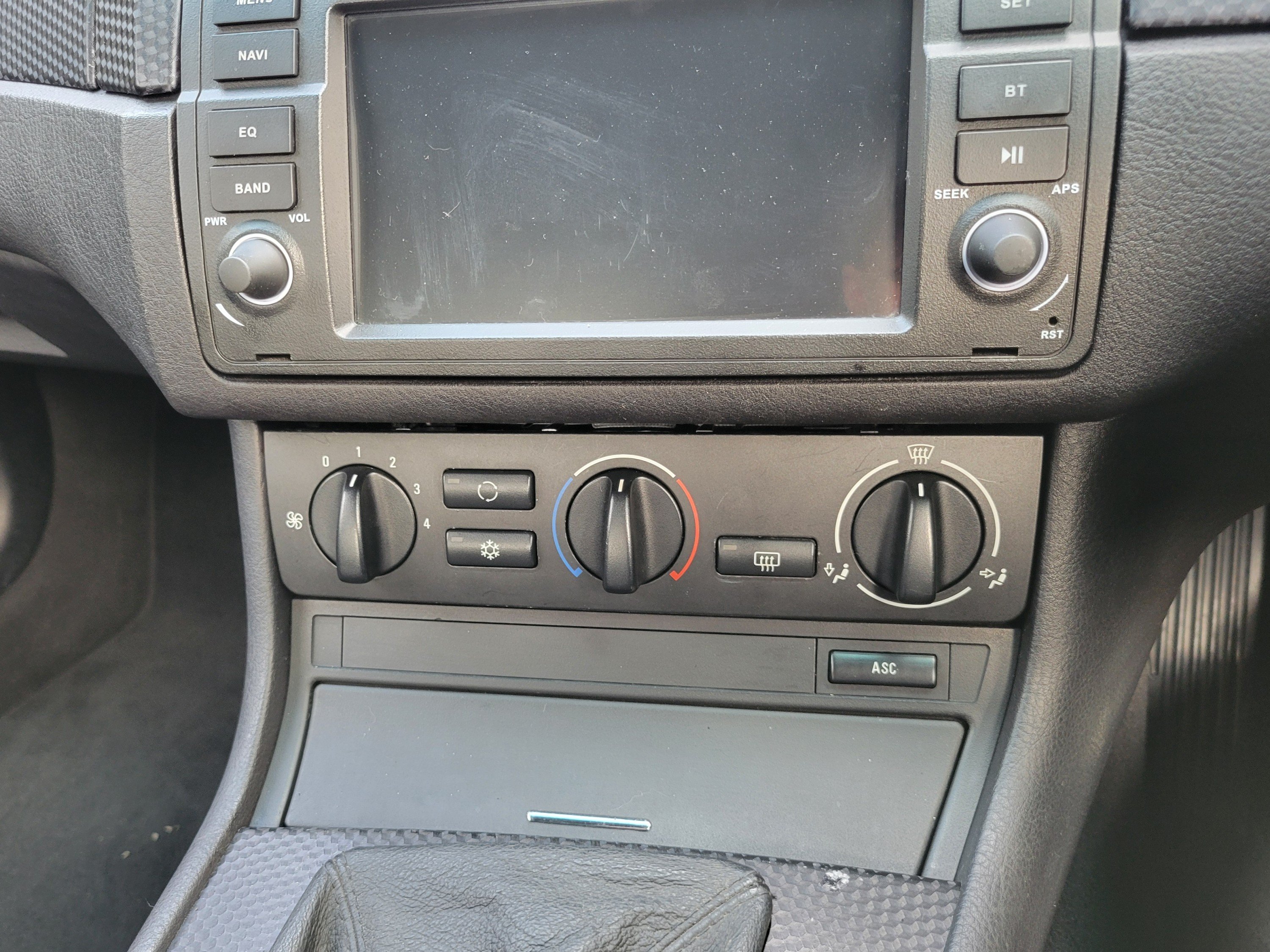

All the centre console trim bits were naturally scratched up so I installed a spare set with an armrest that I had already de-rubberised a while ago. I also managed to get my hands on a fancy genuine HVAC relocation bracket for the touring so I had the old 3D printed HVAC relocation bracket as a spare. Installing that turned out to be a bigger faff than anticipated though. Turns out that the older version HVAC control panel with the physical buttons is much bulkier than the newer one with the buttons and digital display so was far from a straight fit.

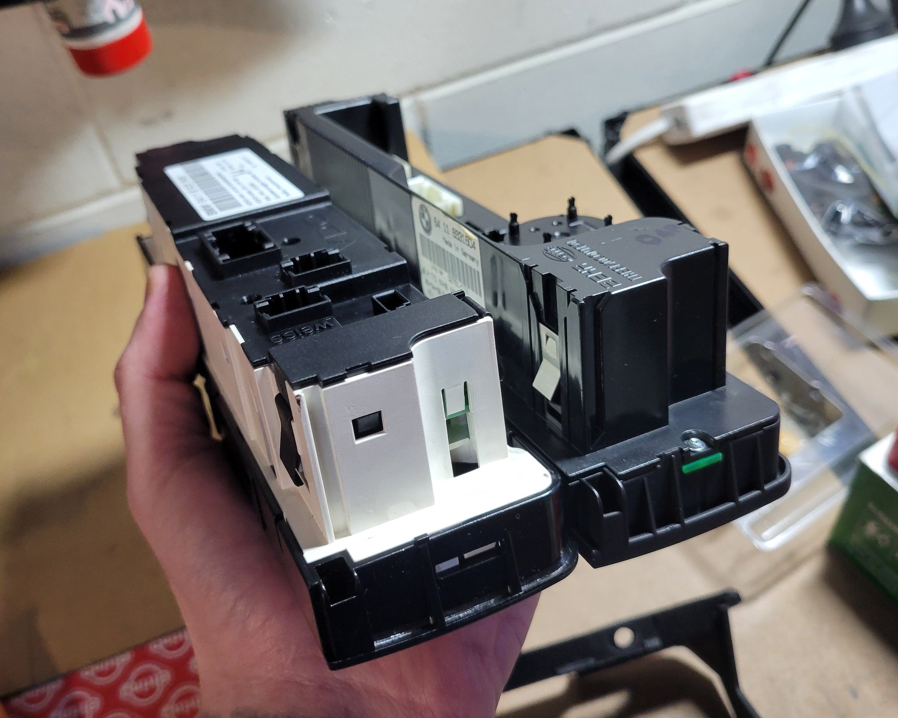

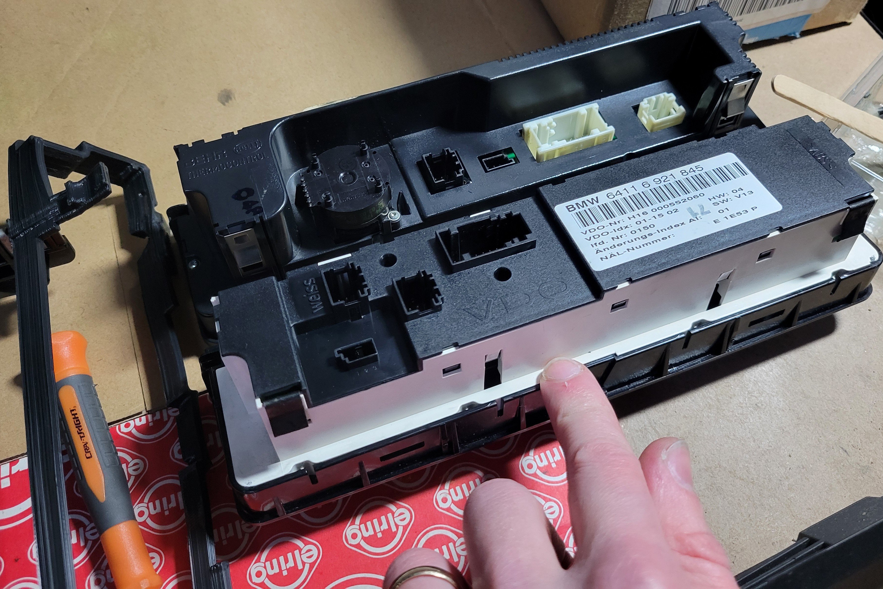

Took quite a bit of dremel-ing and filing to trim the bracket down enough to fit around the HVAC panel, was left quite thing and flimsy in a few places but does the job in holding the panel securely in place in the end.

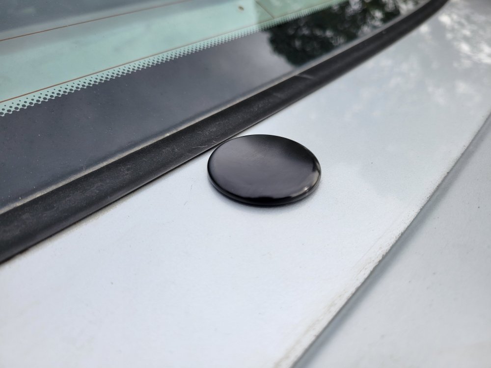

Followed @Harper's lead and deleted the rear wiper to clean up the look a little bit. Went with an Aliexpress special Bevinsee piece. Worked out cheaper than buying a new wiper too... Also got a Bevinsee clutch stop which I've also got on the touring and is an absolute must for all manuals - nice cheap and tidy kit that takes out the silly long pedal travel these came with from factory.
