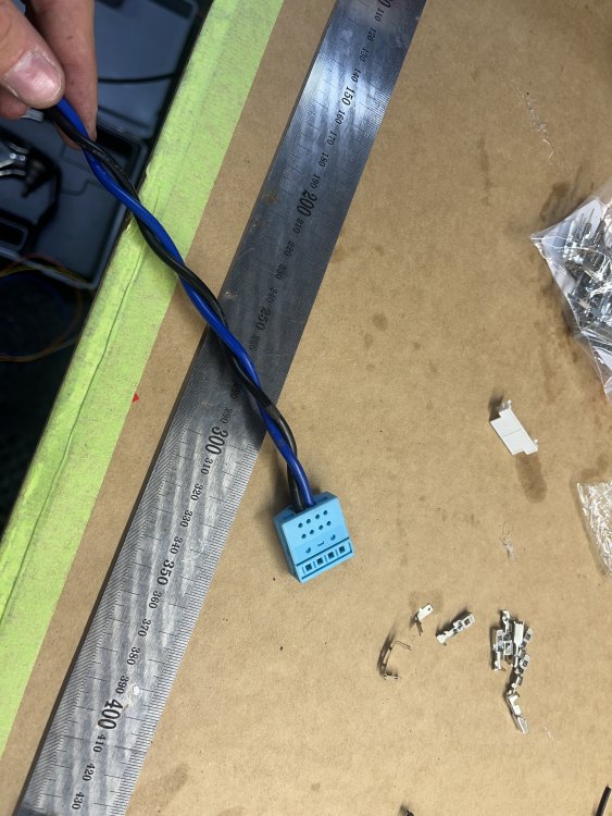

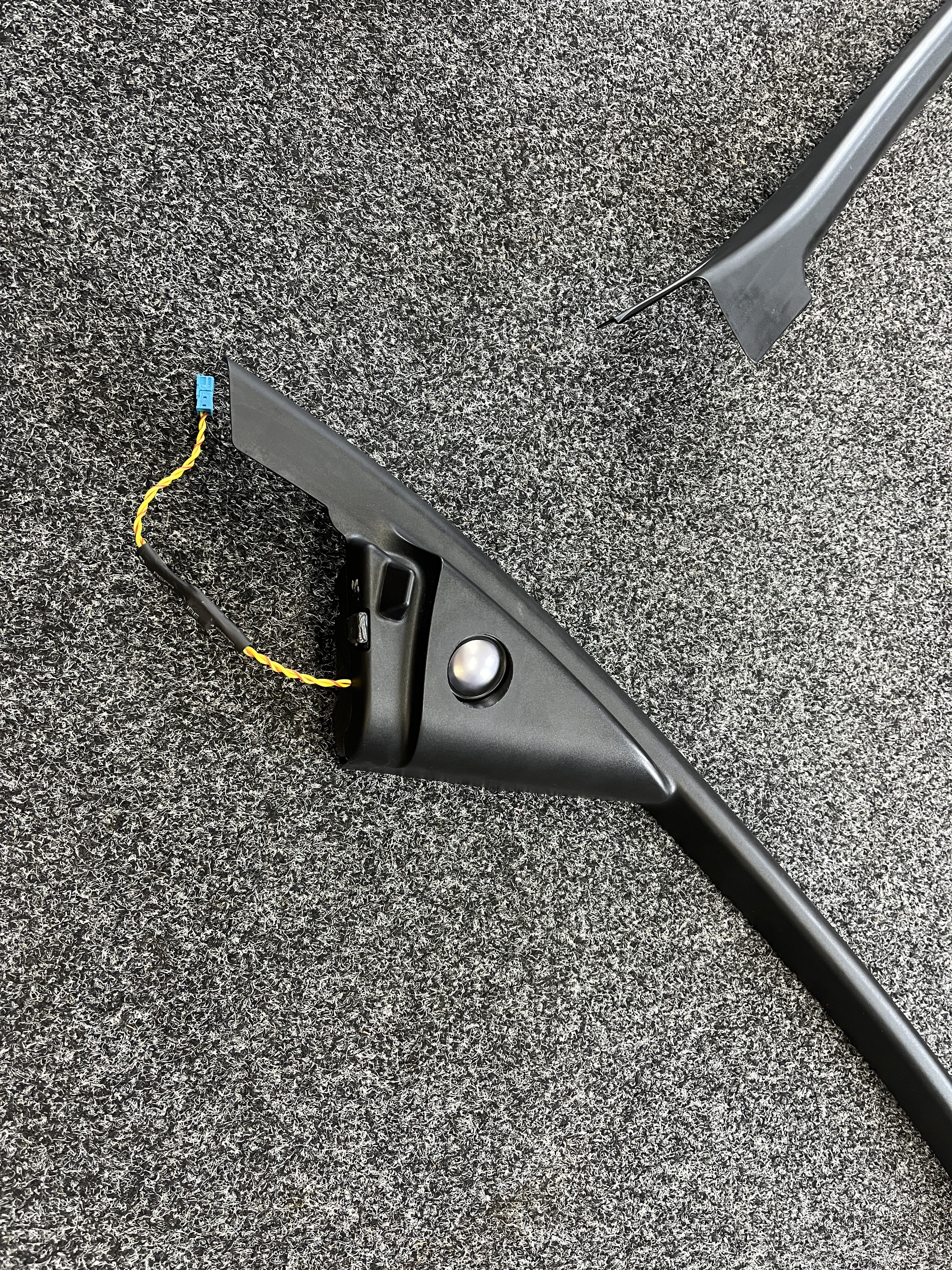

dln 24 Report post Posted March 19 (edited) On 3/7/2025 at 7:45 AM, balinm said: Another important item on the list was sorting out the paddle shifters. Who in their right mind decided that pulling on either would upshift and pushing on either would downshift? I thought the same thing when I first got mine and determined to do the same fix at some stage. But the more I've driven it the more I like it - up or down with either (or a single) hand. Not looking forward to going back to "normal" on a future vehicle now ... Edited March 19 by dln 2 Quote Share this post Link to post Share on other sites

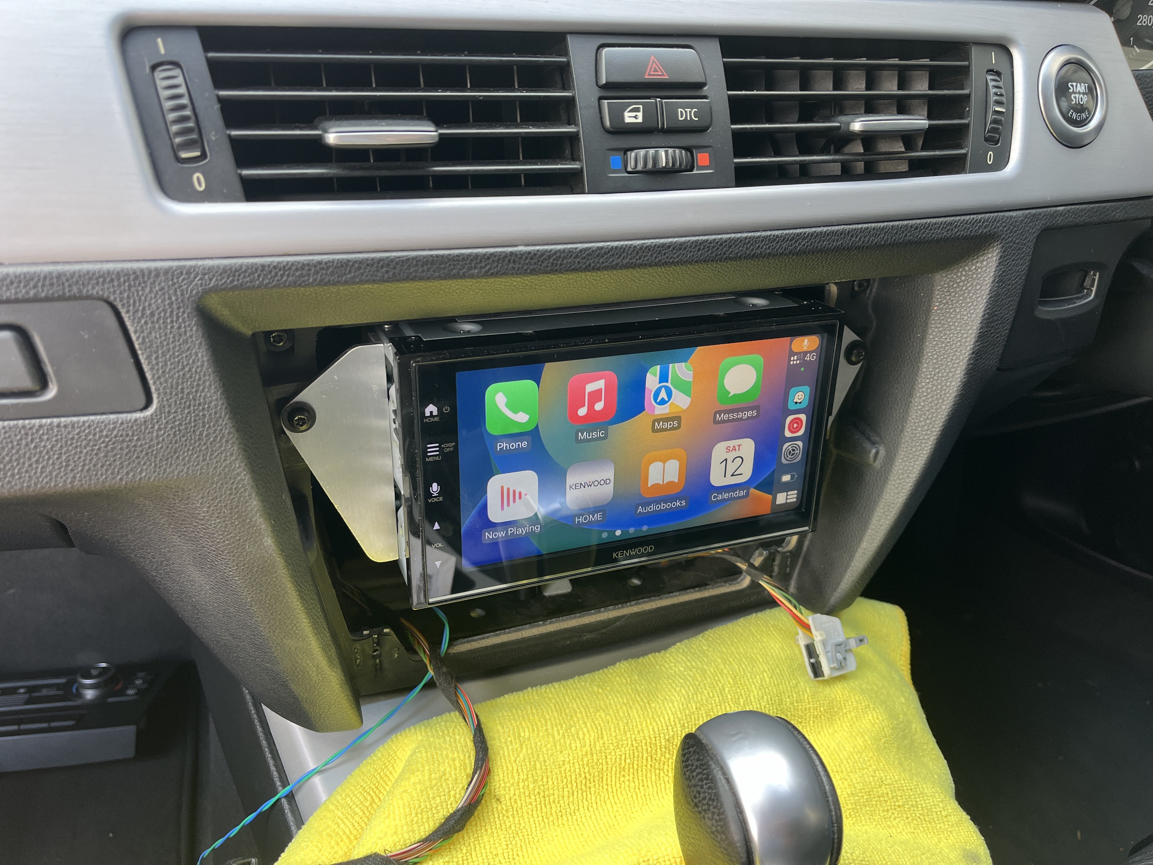

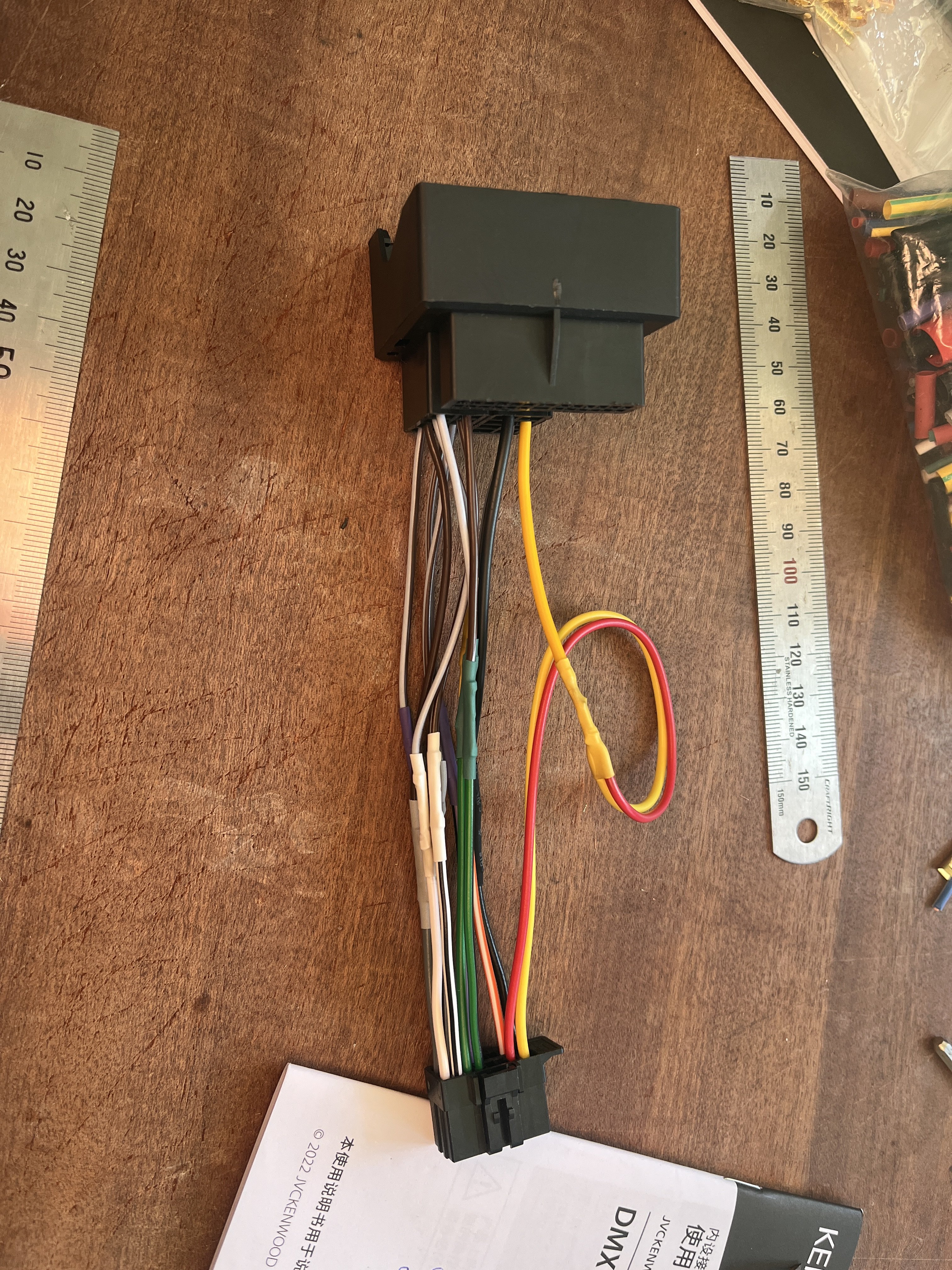

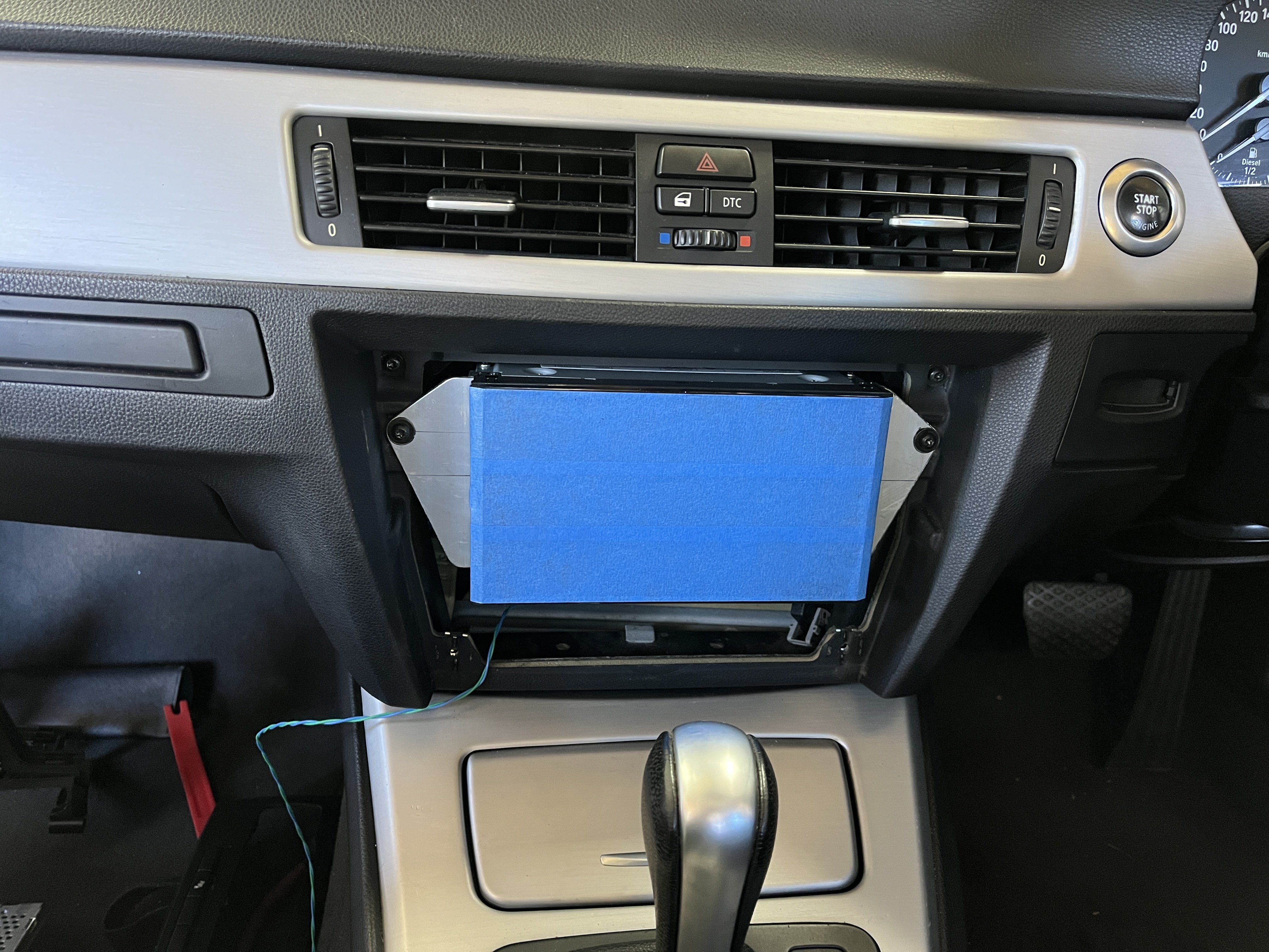

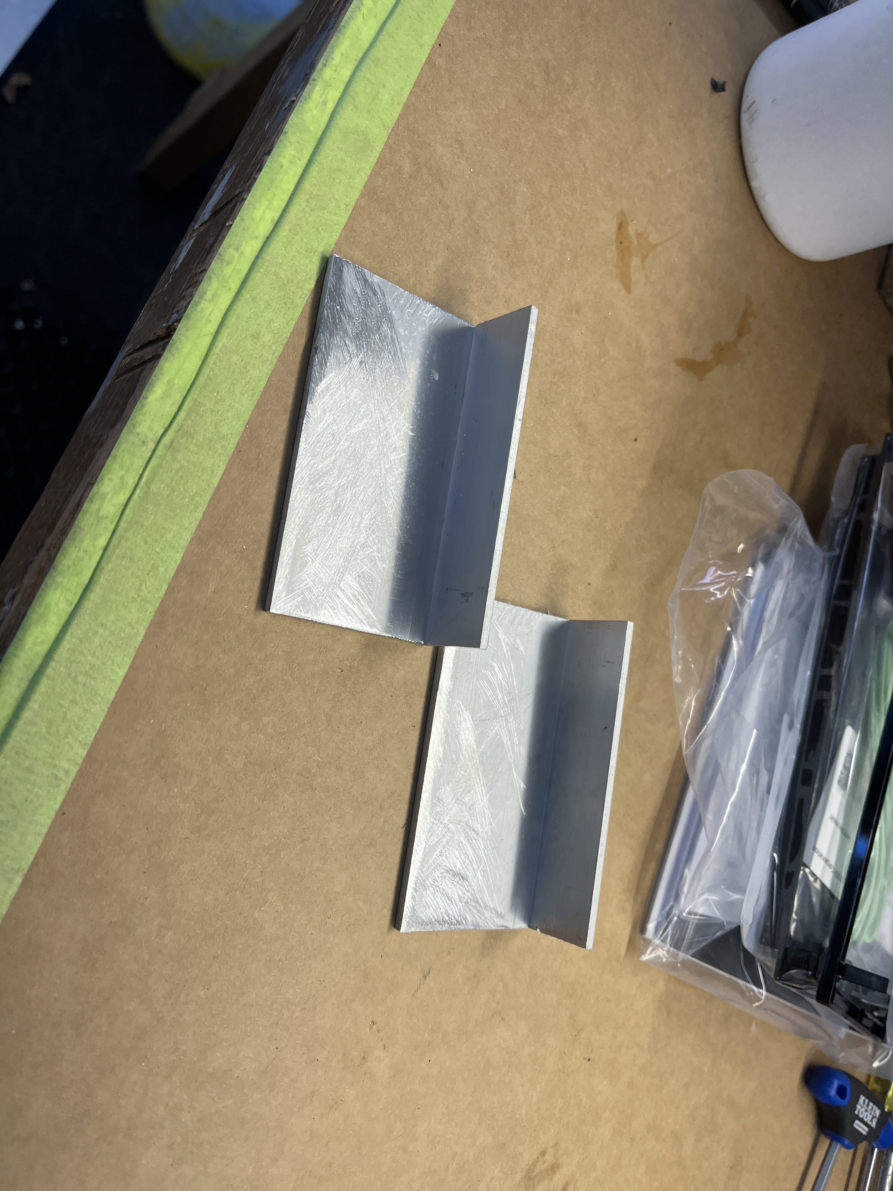

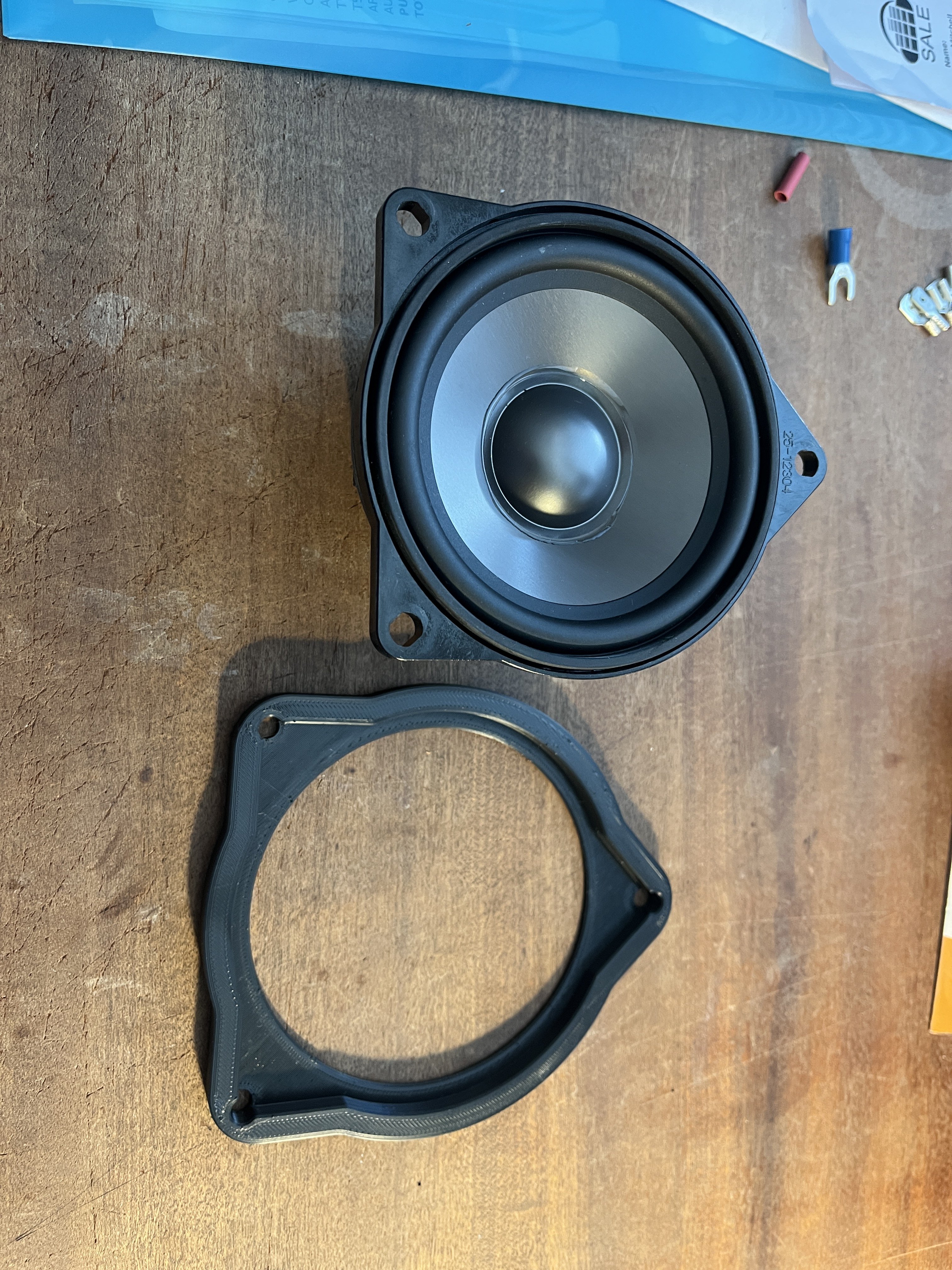

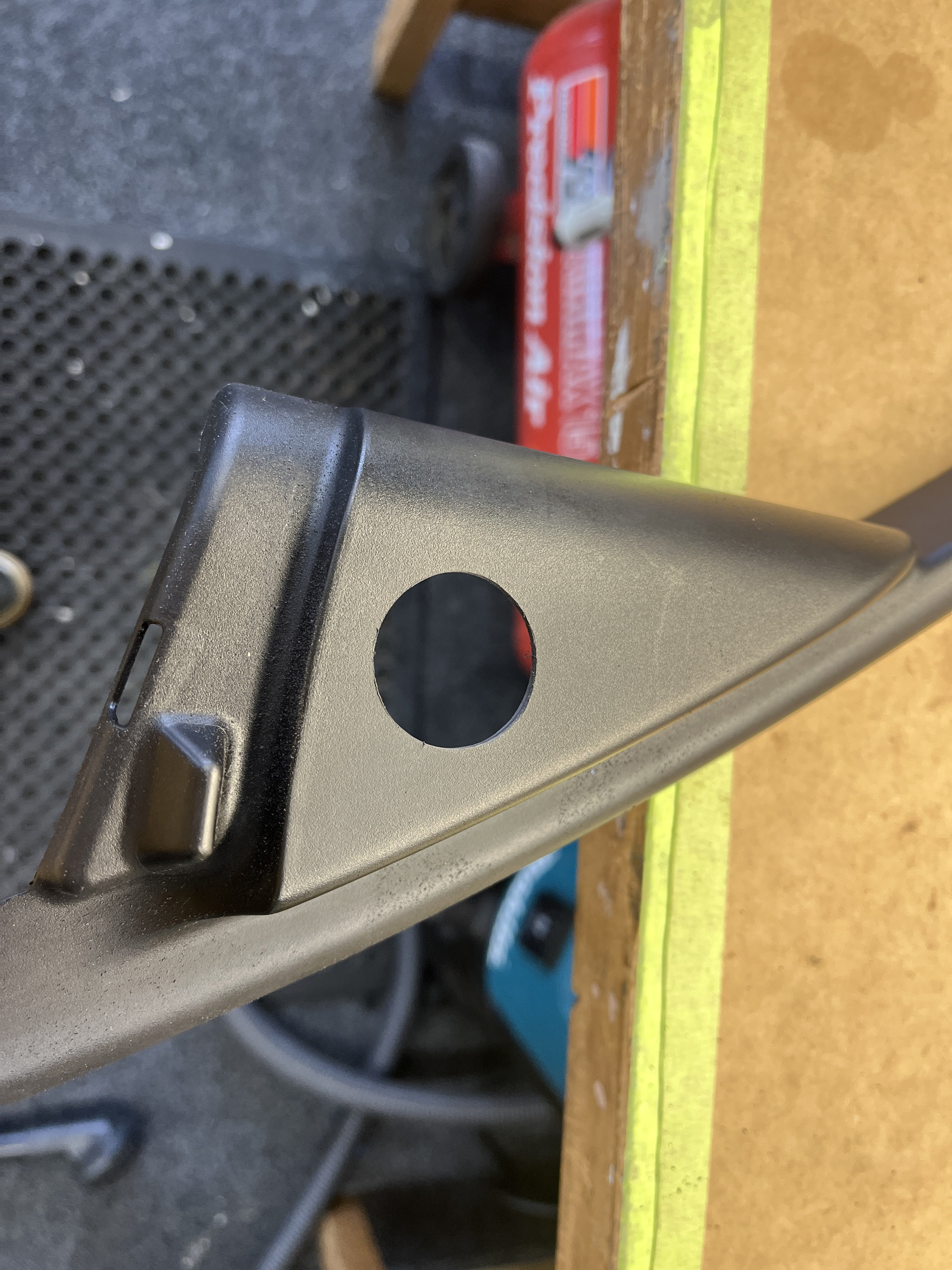

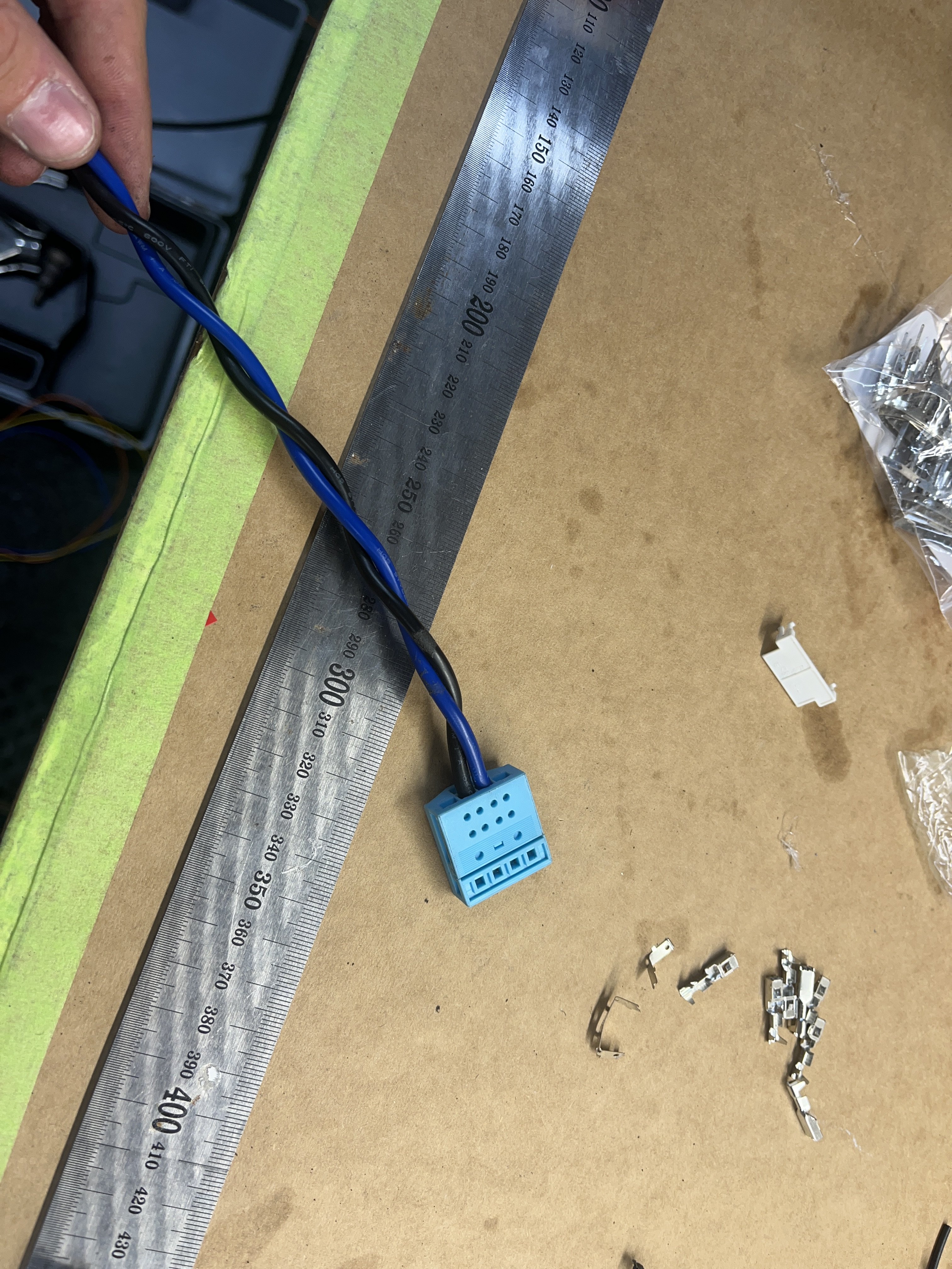

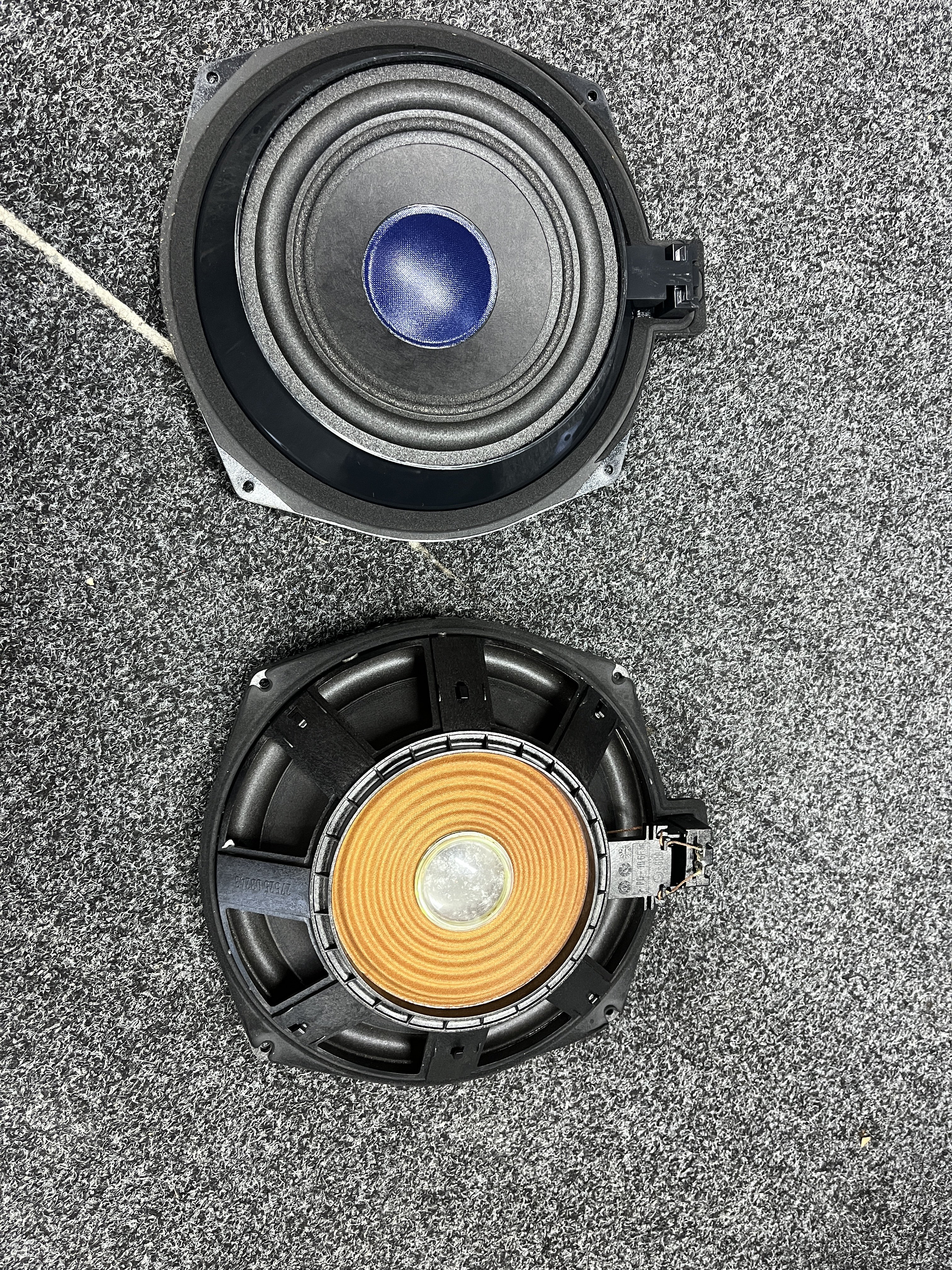

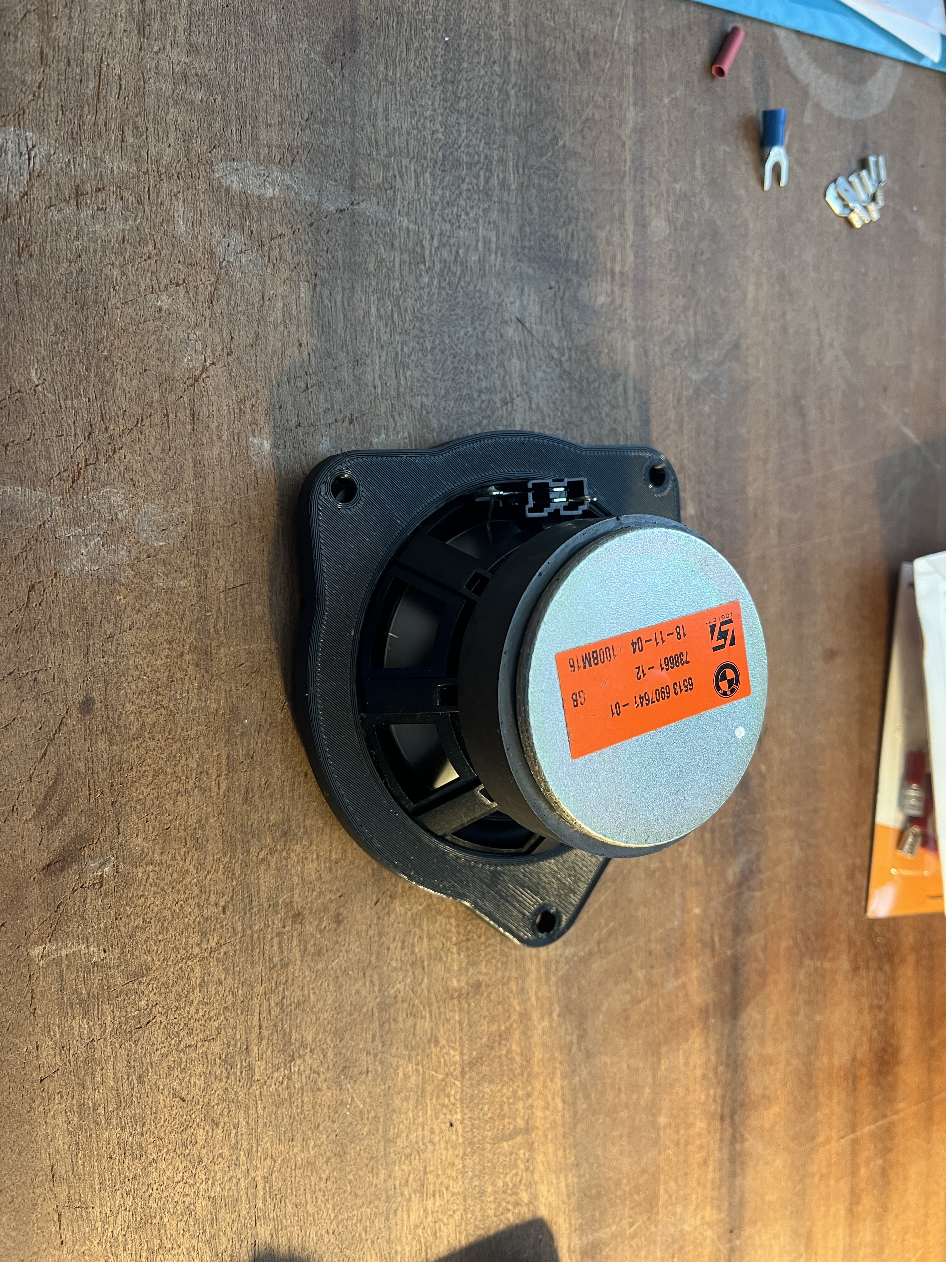

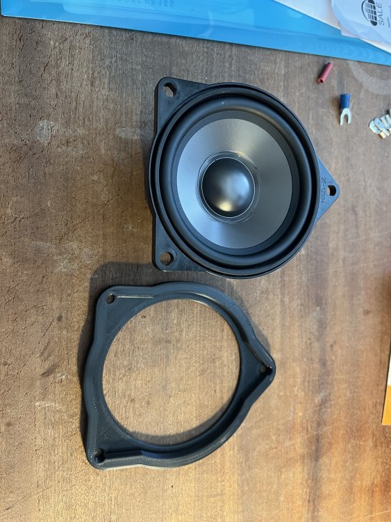

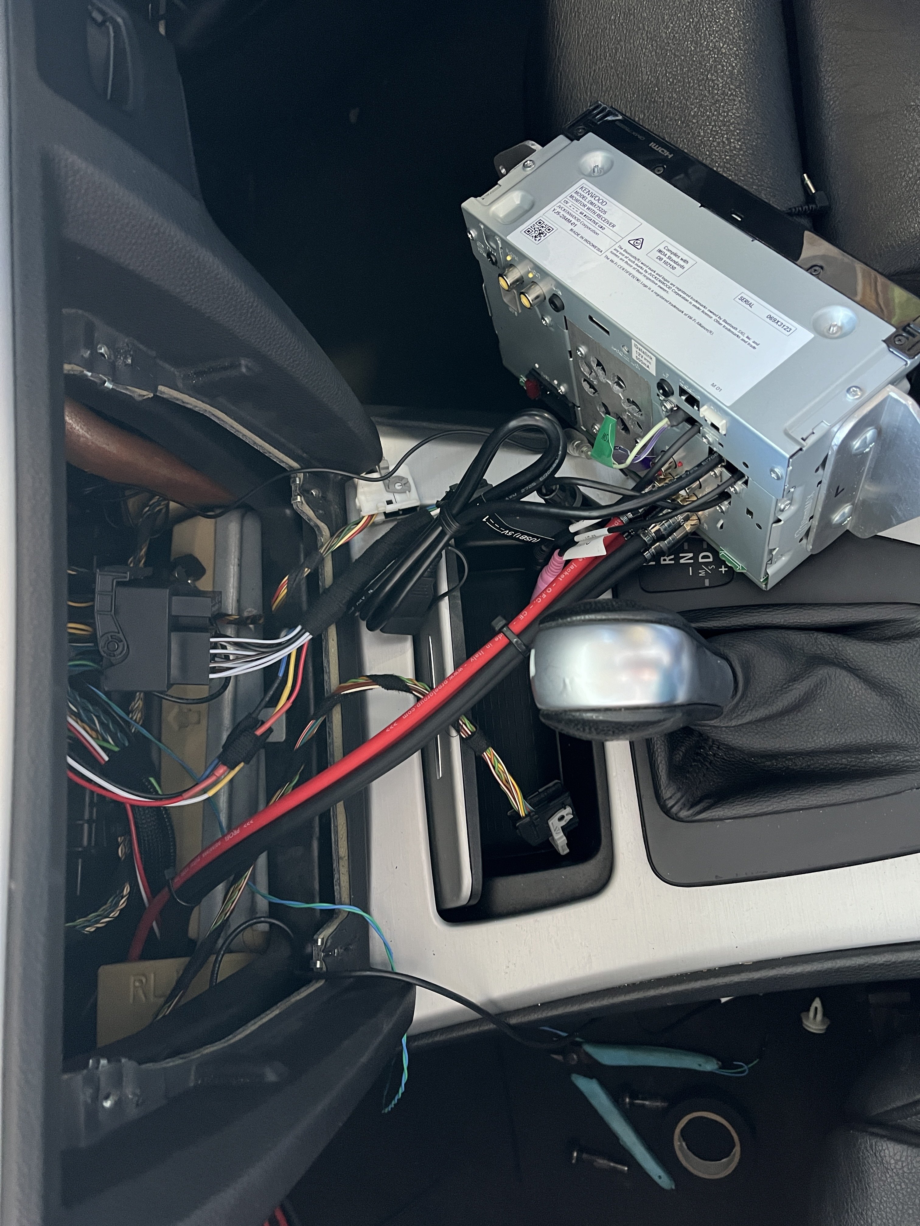

balinm 43 Report post Posted April 28 Time for some decent audio. This is something I've always been big on, maybe not to an audiophile extent, but life is too short to listen to stock car audio. My first car, my ford focus, was when I first got my feet wet with car audio. Just a bluetooth single din head unit, front components and a little active 250W sub in the rear. My last wagon, the white 325i e90, was a touch more in depth. It came with a mechless double din, most likely just for the bluetooth and reversing camera aspect, definitely a japanese addition. The stock e90 base audio is pretty sad, 4" door speakers all the way around with 6.5" woofers under the front seats. the front doors and underseats share a channel which is just a joke really. All 4 door speaker were then replaced with 4" kicker coax units, with the tweeter disabled for the rear doors. Adding a 4 channel Pioneer GM-D8704 amp to split the doors from the underseats helped massively. Between the headunit and amp HP and LP filters I managed to high pass the doors from 250hz and cross the underseats from 80hz to 250hz. Throwing a 10" 400w sub box in the rear then filled in everything under 80hz. Onto the latest wagon, I told myself I was going to hold off on doing audio for a while and learn to deal with the stock tunes, that didn't last long. The biggest hold back was the headunit, to get a wireless carplay double din headunit the entry cost is around $700, seems absurd campared to the $140 I paid for the single din in my focus back in the day. Anyways I bit the bullet and bought a Kenwood DMX7522S, the cheapest wireless carplay headunit on the market with active crossovers. Step one was mounting, some 3mm C channel kicking around in the back of Dad's garage got chopped up into right angle and shaped to make some brackets to fit it into the stock position. Step two was to wire it in, with this one I wanted to make an effort not to butcher the stock wiring, instead opting to make an adapter harness. An aliexpress fakra quadlock extension loom was butchered to join up to the kenwood harness. Temporarily the constant 12v and accessory power were connected to the terminal 15 pin in the quadlock harness, which means that the headunit has no memory and has to be switched off manually as terminal 15 takes 30 minutes to time out. This is fixed later on. And for carplay to function the gps must be plugged in, the centre dash speaker location is ideal for this. I printed a piece to bolt in where the speaker goes and stuck the gps onto that. And we have liftoff! This concludes step one of the process for the car audio upgrade. This has already taken some time to write up. I will carry on in my next post with: mounting amps, running new wires to all the speakers, powering the amps, making new rcas, replacing the doors speakers and underseats and adding tweeters. 3 Quote Share this post Link to post Share on other sites

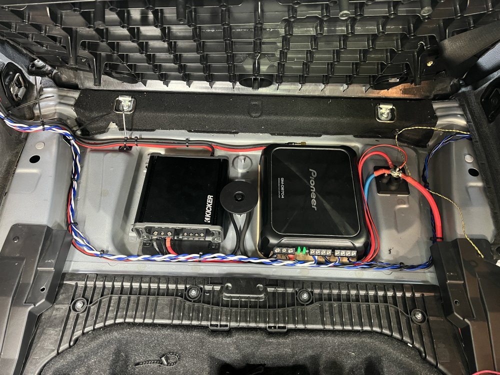

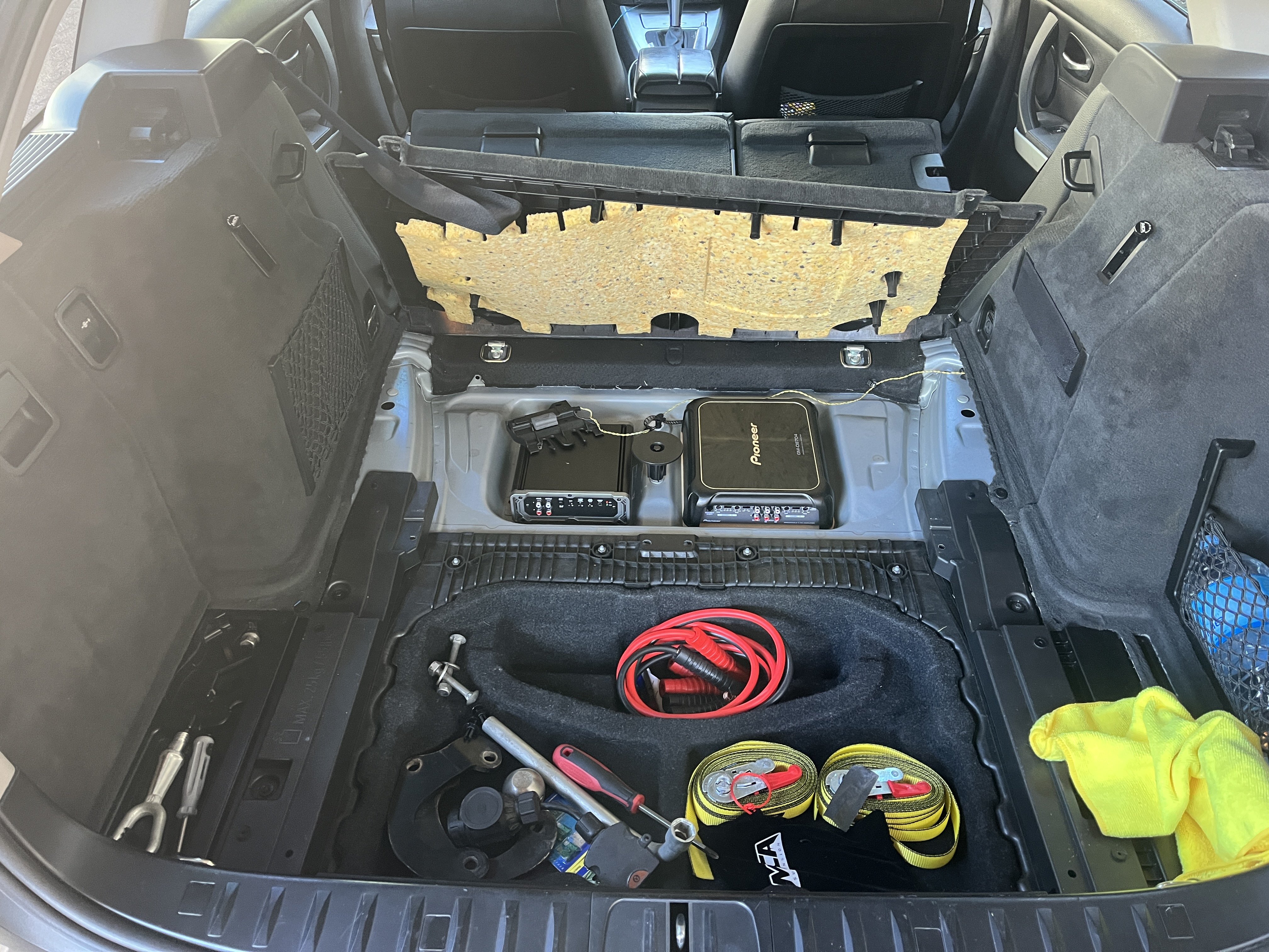

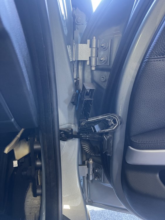

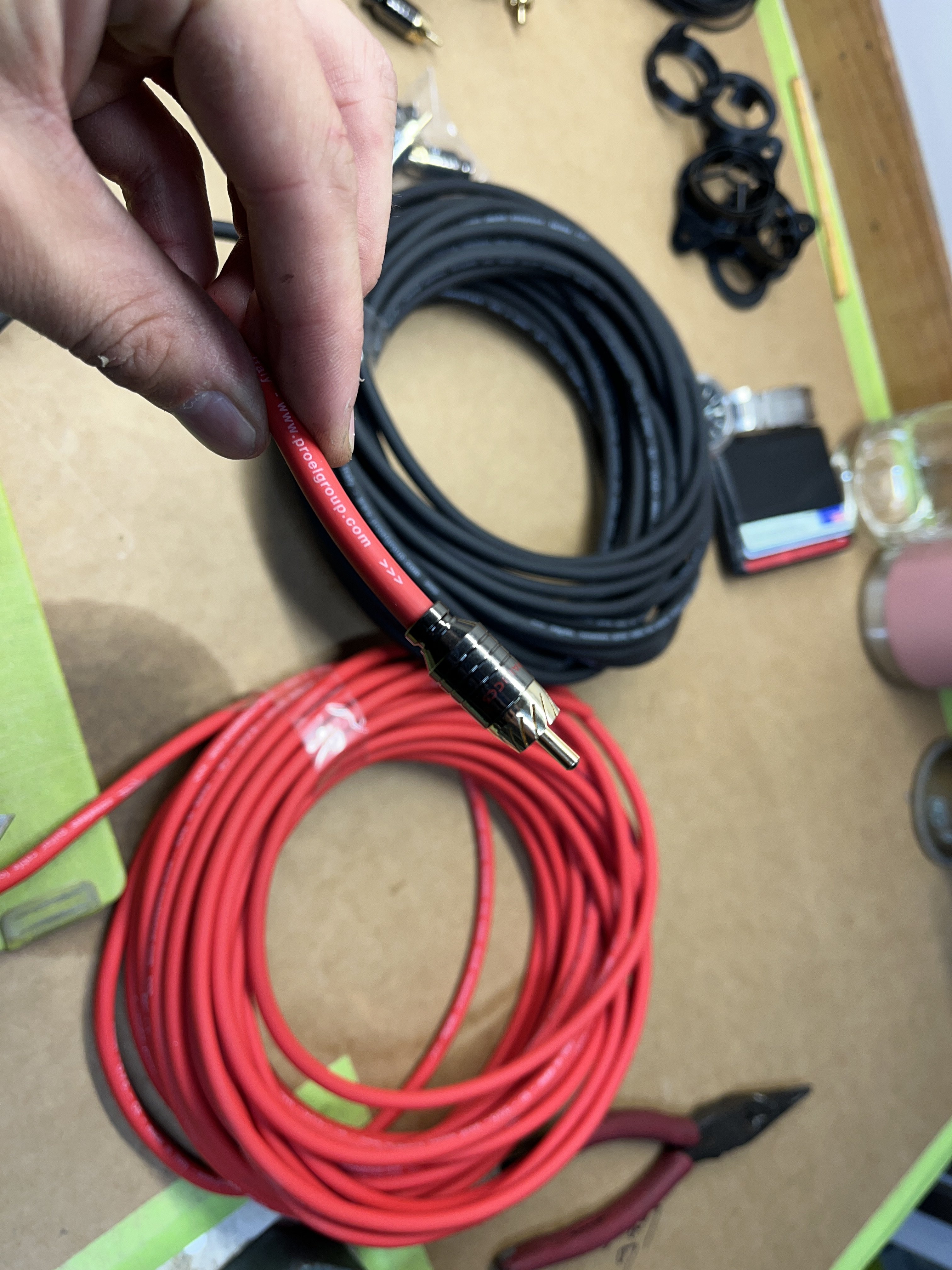

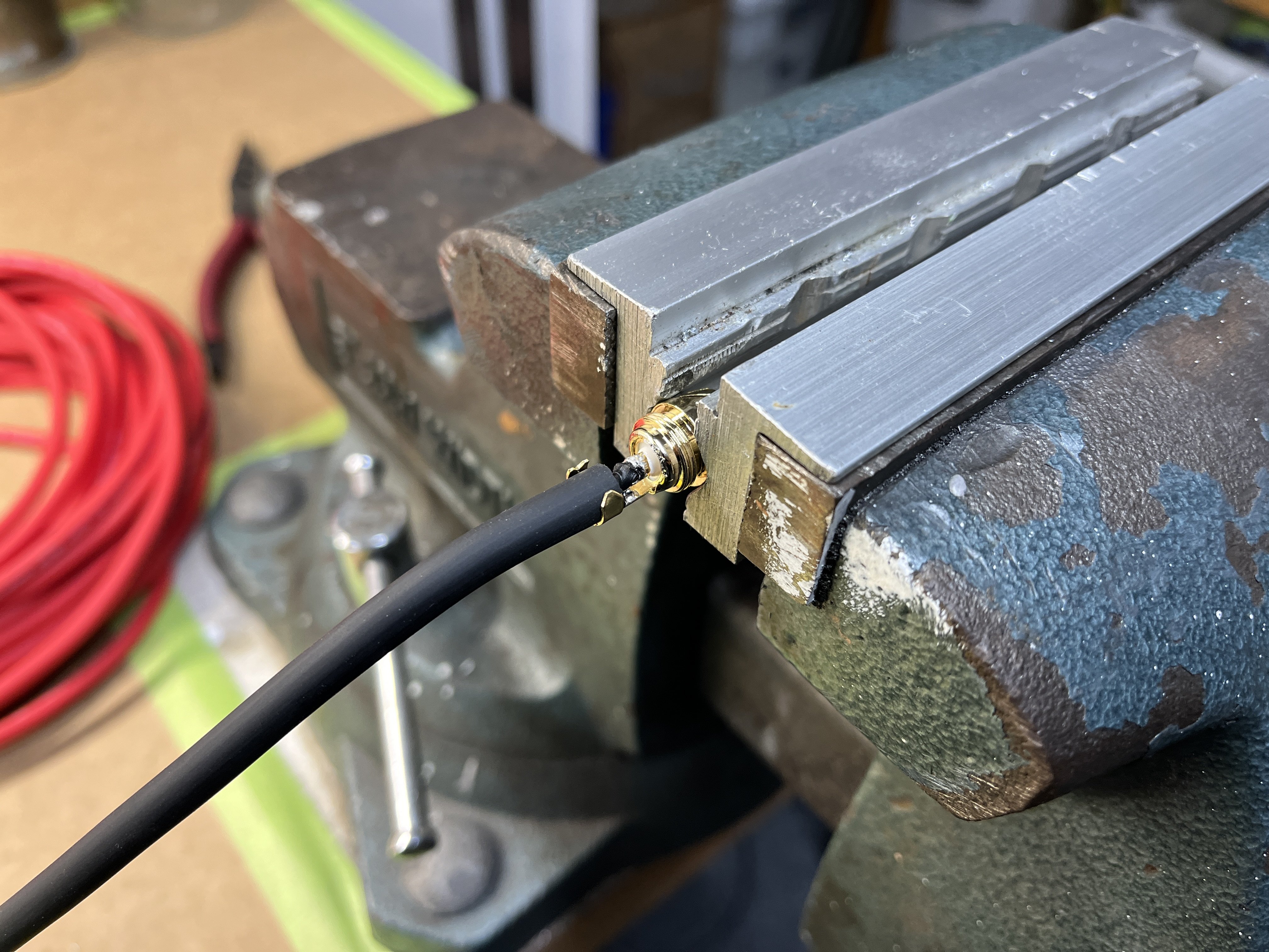

balinm 43 Report post Posted May 28 Probably about time for a part two on the audio upgrades. The E91 isn't the largest chassis around, so options for mounting amps are few and far between, however I discovered enough room in the boot under the second hatch. Looks to be just enough space for two amps with easy wire access up to go up and over the strut towers going forward as well as a channel to run power from the battery. The only little annoyance is one of the comfort access antenna is mounted in here so will have to come up with a solution to remount that. Main power for the amps is 4 AWG and comes off one of the power studs in the battery compartment and goes through a 100amp fuse to the power stud I mounted in this new space. The 4 channel amp uses 6 AWG and the sub amp uses 4 AWG. Behind the black plastic support brace is an M8 stud built into the car, perfect for grounding, paint removed and all! There are two things still to do here, the continuous power for the headunit comes from this power stud and runs all the way up the car, I want to change this so it is running from the fuse box but I have yet to figure out the terminals etc to do so. I also need to fuse each amp individually. I made some RCA cables out of some Proel instrument cable and some metal rcas I found on Ali, much nicer being able to make these custom length instead of being stuck to generic lengths. The 4 channel amp shares a set of RCAs and the sub amp gets its own RCAs. Back to doing things properly and not butchering stock wiring, the speaker wires were definitely more involved than I would normally have opted for. For the front door speakers I used 18 AWG and made my own twisted pair with a vice and a drill. They go from the amp to the door connector where they use two empty pin slots, they then carry on up to the speaker. This means I can completely revert back to the stock setup in future, not that I would ever want to but nice to have the flexibility. As for the underseats I used some 12 AWG wire, this is well and truly overkill but its a match of the stock wire. Time for some speaker upgrades. I found a set of HK doors, tweeters and underseats on facebook from a 7 series for $200. While these are pretty old in 2025 they will still be much better than stock and it allows me to add tweeters. The underseat install is straightforward, seatbolts out, lean seat back, remove grill, remove speaker and reverse to put everything back in. Something which was a total surprise to me is that the stock underseat is actually a 6.5" not an 8". This alone would make a decent difference. The doors has slightly more going on, unfortunately the bolt pattern didn't line up, not sure why. I printed some adapter brackets to sort this out. The tweeters had a bit more going on again. I popped the tweeters out of their original housings and printed a housing instead. It was then just a matter of cutting a hole in the sail panel, gluing the housing in place with the tweeter and cutting the foam sound insulation behind it to fit. These plug straight into the back of the door speakers with an inline cap for passive filtering, as some point I would like to build some passive crossovers for the front doors to do a better job of crossing the door and tweet. I'll also print some grills to go over these as I don't want any fingers ending up in there. Now all that needs to happen is some tuning! 1 Quote Share this post Link to post Share on other sites
elias 460 Report post Posted May 28 Excellent stuff, be interested to hear what it sounds like once you’re finished. Might need to get you to give me a hand with the audio/headunit situation on my e30, previous ownr made a right mess of the wiring, and I don’t know the first thing about car audio 1 Quote Share this post Link to post Share on other sites
balinm 43 Report post Posted May 28 12 hours ago, elias said: Excellent stuff, be interested to hear what it sounds like once you’re finished. Might need to get you to give me a hand with the audio/headunit situation on my e30, previous ownr made a right mess of the wiring, and I don’t know the first thing about car audio Thanks mate! For sure, would be happy to help with the E30. 1 Quote Share this post Link to post Share on other sites

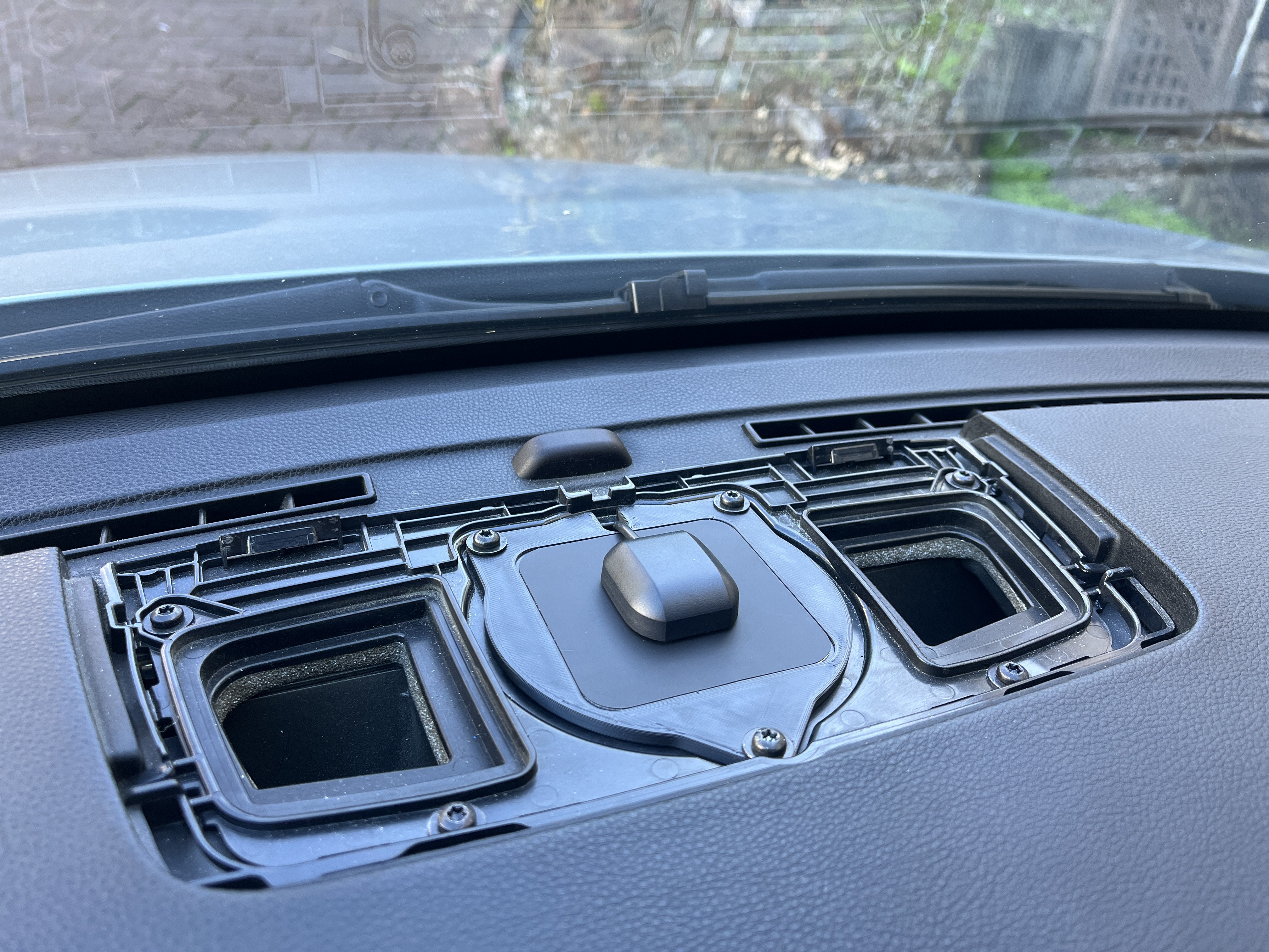

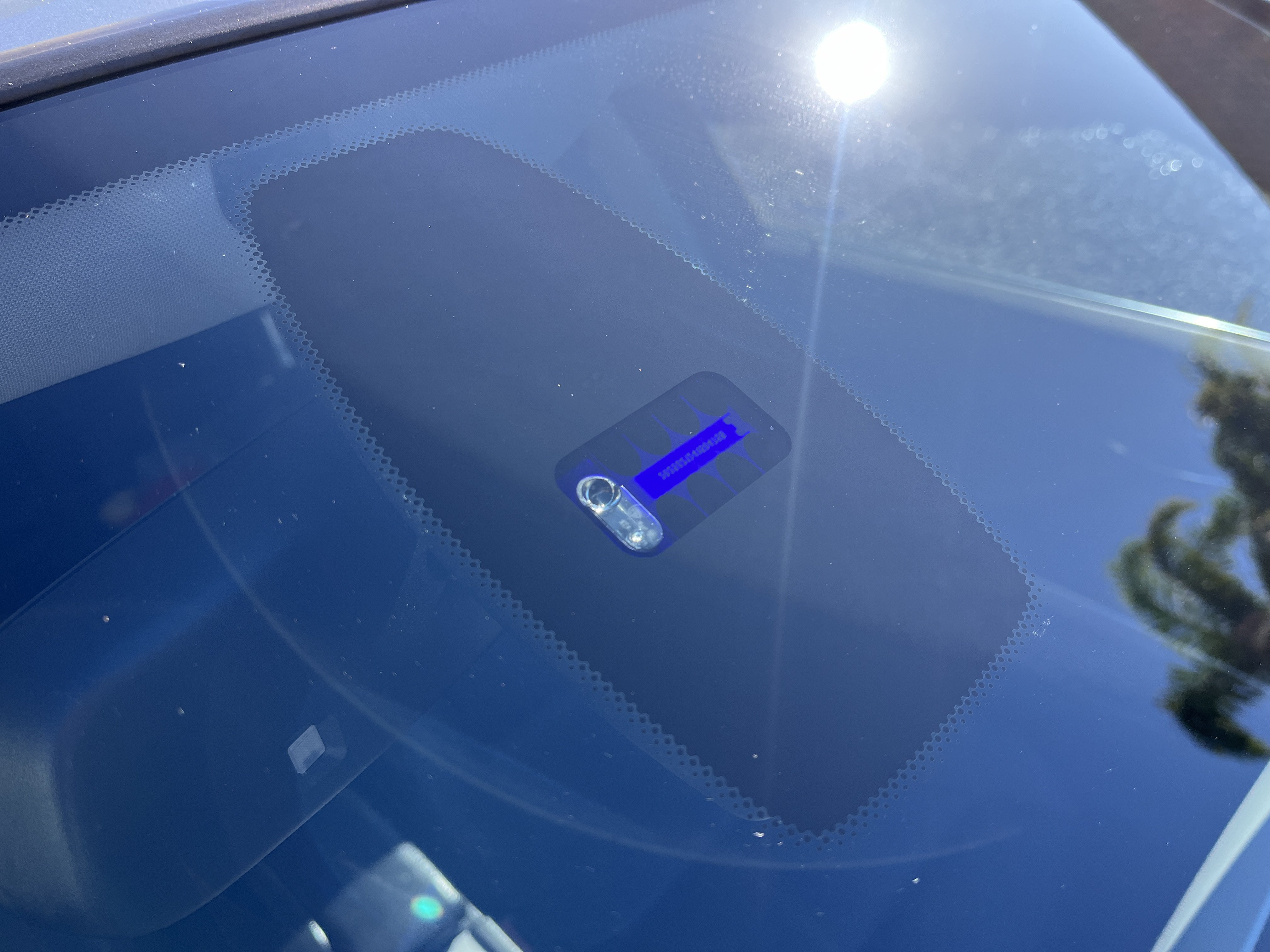

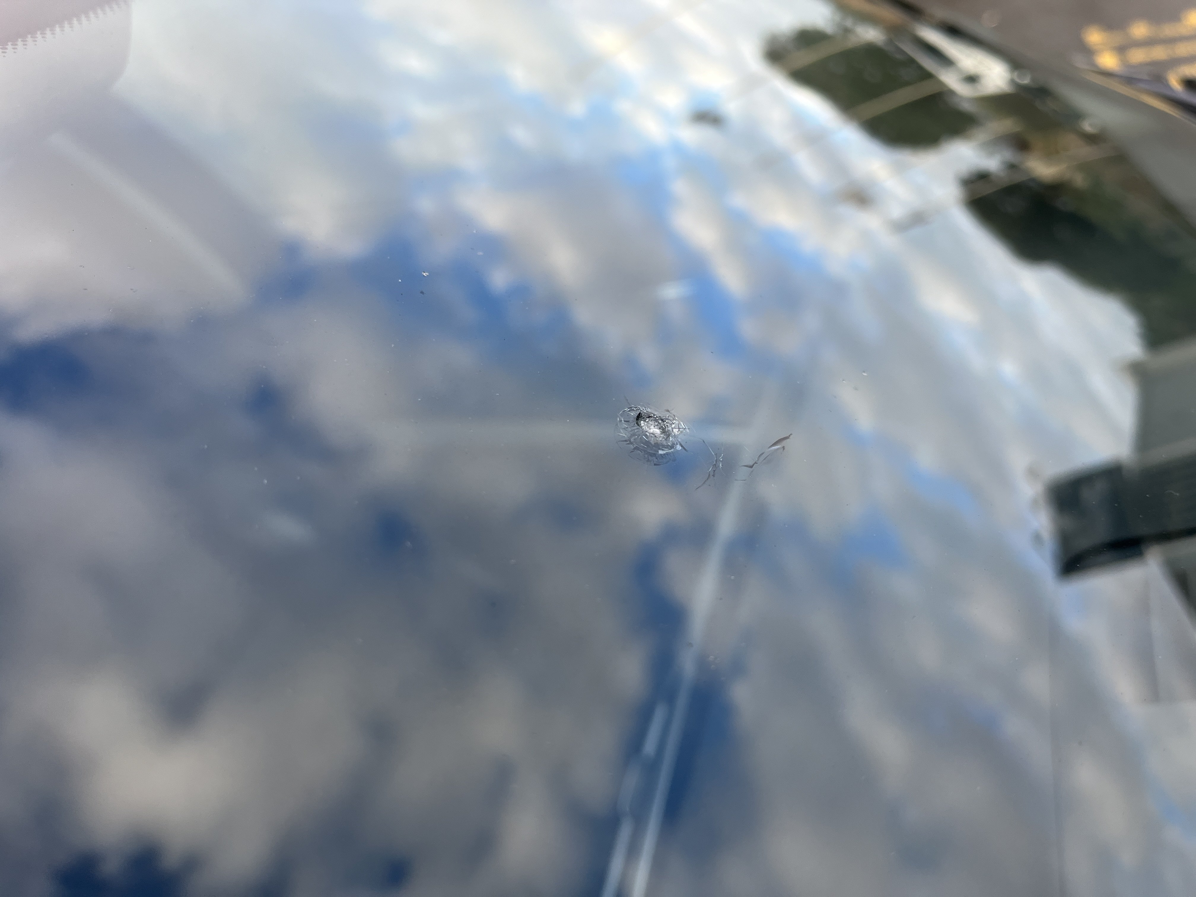

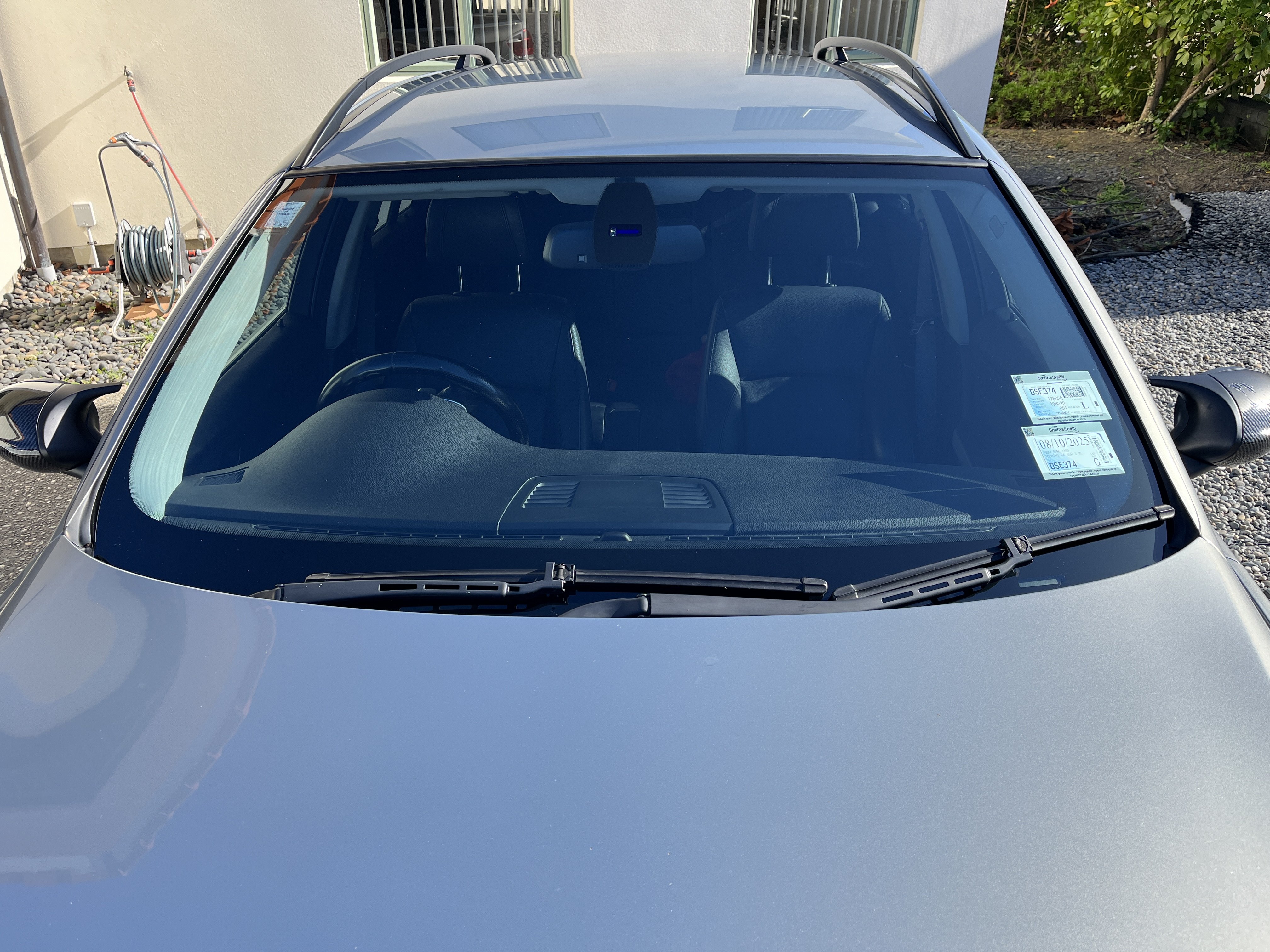

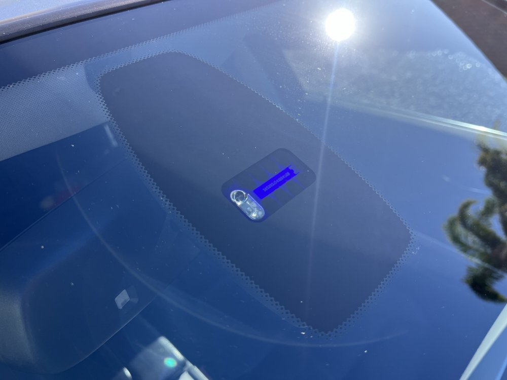

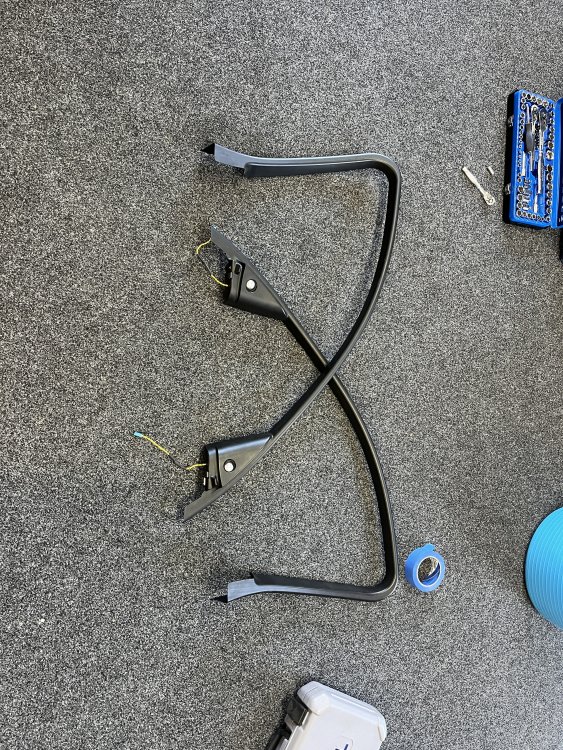

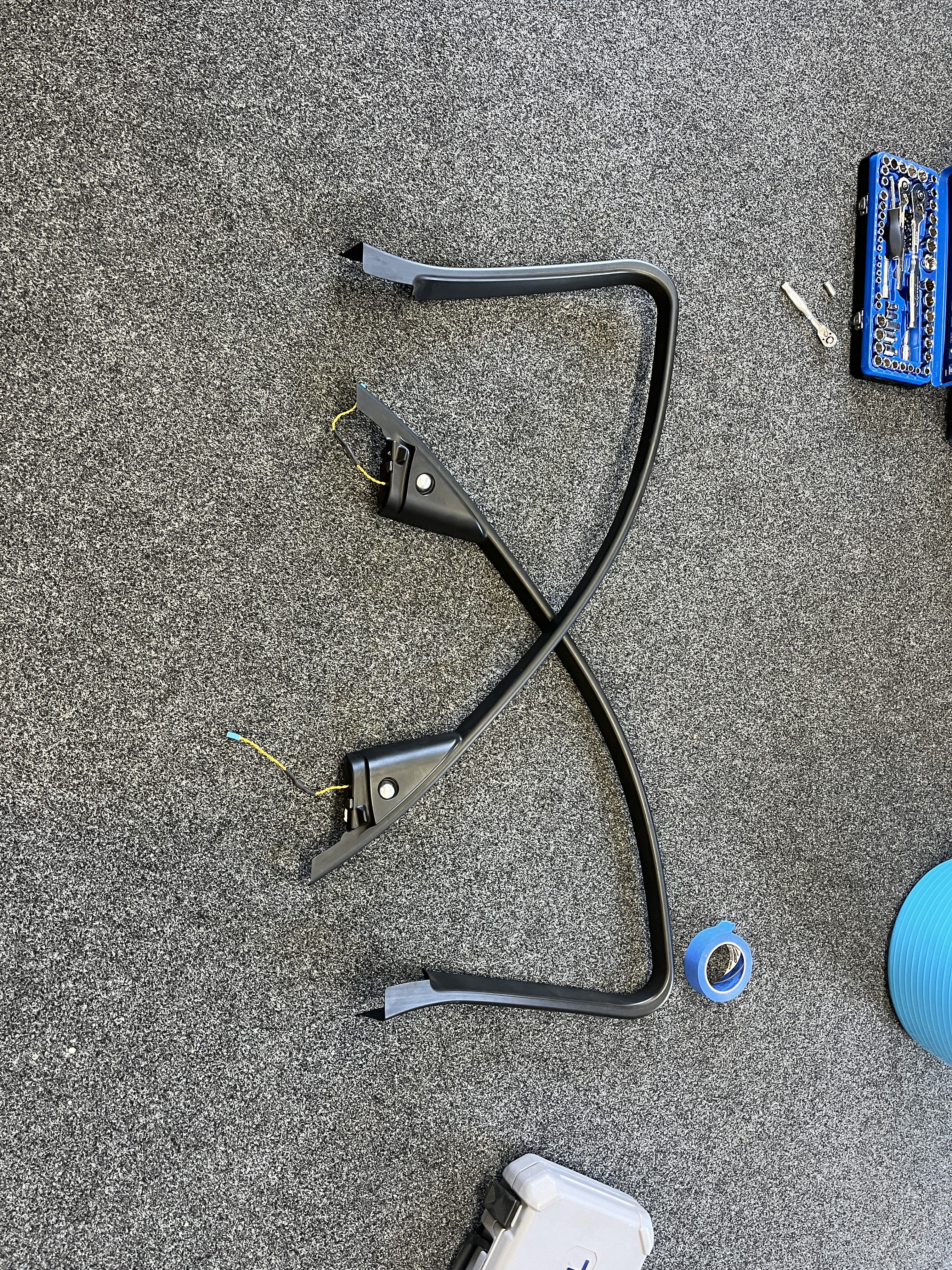

balinm 43 Report post Posted June 4 Time for a fresh windscreen. The old screen was covered in little rockchips from living up a gravel driveway and was probably still the original screen. The sensors also didn't work very well - both rain detection and auto lights, the lense was pretty cloudy after many years of UV. A decent rock hit the screen a couple of weeks ago on the way to work, conviently large enough for a replacement screen through insurance. I ended up going through Smith and Smith Mt Wellington as they were nice and close to work. Overall they did a great job, trims seated nicely with nothing scratched, 10/10 would recommend. I was initially leaning towards trying to get it replaced with OEM because that would always be nicer but after some research it looks like it is pretty difficult to get done. Of course paying the difference is always an option but when an E91 screen is ~$1400 I don't think so. I ended up not sweating it and they replaced with an 'equivelant' brand. I've got no issues with the product so far, apart from the sun strip at the top missing. I figured if it was an average install and the glass was subpar I could have whinged enough to get an OEM replacement. What a difference a fresh screen makes! To anyone with a chipped up old screen it is well worth the effort. 4 Quote Share this post Link to post Share on other sites
