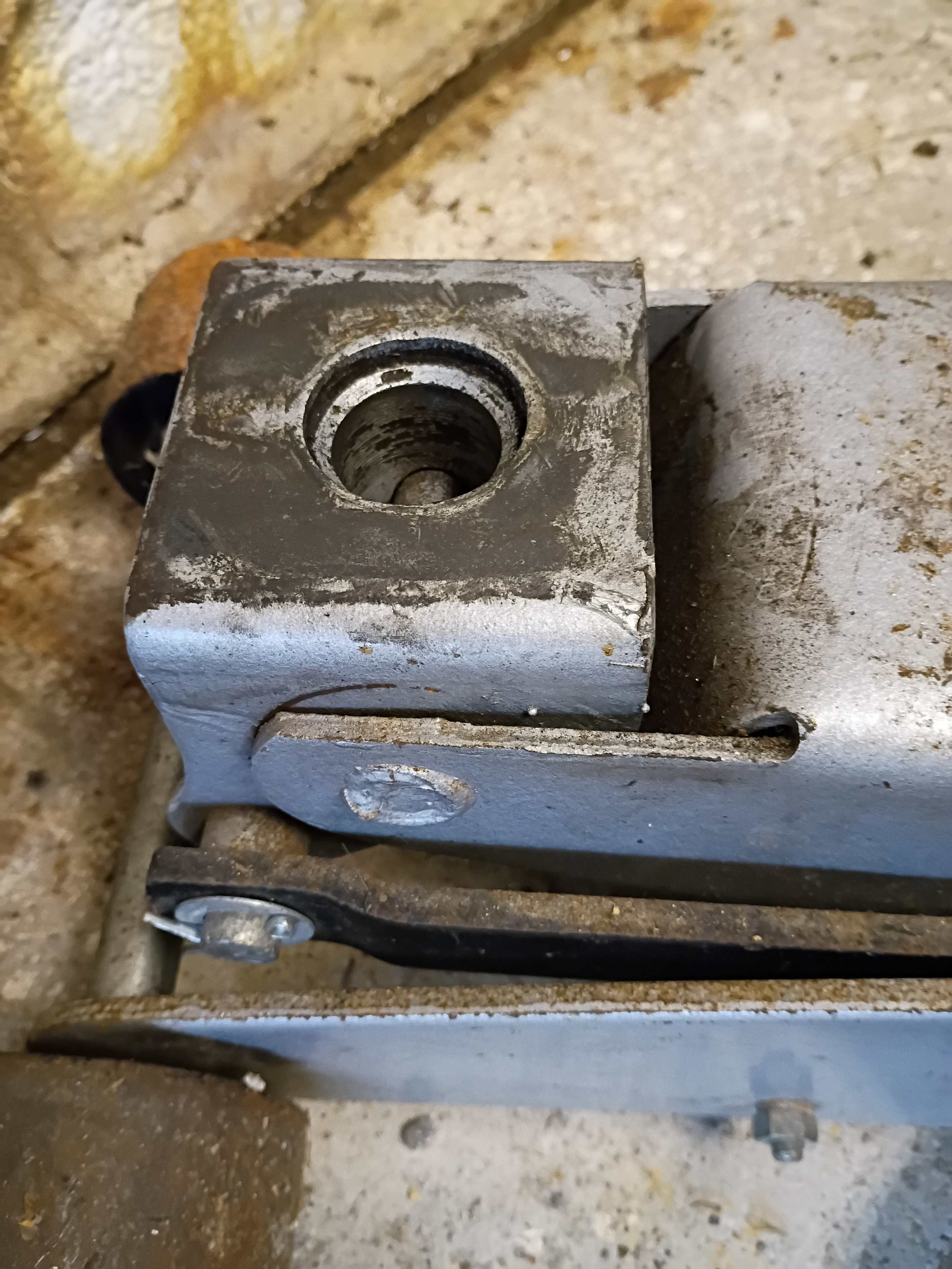

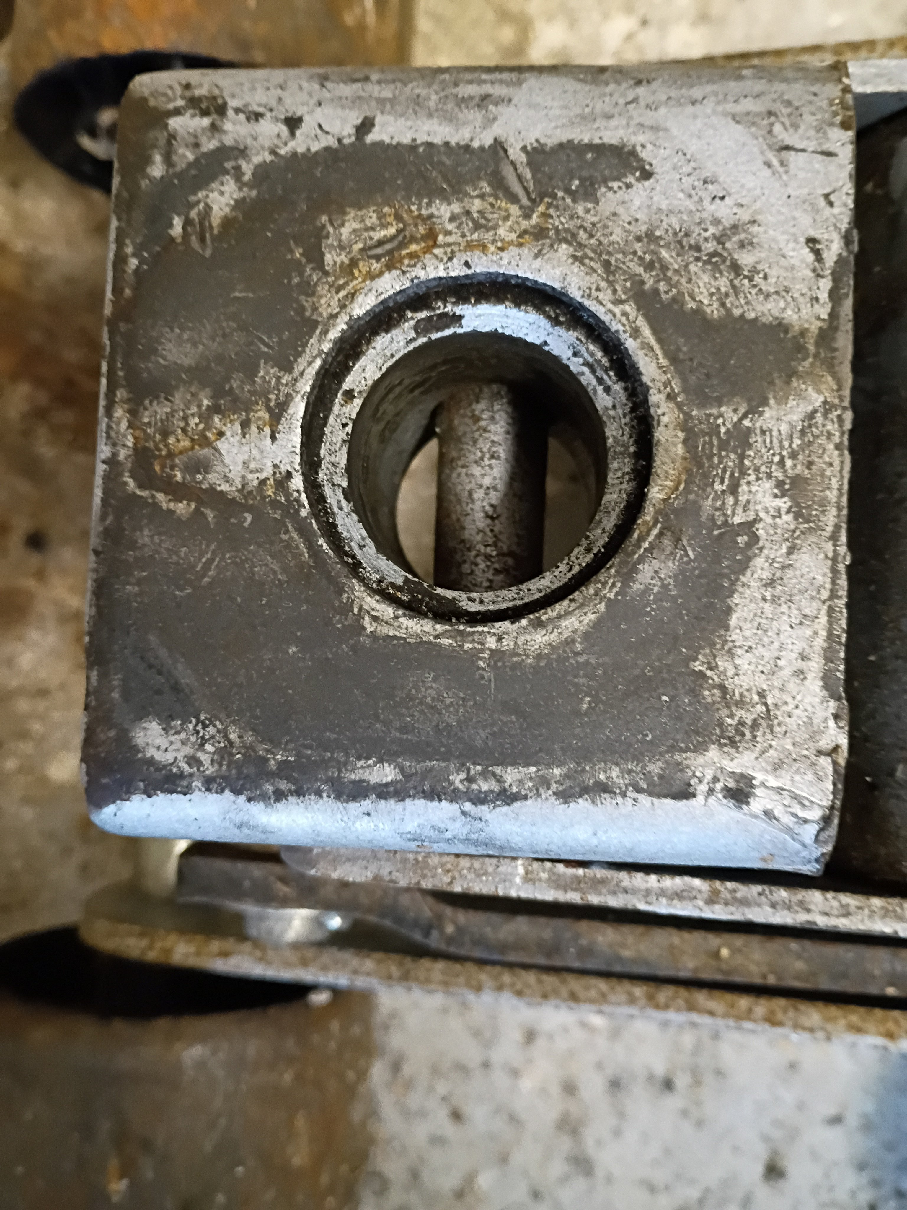

Spinner99 67 Report post Posted June 26 (edited) Sorry I'm a bit late to the party on this, but just in case you haven't purchased a jack yet some advice from experience is is to get a jack with a saddle hole that is clear of obstruction. Those adaptors (well mine at least) have a bolt that screws in from underneath the jack to hold the adaptor firm on the jack. Unfortunately some jacks (mine included) have a bar below or at the bottom of that hole and I couldn't get a bolt through from underneath with that bar being there. I recommend checking your new jack has an unobstructed hole, the size of the hole is suitable for the transmission adaptor, and the jack is as low as possible to give you as much room as possible to get the transmission out from under the car. Here's a couple of photos of my jack showing the bar in the hole the saddle would normally sit in. Edited June 26 by Spinner99 Quote Share this post Link to post Share on other sites
