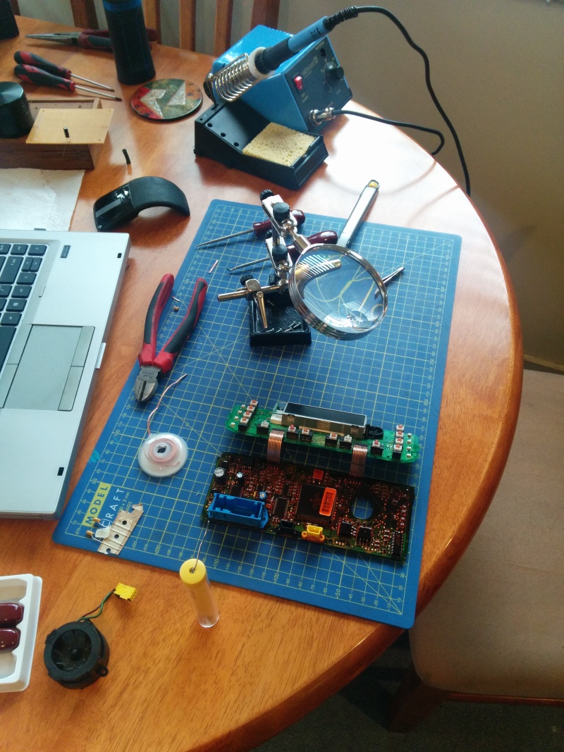

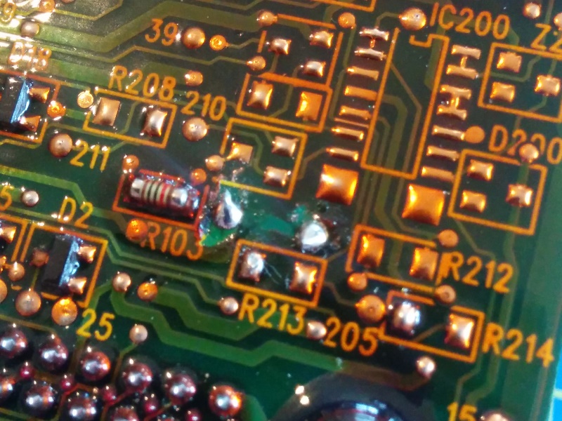

M3AN 4182 Report post Posted June 1, 2015 (edited) Fixed my digital climate control head unit today which was a little annoying because I actually had it professionally fixed about 8 years ago and secondly I hate soldering electronics, I'm fine with larger electrical stuff but find electronic components very fiddly. But it had to be done and this time I'm using a 1.0 instead of 0.47 capacitor for more headroom. And to be honest I think I did a pretty fine job... All tested and working fine! I followed this DIY so thanks to Richard for keeping it up: http://www.macadamizer.com/bmwfix.html Edited May 18, 2018 by M3AN 1 Quote Share this post Link to post Share on other sites

Michael. 2313 Report post Posted July 22, 2015 Hmmm what made you use a 1uf cap instead of 0.47uf? I would have stuck with the original capacitance Dave, you've increased it 100% by going to 1uf - it might have some performance side effects for that particular part of the circuit. Caps usually have a tolerance of +/- 10 to 20% so by lifting it to that extent is not something I'd recommend. That said it's only one cap, so probably hasn't had that big of an affect overall. At least it's working however! Voltage is okay to lift when it comes to caps however. I've replaced over 500 capacitors in my V8 Soarer in recent months. Detail is everything! Quote Share this post Link to post Share on other sites
M3AN 4182 Report post Posted July 22, 2015 Hmmm what made you use a 1uf cap instead of 0.47uf? I would have stuck with the original capacitance Dave, you've increased it 100% by going to 1uf - it might have some performance side effects for that particular part of the circuit. Caps usually have a tolerance of +/- 10 to 20% so by lifting it to that extent is not something I'd recommend. That said it's only one cap, so probably hasn't had that big of an affect overall. At least it's working however! Voltage is okay to lift when it comes to caps however. I've replaced over 500 capacitors in my V8 Soarer in recent months. Detail is everything! It's all good mate, 1uf is a tried and tested solution. And since my "oem spec" 0.47 blew out I wasn't going to try that again! 1 Quote Share this post Link to post Share on other sites

wrs 121 Report post Posted October 7, 2015 (edited) Are those the replacement capacitors you used near the bottom left corner off the mat? They look like tantalum caps... If they are tant's they are far less reliable than newer technology, eg Solid Aluminium or Polymer Caps. Tant's don't like higher temperature or ripple where the newer alternatives work well in either or both of these conditions. Edited October 7, 2015 by wrs Quote Share this post Link to post Share on other sites
M3AN 4182 Report post Posted October 12, 2015 Are those the replacement capacitors you used near the bottom left corner off the mat? They look like tantalum caps... If they are tant's they are far less reliable than newer technology, eg Solid Aluminium or Polymer Caps. Tant's don't like higher temperature or ripple where the newer alternatives work well in either or both of these conditions. Hi and yes, they're tantalum caps to the best of my knowledge. I just used what the DIY says to use because I have very little idea about electronics and wasn't going to second guess somebody that had already had success. So far so good... with any luck it will hold for years to come. 1 Quote Share this post Link to post Share on other sites
wrs 121 Report post Posted October 12, 2015 Yeah, tants usually last quite a long time but have a much higher failure rate than other types of cap - especially that particular style of tant. Today there is much newer technology caps that would work well in place of a tant and once changed you'd never have to worry about it again. As you say though - you'll probably get years out of the replacement. Quote Share this post Link to post Share on other sites

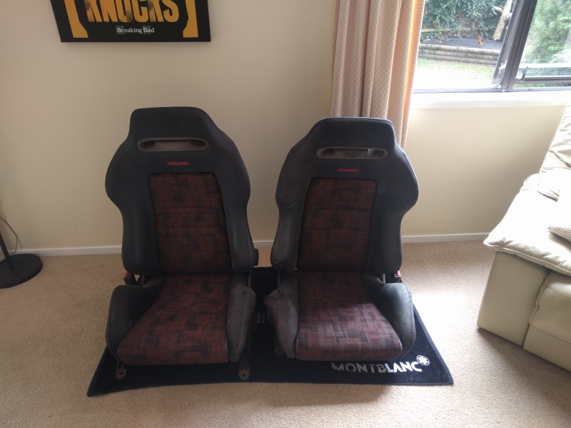

M3AN 4182 Report post Posted February 14, 2016 (edited) Looks like I'll be cleaning seats this week/end... 2 x Recaro SR3's with fold forward leavers on the backrests. Edited May 18, 2018 by M3AN 4 Quote Share this post Link to post Share on other sites
M3_Power 636 Report post Posted February 15, 2016 SR3s, SR4s have separate belt holes and a taller headrest. 1 Quote Share this post Link to post Share on other sites
M3AN 4182 Report post Posted February 15, 2016 Yes, you're correct, I looked up the wrong reference pics! Auction didn't reference the type, that was my error. Quote Share this post Link to post Share on other sites
M3AN 4182 Report post Posted February 15, 2016 Also just found out the seller has new bolsters for them also which he's going to drop off, sweet! And, dreading the worst I pulled out the genuine Alcantara I have and it's an exact colour match. This will allow me to replace any of the less than perfect panels. Looks like the entire seats will need to be unstitched and re-sewn to put new bolsters in anyway unless I find otherwise when I disassemble them. Quote Share this post Link to post Share on other sites
M3_Power 636 Report post Posted February 15, 2016 (edited) They can be disassembled. i have disassembled tons of these in the past to fix bolsters, it does not require unstitching. The whole thing can be taken apart. There's even a way to fix the seat back wobble that's common on these from usage. Edited February 15, 2016 by M3_Power 1 Quote Share this post Link to post Share on other sites
M3AN 4182 Report post Posted February 15, 2016 Sweet, that's good to hear Tom. I'll tackle disassembly and cleaning hopefully before the next weekend is out. Quote Share this post Link to post Share on other sites
