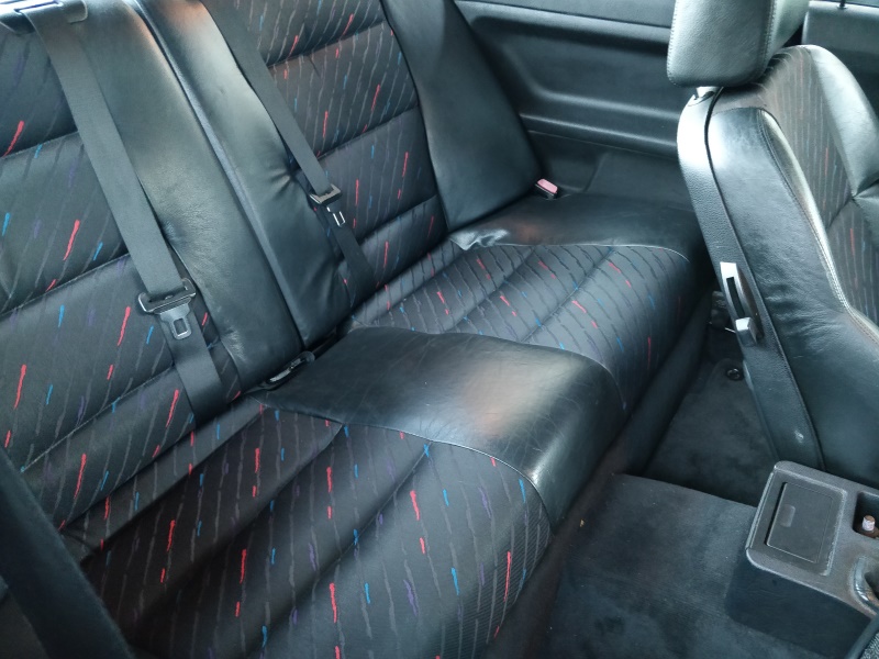

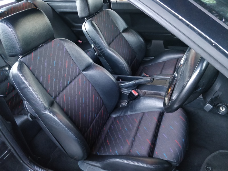

M3AN 4155 Report post Posted July 3, 2018 And pics of the new seats front and rear... considering these look nearly new and my old ones looked (and felt) terrible this is a HUGE upgrade... really like the Motorsport fabric as well. ? ? 11 Quote Share this post Link to post Share on other sites
BreakMyWindow 1974 Report post Posted July 4, 2018 Nicely done Dave. The M rain interior is a definite win imo 1 Quote Share this post Link to post Share on other sites

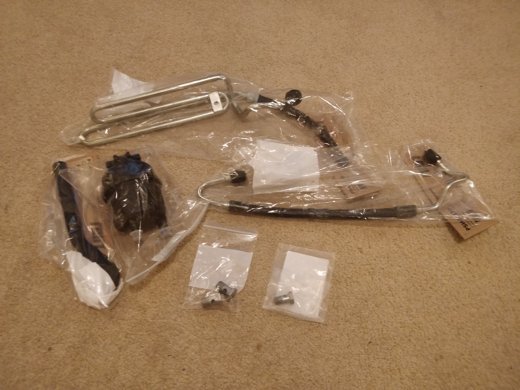

M3AN 4155 Report post Posted February 21, 2019 (edited) Having ignorantly purchased a LHD refresh kit for the power steering it ended up costing me nothing but a little of my time. FCP Euro took back the LHD parts, refunded me and even paid for return shipping, how good is that! Because the crush washers went back with the lines I had to get them locally and BMW NZ charges over $3 each which is criminal. I should have ordered them from abroad and waited. Nevertheless, it all went in on the weekend so now I have a fresh power steering system (including rack) to add to all the other maintenance items - at this rate it's getting more love than the M3 at the moment... totally replaced interior (abandoned M3 project + used from Zebra) totally replaced suspension w/M3 inc. used struts, springs and bars w/all new mounts, bushes and links entirely new cooling system rad, pump, therm, hoses etc. (new OEM + alu rad) aftermarket wheels and new tyres (17's forged BBS RGR + cheap Pirellis) replaced steering rack, reservoir, hoses, bolts, washers and fluid Alignment today and it drives straight again! That was a bit of practice for when I come to put the Z3 rack in the M3 sometime soon... Edited February 21, 2019 by M3AN 2 Quote Share this post Link to post Share on other sites
