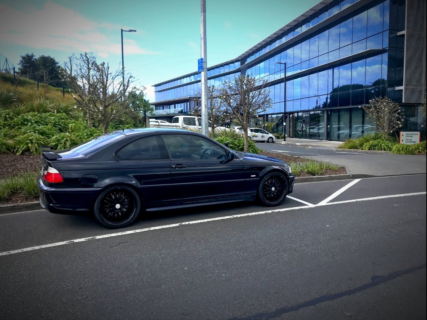

mmario 60 Report post Posted July 21, 2024 Wheels look great, my vote for BMW center caps 1 Quote Share this post Link to post Share on other sites
Eagle 1759 Report post Posted July 22, 2024 Ordered some Black/gold ones which should match better and save cutting. BBS caps are all different fitment so you have to hack genuine stuff up or play around with lesser quality aliexpress bits. 1 Quote Share this post Link to post Share on other sites
Vass 1030 Report post Posted July 22, 2024 Nice score on the wheels, do look like a cool design but that black-silver-red and blue combo just looks hella busy. Would be ideal if they were straight silver. Almost a shame they were recently redone since it makes less sense to repaint them now hahah Quote Share this post Link to post Share on other sites
Eagle 1759 Report post Posted July 22, 2024 Pretty much. They were suppose to come black caps but he changed his mind hah. BBS diamond black(more of a gun metal grey) wasn't doable for various reasons so instead used a Mazda black which is appears noticeably darker but is suppose to be lighter in sun 1 Quote Share this post Link to post Share on other sites
hunter 411 Report post Posted July 22, 2024 18 minutes ago, Eagle said: Pretty much. They were suppose to come black caps but he changed his mind hah. BBS diamond black(more of a gun metal grey) wasn't doable for various reasons so instead used a Mazda black which is appears noticeably darker but is suppose to be lighter in sun Be good to get some sun to see the true colour. lol. Quote Share this post Link to post Share on other sites
Eagle 1759 Report post Posted July 22, 2024 Im sure ill post some more in better light with different caps, but i dont see the sun making a massive different tbh. Main benefits are minor increase in performance, way stronger and straighter wheels, nicer ride and look with the 40 profile tyre and offset and having a square setup for easy of use and cheaper tyres. 1 Quote Share this post Link to post Share on other sites
hunter 411 Report post Posted July 22, 2024 I hear you on the straight wheels. I took some to get the lips refurbished today and one was wonky as once it was in the machine. I hadn’t driven in them yet. Glad I got it checked before it sent me down a rabbit hole. 2 Quote Share this post Link to post Share on other sites
Neil McCauley 434 Report post Posted July 22, 2024 BBS RX / RG-R are god tier wheels for the E36/46. Great choice. Can't really complain at being freshly refurbed either - I've spent stupid monies in the past doing that exercise so can totally understand not wanting to spend the money if someone else already has! 1 Quote Share this post Link to post Share on other sites
Eagle 1759 Report post Posted July 22, 2024 Completely agree. Paint costs arent cheap and finding something even remotely decent in these specs and price range was way harder than i expected. They are 6k new in US before any than other expenses so i thought 2k was very reasonable. Worst case i can repaint them down the line if i really want to. Ive been fortunate in the past to own 3 sets of various used forged BBS wheels that were all under 1k at the time. You still pay the brand tax but used quality beats all low quality aftermarket junk any day with a much lower premium. Quote Share this post Link to post Share on other sites
