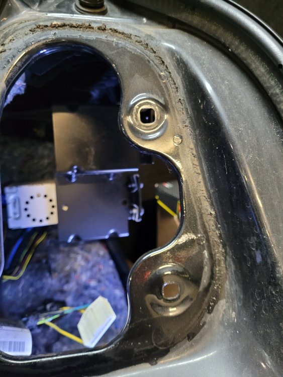

eski 3 Report post Posted July 27 On 7/22/2025 at 11:30 PM, Danch said: Water leak! Has anyone experienced water pooling underneath rear seats and in wells underneath rear lights? (where PDC module is if you have one) I pulled out 100ml of water from the rear seatbelt bolt holes and emptied the wells (the driver side was a lot worse). The rear rail seems to be wet inside. I searched online and people suggest it's either coming from the rear light gasket, or the rear vents in the wells, or the bumper mount gasket. The rear light gasket and rear vents seems ok - I just can't imagine that much water collecting in the rails because of those leak points 😕 Maybe I'll hose down from the top and see if there are any obvious leak points... Did you also drain the rear rail? Had the same issue a couple years ago and my rear rails were full of water and leaking up through the seatbelt bolts, there's a plug on the underside of the rail that's not too bad to access with the battery tray out. As others have mentioned, retorquing the taillight and adding drain holes to the plugs in the wells helps (fixed my problem at least, only place water gets in now is my badly leaking cowl (anyone got any pointers for that...)) 1 Quote Share this post Link to post Share on other sites

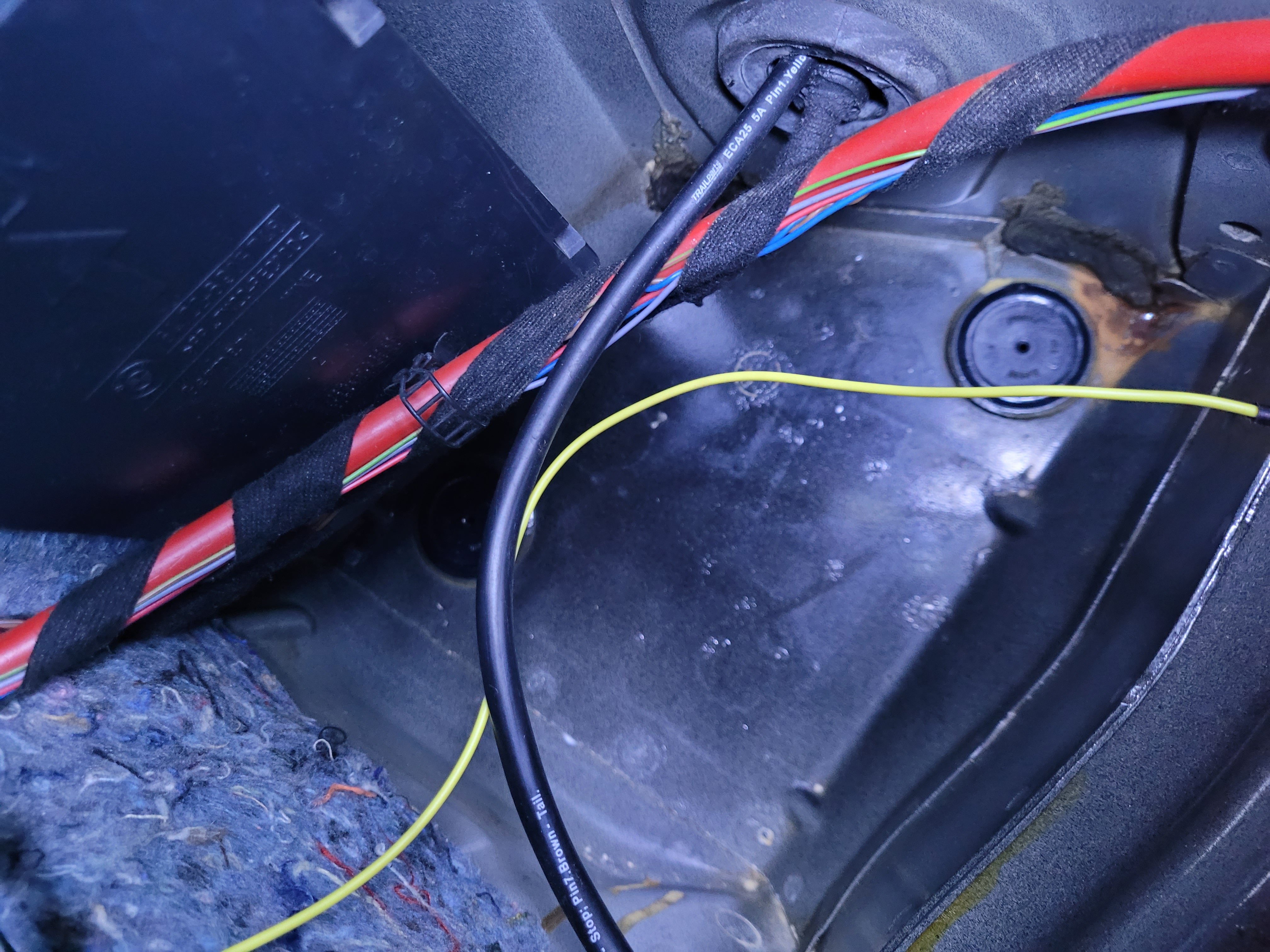

Danch 51 Report post Posted July 27 5 hours ago, eski said: Did you also drain the rear rail? Had the same issue a couple years ago and my rear rails were full of water and leaking up through the seatbelt bolts, there's a plug on the underside of the rail that's not too bad to access with the battery tray out. As others have mentioned, retorquing the taillight and adding drain holes to the plugs in the wells helps (fixed my problem at least, only place water gets in now is my badly leaking cowl (anyone got any pointers for that...)) I drained the rear rail after reading this post: E91 rear seat wet / water in battery compartment / water ingress search (picture below is from the post) There was quite a bit of water in there. I tried to take the battery tray out, but something is stuck - maybe some clipping mechanisms? I didn't want to damage anything, so I left it there. I've drilled drain holes to the plugs in the wells and retorqued the taillight after noticing some water marks underneath it. However, despite having sunny days, I noticed some droplets of water in the driver side well today. It was in the corner next to the wheel arch. Maybe it's seeping from the seams? not sure. The passenger side rear seat carpet is still damp - again, not sure if it's just from previous leak or not. Looks like we've got some heavy rains forecasted so I'll keep an eye on it to see if it leaks again. 1 Quote Share this post Link to post Share on other sites

eski 3 Report post Posted July 27 2 hours ago, Danch said: I drained the rear rail after reading this post: E91 rear seat wet / water in battery compartment / water ingress search (picture below is from the post) There was quite a bit of water in there. I tried to take the battery tray out, but something is stuck - maybe some clipping mechanisms? I didn't want to damage anything, so I left it there. I've drilled drain holes to the plugs in the wells and retorqued the taillight after noticing some water marks underneath it. However, despite having sunny days, I noticed some droplets of water in the driver side well today. It was in the corner next to the wheel arch. Maybe it's seeping from the seams? not sure. The passenger side rear seat carpet is still damp - again, not sure if it's just from previous leak or not. Looks like we've got some heavy rains forecasted so I'll keep an eye on it to see if it leaks again. Could have been the ground/battery cables on the underside of the tray stopping you from pulling it out? Doesn't happen to be a sunroof car does it? If so, front & rear sunroof drains are a pretty likely culprit... Quote Share this post Link to post Share on other sites

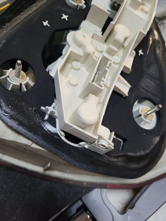

Danch 51 Report post Posted July 31 After some more rain, I confirmed that the water was leaking from the taillight gaskets. I took the taillights off and there was a lot of gunk around the gasket/foam. I gave them a good clean and reinstalled the taillights. I'll see how things go before buying new gaskets (120 for a pair incl gst from BMW) I've shoved in some rags into the rear seatbelt bolt holes and it still comes out damp every now and then. Not sure if there are any other drain plugs I can try.. Quote Share this post Link to post Share on other sites
