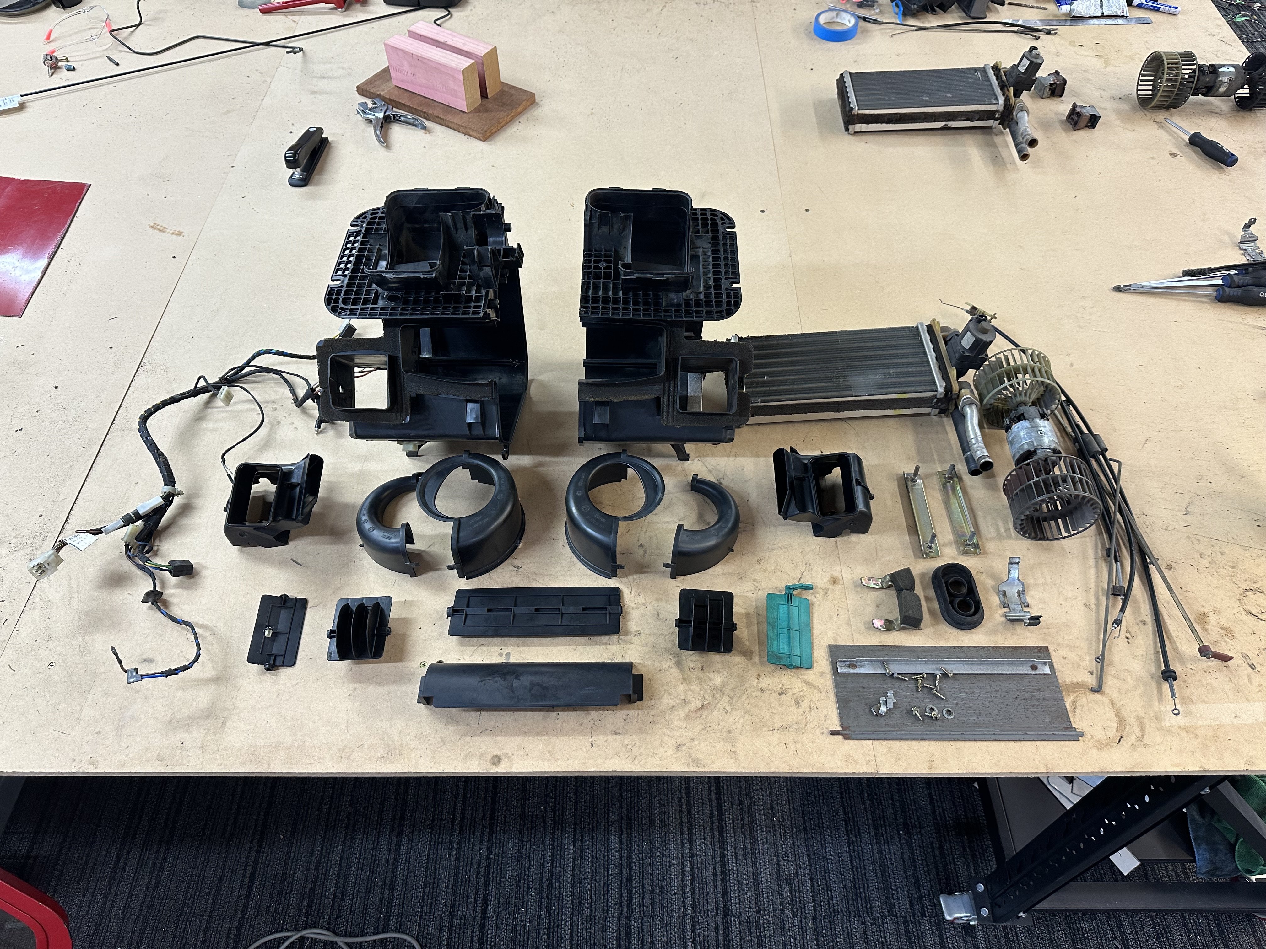

Car is currently stripped out. Engine / transmission, full wiring harness, interior, dash etc. Car came non aircon from factory and has the horrible dealer fit aircon system where they just cut into the heater unit and stuff in a condenser and add an extra blower along with ugly wiring in the engine bay and extra holes cut into the fire wall instead of using the factory stamped cut outs that cars with aircon would use. Overall a useless / ugly system that doesn’t blow cold anymore and can’t be recharged (R12 gas).

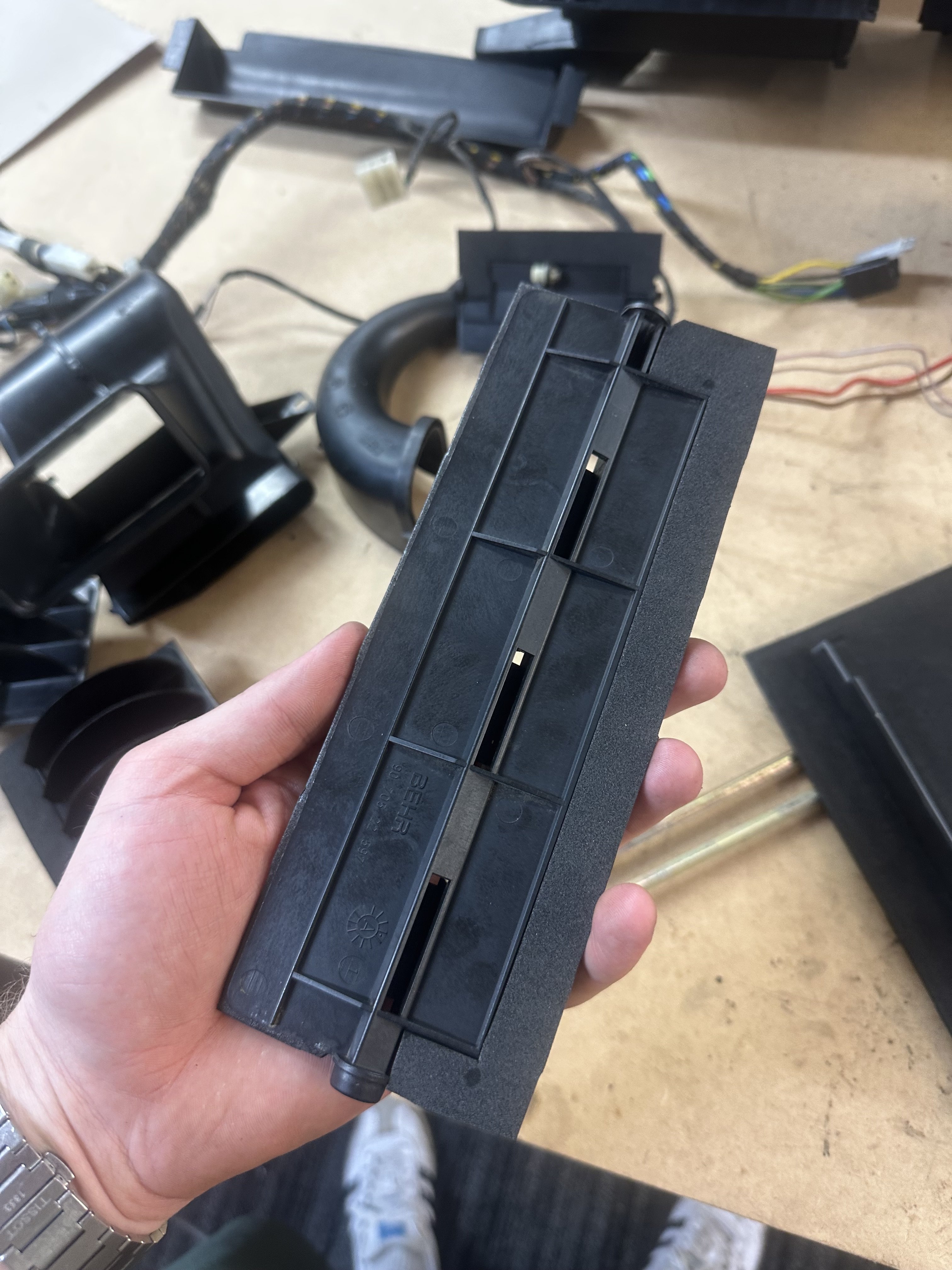

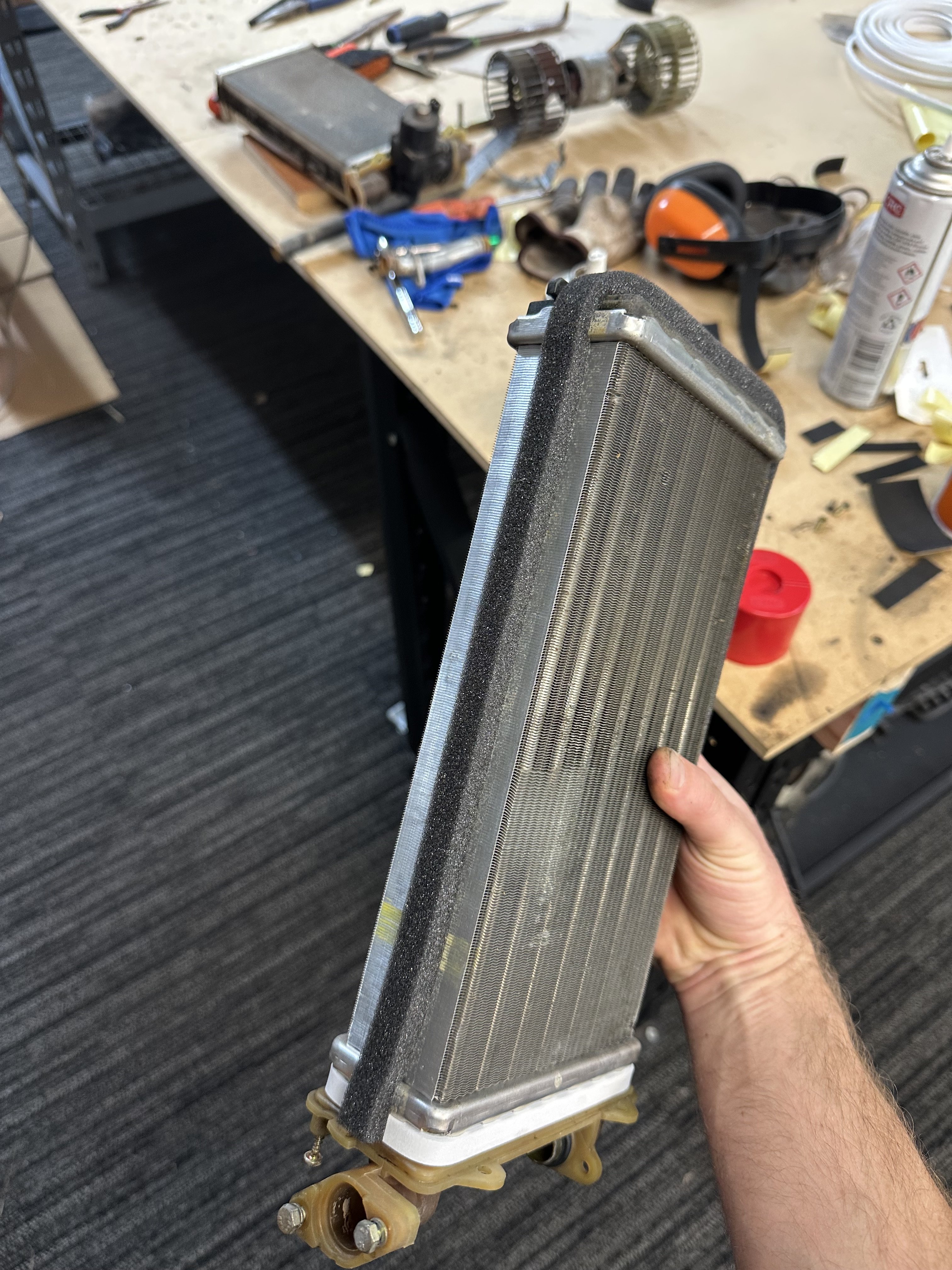

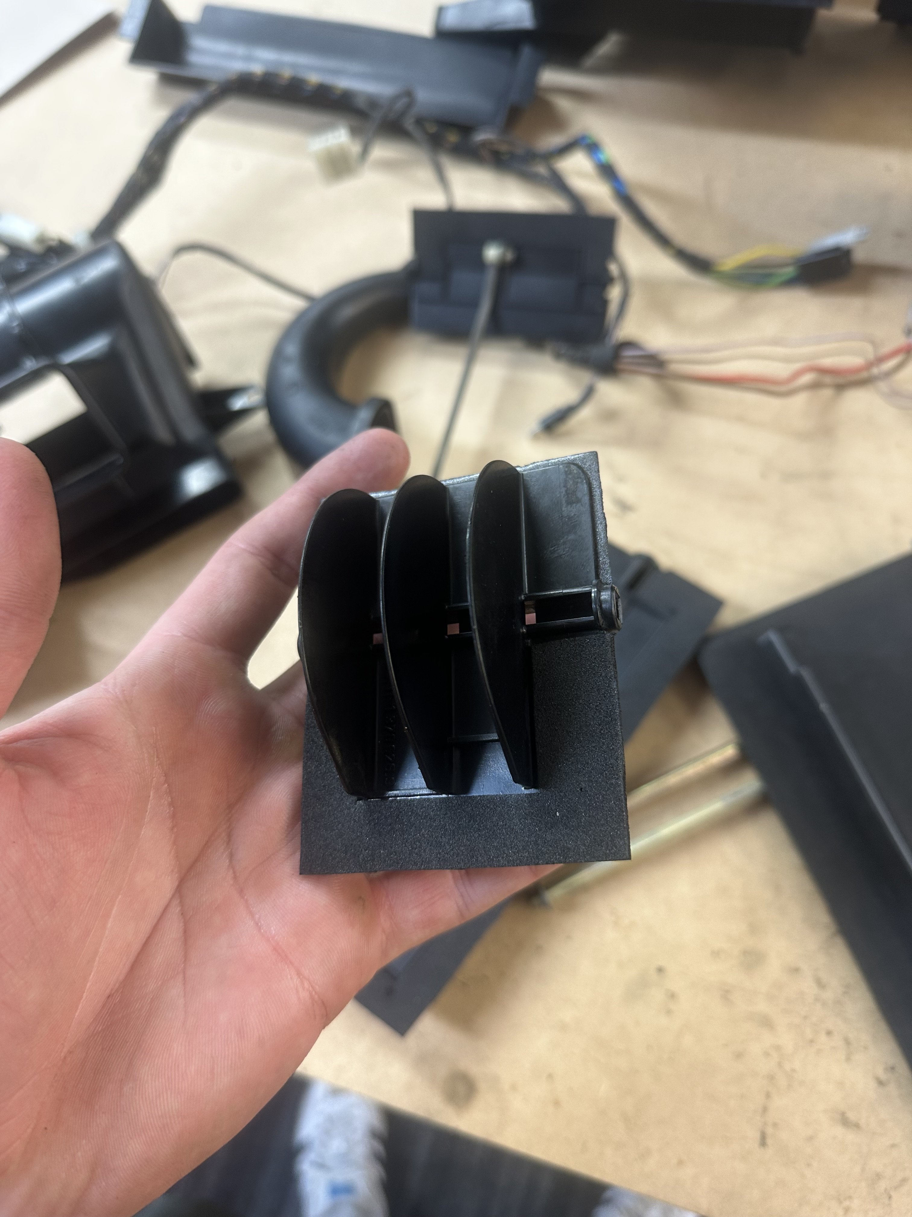

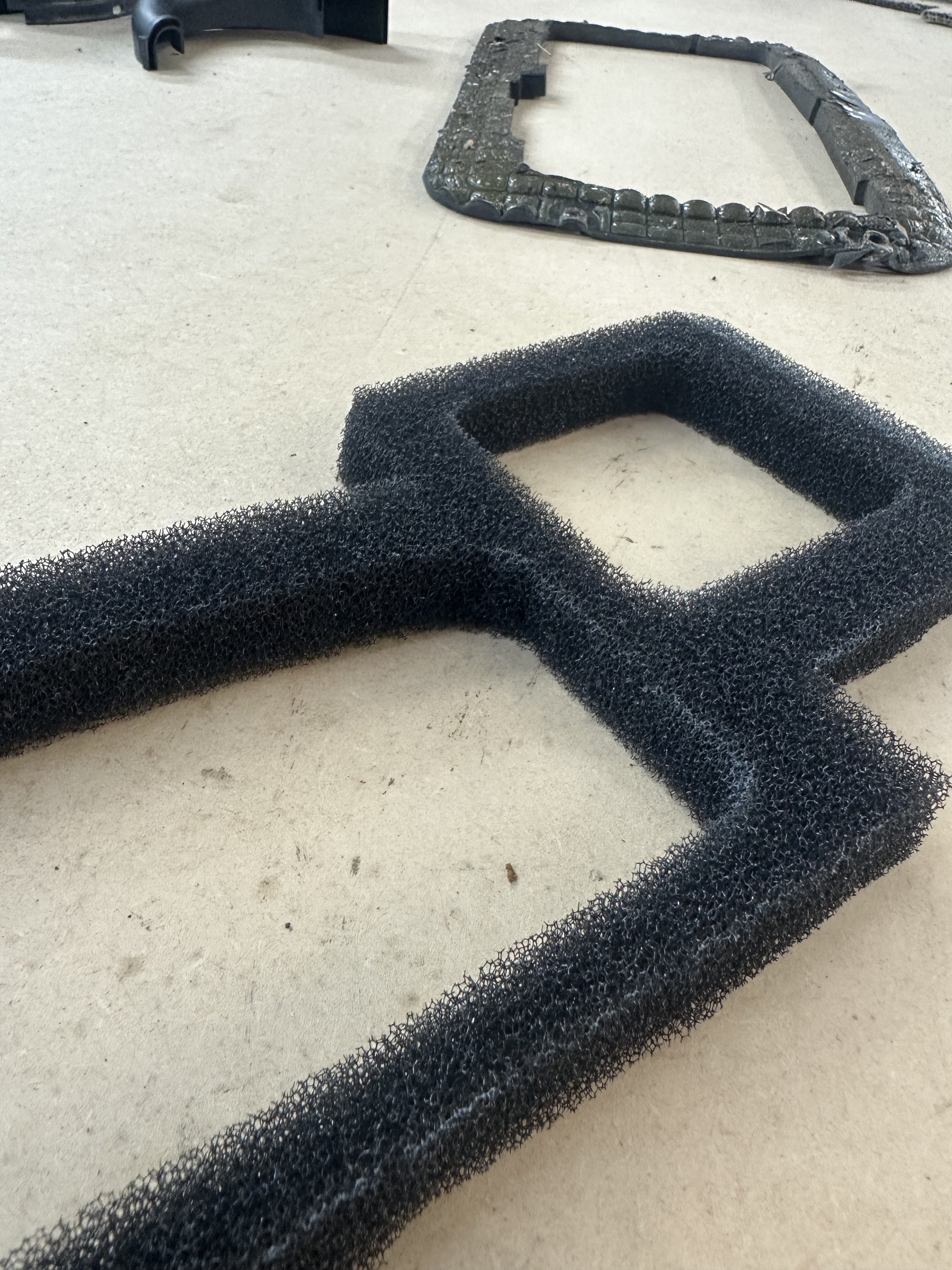

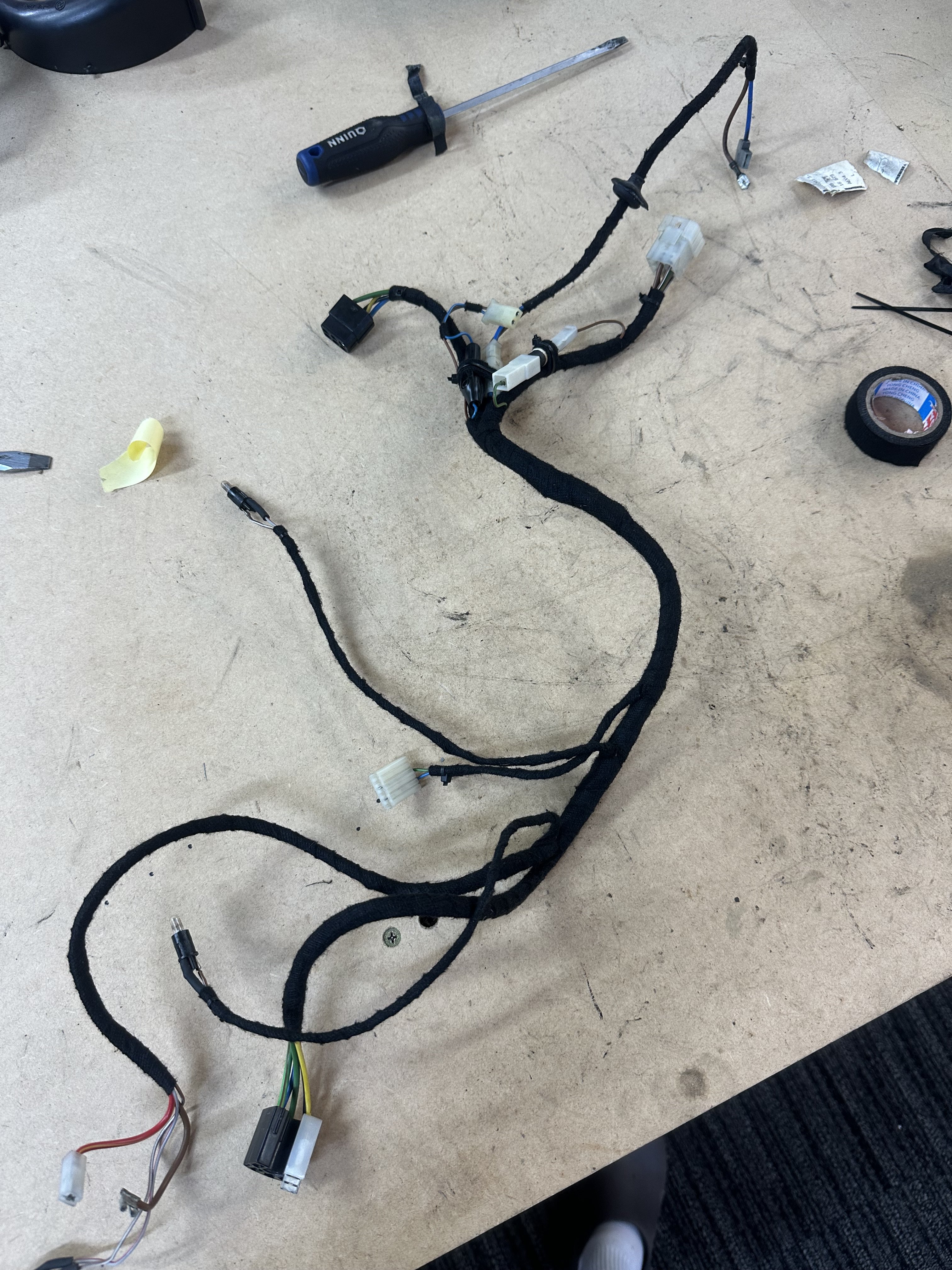

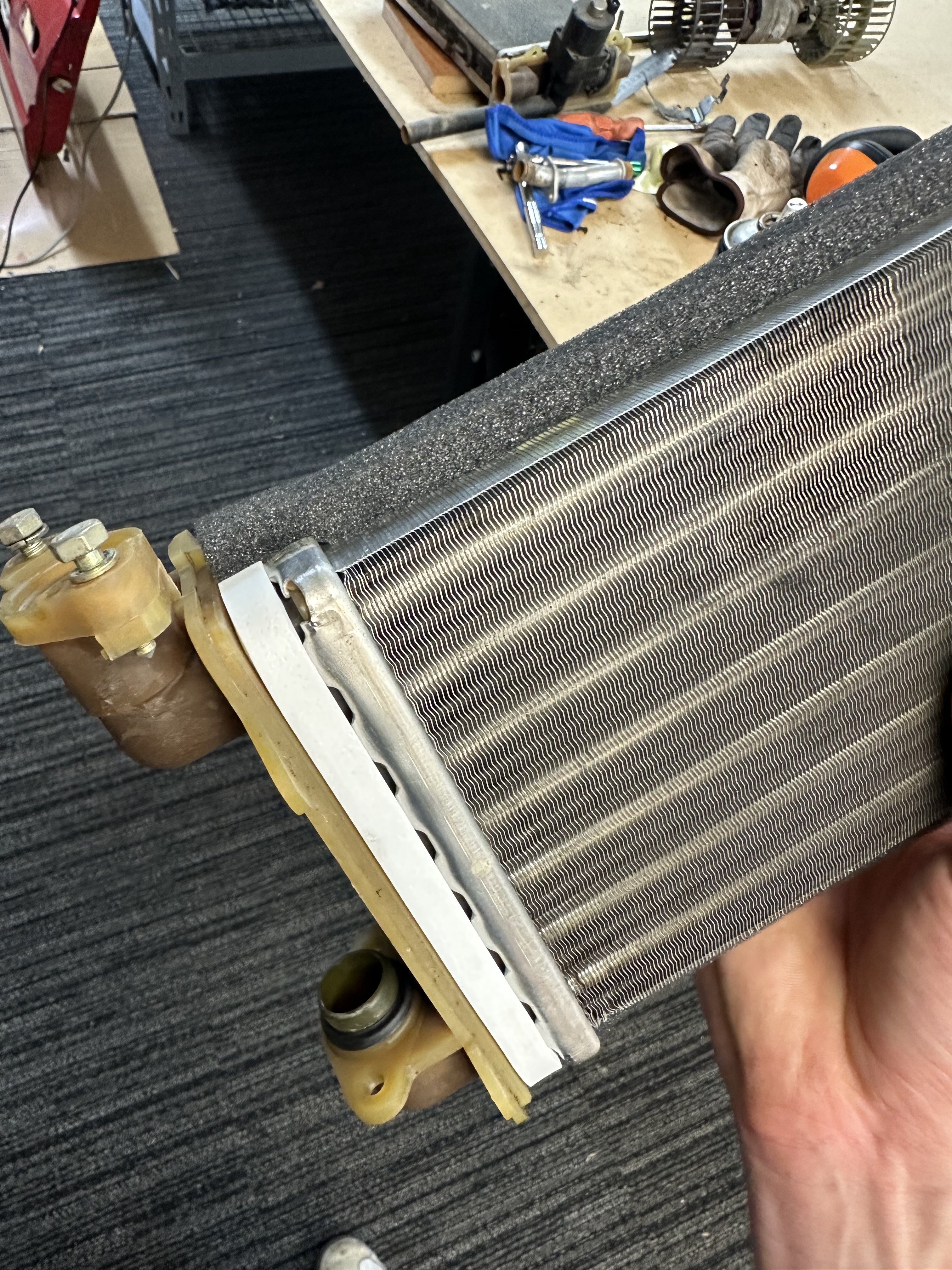

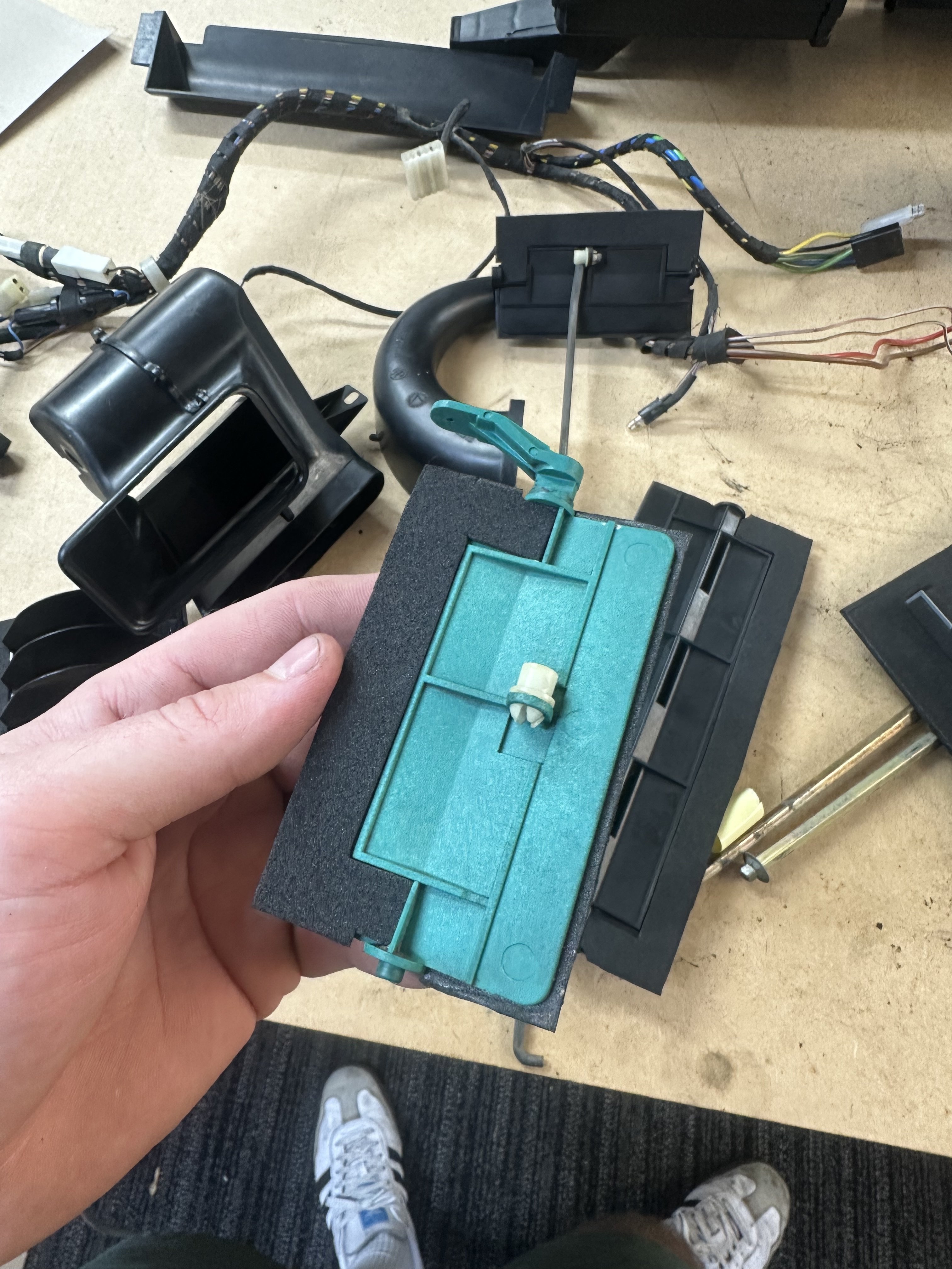

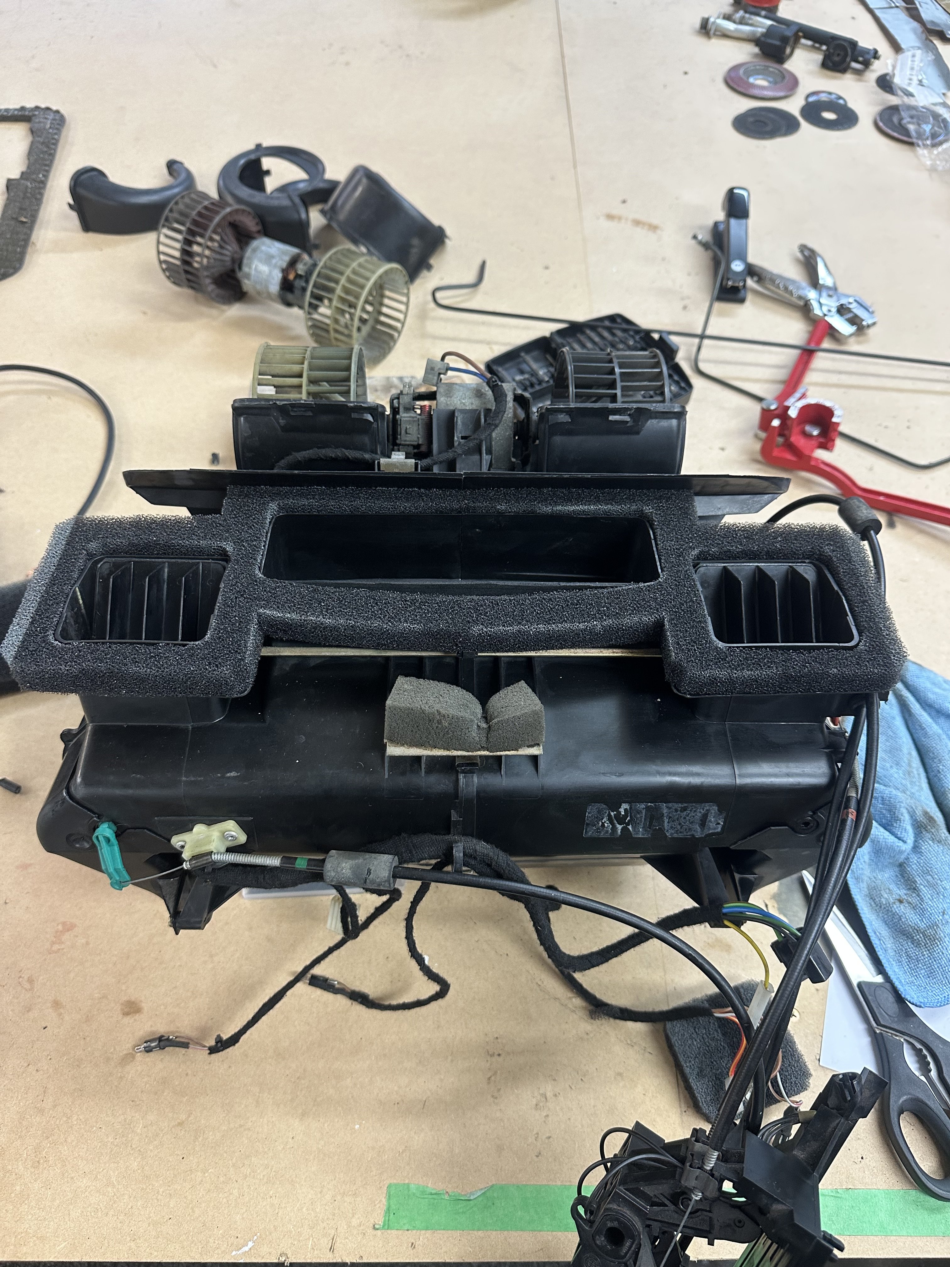

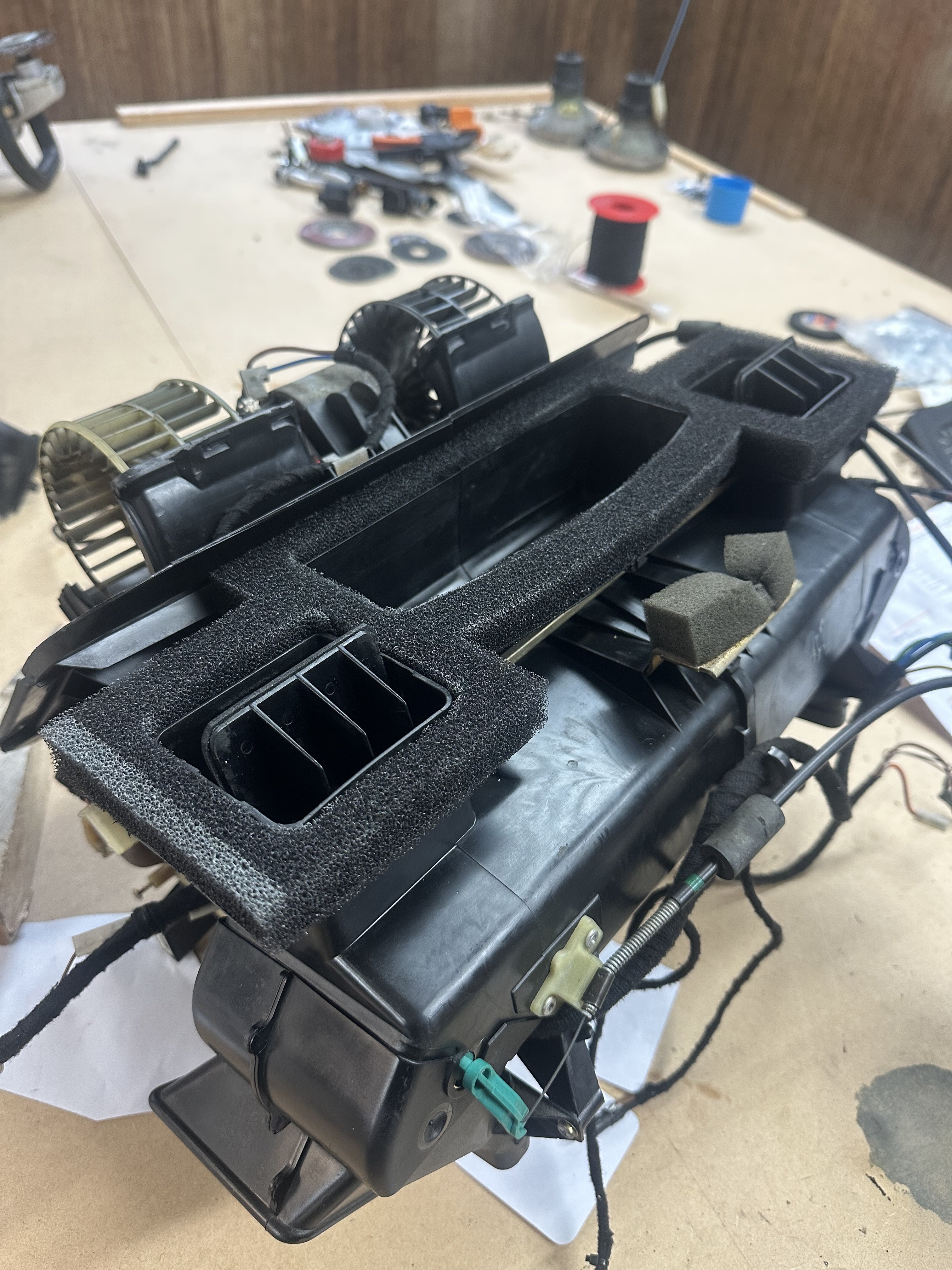

Managed to find a new unit for a non aircon pre facelift car and promptly pulled it apart and reapplied new foam to all the vents along with giving all the plastic a thorough clean and the wire cables a good greasing. All the foam in the unit (like all units of this age) was disintegrated and don’t create any form of a seal so good to get this done while the car is in bits. Fitted new o rings and resealing the pipes the come out the side of the heater core as well. Wiring for the unit got stripped of the old loom tape (along with the rest of the wiring in the entire car) and new loom tape applied.

Where did you get some of that adhesive foam if you don't mind me asking? Any local suppliers or need to look overseas?
Used this stuff for the internal vents:
https://a.aliexpress.com/_msIlXjh
got a bunch of foam from AliExpress / Temu including the thick low density stuff that seals between dash vents that clear the windscreen mist and heater unit. Had to draw the line at a $50 piece of foam from FCP. Just made stencil out of paper and transferred it to the foam and cut out.

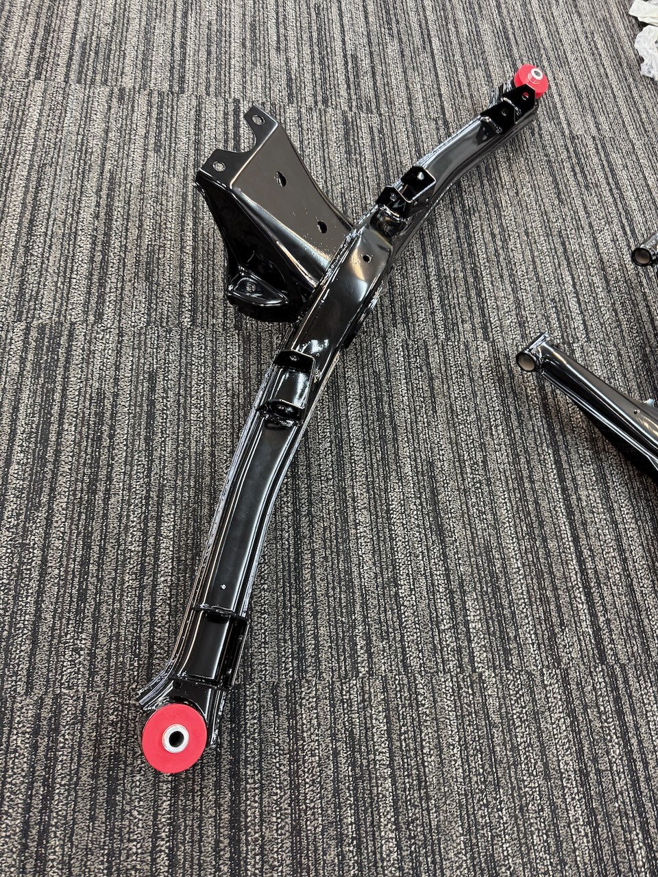

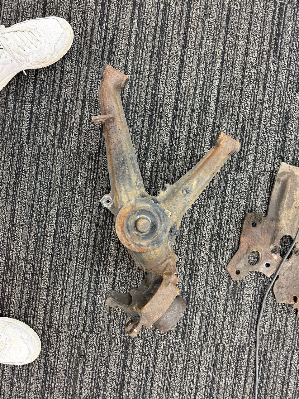

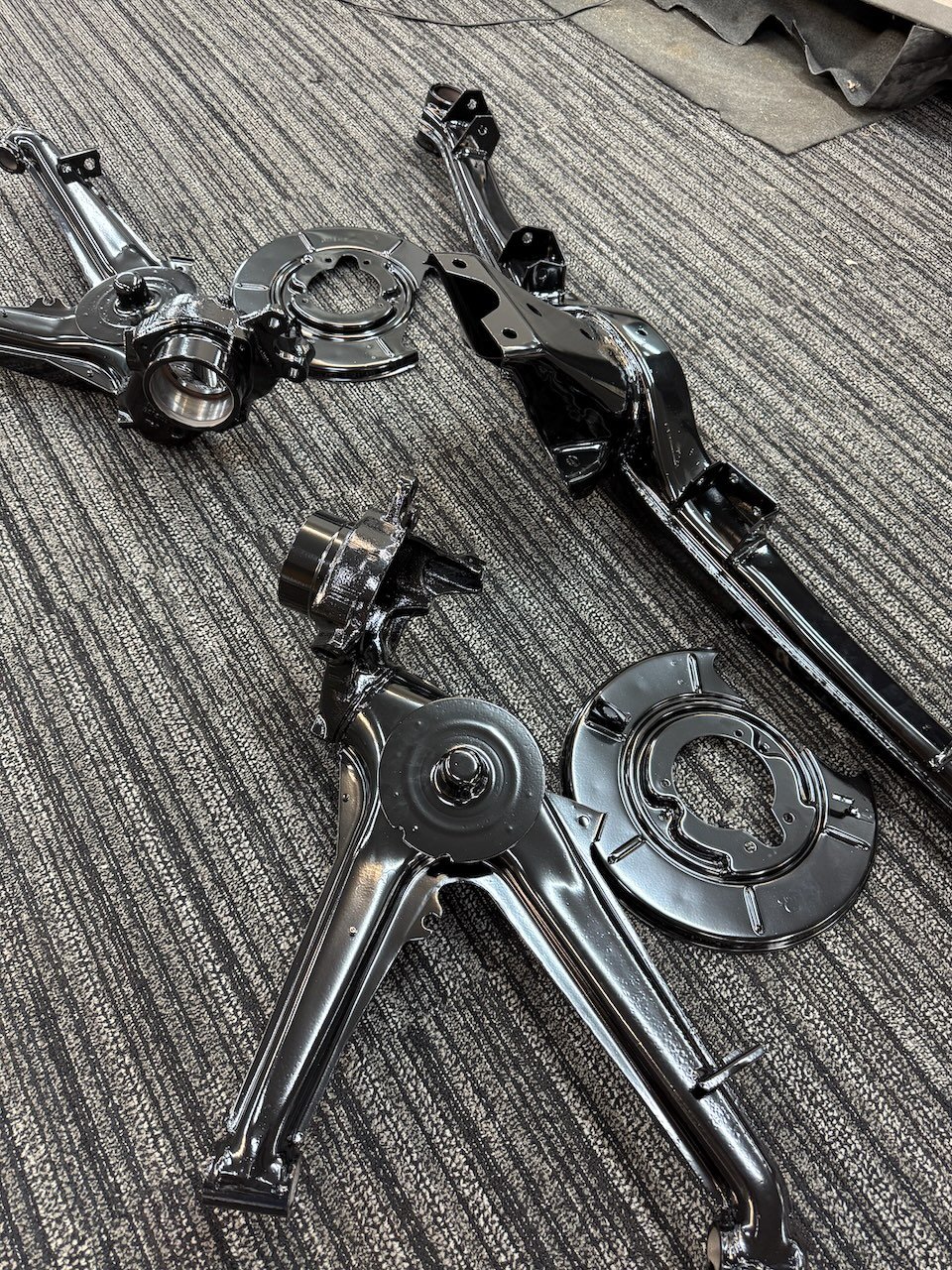

Just read through your thread now, awesome work! I’m currently restoring an e30 as well, have all the suspension stuff stripped out currently, who did your sandblasting of the front strut housings for you? Need to get that done along with rear trailing arms, front and rear subframes, heatshields etc
Thanks mate, been seeing your posts on Facebook. Car looks good, you’re getting through it quick! I sandblasted them myself at a mates shop, although wasn’t the best compressor so wasn’t the best job so had to wire wheel quite a bit off.

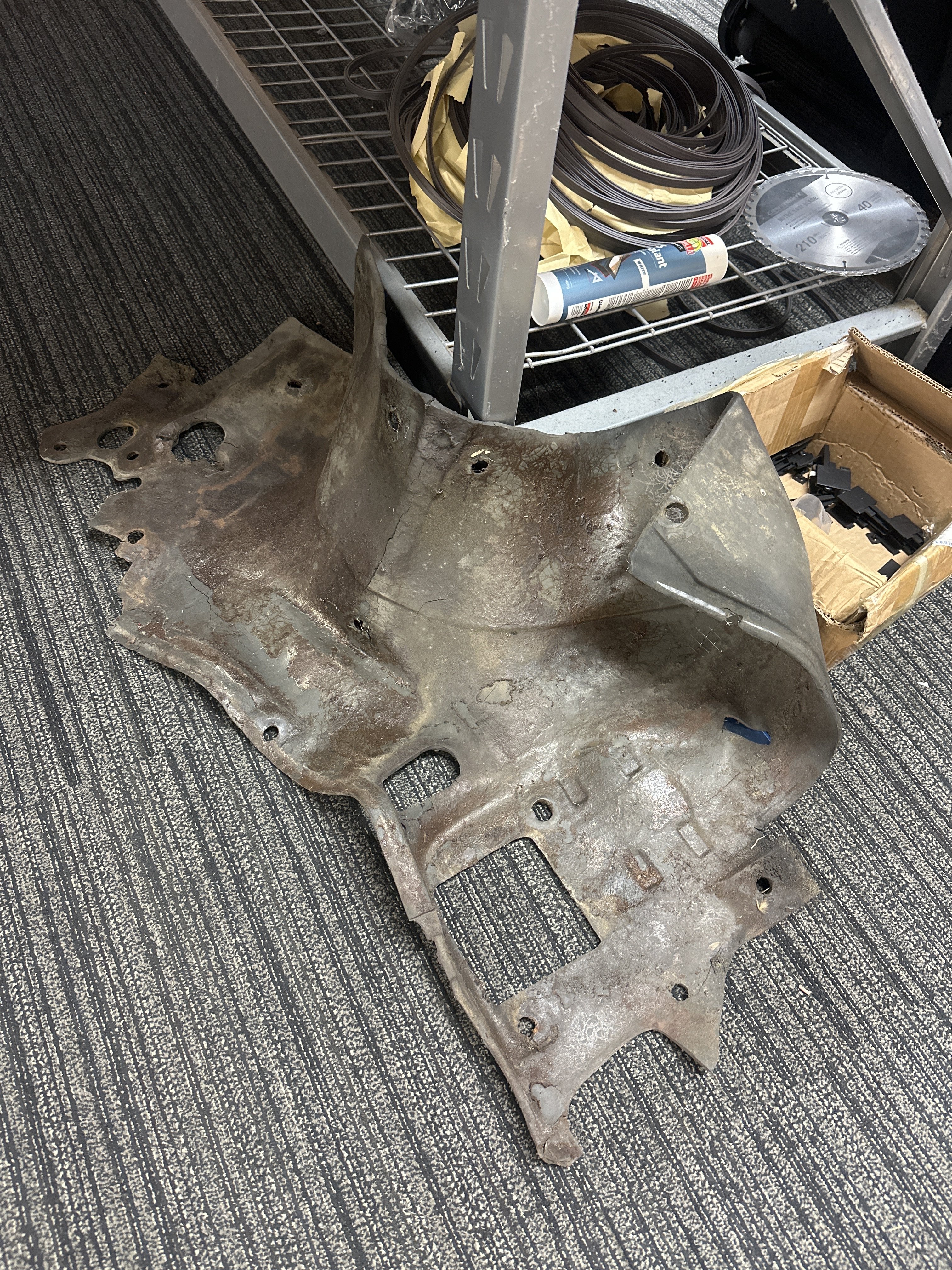

Did you figure out what to use for the trans tunnel / firewall insulation? Mines a bit worse for wear to and don’t really want it going back in.
Right gotcha. No unfortunately haven’t found anything suitable yet, I think I’ll use something like dynamat or similar on the inside but not sure what to do for heat protection on the outside just yet, debating just heat wrapping the headers and leaving it as is.

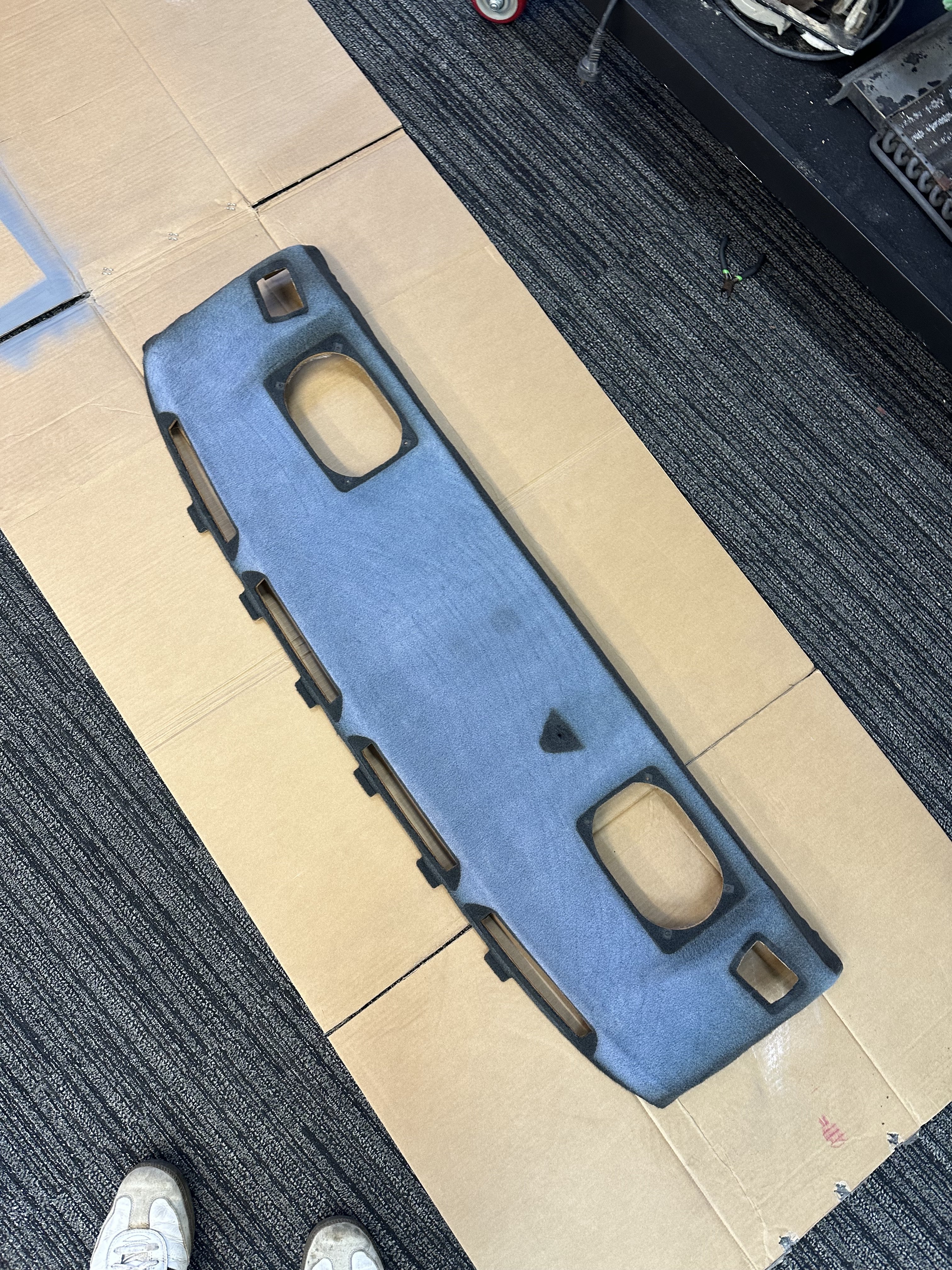

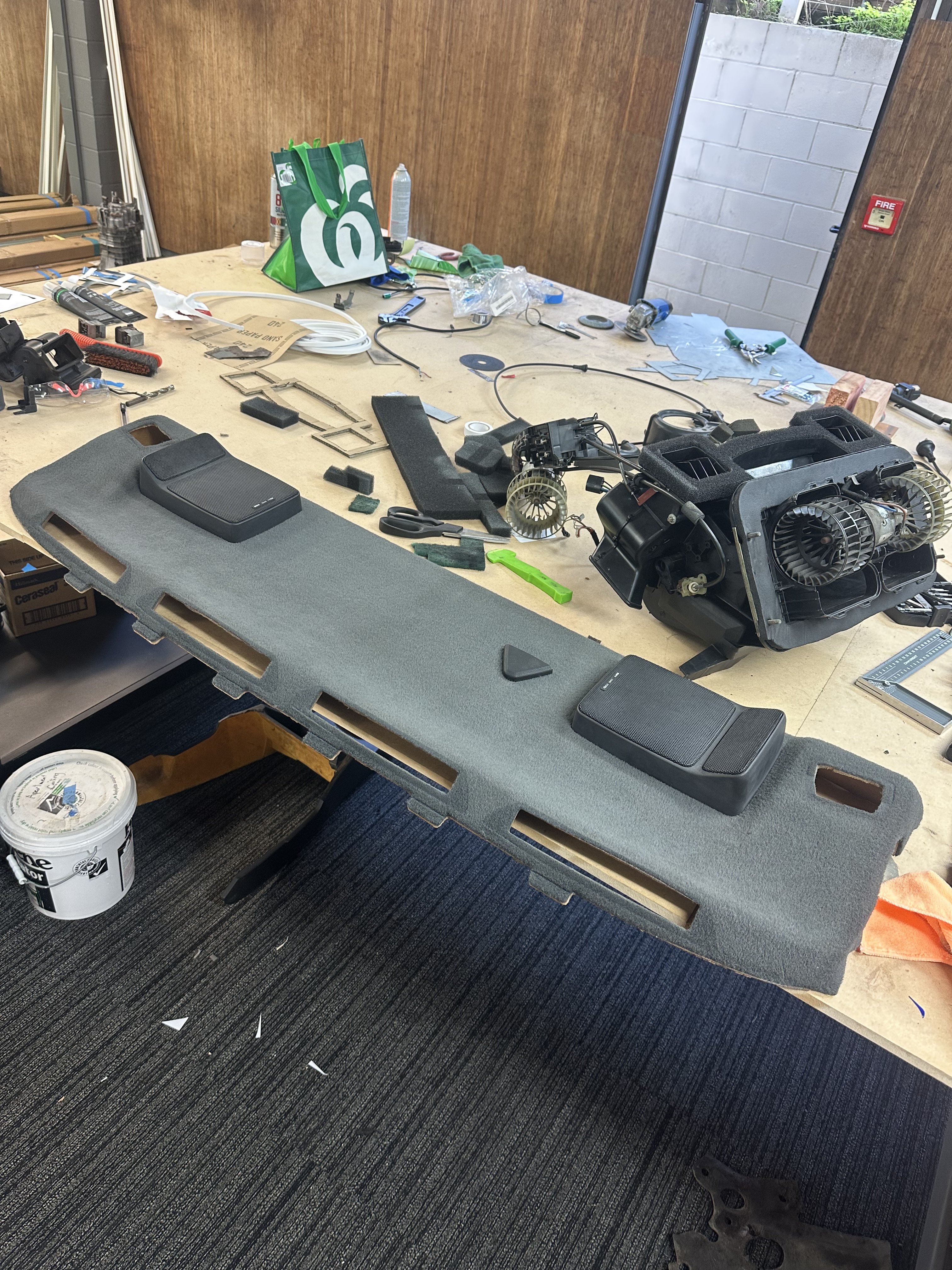

Got the rear parcel shelf done this morning. Went for the grey duplicolor @Sammo suggested. Came out pretty nice, looks a bit darker in person but would be hard to match OEM colour as using the black coloured spray would be too dark. Think it will go well with the grey houndstooth fabric regardless. Big difference from the faded blue it was!

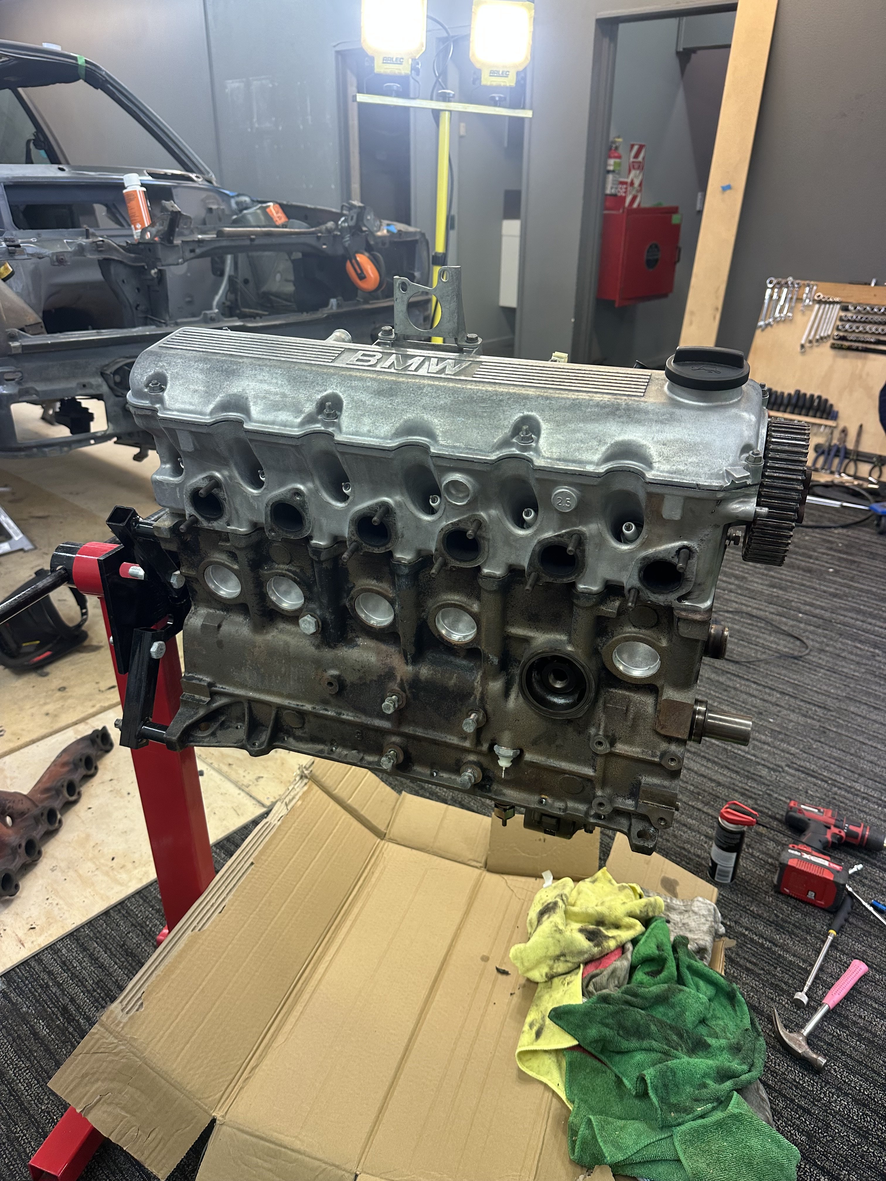

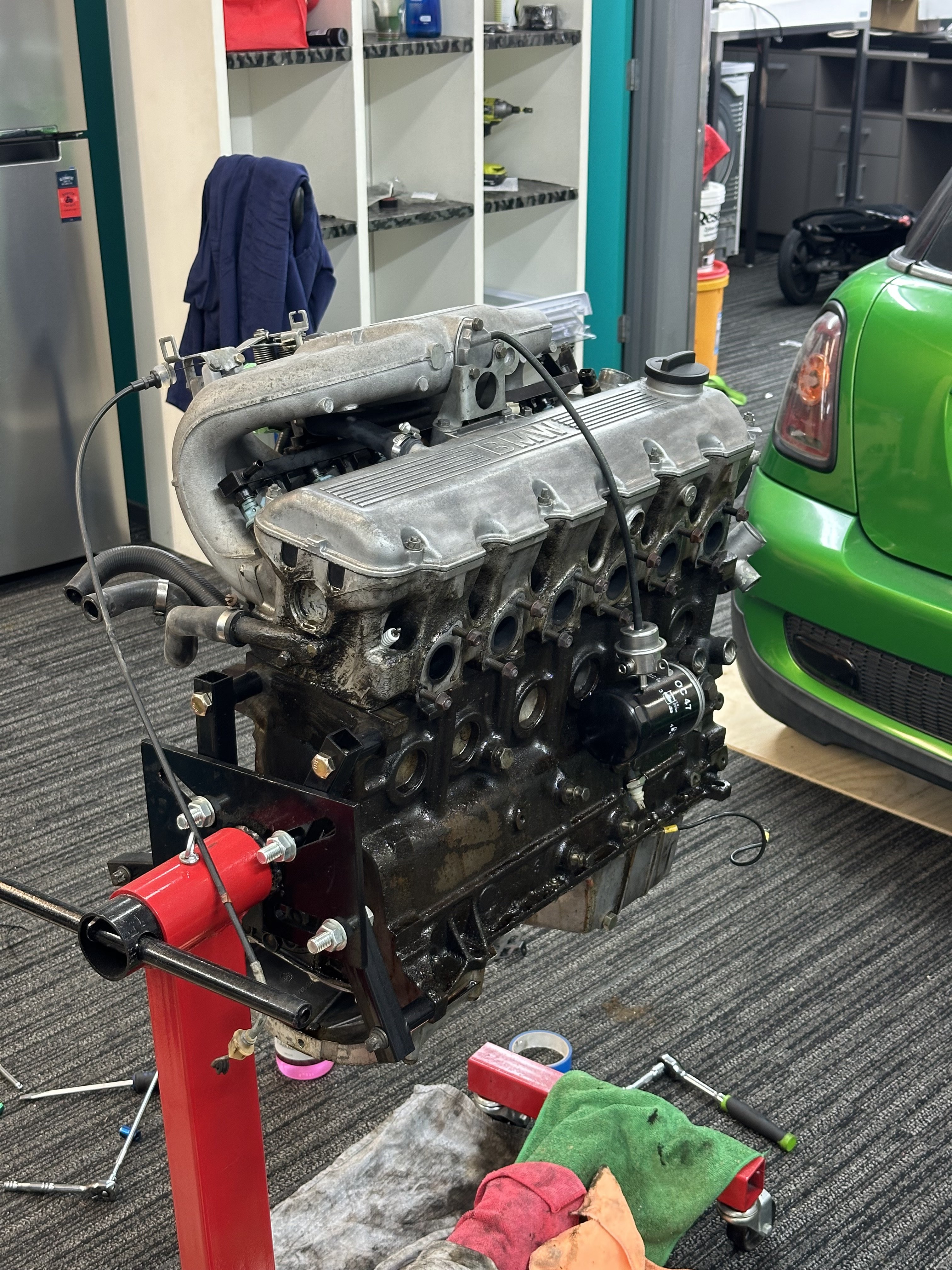

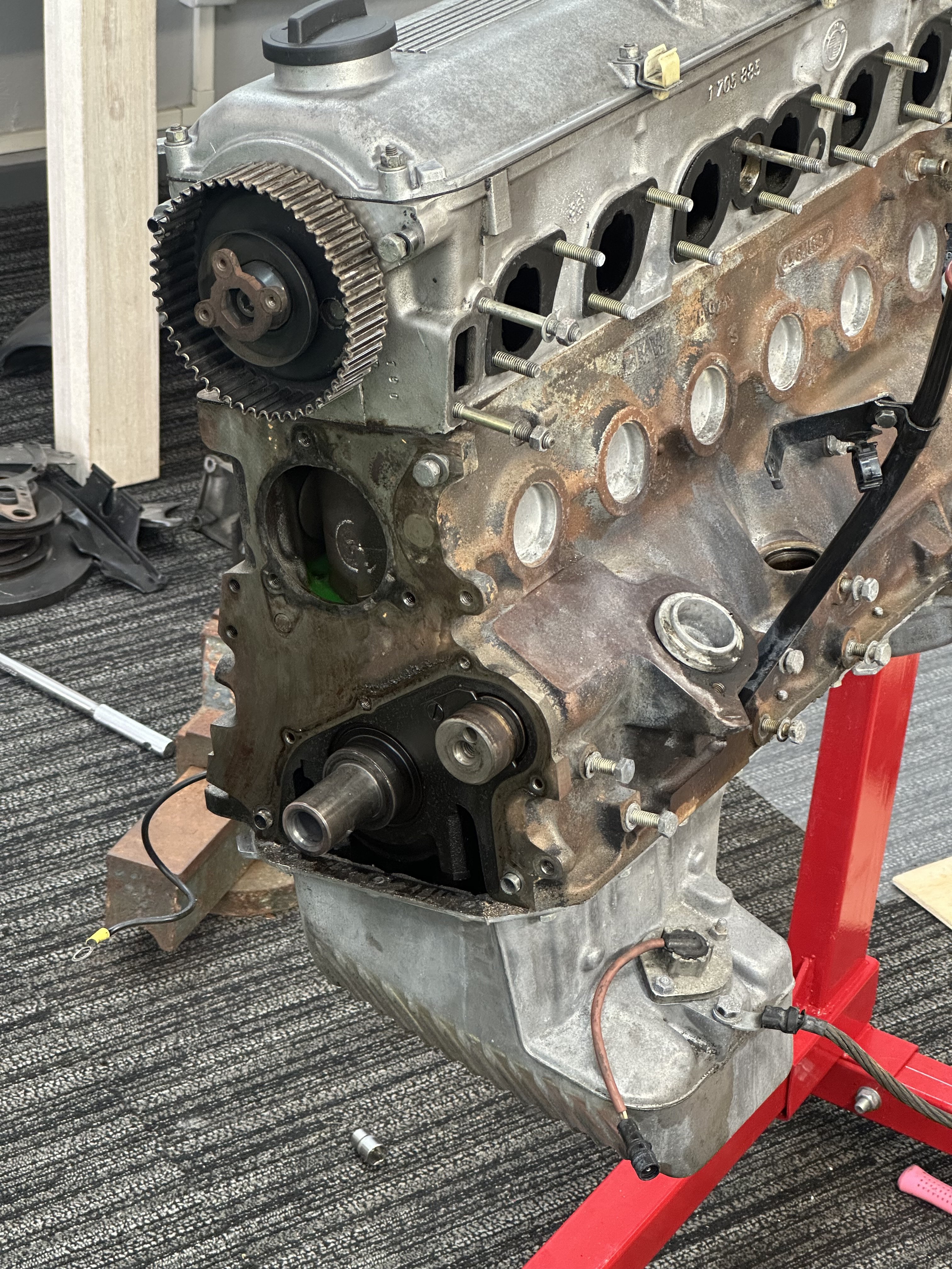

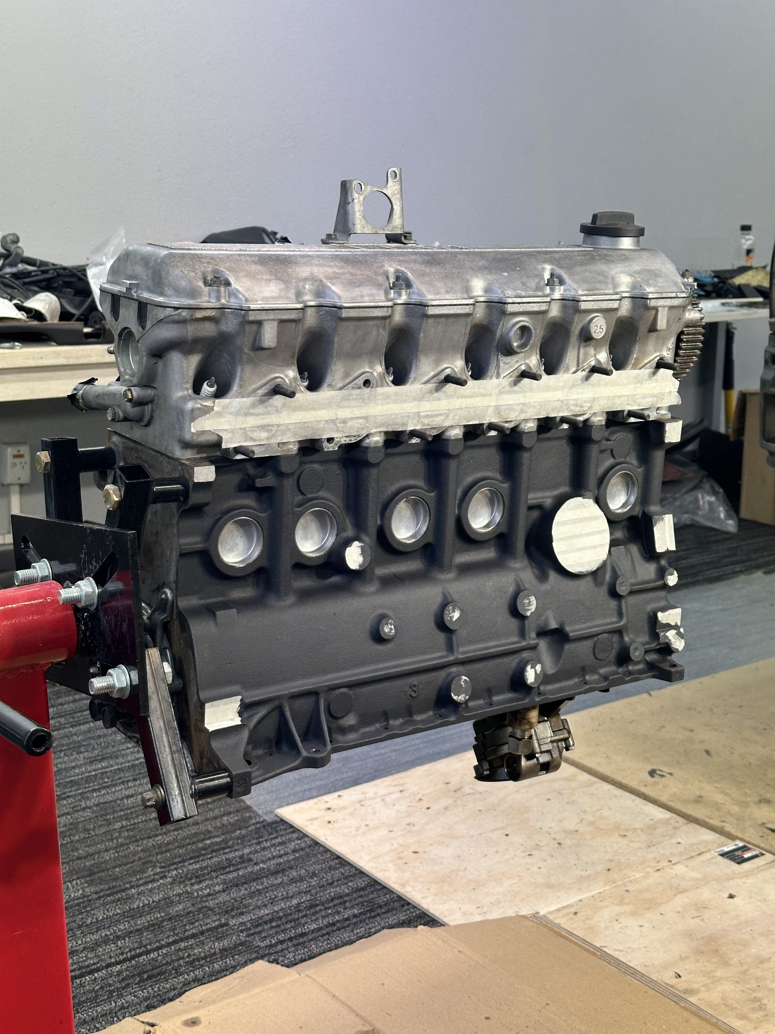

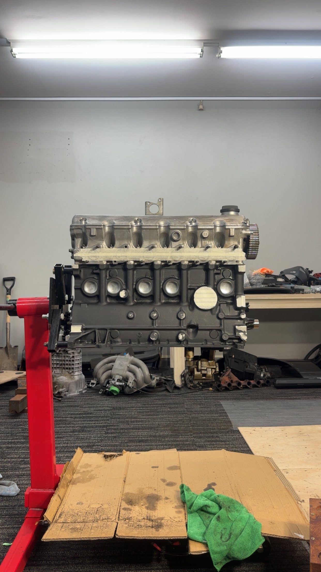

Engine and transmission have been repeatedly sprayed in degreaser all week in preparation for pressure washing which I did yesterday. Block was filthy with grease and dirt built up over the last 37 years so now will be good time to repaint the block and do the seals / gaskets that I haven’t already got to. Got the engine back inside today and stripped it down to begin prepping for paint.

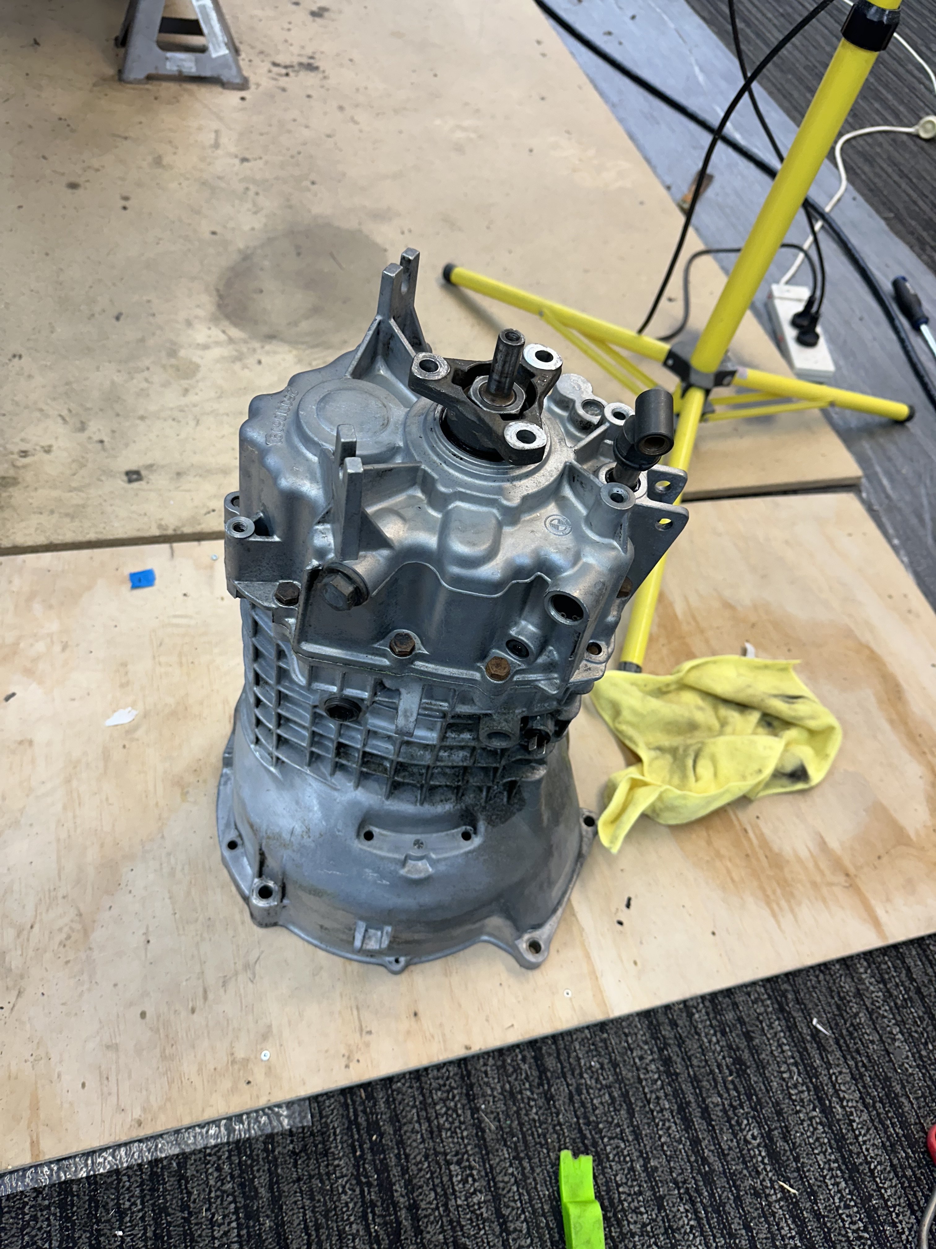

Finished up with the input and output shaft seals on each end of the trans as well as the selector shaft seal along with new selector joint. I had already put a derlin carrier bushing in along with derlin linkage bushings / new shims so should make a huge difference in shifting feel once all back together. (I’m running the z3 shift lever). Replacing throw out bearing, pivot pin, clutch fork / pin and slave cylinder while it’s out. The plan is to paint the gearbox in a nice bright aluminium colour.

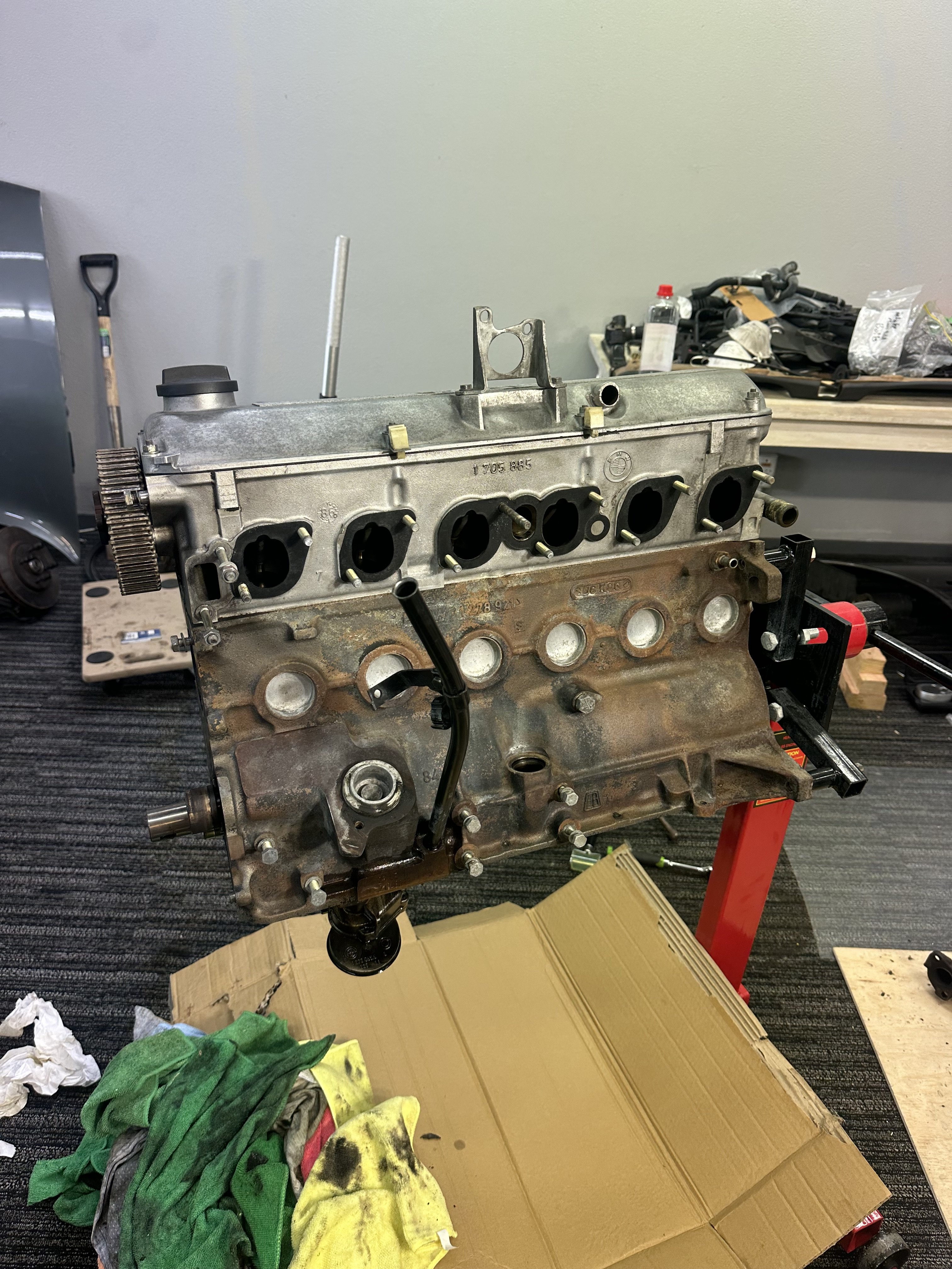

Painted block. Giving POR-15 high temp paint a go. So far, the flat black was the exact finish i was after.
Some before and afters
  • Like 2
No, degreased the block about 5 times with a brush to make sure there was no oils and then hit it with a blow torch briefly to burn off any left over. POR-15 didn't seem to say anything about primer so just went straight on with that. Meant to run the engine for 15 min to full cure.
  • Like 1
I etch primed my cam cover on advice from an engine builder. Sill looks great a couple years later. Will keep por-15 high temp in mind for future. Was not available at the time.
